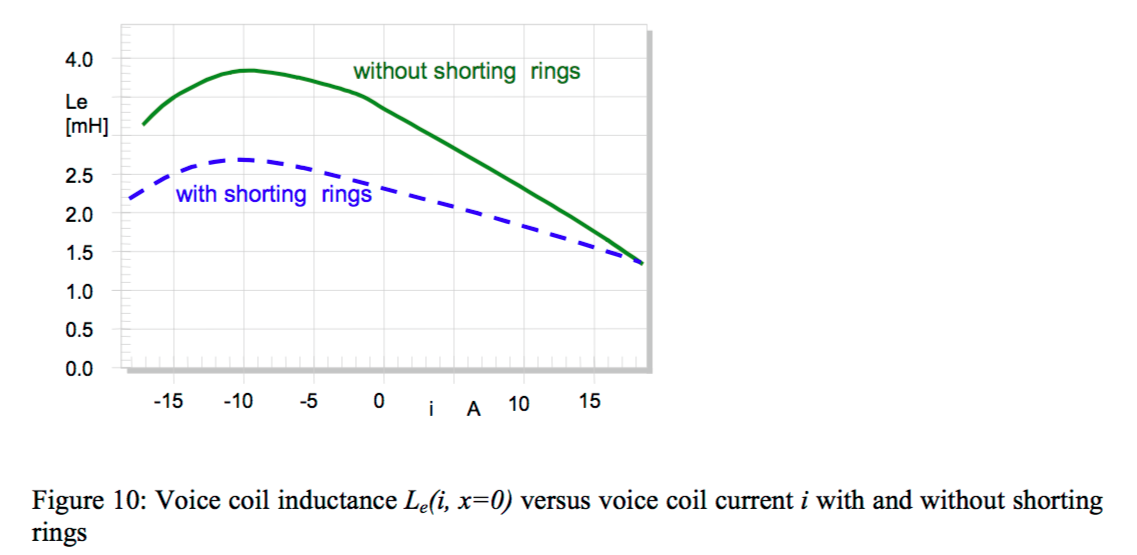

From Klippel.
https://www.klippel.de/fileadmin/_m...linearities–Causes_Parameters_Symptoms_01.pdf
B.
Strange. Inductance vs current, x =0.
What frequency? Who cares what the DC inductance is???
To measure this, inductance vs x is required. Also, frequency dependence.
L vs f vs X vs I vs velocity..It's just a five dimensional problem, what's so difficult?
This is nothing..try eleven dimensions.
