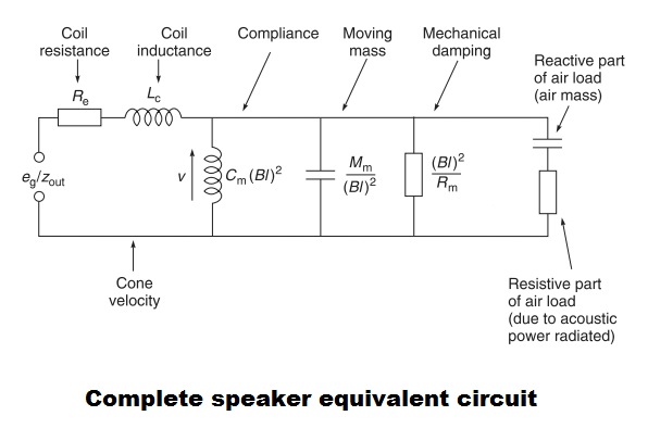

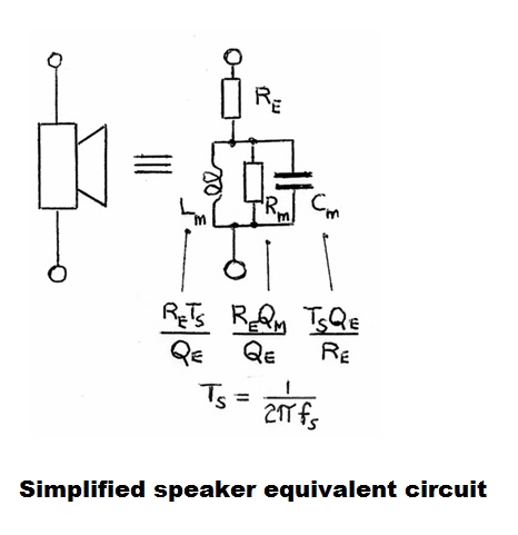

As per the diagram in post 150066, in deriving the feedback signal for motional feedback using a Wheatstone Bridge, R1 and L2 are balanced out by the bridge and therefore R2, L1, and C1 become the impetus for the feedback signal....To model a simplified impedance of a loudspeaker unit, a few parts suffice to do that.
Please see post 150066
Of course, in Lojzek's simplified electrical analogy R2, L1, and C2 are values representing the speaker resonance (or free air resonance of the driver before mounting). But more generally, they represent the elements that model the motion of the cone... which is how you get feedback which includes, at long last, the speaker and the room environment in so far as it influences the speaker.

This might help in understanding where the capacitor comes into picture. To model a simplified impedance of a loudspeaker unit, a few parts suffice to do that.
Thanks Lojzek., I found this, maybe it helps to leave the swamp to those like me we are overcome by so much verbiage.
The capacitance is CM or Mm in the graph.
Speaker equivalent circuit / electrical model | Audio Judgement
