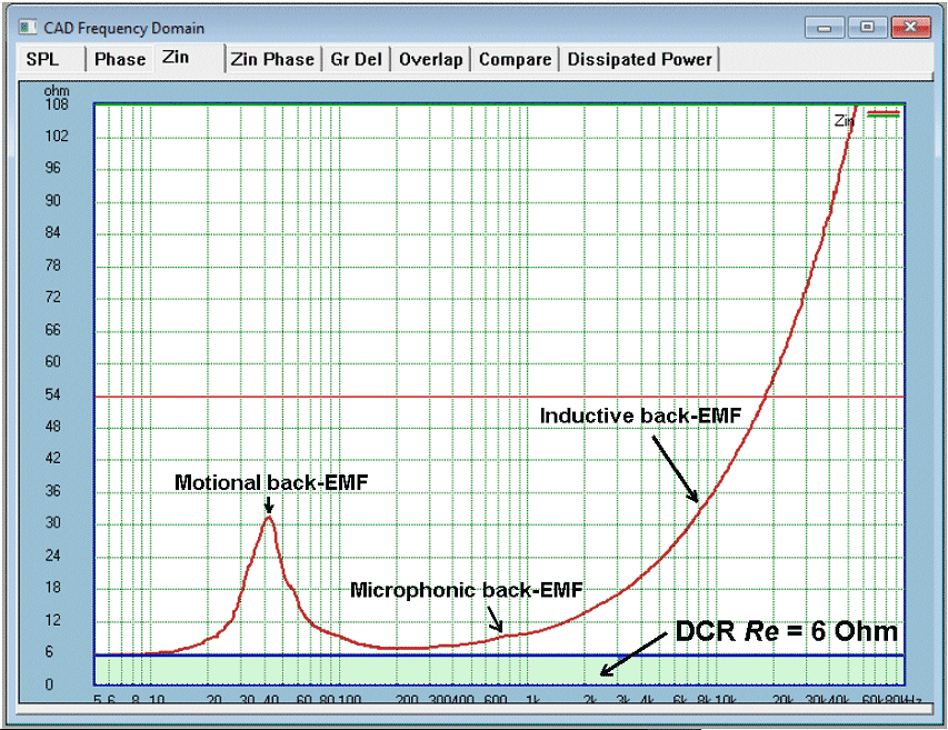

Let us say that R = 6R and at 3KHz the total impedance is 18R. Now we subtract one from the other, and the back-EMF impedance at that frequency is 12R. Now how much current will reach and flow through the Re part of the impedance? Not hard to figure out that it will not be the full 1 Amp, it will be 1/3rd of an Amp. Also, the current phase angle will not be zero degrees. The speaker reacts to that modified current, but once in motion, the amplifier is now reacting cycle by cycle and you have a vicious cycle - one that will only get reduced by the music, the content dying. The dynamics come up again and the cycling renews. All because the back-EMF impedance is not stable, reacting constantly and modifying the current of the amplifier - and what the amplifier does current wise, that is what we end up listening to.

Please see attachment, where Re and back-EMF impedance is shown as part of the complete impedance plot of a driver.
