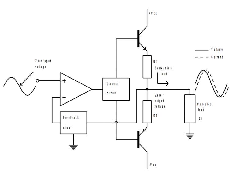

Finally, since most people use Class AB amplifiers, and when switching transition between A and B, that voltage and current are not in sync, does that not spell trouble? I am not the only one saying this, here is a quote:
"When the current through the load is not zero because of a phase shift between the two, one of the output transistors needs to deliver this current. But this is not possible unless an error voltage at the output can open one of the output transistors via the feedback loop! So distortion is introduced and this phenomenon tends to enhance cross-over distortion which is well-known for its highly annoying properties because it has the wide spectral distribution of harmonics as shown... A class-A amplifier is far less sensitive to this phenomenon (simply because there is always current flowing through the power transistors)..." Hans van Maanen from Temporal Coherence (Temporal Coherence - Natuurlijk geluid dat je raakt... - Home
See his schematic representation as attachment below.
It isn't phase shift perse' that causes the problems. This isn't about the ear being sensitive to such things. Just that is a separate issue. It has taken me a long time to think 'current first' while not ignoring the voltage. We are talking about current devices, that means that the voltage across the speaker terminals is not what a driver responds to, it is the current. If the voltage does not change and the current doubles, then the dB-SPL goes up by 3dB. That's it!
