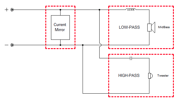

Basically, you can look at what the MyRef project is doing. You are driving current, but you also use voltage feedback.
That is not exactly what the MyRef is doing, but it does have a current pump drive. With voltage feedback, you still have the response of a voltage amplifier. But you can control how the current drives. Yes, the current gain can be adjusted, and you can optimize it to different loads, but basically it will work with speakers like a voltage amplifier would do.

Creating a classic "constant current amplifier"!

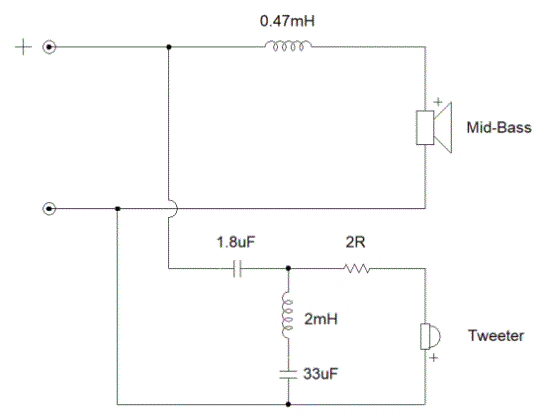

Earl if you look at Joe's web site you will see an example of what I think he is talking about. Crossover, plus drivers showing a pure real impedance at the terminals (except at the lowest resonance). I have no problem with this, it's just the confusing way of explaining it. Saying it "forces" the amplifier into constant current mode is stating the obvious and leads to confusion. To add to the confusion are the comments about crossover distortion as if it is not a problem at zero degrees of phase between voltage and current.

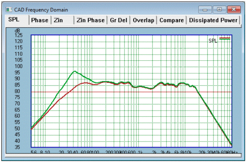

One thing is interesting though, if you EQ the current, so that the amplifier supplies the same current at all frequencies, then you have effectively cancelled out the output impedance of the amplifier. It is still there, but there will be no deviation in FR. This can be done to near perfection with sealed boxes and more difficult with vented boxes. It also makes the crossover not need to see a zero source impedance, so both box alignment and crossover behaves the same.
So that is incredibly practical too. Especially with the kind of amplifiers I do, 5 Ohm typically. The box alignment does not need to see zero Ohm.

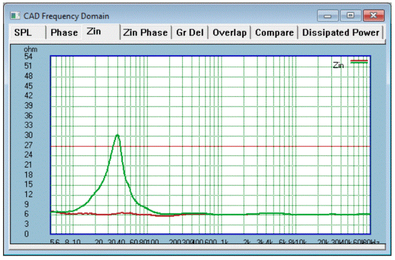

But if the load impedance is made totally flat, as close to that of a resistor, then we have constant current with respect to frequency. Several interesting things happen, for one you can indeed use a current amplifier, if you wish. This is because the output impedance largely becomes cancelled out. Two, the LF tuning and crossover no longer needs to see a zero Zo from the amplifier. For example, a sealed box Butterworth Q=0.707 will stay that way, no matter what. Normally any added series impedance would blow out the alignment. Same goes for the crossover.
This isn't just theory, it is quite achievable and added complexity is over estimated. I have done a 2-Way system with 13 crossover parts. Actually, 8 was used for the current EQ (seen directly by the amplifier terminals) and he rest as the actual filtering. See attachments.

That flat impedance, making the current the same at all frequencies, the real pay-off is that the current phase angle goes flat, virtually zero degrees. An amplifier cannot produce reactive current under those circumstances. In fact, the current load is resistive. So just as current drive is about the current, this proposed alternative is also about the current. And the one thing that corrupts current in unpredictable ways is the back-EMF impedance of the driver. Suppress it is the key to both. In fact that is the raison detre.
