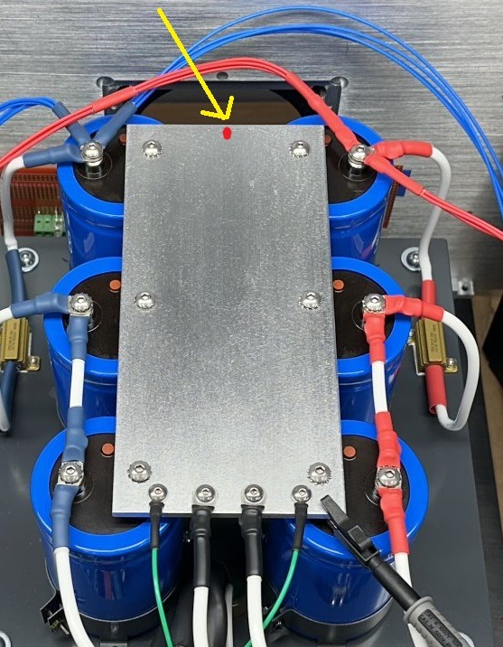

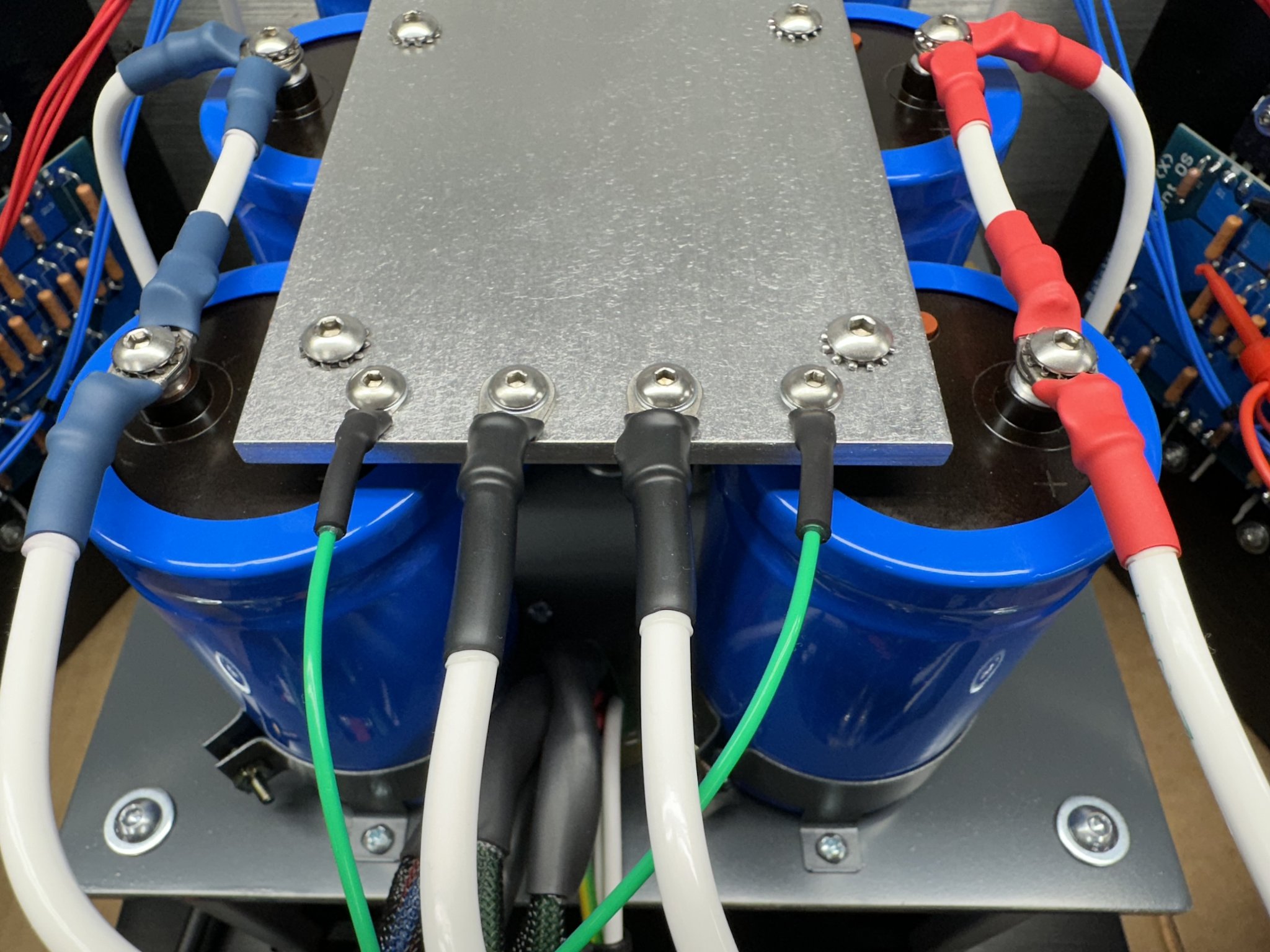

GNDs - it should help you to get clean GND reference to FE pcb
see attached pic - small red dot, pointed with yellow arrow, exactly in middle of 2 caps, ditto on edge - hopefully out of pulsating currents routes
where red dot is, drill small hole for M3 or M4 or whatever small bolt size, take your GND wires for FE from that point
I assume those caps are final ones in Cap bank, and there you have (where red dot is) some tiny area where are no current pulses

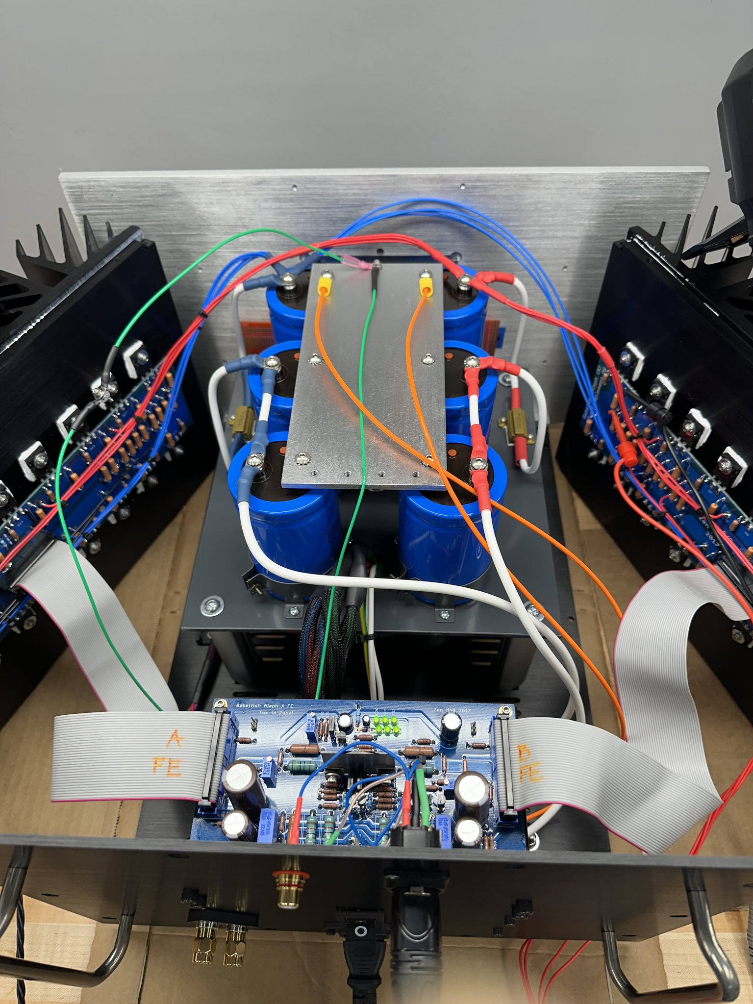

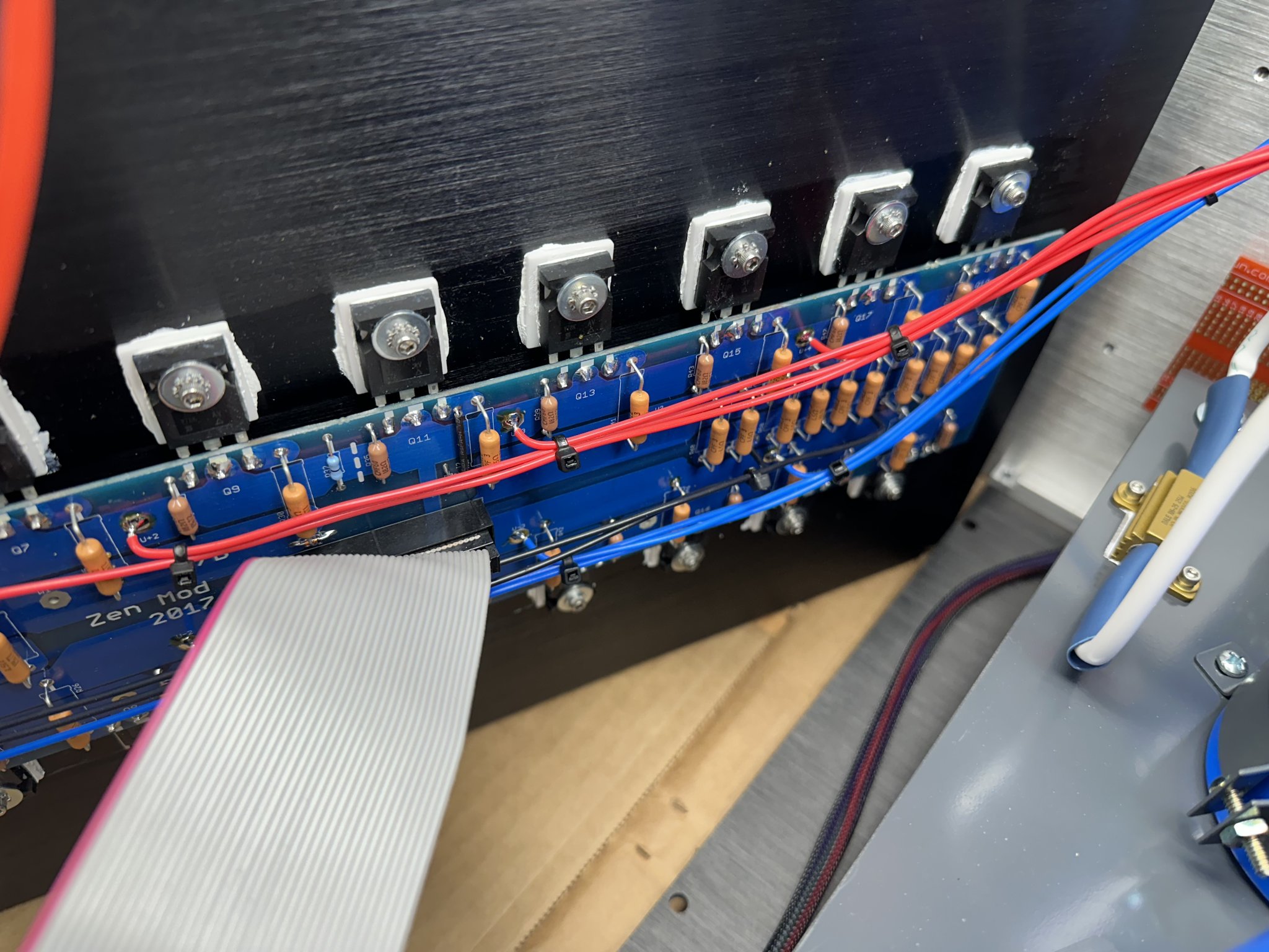

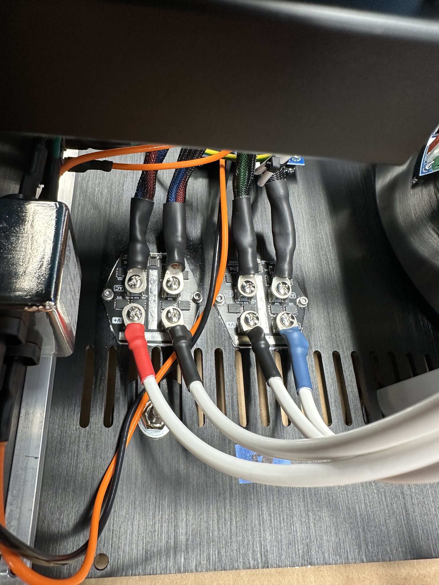

See pictures below for bridges to cap bank (and also front ent). Cap bank to pcbs is 4 runs of 16 awg for each pad on the pcb.it would be helpful if you can describe/sketch in detail how you did wiring from diode bridge(s) to cap bank and then to pcbs
I see it as potentially fishy but I can't be sure from posted pics

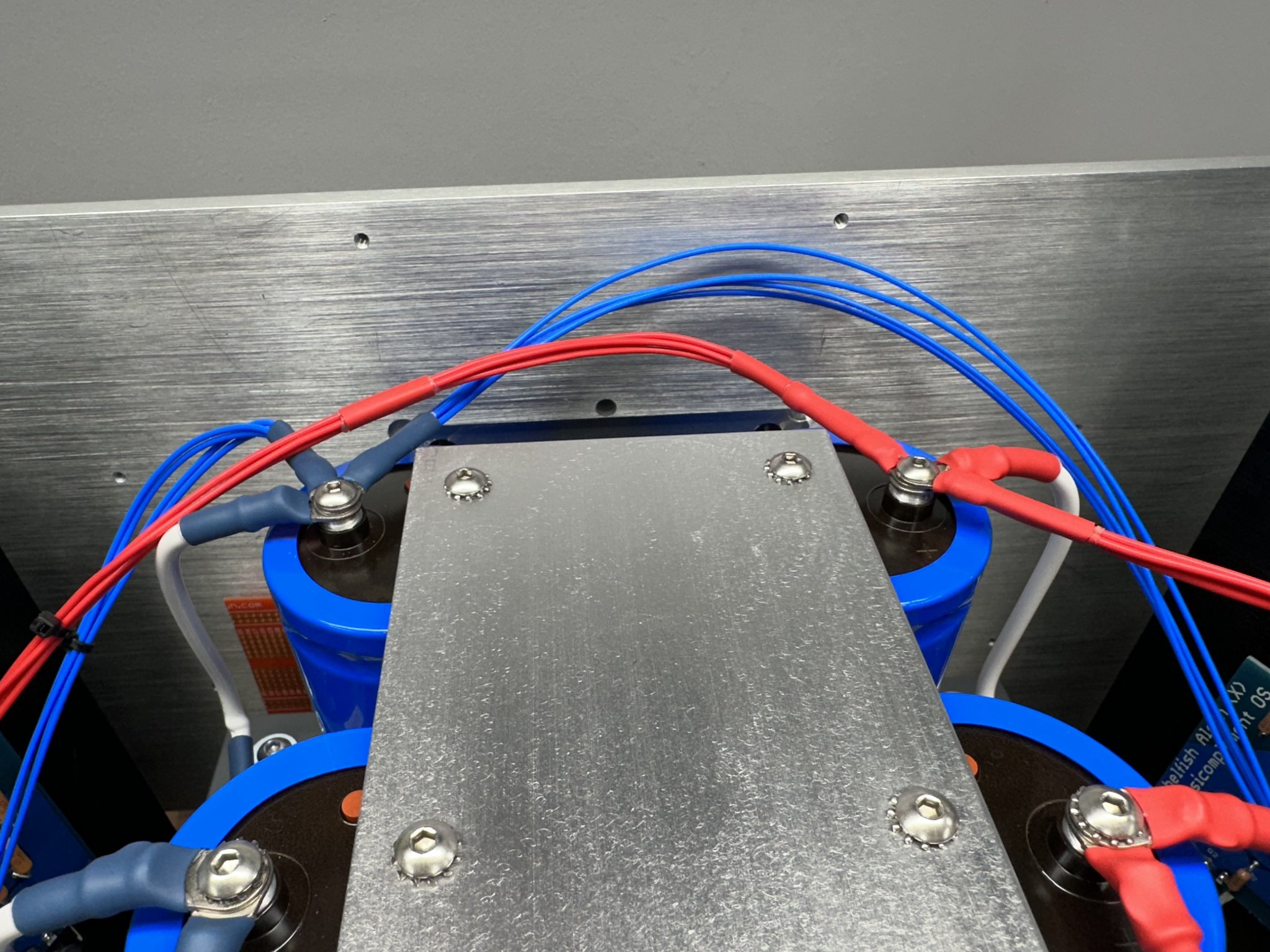

Interesting, never thought about pulsating currents through the plate, plate is 3/16" aluminum.GNDs - it should help you to get clean GND reference to FE pcb

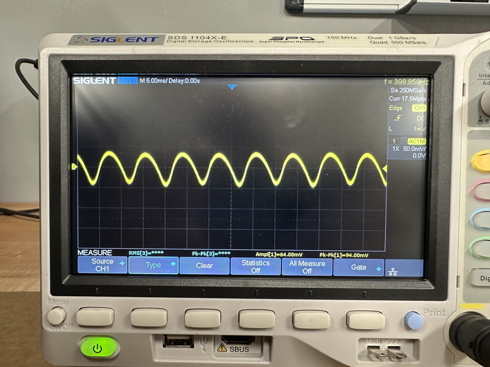

3 - PS Ripple - Getting 100mV on pos and neg rails (see attached). About 400mV before the resistor.

anyway, let's wait to rearrange that GND take-out point ....... as you have now, it's practically dirtiest possible place to get GND from

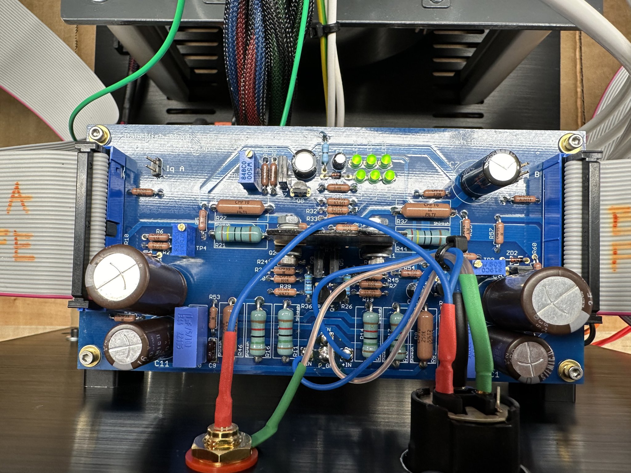

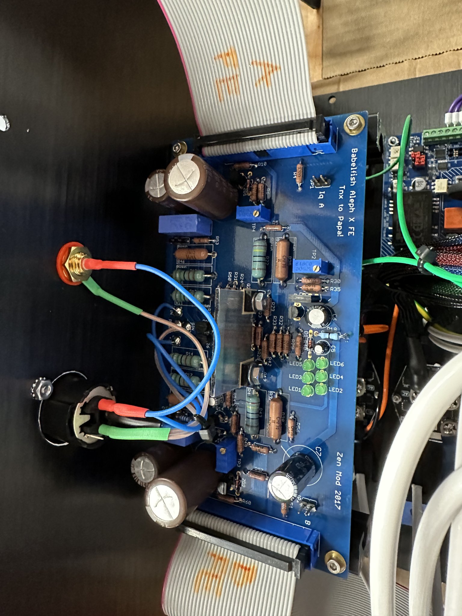

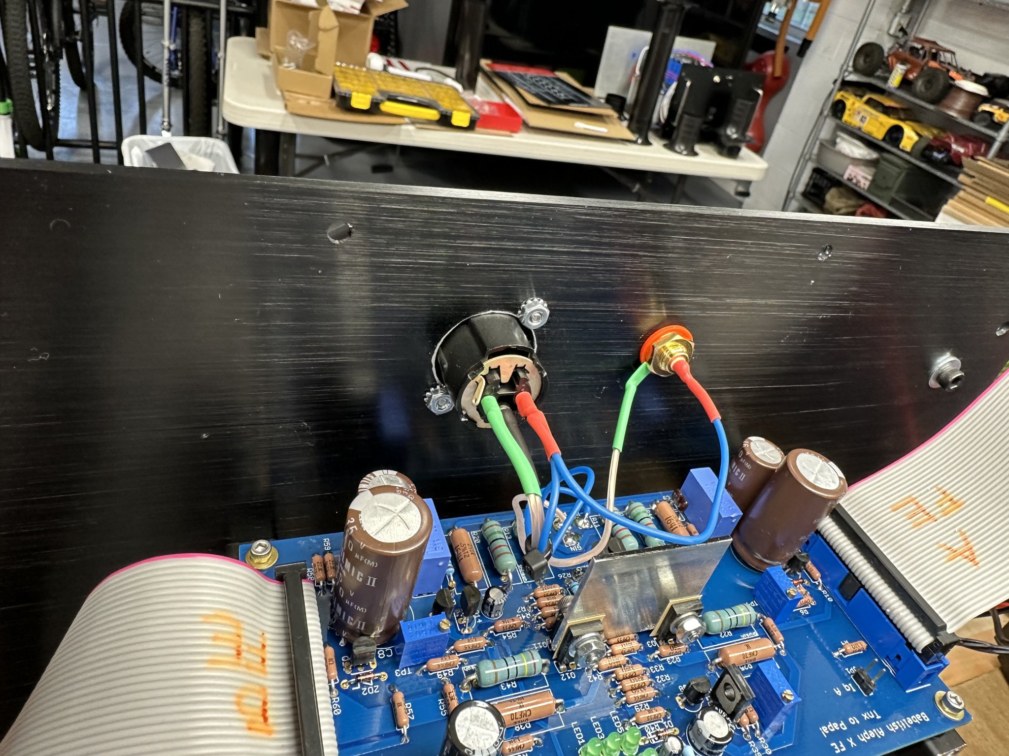

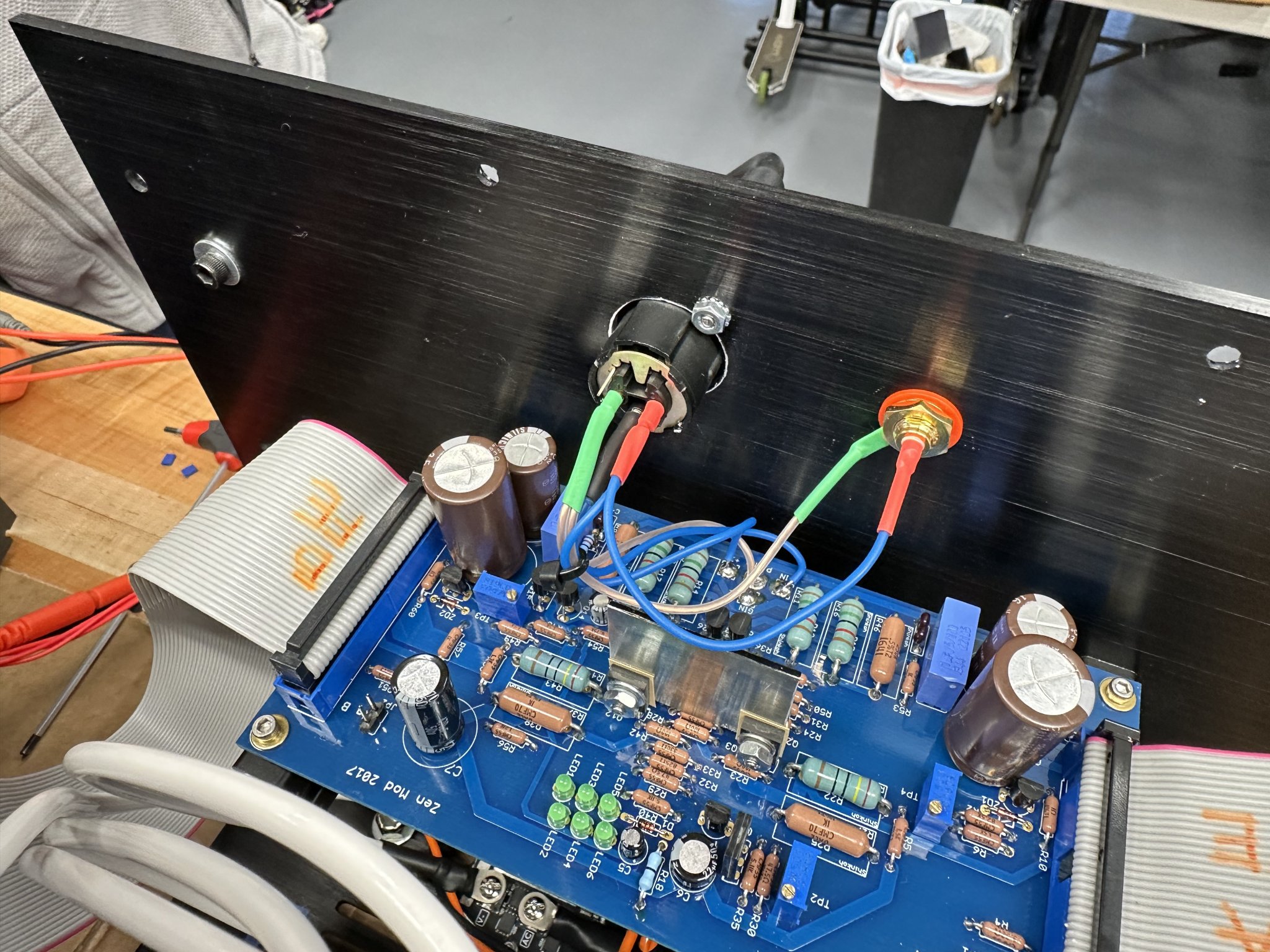

All right, updated FE ground complete and we're still buzzing unfortunately. m4a sound file in the zip. I have the option of moving these output stages over to the other PS/FE for the other channel and seeing if I get the same issue there.
I know I am not of much help but I will say that you have yourself a beautiful-looking amp! I am really excited to see what you think of the sound after you get it functioning 100%
-Are all of the ribbon connector solder points good? I know those can be tricky. Clean all of the flux off of the solder points and inspect carefully.
-Did you have to make the ribbons yourself? You can check for continuity on both sides on each wire going across. Or just swap the ribbons from the good channel
-You can check the parts and that the active and passive components are all of the correct values etc.
-Check the resistance between the signal ground and chassis ground on both the good channel and the buzzing channel
-Did you go in with a chop stick to tap and push on the components gently?
I listened to the recording. It sounds like some grounding issue or power supply noise to me. Moving the bussing parts to the other power supply does seem like a reasonable thing to try but it would be good to let the Mighty Zen Master pitch a few thoughts.

anyhow - what I'm thinking now ....... those 2 white wires with black heatshrink bands, connected from bridges to GND plate
maybe just for giggles and temporary, to test nature of evident Gremlins - try disconnecting them from present position of GND plate and improvise how to extend them - then connect them to GND screws of last caps in chain - all the way back, where you moved GND takeout wire
so, one white/black to left cap GND screw, second white/black to right cap GND screw
and yes, wire going from GND to chassis (hopefully with NTC inserted) - it needs to be moved also all the way back, to clean GND point

OK - Temporary wiring from bridges to final cap ground complete and chassis ground (which goes through CL60) also moved back. Hum is better, but still there. I should have measured to determine difference, but can do that later.
So is there a better solution than the ground plate? Should I try to establish a star ground instead?

I know from experience with those ideal bridge rectifiers, having used them in many class A, that under a much higher load than a class AB amplifier, I’ve had transformers buzzing (even encapsulated ones) and getting very hot after a couple hours, also causing hum in speakers. I had to change the mosfets on the rectifiers (tried different ones) to get it to quiet down a lot. My suggestion for you is to try a regular bridge to test everything and if you conclude that it is the issue, then you can address the ideal bridges afterwards. Also, low ESR and high ripple caps just after the ideal bridges don’t help.
