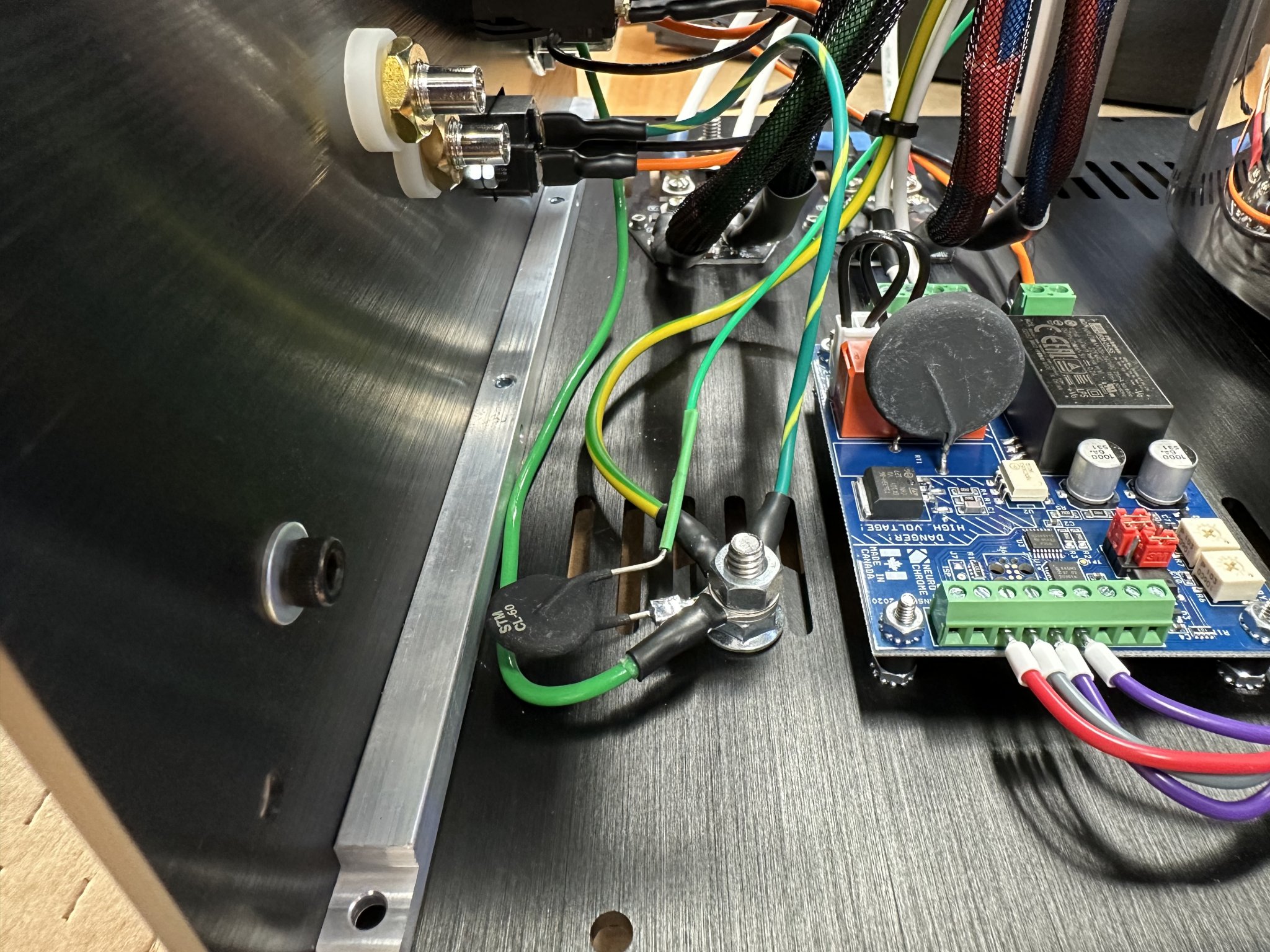

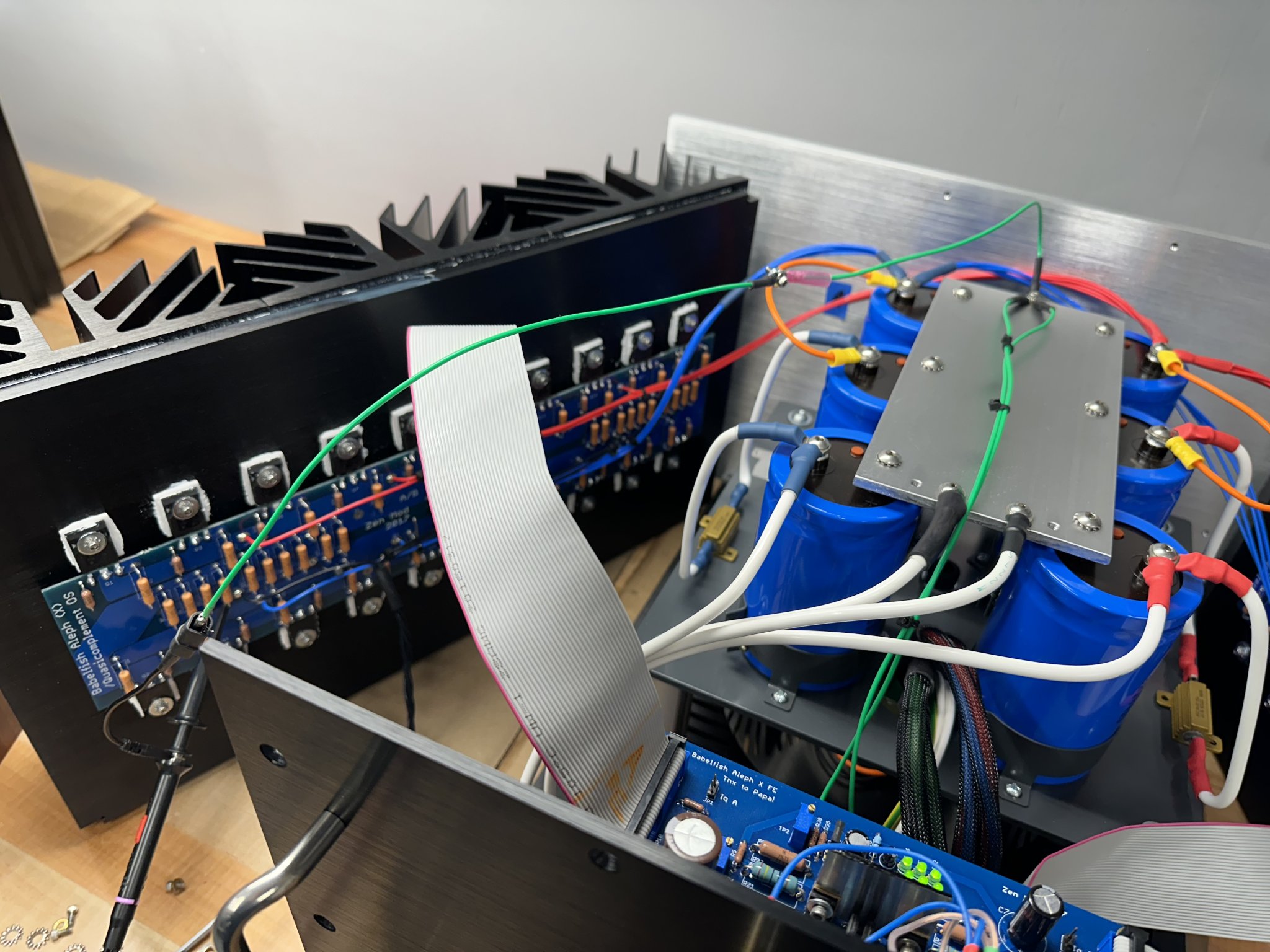

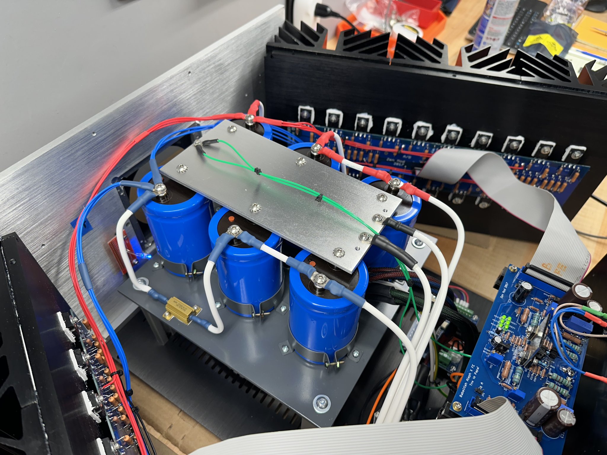

Hi all - wanted to summarize my current power supply components and see if there are any recommendations for areas to change:
IEC -> 10A Thermal Breaker/Switch TA45-ABDBL100C0 -> 6A Line Filter 5500.2652.04 -> Neurochrome Intelligent Soft Start -> Toroidy 1200VA, 117VAC Primary, 4x17.5V secondaries -> SALIGNY® Power rectifiers -> Caps: CDE DCMC643M063CF2F in a CCRC configuration. Caps rated at 12.1 mOhms ESR and 15.5A Ripple Current -> Resistor Dale RH-25 0.1R.
Audio/Circuit to Chassis Grounding is through a CL60.
Few more pictures attached of where we stand now.

after that, one thing worth trying, arrange your filter bank in CRCC
easy, if you unscrew R from plate, at least for temporary test
Thanks ZM
I paralleled a 10uF across C12 and no change to buzz.
I then swapped to a CRCC and no change to buzz.
Unfortunately no change with audio ground to chassis. Bigger R in CRC? Would have to buy new parts to try that.

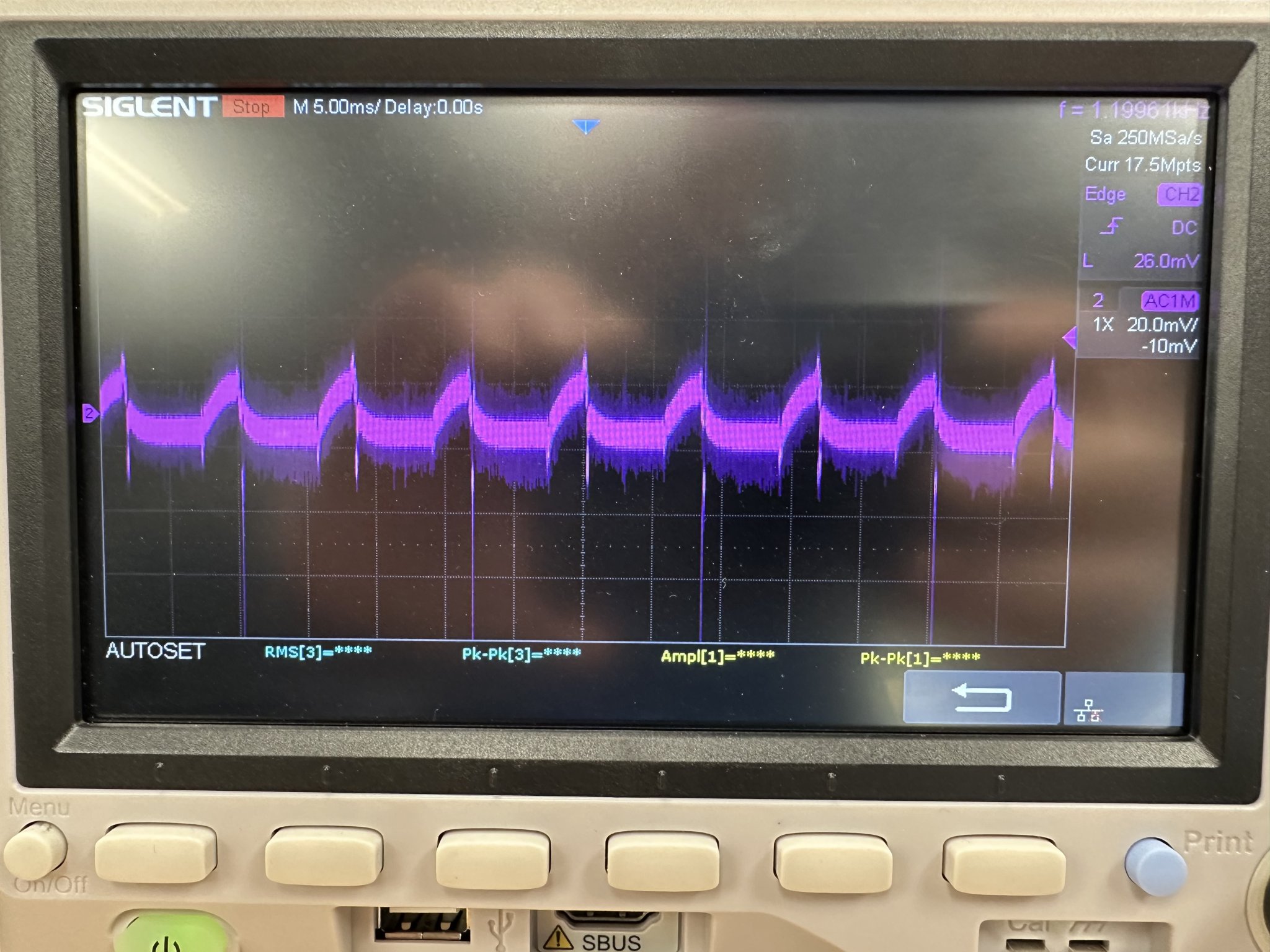

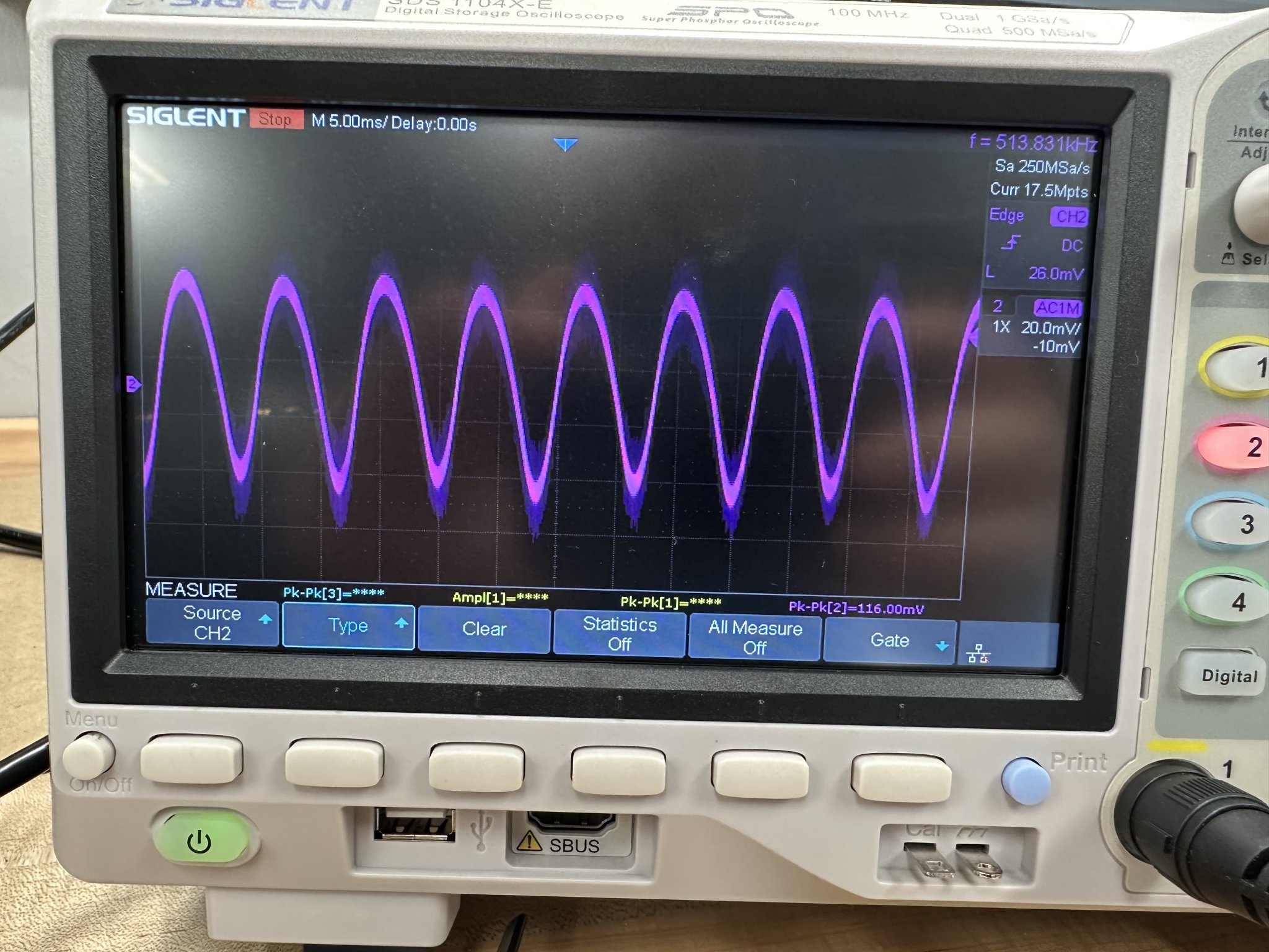

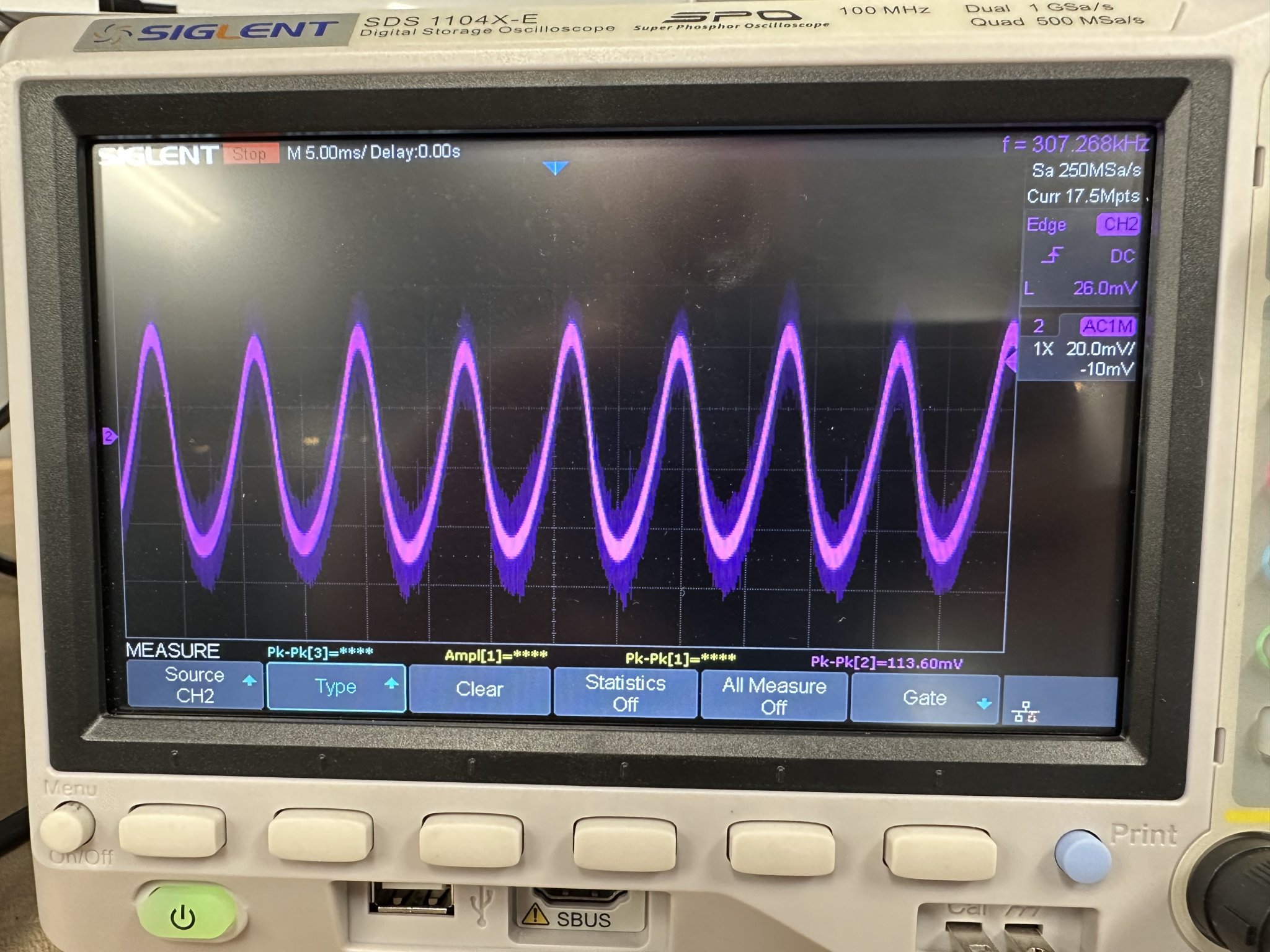

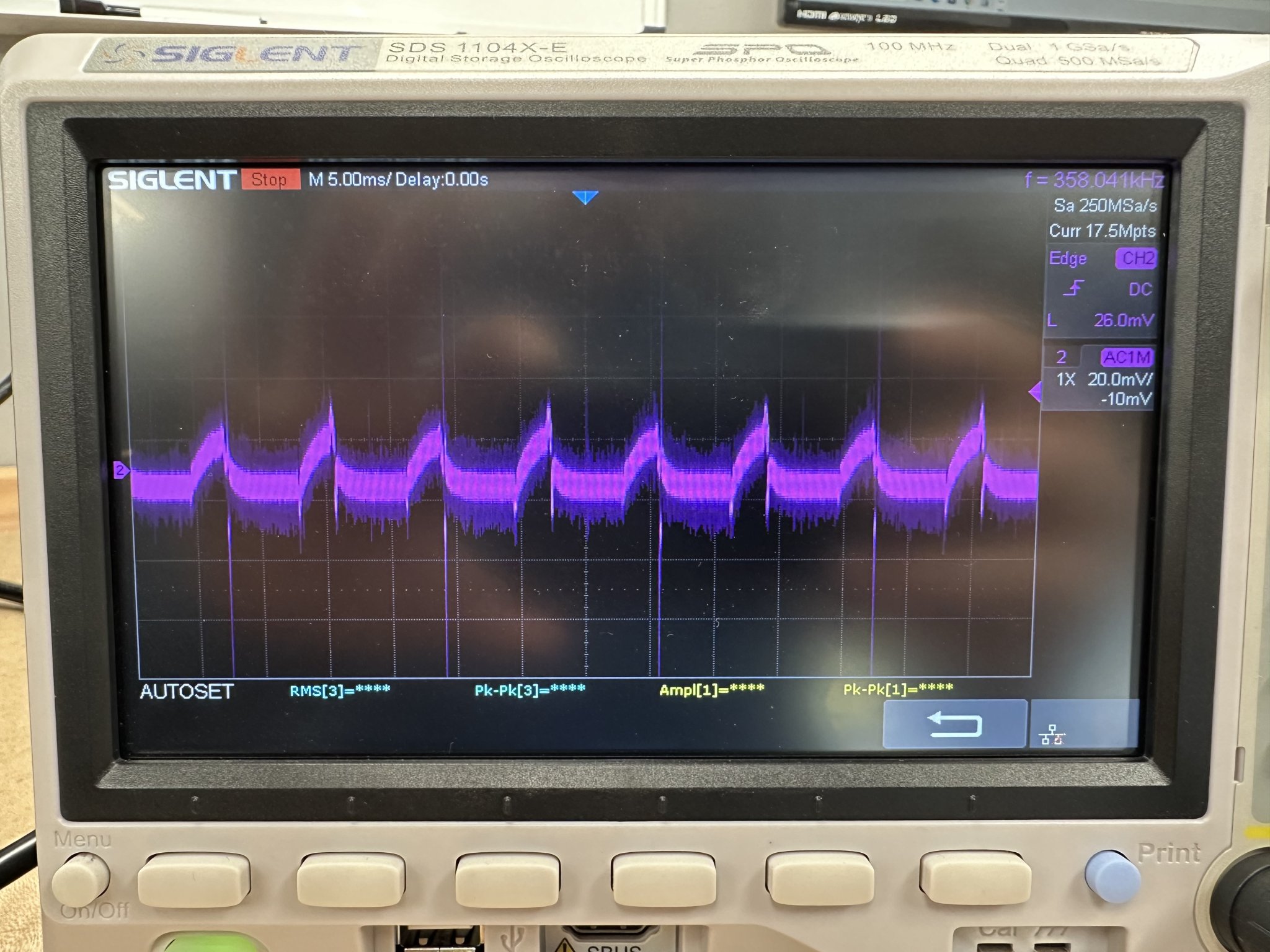

check (again) PSU ripple with scope and post picture
check output with scope ( if scope probe is safety grounded/not floating, measure one hot ref. to GND, then other hot ref. to GND), post here
OK Not a Scope expert, but here goes:
Left Amp, Inputs Shorted, Speaker Load Connected, Still in CRCC, Scope AC Coupled, GND taken from 'clean' point on plate.
Filenames hopefully explain the measurement.

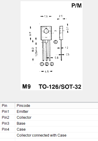

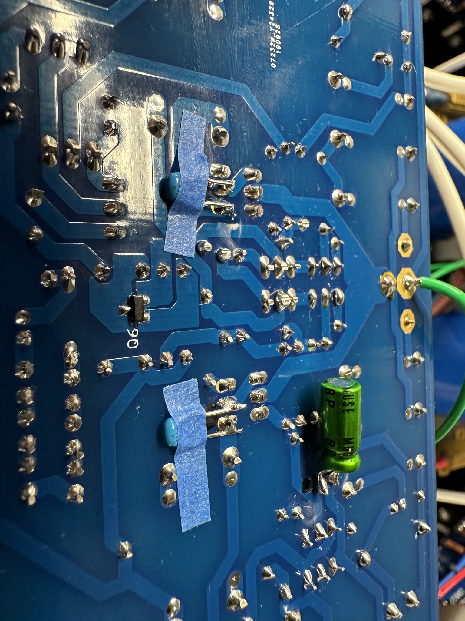

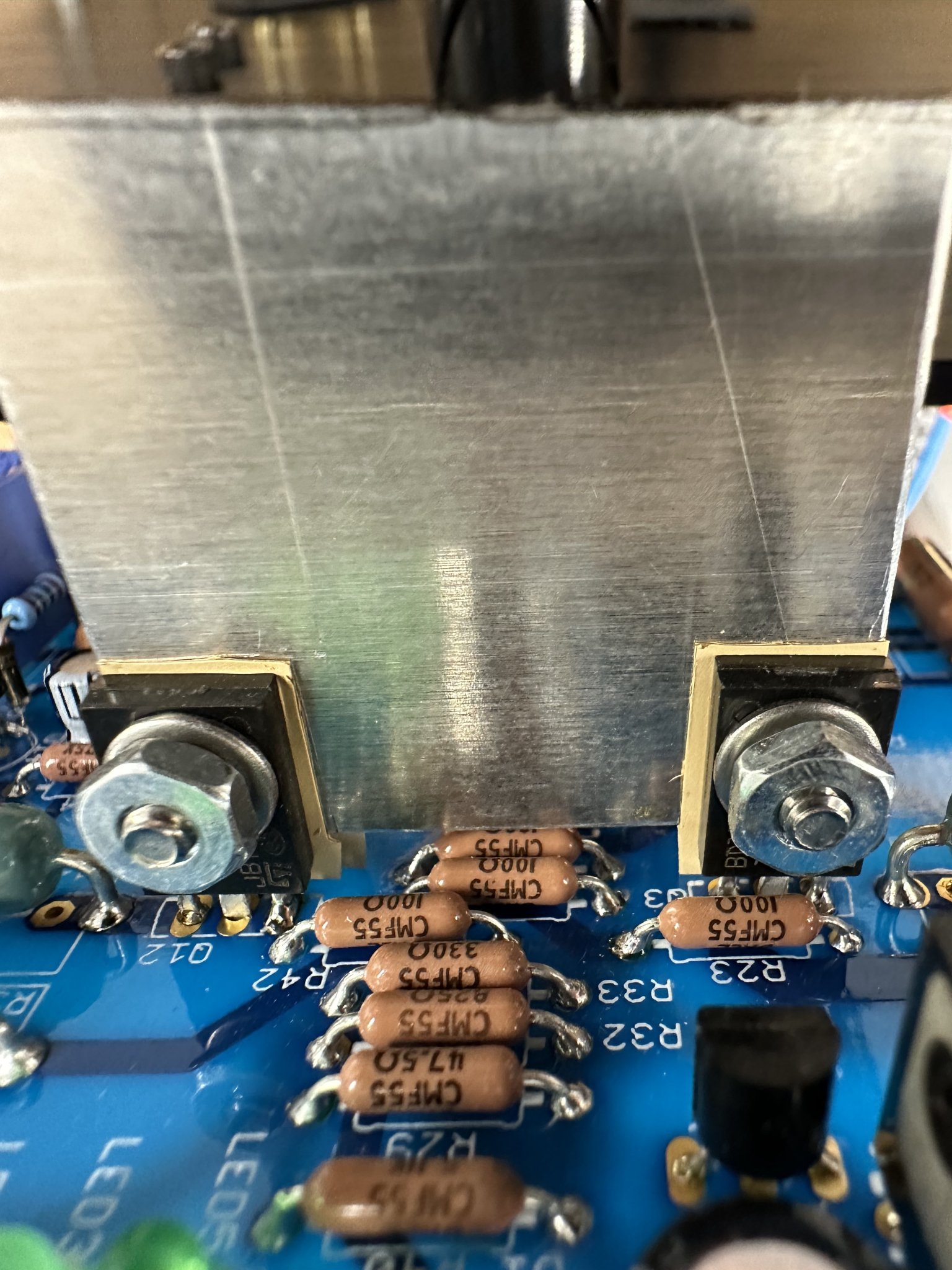

ok, to remove even slightest possibility of circuit oscillation, please do this:
find a pair (per channel) of small caps - anything from 220pF to 1nF will do, either smd 1206 or small ones with pins
solder them on copper side in between C and E pins (or on traces, closest possible to transistor itself) of Q3 and Q12
those being emiter followers, practically final drive to OS
transistor numbers ref. to schm in post #4
that being pins 1 and 2, pins down, label to you

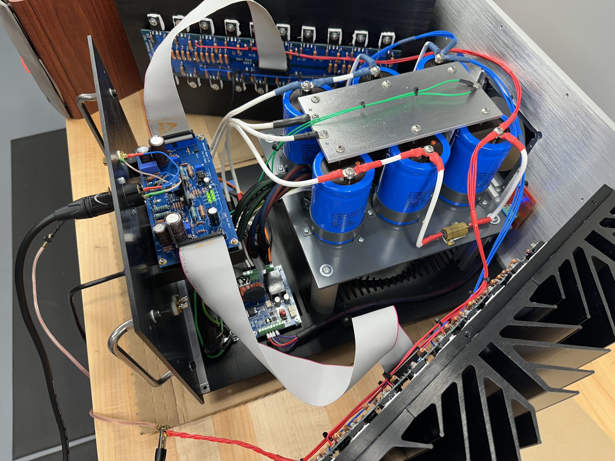

is there a way to - temporary - connect two Donuts, together with their bridges, to one cap bank?
practically - disconnect wires going from one channel bridges to cap bank, and connect to other channel cap bank?
that way having two xformers feeding one cap bank, bridges are there so paralleling is proper, and each xformer dealing with just half load
I mean, I exhausted ideas - everything regarding amp circuit, even if least likely to be a problem, we tried ........ wiring arrangements - logical and less logical, bridges....
now I can only think of snubbers for xformer secondaries, but that's just hanging on the straw

It’s curious why LA Out on post #330 shows the frequency at ~ 1.19khz. All the others are very high in frequency.

all 4 scope readings are pretty much equally dirty, so I reckon (with everything else taken in account) that's due to measurement itself - see just how long that wire to central GND point is
anyhow, sound file posted before clearly shows 120Hz as main ingredient; yup, it was weak in volume, so to be sure I needed to pull it in Sound Forge and do some tweakering, but then it was conclusion
