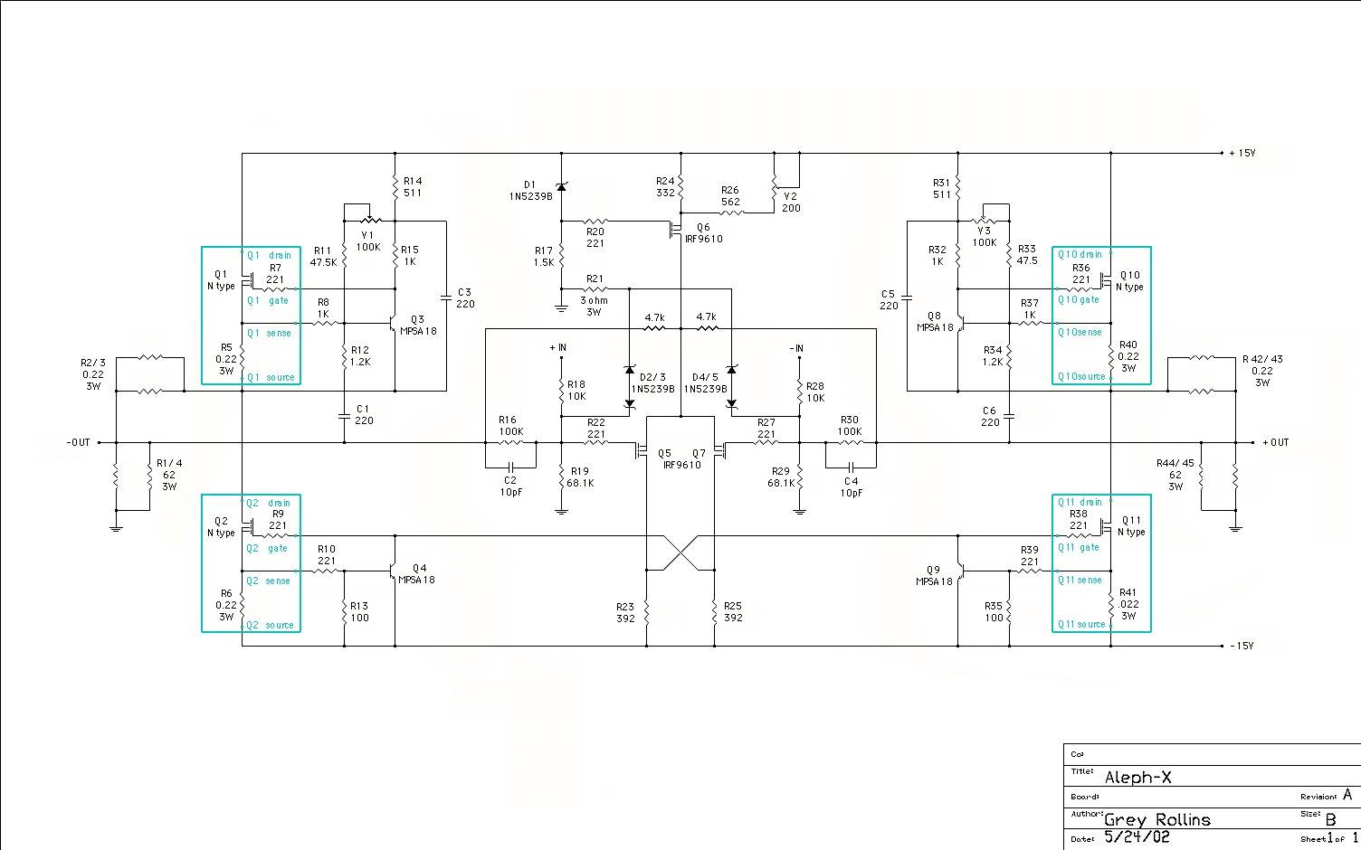

Almost 16 years ago , Gray Rolins came to clever idea (alone ? bugging Papa in private mail, as we all do more or less?) to bridge two regular Aleph channels ....... well , read by your self exact story HERE .
As far as I remember (origins), properly visible schematic is this one :

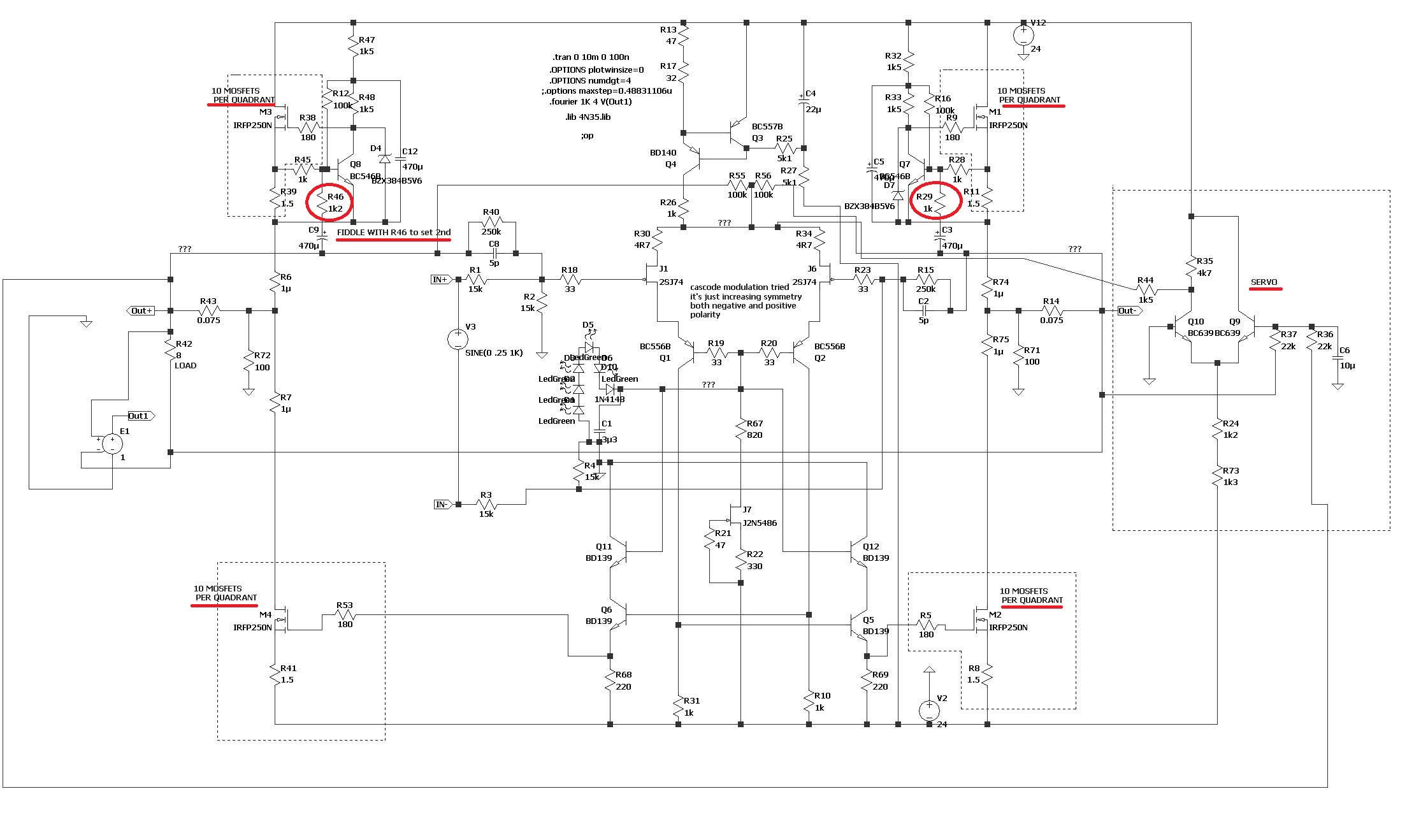

……… Wheel is turning ……. Robert sent cases to me , I was LTSpice-ing like mad , trying to implement all details ; I did tried them one by one in vivo , but never combined.
So , after countless hours of PC time (yes , I’m slow) , here is LTSpice schematic , intended for first prototype step ; Big Bada$$ mosfet banks omitted for clarity , each quadrant of 10 parallel mosfets shown as single one :

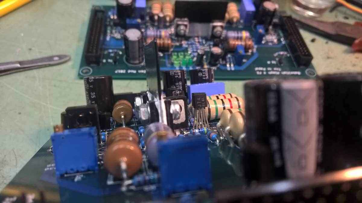

Then Ikebana prototype , measurements and some tweaking of values ; it passed , so it was time for pcb work.
Robert insisted on some fancy resistors , in most important positions ,so I made that – placement for both usual metal films or fancy Shinkoh/Kiwame.

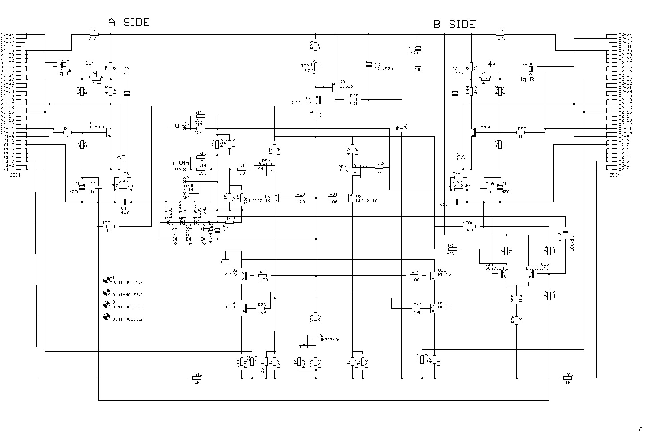

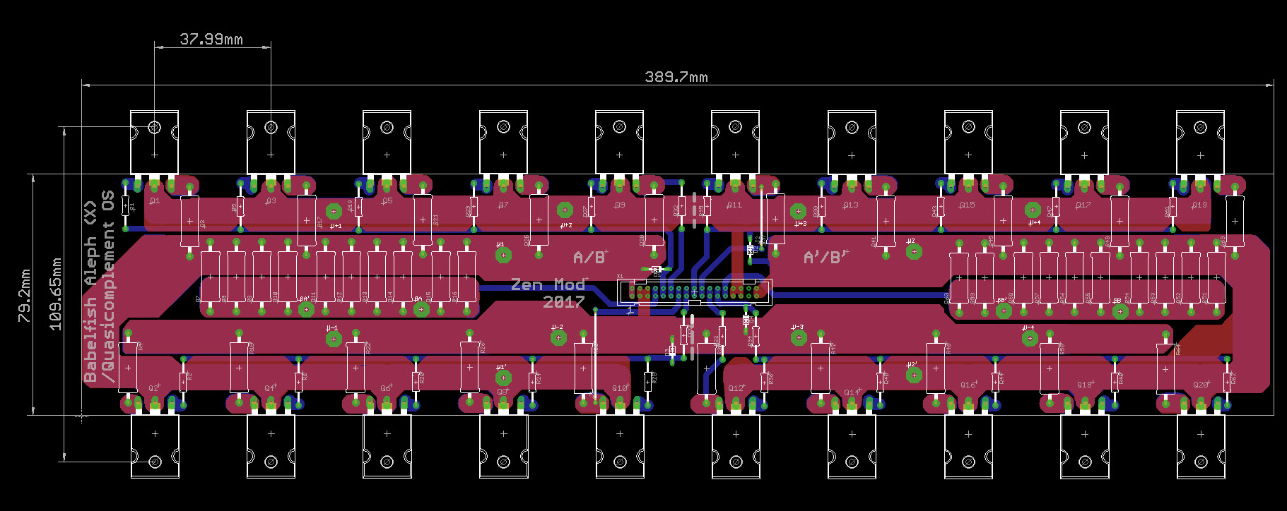

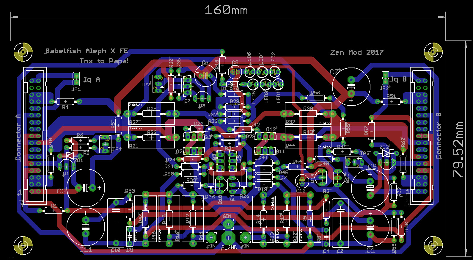

Front End Eagle schematic and Front End Eagle pcb screenshot:

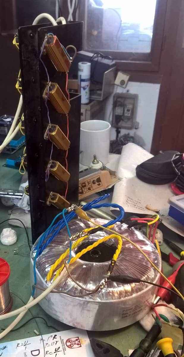

I'm using this (pictured while testing donuts briefly , so no fan ) :
when exploiting full power of my extremely dummy load (2 x 8R/250W in slim format) , I need a fan , so usually looking like this after :rofl: :

If you take a look at LTSpice schematic of amp (third pic from top) , you can see two resistor positions circled in red. These resistors are path to modulation of Aleph CCS-es and their values are directly defining amount of that modulation , thus defining amount of Aleph CCS-es contribution in output signal .
So , simple ; disclaimer – my goal is to invoke 2nd , and control it’s polarity and amount :
-If these two resistors are same in value , there is greatest amount od symmetry , resulting in zilch 2rd ,dominant 3rd.
-If we increase value of said resistor at side of positive output , there is increase of 2nd (and dominance over 3rd) , while our dear 2nd being negative phase,
-If we increase value of said resistor at side of negative output , there is increase of 2nd (and dominance over 3rd) , while our dear 2nd being positive phase.
That’s it .
How it is organized in vivo ?
I had idea to introduce sort of already know device among Greedy Boys , called -ZAP (Zen Amount Pot) , but later decided that would be impractical , and probably leading to constant play with , while forgetting enjoyment in music 🙂 …. so I decided to use pin sockets/or whatever their name is , in said resistor positions , thus allowing easy change of resistors in situ , without involving soldering equipment etc.
Now , if you take a look at Eagle front End schematic and Eagle Front End pcb screenshot (4th and 5th pics from top) said resistor positions are R3 and R53 , with R3 being position of our special interest .
My taste dictate R53 being 1K , and R3 being 1K2 ; for anyone else’s taste , all what’s needed are few different resistor values and pincette/tweezers ; just power amp off , pull resistors out (gently,please) and push new one in (gently again , please).
After that you can power amp on , or go out for beer and some talk , I don’t care 🙂
