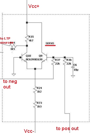

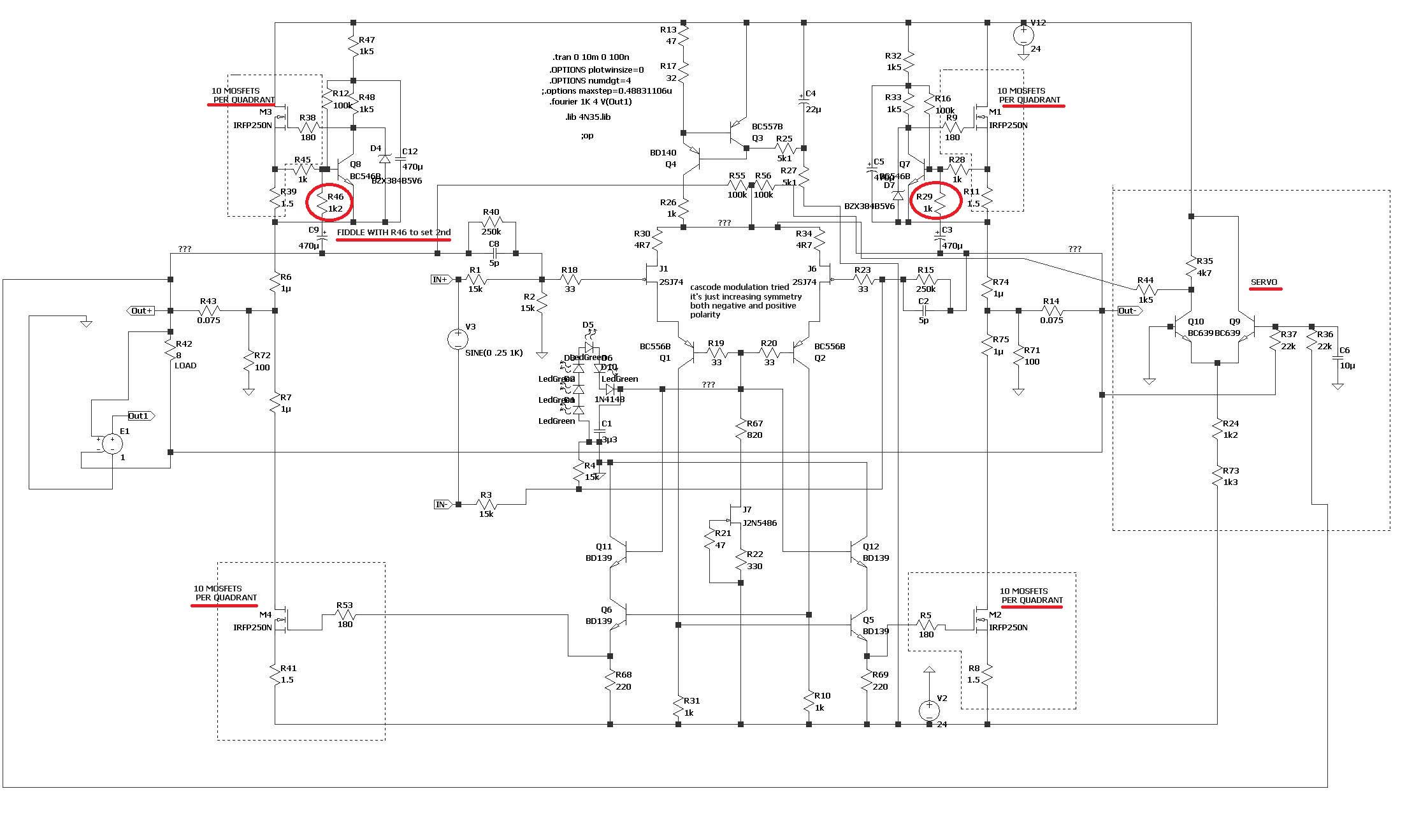

implementing servo in your existing Aleph X
it's easy ;
just look at (re)attached schm , taken from LTSpice (open it in new tab) ;
you can use small veroboard , to accommodate parts bracketed and labeled as servo - two small T092 transistors (any decent NPN 1W will do the job)
you have to connect 5 wires & GND:
-Vcc+
-Vcc-
-sense from neg out
-sense from pos out
- servo out to sources node of input LTP
-GND
decrease slightly current through LTP CCS , to allow servo circ to compensate;
replace McMillan resistors with new ones, at least 10fold in value vs. present ones
rebias/reset entire thingie

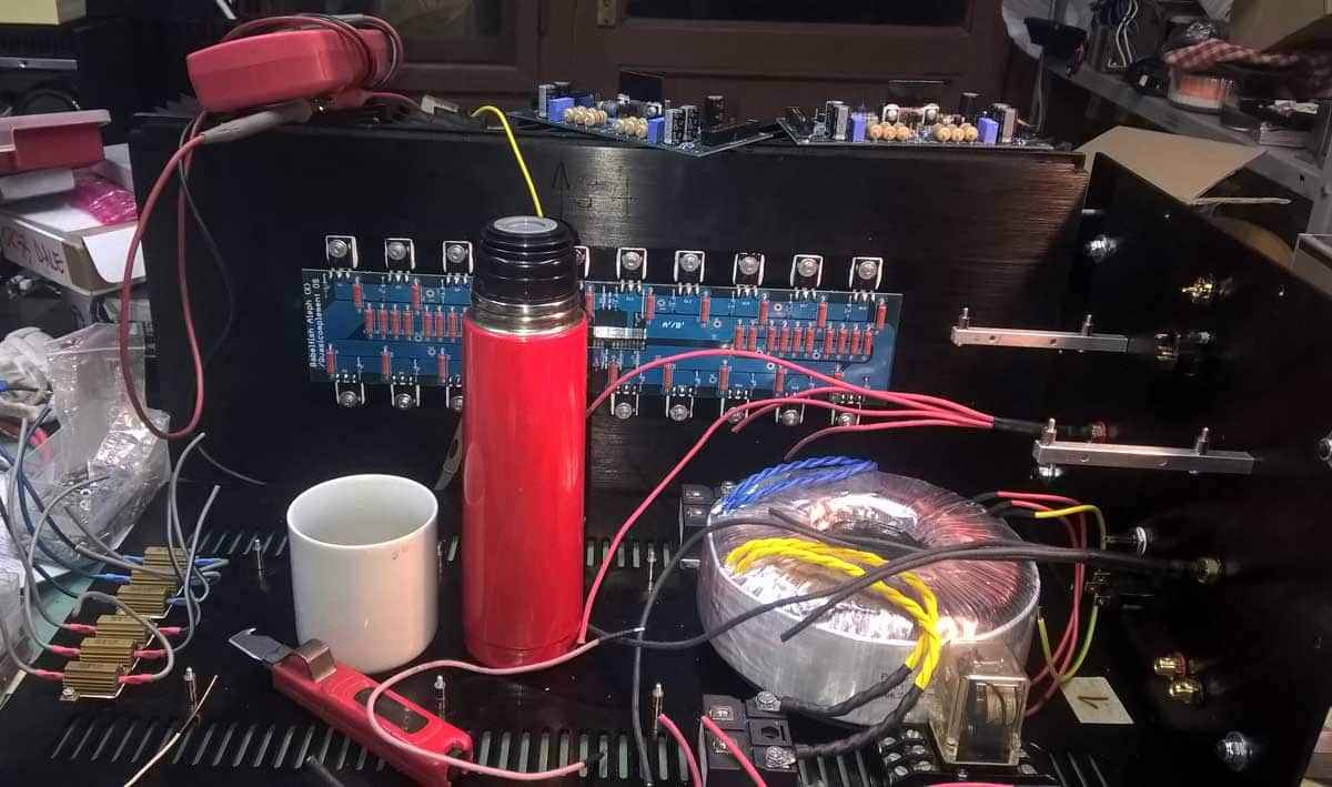

Ahem... I just want to say it looks like several resistors need to go on a weight loss program... They look kind of chubby. 😀
Those resistor stand-offs are kind of cool!
All in all an AWESOME build. But that's to be expected from the Mighty ZM! I wish I could take it for a drive. 🙂

Wow, ZM is that one of these boxes with 8 heatsinks?
Is the plate where you mounted the IRFP outputs on, not too much brushed? Shouldn't it be smoother?
is the way you are mounting your Frontend boards, also the way passlabs does it? With the two alu bars?
yup , those ;
regarding quality of case , everything is top notch ....... so mounting of outputs is also no brainer
PL way of mounting - dunno , this way is logical to me , so why not

also important thing about implemented servo
......... I'm sure that I saw principal schematic somewhere in Papa's s papers/projects ; even if I tried repeatedly , I simply couldn't find it again , due to enormous number of files I have stashed along the years .
So , even if I can't reference it precisely , it is important to say that all puzzles are his , as usual.
- Babelfish XJ , or JX …….. or whatever (Aleph X servo for Greedy Boyz)
