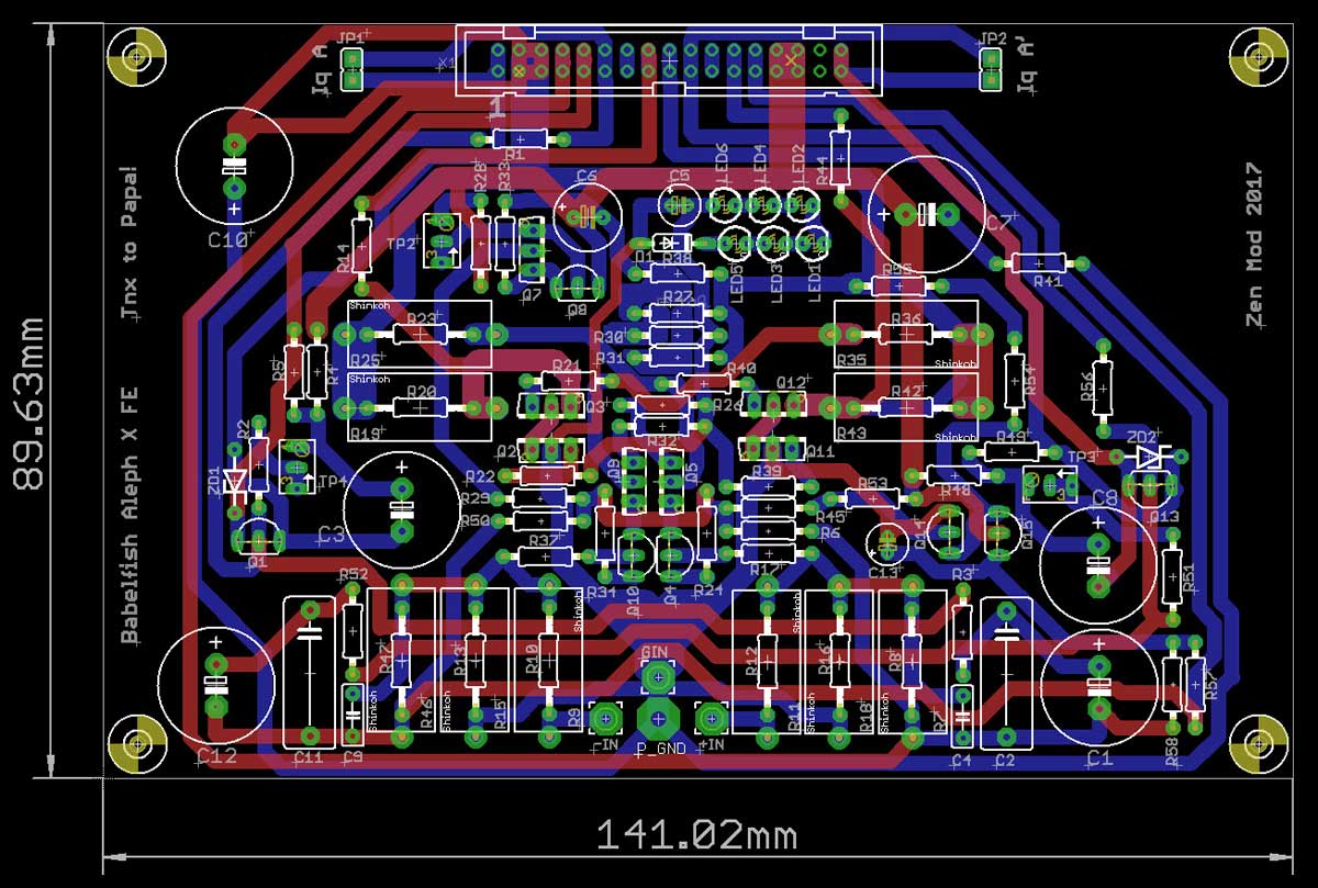

Babelfish XJ , or JX …….. or whatever (Aleph X servo for Greedy Boyz)
FE for 5-deep
so , one big OS pcb per channel ...... so it's possible to make stereo amp in one (big) case
even other solutions possible , if one use something as Daughter boards I made for Babelfish J on Steroids (each small pcb covering 3 mosfets)

Soooo.... I have a BIG 5U case from modushop. And a nice +-30V PSU with a 600VA and 216000uf currently powering a BA3 + F4.
I believe this PSU and case fit the bill for this nice project of yours. Would you consider a OS pcb that fits the UMS mounting standard?😀
The 5U 400mm with standard drilling has space for 16 output mosfets, still plenty right?
What did you alter? The 22mA emitter follower?
pretty much written in few first posts:
- there is cascoded JFet input ,
-cascoded emiter followers
-servo dealing with absolute offset

reconsider that Aleph is circuit simply not able to even make a Klunk! , let alone pass it
so , you're doomed on pure A class , thus needing everything heatsink can cope with
so , 30V rails are pretty much in SciFi realm

Several iterations of amp were made , in various sizes and complexity , several threads …… to my knowledge most comprehensive being this one , also extremely worth mentioning is Eric’s web page , dedicated to his Aleph X incarnation.
