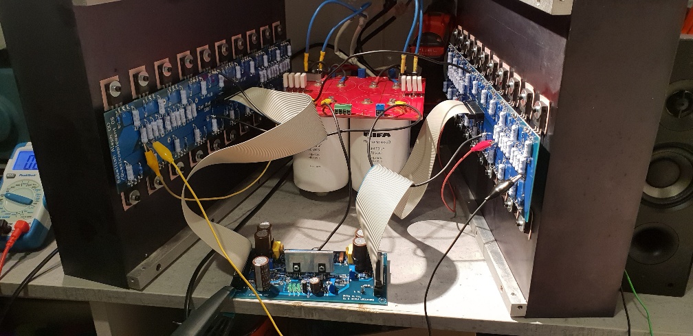

Tonight I managed to finish a mono BJX channel (100W)
I did not abstain and played a bit of music.
I expected to be fine, but ... I have not been so impressed for a long time. It's extraordinary ! And I subscribe to everything Slowikpl wrote!!!
And yes, combine the best of XA.05 and XA.08. I am really impressed, very silent, the voices come out of the night and am amazed with their warmth and clarity. And bass ... very special.
Thanks a lot to ZenMod for this project, for the patience she had with me, there were some problems. But I managed to solve them. One tip, if you put only one pair or two MOSFETs for testing on the PCB, do not try to connect a speaker. I did it and I could not understand why I have oscillations in both channels. I've lost a lot of time before I realize that I have to put all MOSFET on the PCB. After I did it, everything went back to normal and it was fine. (between Hot Out and GND am 250mV, between both Hot OUT am 10mV) Bias 350mA on each MOSFET after 2 hours has not changed, as well as offset- very stable)
And the most important - the sound is super cool!

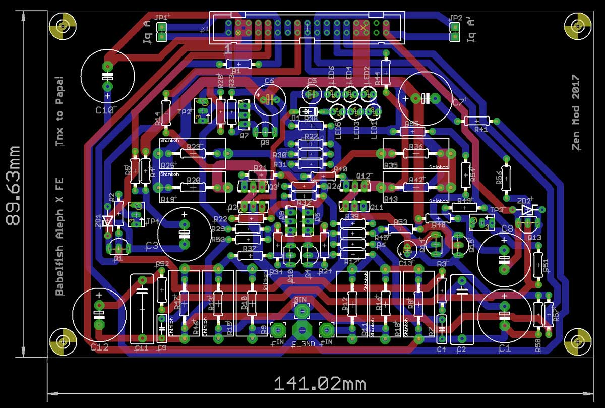

what I had (briefly?) as intention , to answer on someone's demand/urge/request/wish , is to make smaller iteration , where one big OS pcb would be used as one channel ..... resulting in 5 mosfets per quadrant
say that 5U/500 Modushop case is base ; by my experience with smaller ones , that one is good for 150W of heat per side ...... maybe asking for Babysitter in Summer months ...but that's trivial
rails as absolut minimum for good mosfet behaving (think capacitance linearity) are 18Vdc ( 15Vac secondaries)
so , rails sum is 36Vdc , heat 150W , so Iq =150W/36V=4A17 .... that would be 417mA per vertical pair
output voltage envelope approx. rails sum minus mosfet/source res. loss and that twice .... say 64Vpp
output current envelope approx 2 x Iq = 8A34
on 8R load we have voltage as limiting factor , so 64Vpp .... resulting in P=Urms^2/Rload = approx 60W
where Urms ={Upp/2/1.41}
on 4R load we have current as limiting factor , so 8A34pp ..... resulting in P=Irms^2 x Rload = approx. 35W
entire thing is based on idea that smaller version must be smaller physically , but ... bridging is tricky thing - easy to get max output voltage , but physics is physics - we still need some current Cojones to make W from VA
regarding mono-block organization - no particular benefits of having two sides for heatsinks , when you have "just" 20 mosfets per channel
for that , one can use already made Babelfish XJ shown here , and starve it more , both with voltage and current , even leave out few mosfets from pcbs
when you starve it enough ...... damn - just make bigger regular (SE) Aleph J
edit: attached sshot of small Babelfish XJ FE pcb ; not checked in vivo ...... though , no reason for some special doubts will it work or no 🙂
