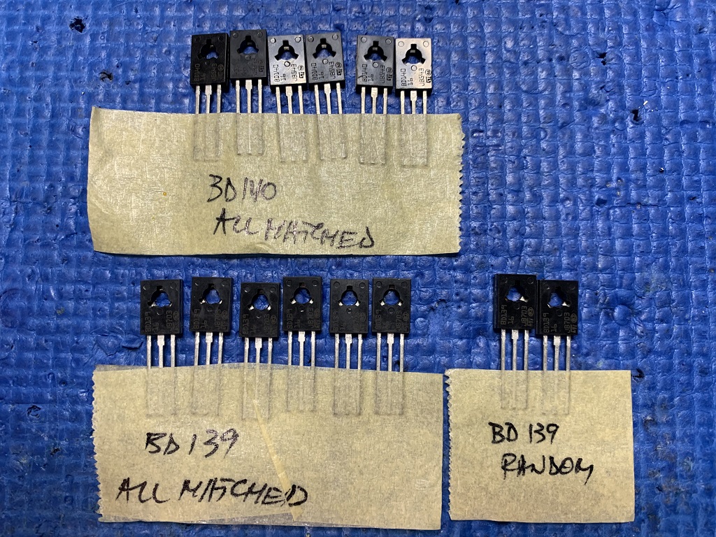

As per my previous post, here are some questions that I had regarding the input stage module.
- Q2, Q3, Q11 & Q12 are all BD139. Two IPS boards requires 8x BD139. You did send me 8x in total but one pack of 6 that is written "all matched" and 2 that are written "random". If these four transistors need to be matched, then I'm short 2 devices from the "all matched" BD139. Do they need to be all matched, and if yes, I bought a pack of 20 to make another 8 matched devices. If they need to be matched, what are the parameters I'm looking for and how did you test them for matching?
- Since I'm reassembling two new IPS boards, I don't have BC639. They seem to be obsolete at Mouser and Digikey, unless I'm not looking at the right number. I did manage to find some BS63916 but the parameters are a little different. What should I do?

Do
practically , just Q3-Q12 need to be matched , cascodes are irrelevant
with BS63916 , is that typo - you meant BC63916 ( which is probably BC639-16, where 16 means just classification by Hfe)?
anyway - those at Mouser are BC639-16 , marked in funny way , so they're good ( two types , one of them being 512-BC63916_D27Z , lazy to go back and grab code for second)
didn't I just sent you spare BC639 , along with spare input JFets ?

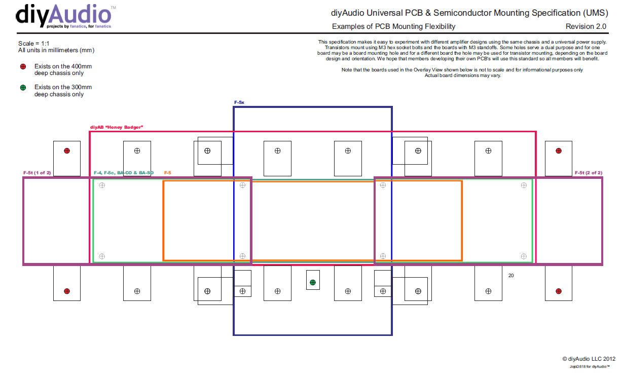

Is there any news about lower version of amplifier using one channel on each heatsink
I think 5U UMS heatsinks would be ideal for that.
Could fit up to 16 TO-247 transistors.

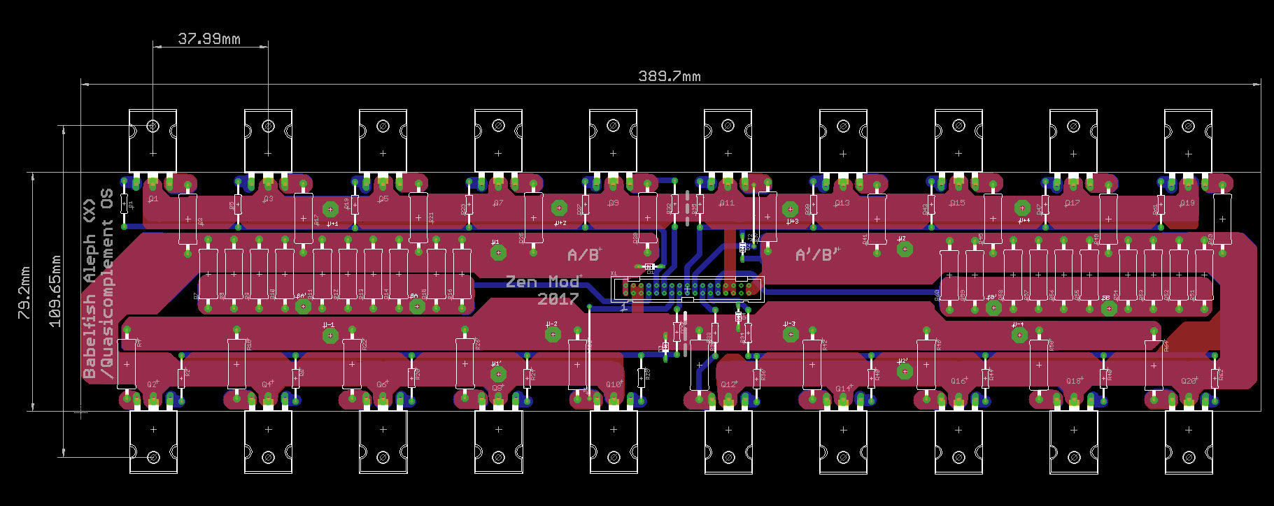

I already have OS pcbs made for big one, which is 10 pairs per pcb; applicable either for two quadrants ( big amp, 10 mosfets per quadrant, needing 2 OS pcbs for amp channel) or 4 quadrants (smaller amp, 5 mosfets per quadrant, needing 1 OS pcb for amp channel)
OS pcb being 79mmx390mm , with mosfets holes at 110mm ....... it can go even in 400mm deep Modushop case , but my advice is to use 5U/500 Modushop case
there will be plenty of heat and you need all the chunk to get rid off it
edit: see post #5
one pic from there :
660334d1517613851-babelfish-xj-jx-whatever-aleph-servo-greedy-boyz-os-pcb-sshot-jpg

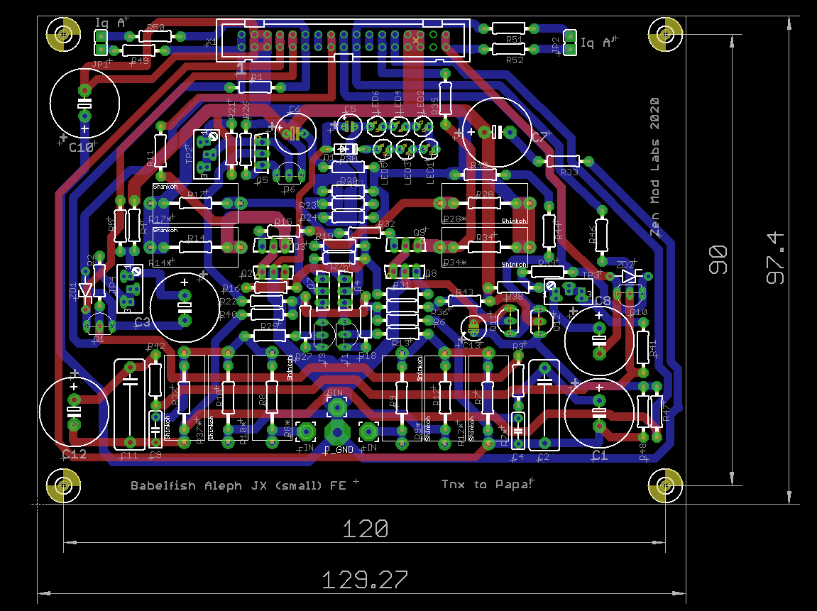

had some pcbs to order, so did final checks and tidy up of these, and they're ordered too
hope it'll not share destiny of fully populated Babelfish XA25 pcbs, waiting to put them on bench, for almost 2 years now :rofl:
