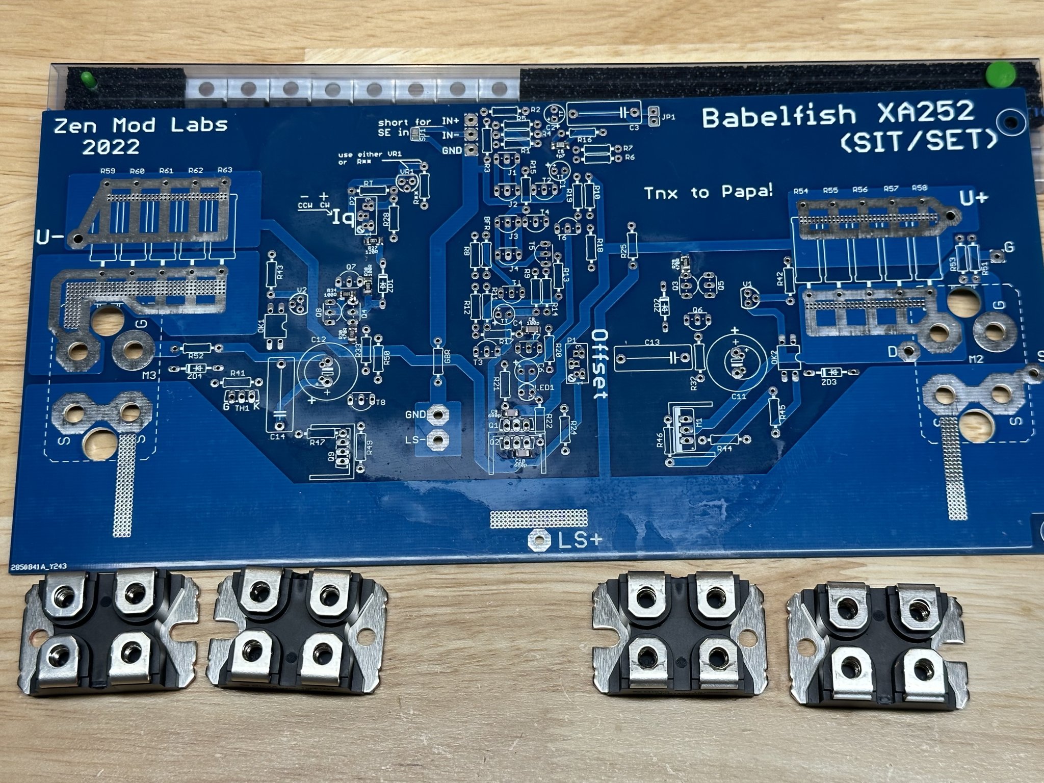

What would be the maximum power supply voltage for MOS version without schematic changes and maximum practical power dissipation per output mosfet (i have BIG heatsinks).

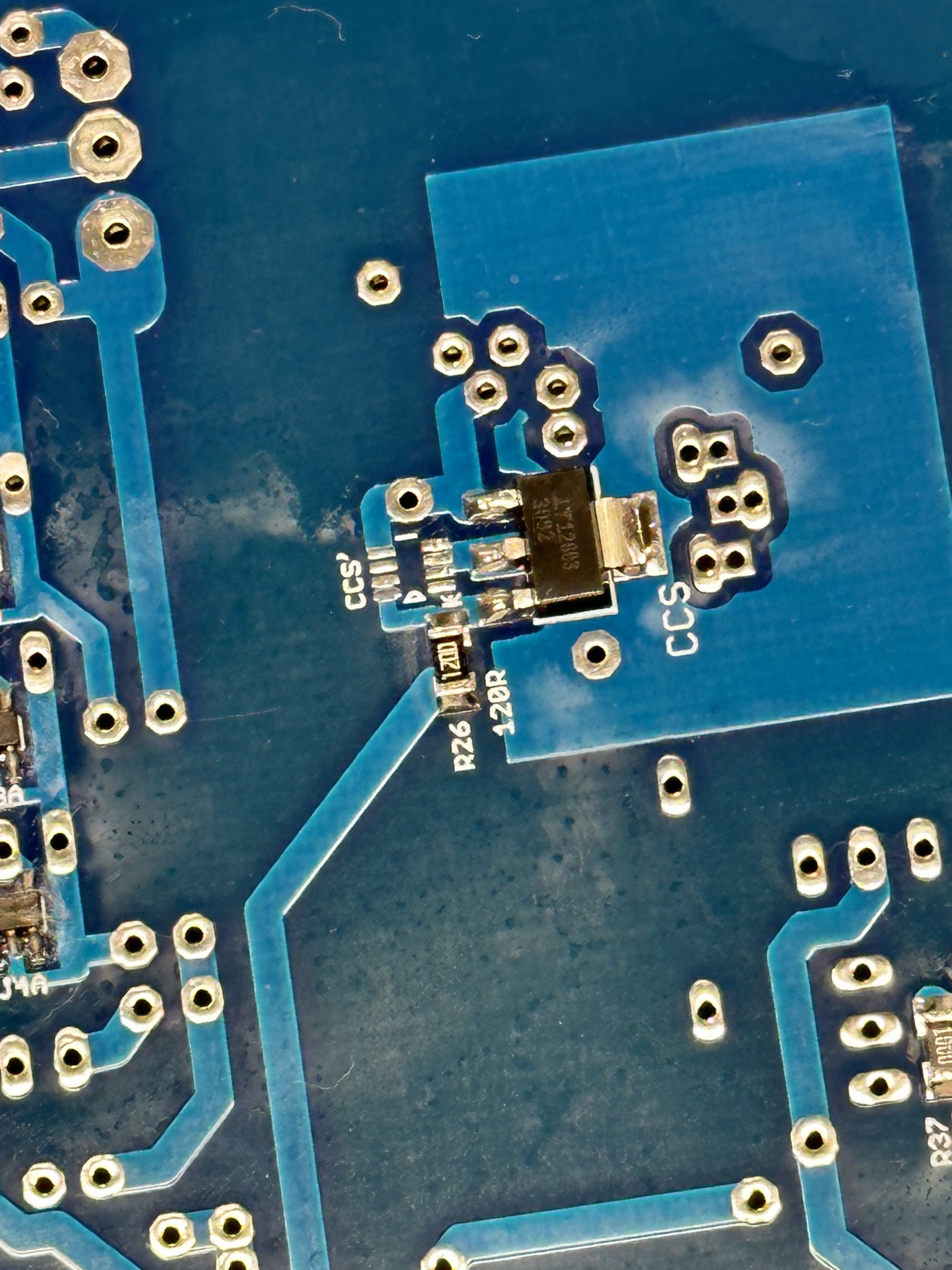

Good move to add another CCS package to future proof the design in these days of ‘here today, gone tomorrow’ parts inventory.

without any changes in parts values, say that you can go to 40Vdc rails
Iq, whatever your sinks can endure, pucks will do the job
though, how much you can set without change in bias circuit - dunno or don't remember
anyhow, to re-set that for your liking is trivial, change of one resistor near precision CCS
my advice - ya need bigger amp - build bigger amp
this one is perfect as is (Modesty ZM) - remember - Theme Park is PL XA25; it is nominally 25W amp

2A and 35v rails is good for me. I only asked because you made a comment earlier that implied the SET version could not go as high, but perhaps I misinterpreted what you said.
I remember saying that SIT and SET iteration are having less power than full MOS, which is completely logical, taking in account Wakoo nature of Wakoo DEF OS stage
rails are different matter, increasing those (significantly) is more or less just matter of work needed to edit few parts values and confirm everything in vivo
