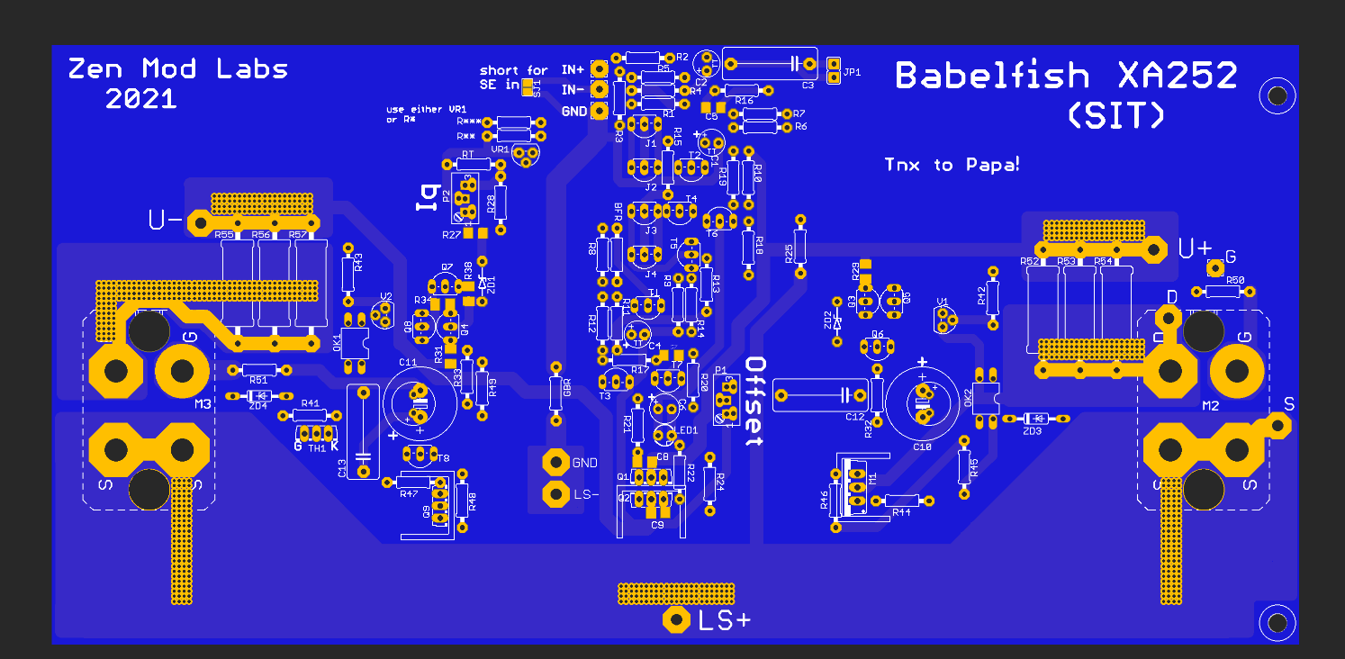

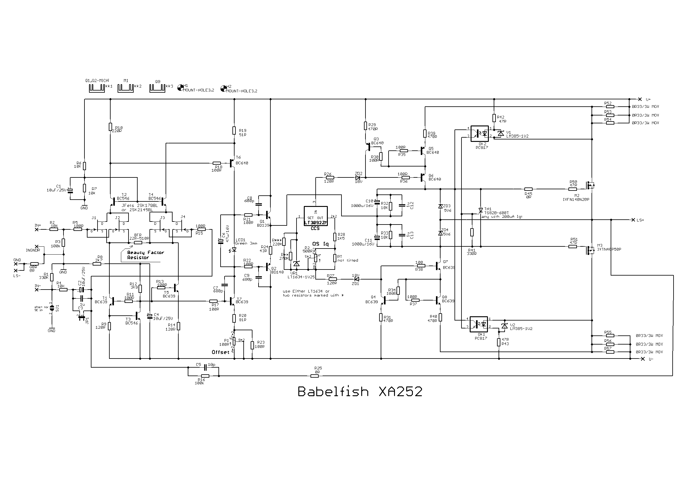

Find enclosed cumulative schematic, and will do edits of this post, if and when needed
OK1-OK2-TH1 .......... 10A limiting circuit, Savior of Our Souls, blatantly stolen from Pa 😛
amp is phase correct , Papa's fave gigglywiggly graphs sez that 2nd is negative phase
all measurements made with SE input, neg leg input grounded

separate schmtc for Full Mos, SET, SIT iterations, post #624
ignore notes on schematics about "do not mount" - just follow schematics
read all down for separate schmtcs, Extra-carefully made set of files, for each of 3 amp iterations

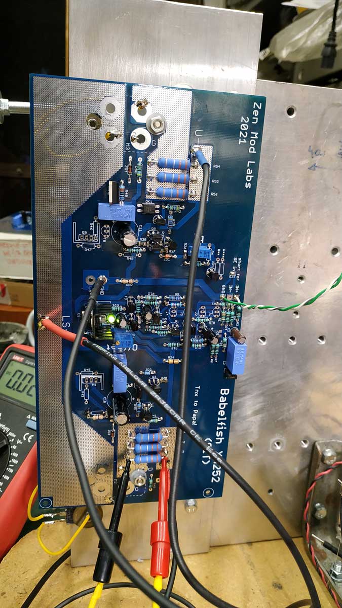

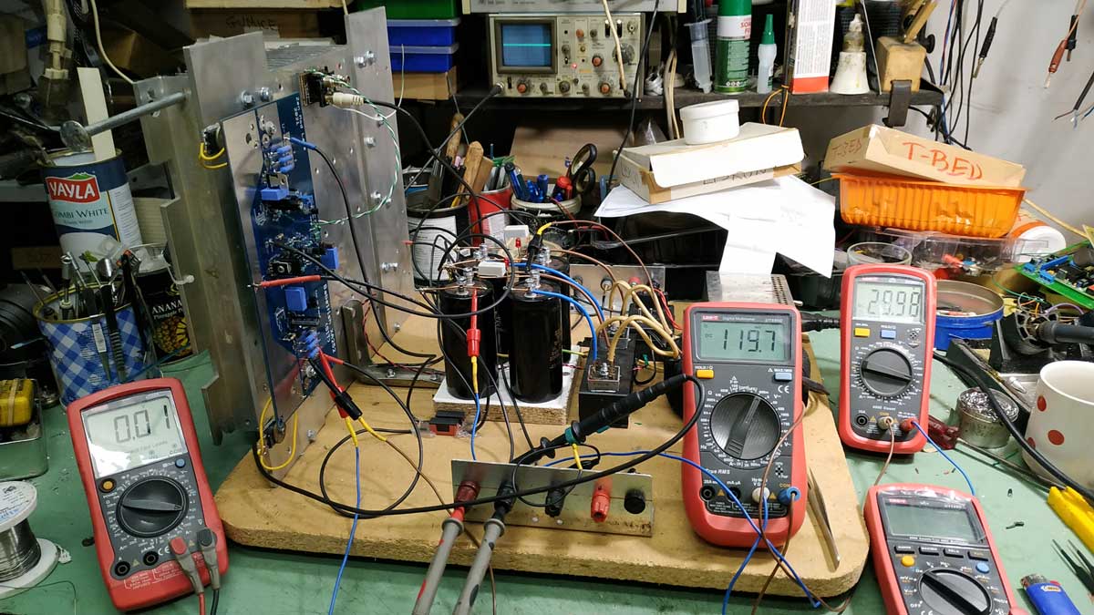

short setting procedure:
P1 is for DC Offset, P2 is for Iq
do not forget to have grounded neg input , presuming you're using it SE input, but also ground positive input, temporary
no load at output
P1 irrelevant for start how it's set
P2 set to max value - check with probes across unpopulated Rt, that one being in parallel with P2; that way pre-set is min Iq
I don't care for left-right orientation of trimpots - never taking care about that when making pcbs - too much times in my service work I
expected some logic with trimpots orientation, just to be confused and from then on, I'm just using DMM as guide
leave JP1 open for start
advisable to put temporary fuses in rails - say 2A
if you have variac, use it
of course, regular praxis - one DVM across rail sense resistor group ( + or -, irrelevant) - Iq observer
second DVM at output, offset observer
power up, have an eye on Iq observer;
DC offset for start - good even if few volts, but normal to expect few dozen of mV
now, fiddle with P2, slowly, to get half of intended Iq
observe DC offset is it still OK
give it time to develop some heat in heatsinks, then increase Iq to 75%
if everything is stable, close JP1 ( alive, no need to power off for that), try to minimize DC offset as much you can
if that is done, open JP1 ( alive, no need to power off for that), wait for some time to get closer to temp equilibrium, increase Iq to
final desired value
that's it
try few lazy powering off - powering On sequences, observe behaviour
if everything is OK, power off, remove temporary fuses, wire rails properly
proceed/repeat procedure with second channel

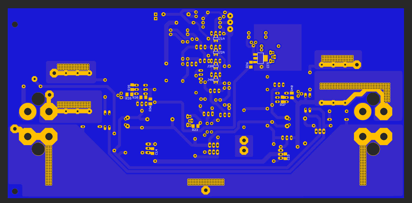

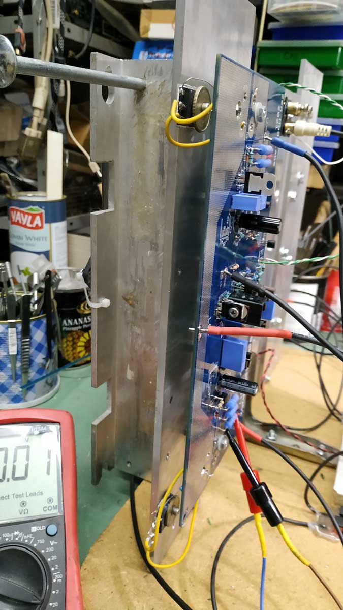

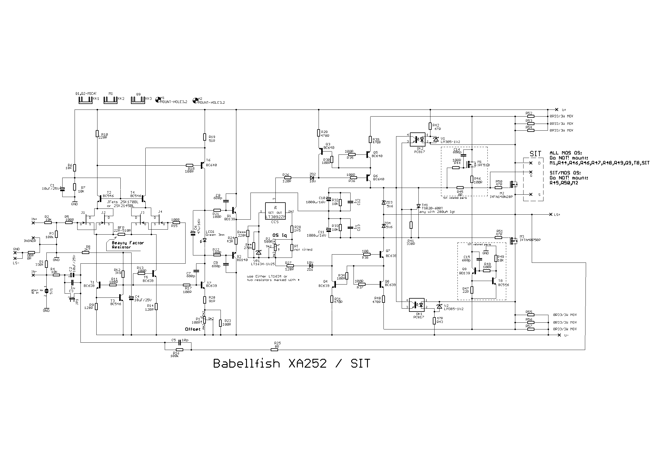

Now, for clarity sake, there is edited schm, parts needed for SIT iteration omitted
few more funny pics, too

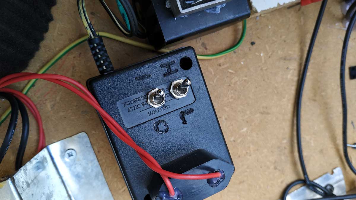

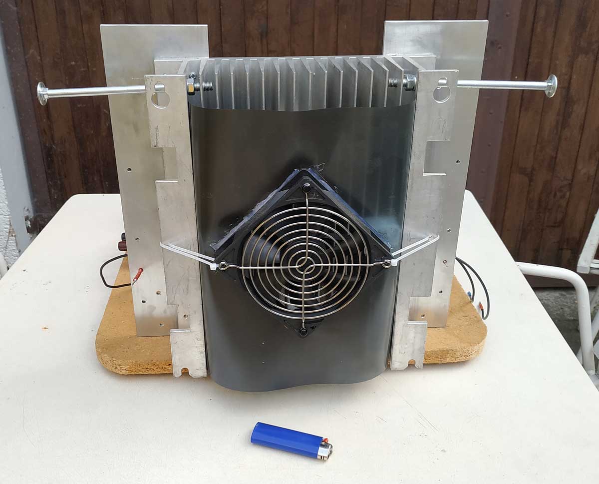

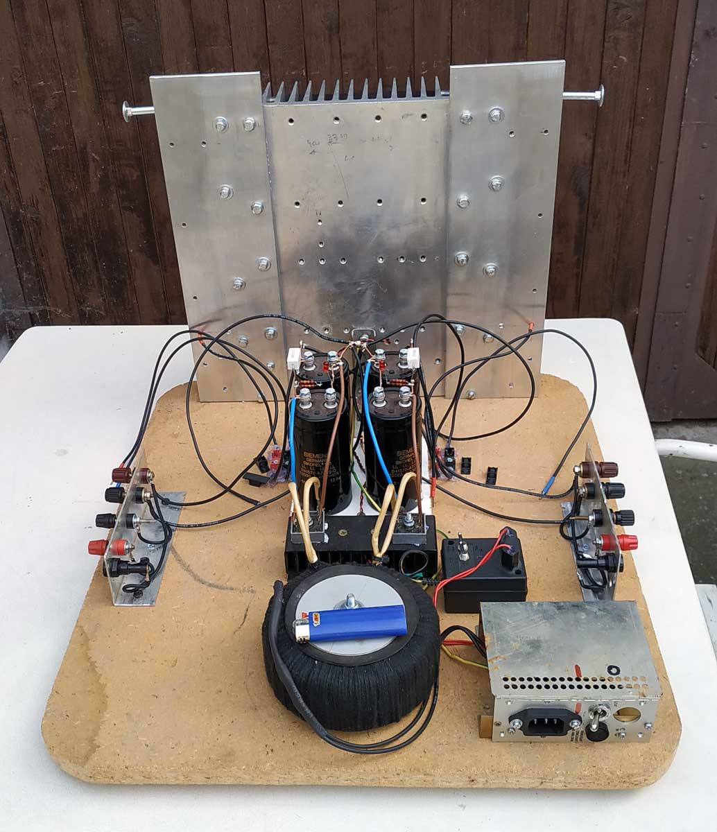

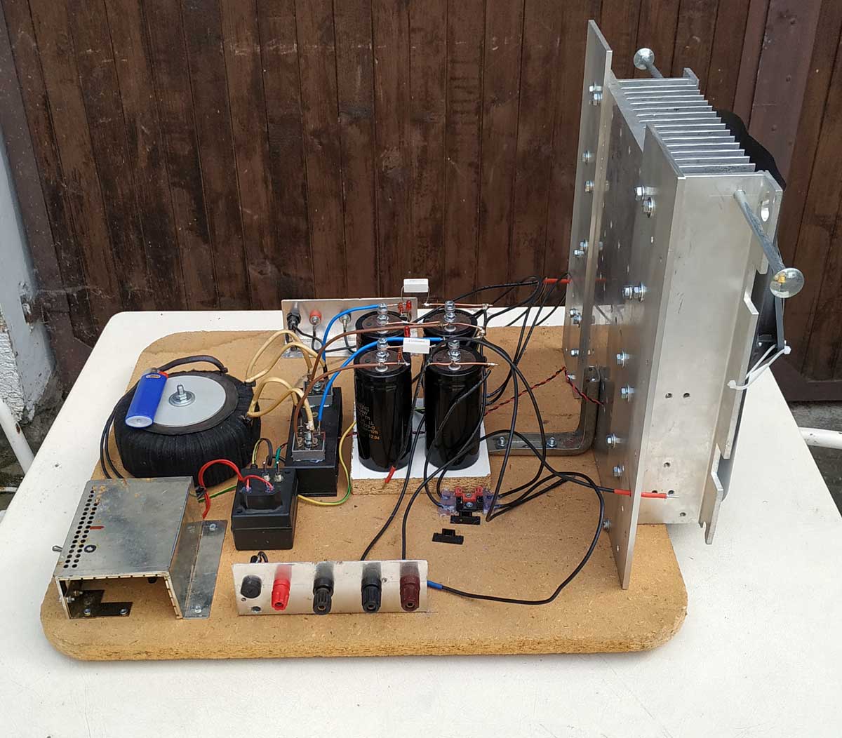

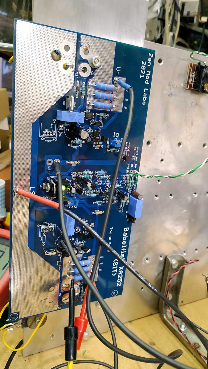

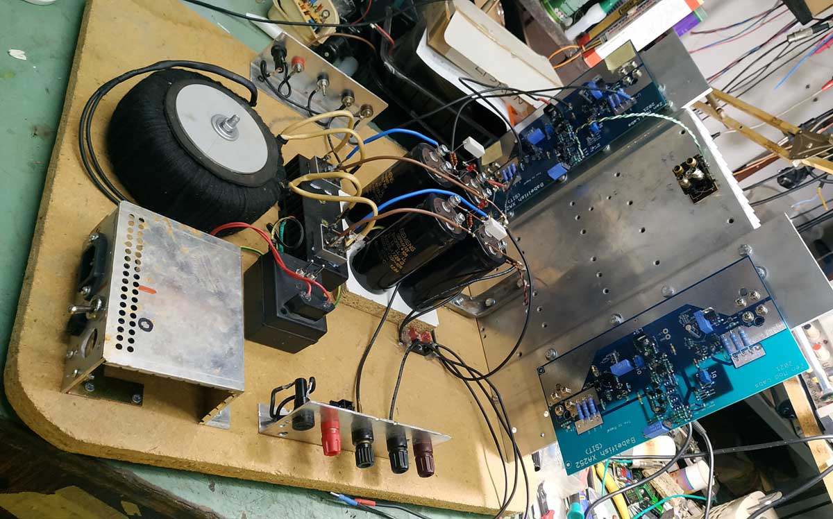

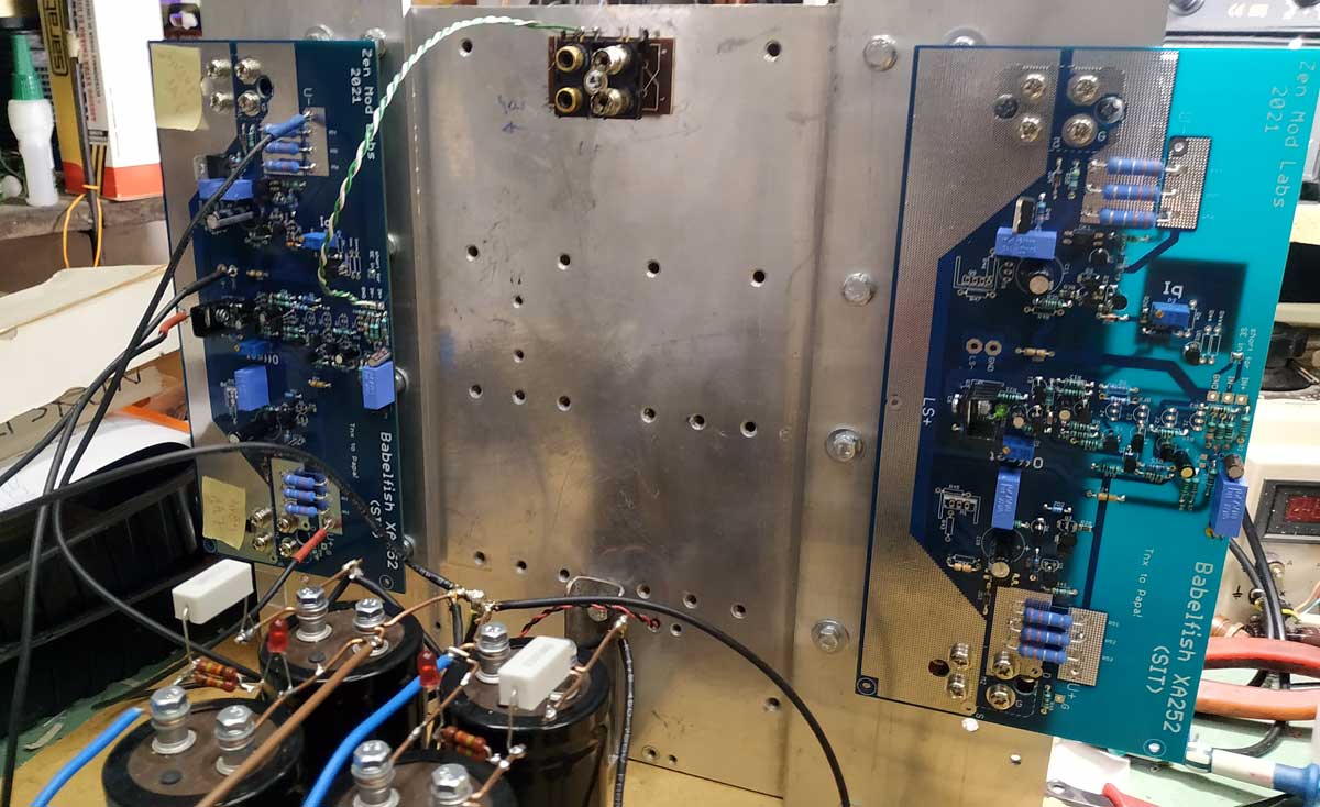

I did planned before to make it, but finally made T-Bed 2 , as proper cradle for prototyping this
from one of pics, you can clearly see that ZM is Chicken , executing first power up and settings with IRFP240/9140 and 2A fuses in rails...... did it with smallish Iq, and later - when I was happy camper, changed to Biguns

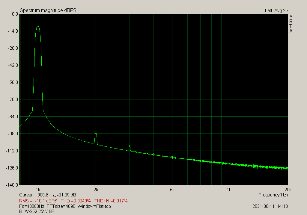

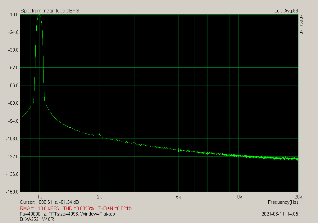

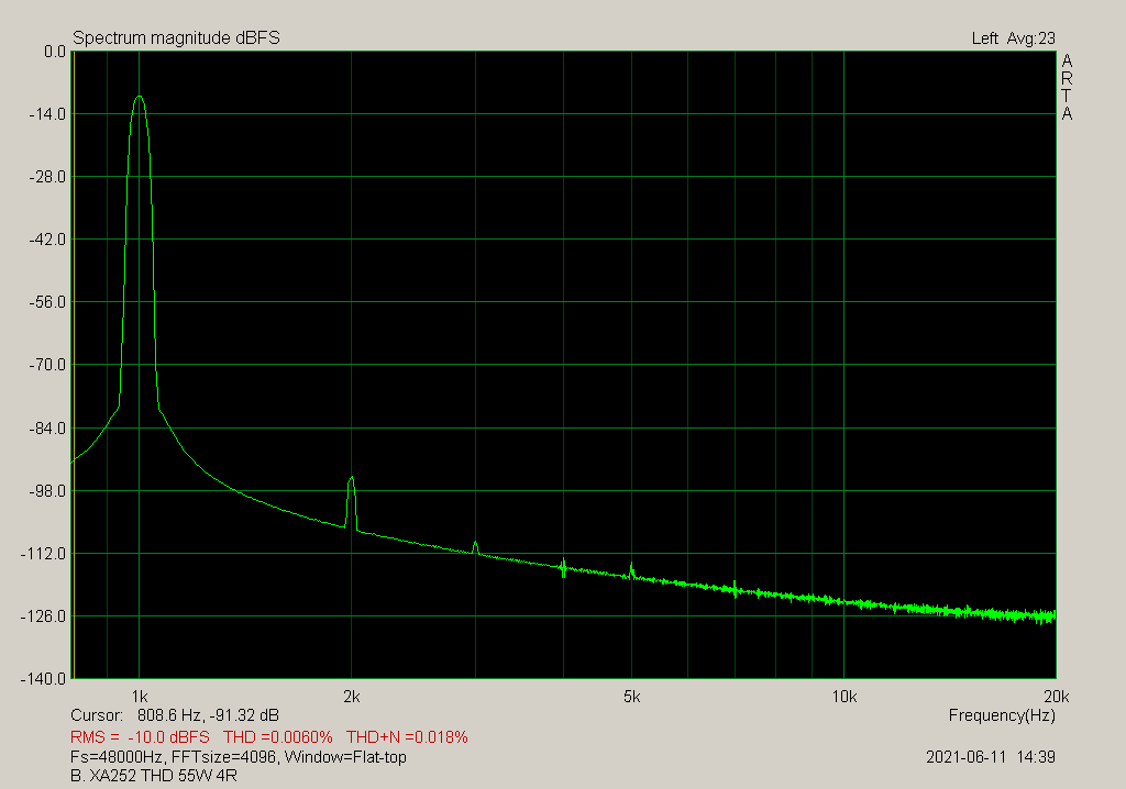

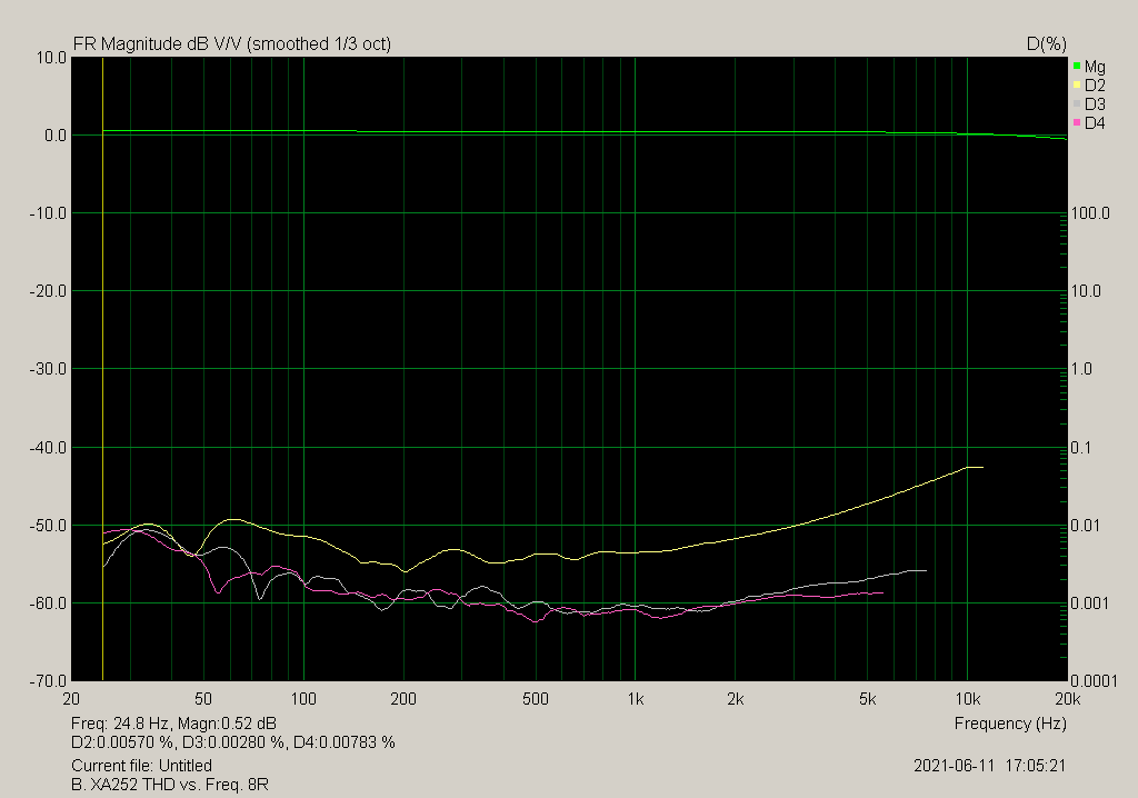

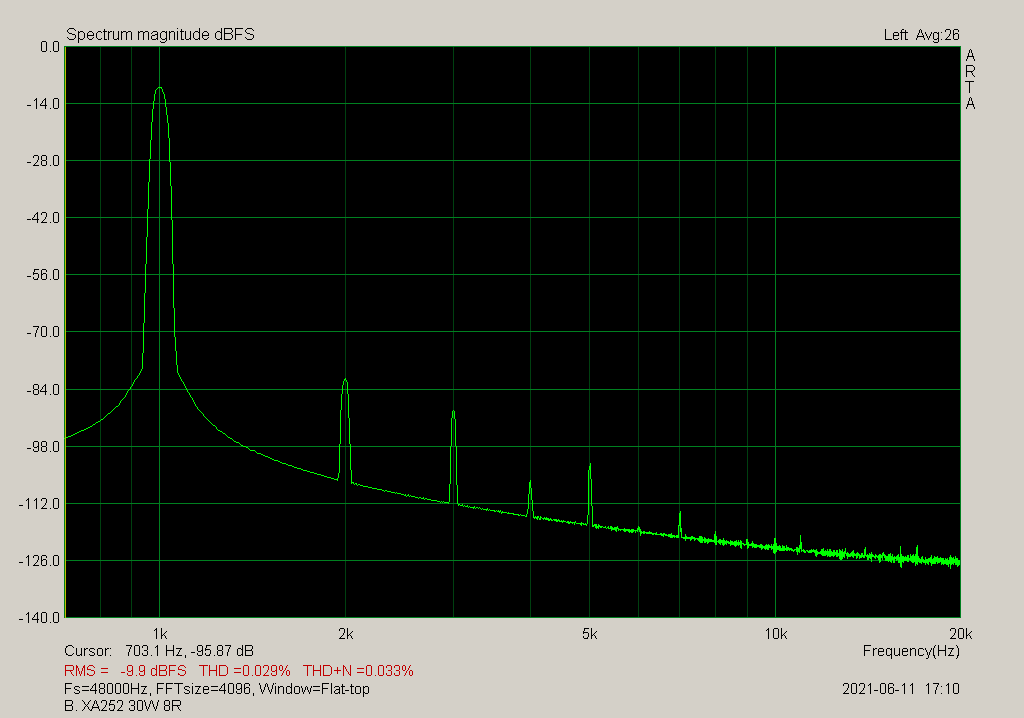

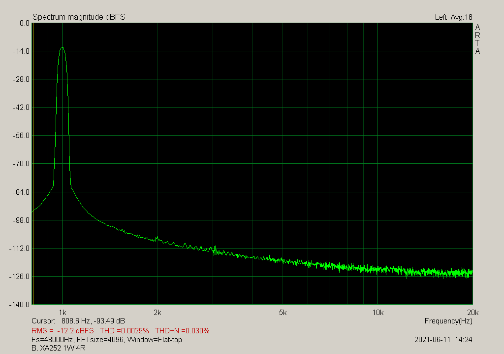

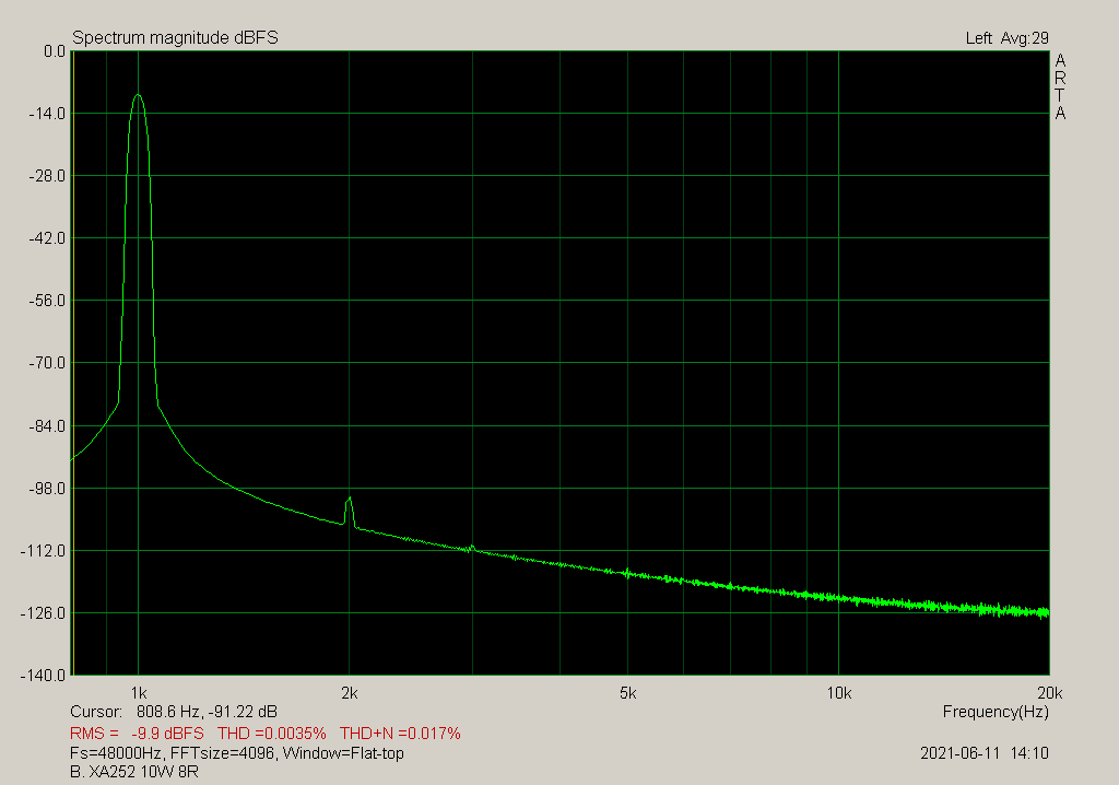

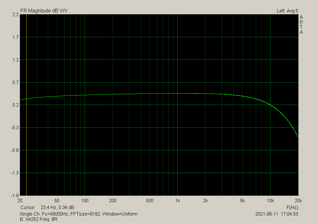

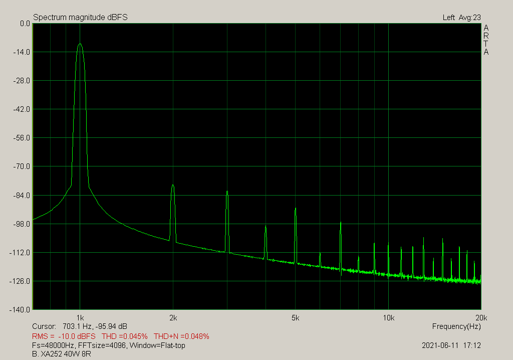

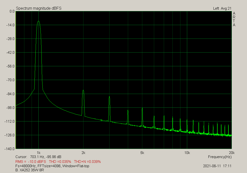

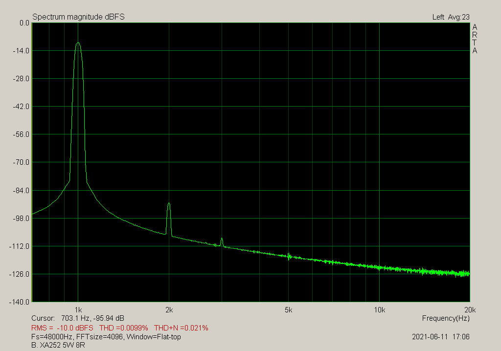

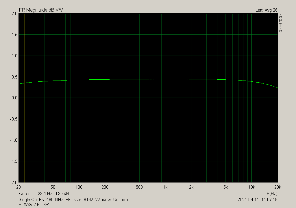

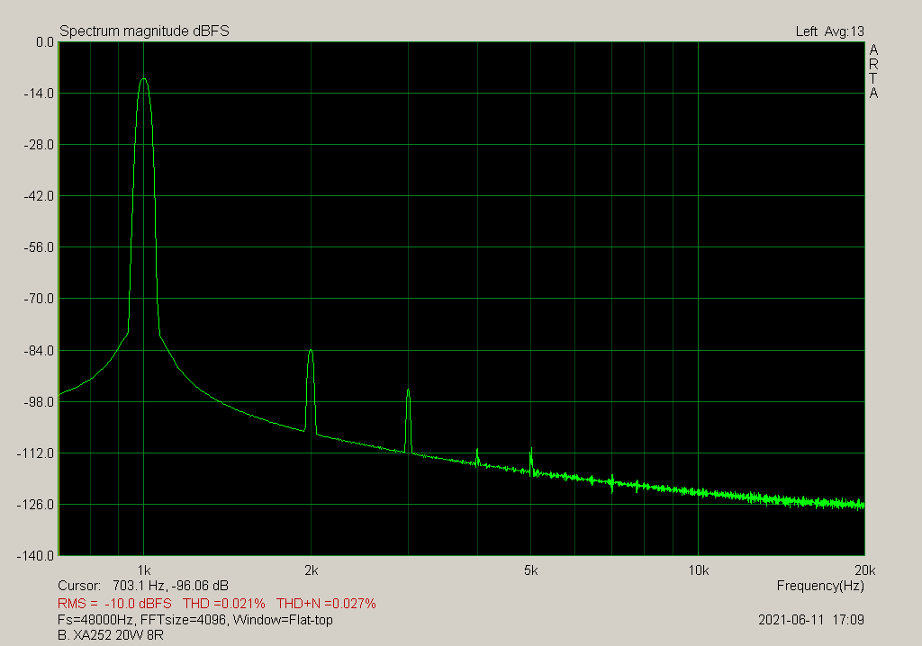

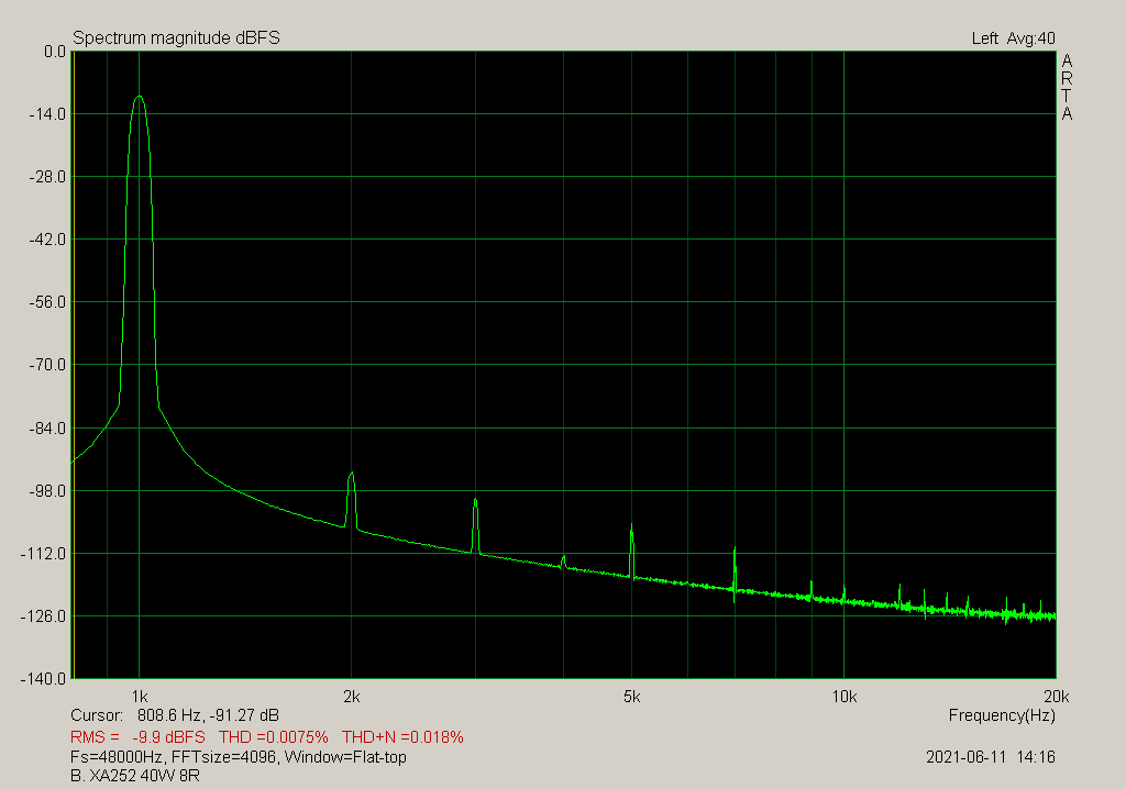

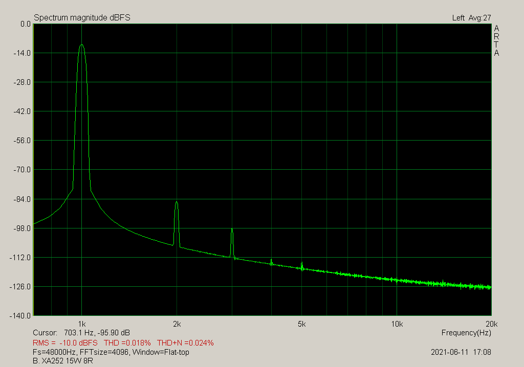

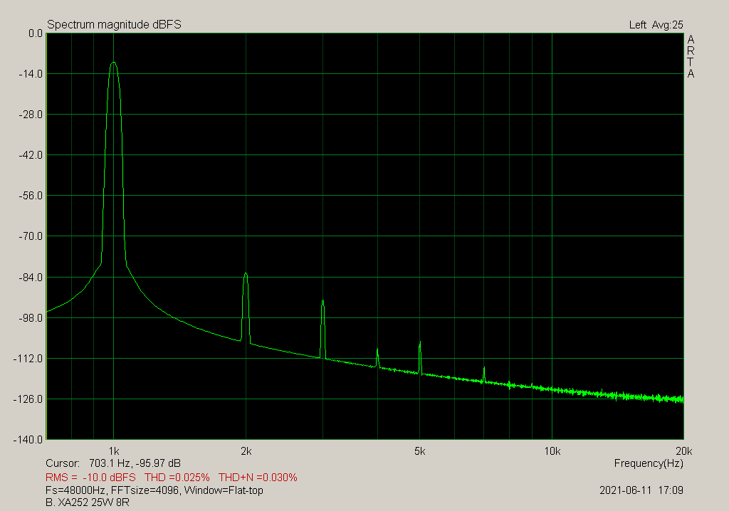

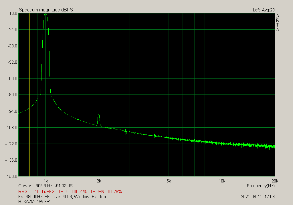

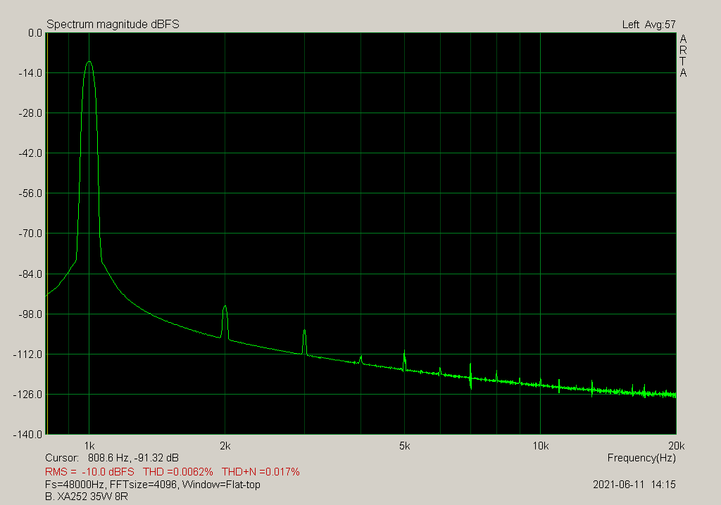

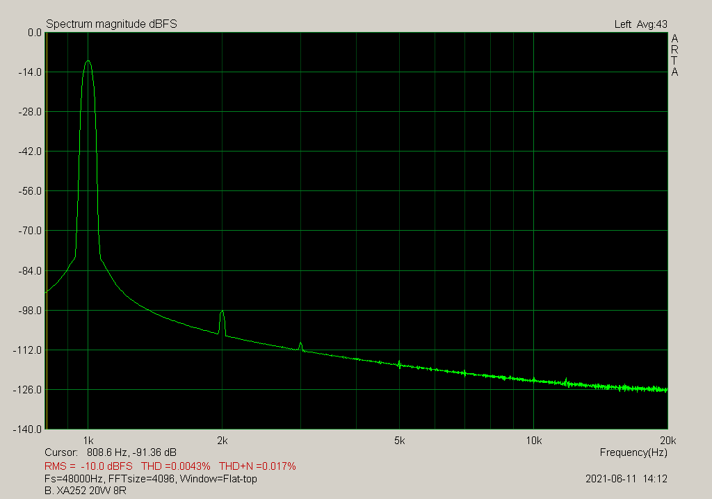

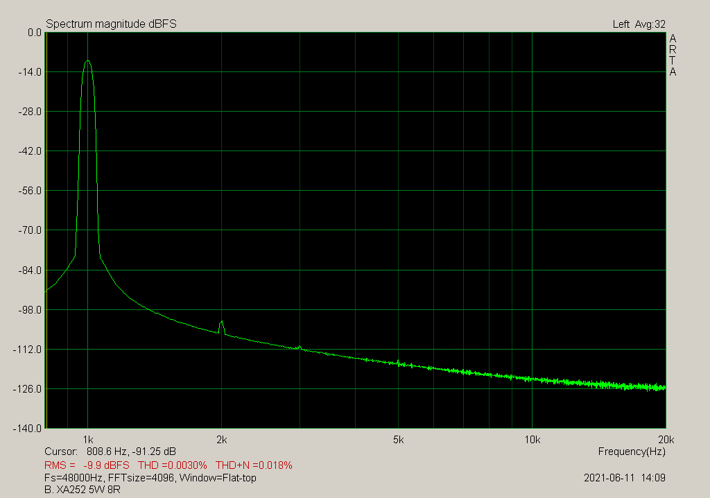

Graphs , 8R load, BFR=22R
FE is made as more or less basic LTP thingy; though, I did wanted to have possibility of altering THD level by changing OLG in simple and predictable way - which I made in also basic way - tearing LTP halves ( each halve having own CCS) and introducing common degeneration resistor ( practically changing length of effective Tail of LTP) , which I then named as Beauty Factor Resistor, short BFR
as you will see, changing value of that resistor is chhanging OLG, thus changing amount of overall NFB, and as result we have lesser or higher THD level
Luckily, Spectra is not changing, and that was a goal
now - set of measurements with highest possible OLG - BFR s 22R
Rails are 30Vdc ( amp projected to work with rails of 30-35Vdc with no changes)
Iq 1A7
DC offset and Iq practically not changing in temperature domain
While varying mains voltage (nominal 230Vac) between 200Vac and 255Vac - DC offset is changing some 20mV, while Iq is practically not changing
Good enough for me
Load for these graphs is 8R; each graph is having title captured, so you can see what/how much
Iq 1A7
Good enough for me

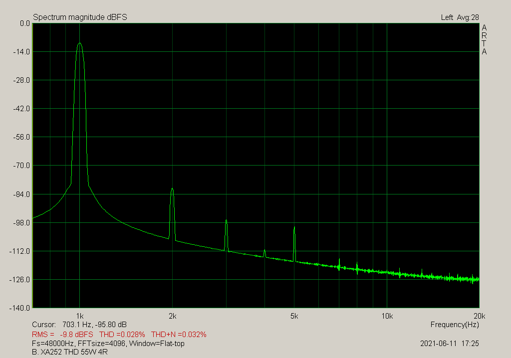

Graphs , 8R load, BFR=22R, continued
too many pics for one post, so continued
due to 30Vdc rails, clipping smidge above 40W
with 35Vdc rails, clip near 55W
who needs that ?
who needs that ?

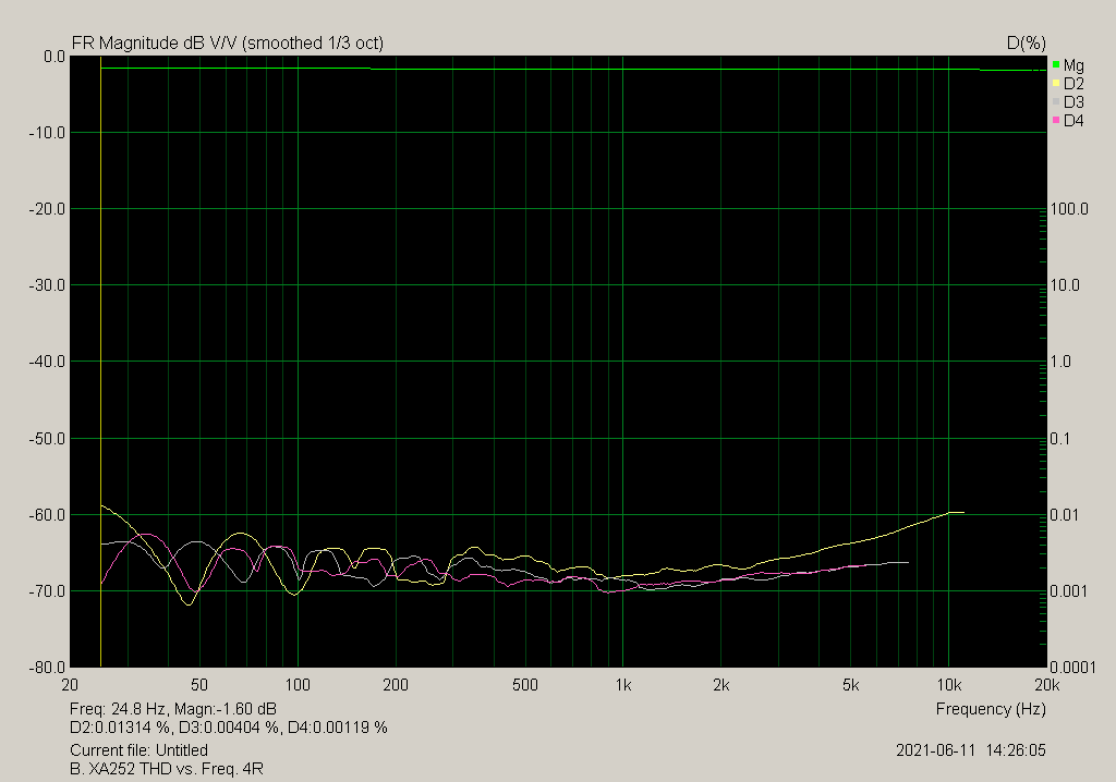

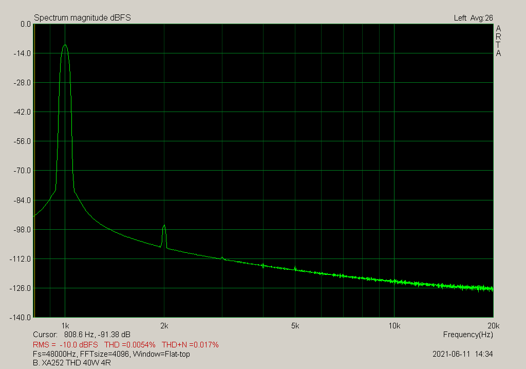

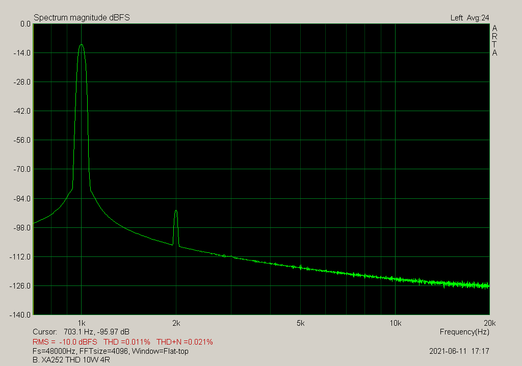

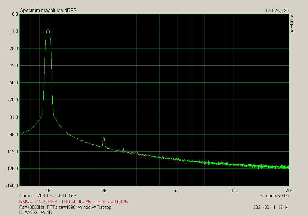

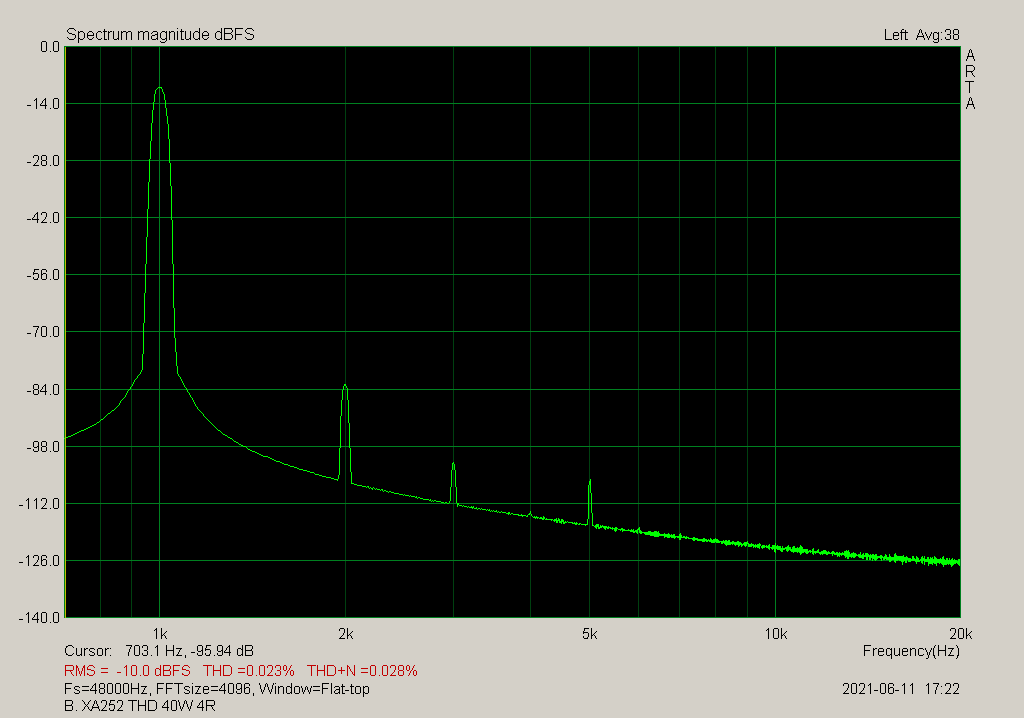

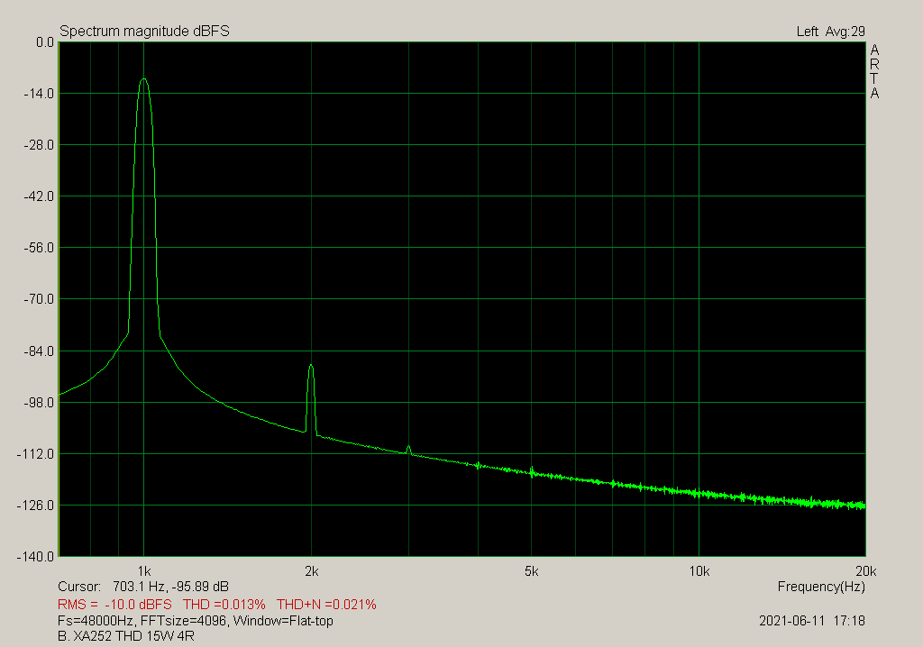

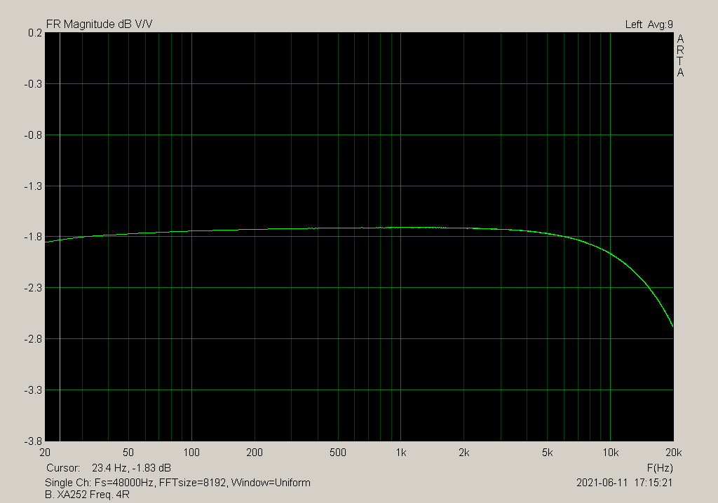

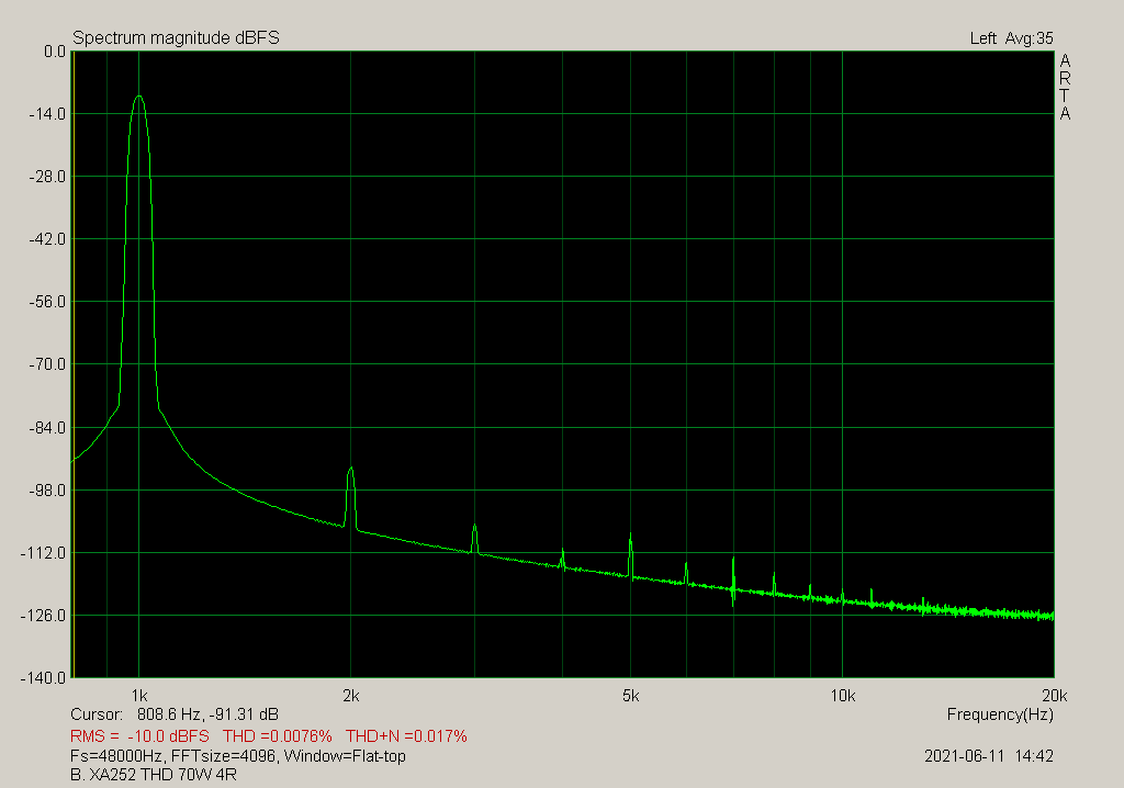

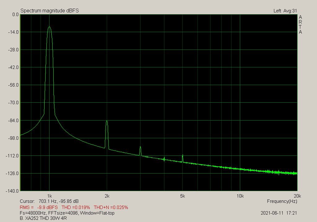

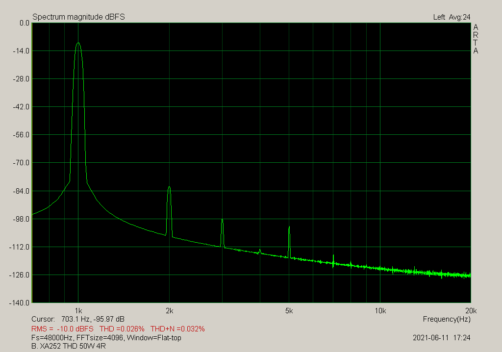

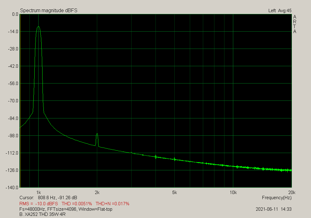

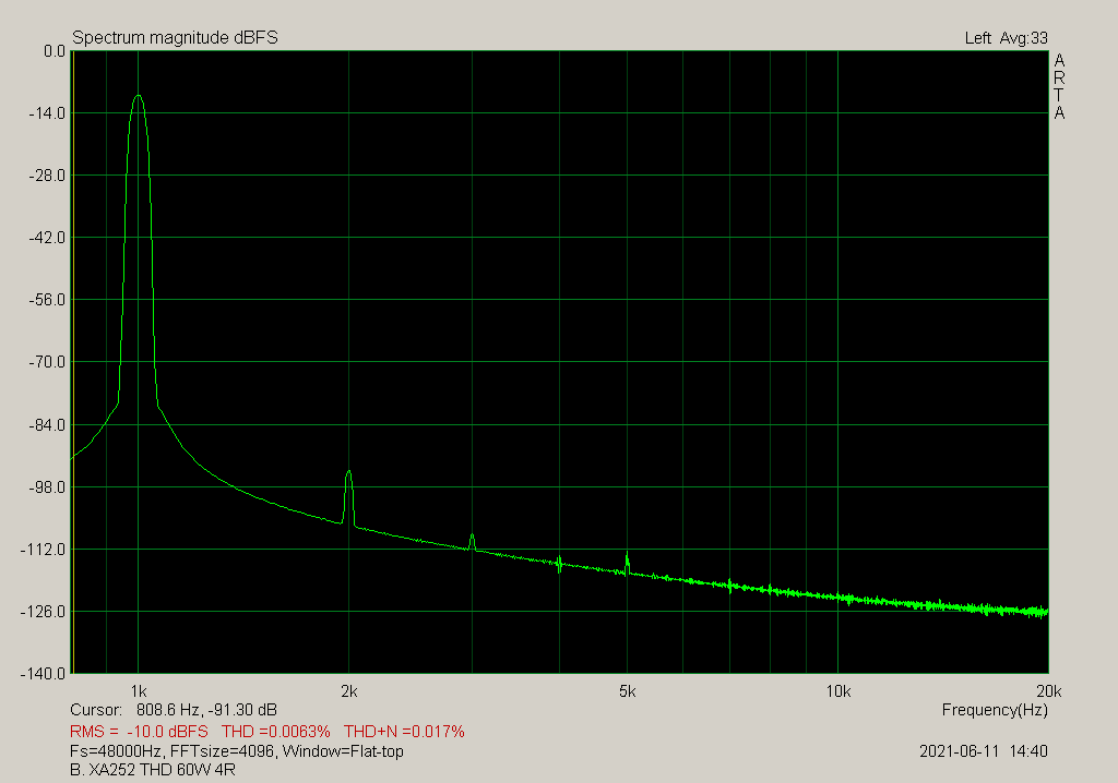

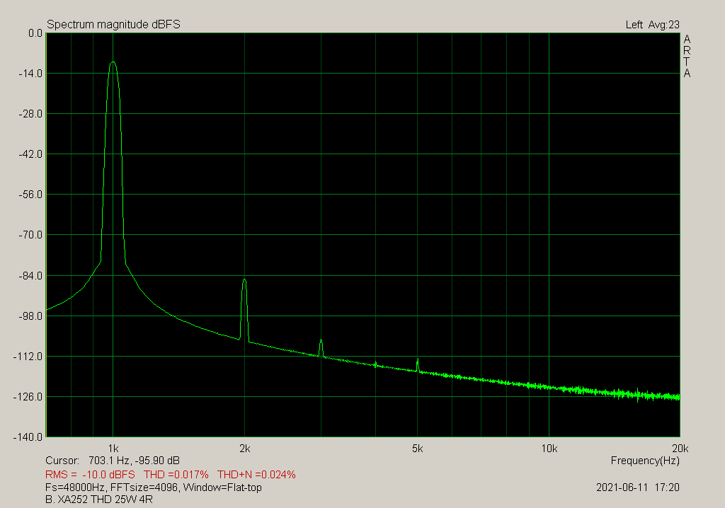

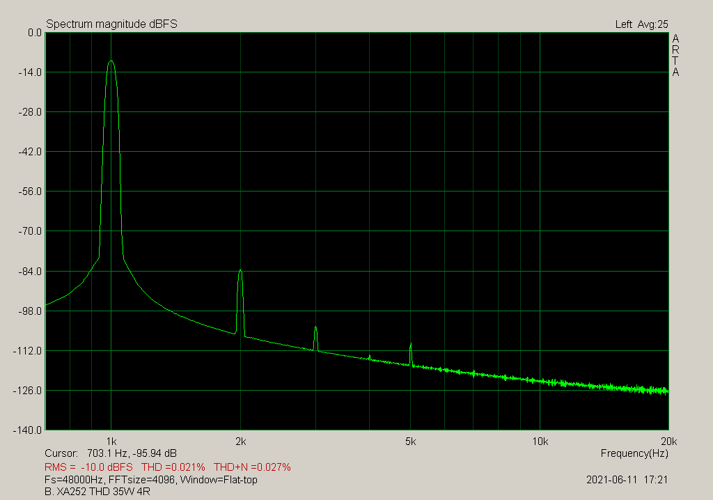

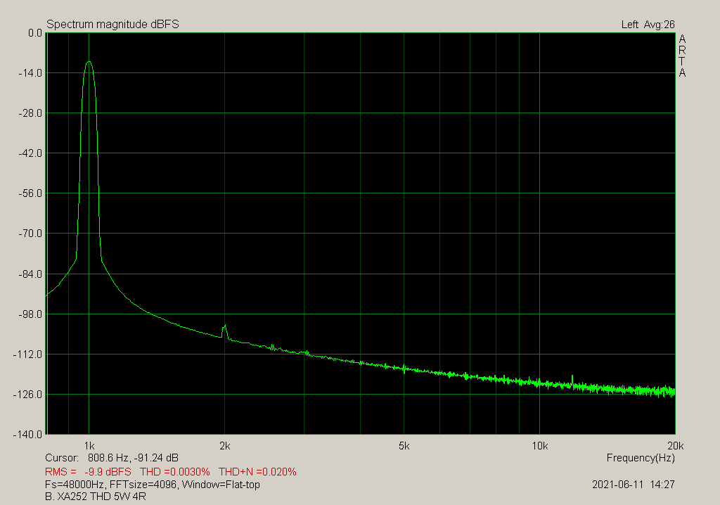

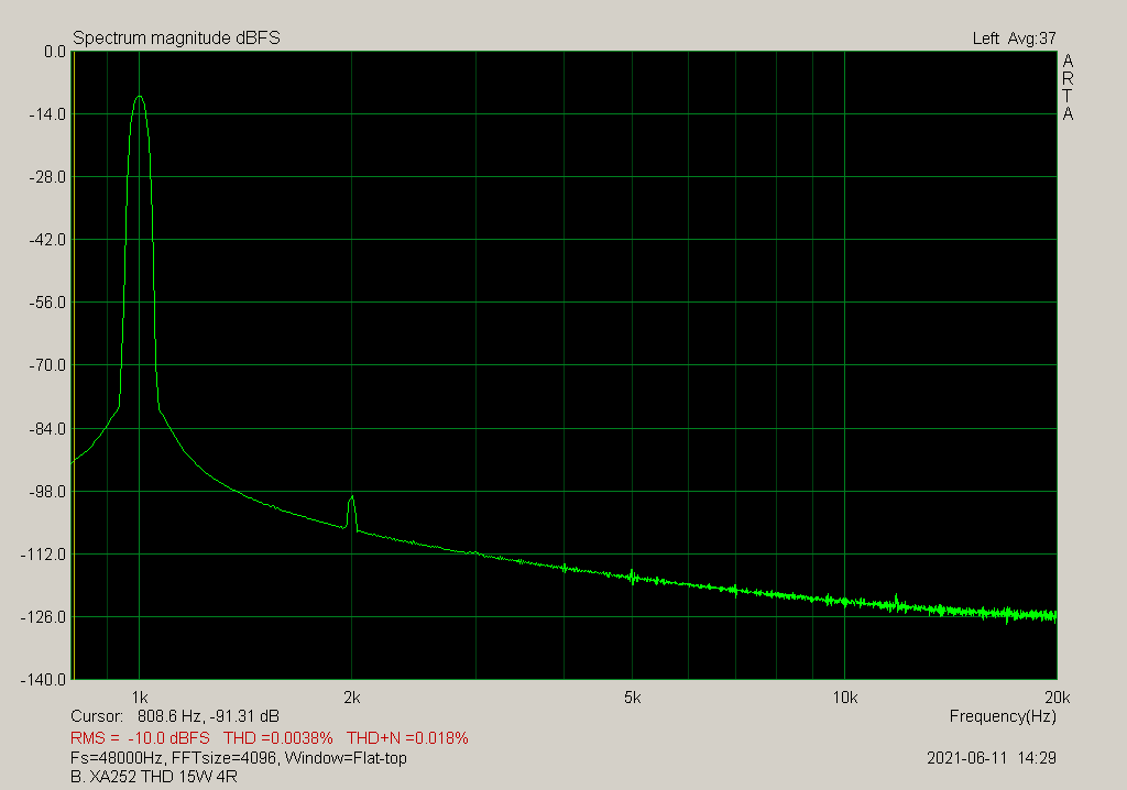

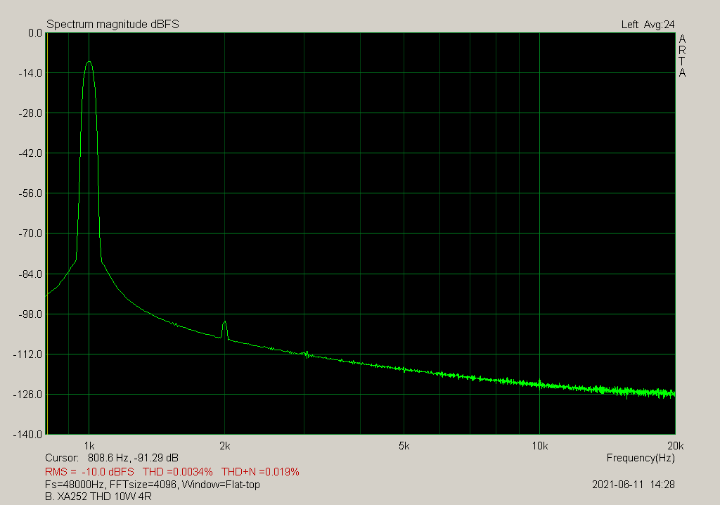

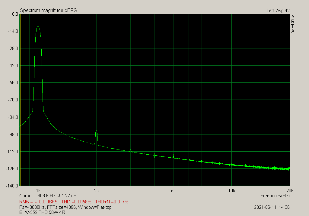

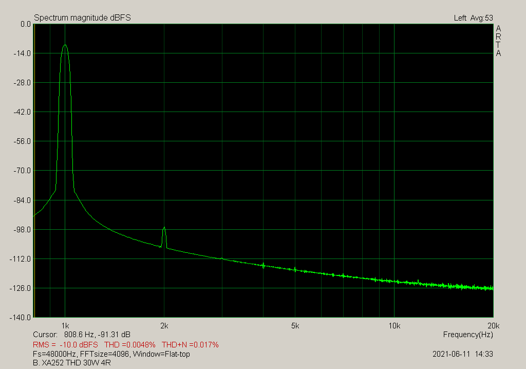

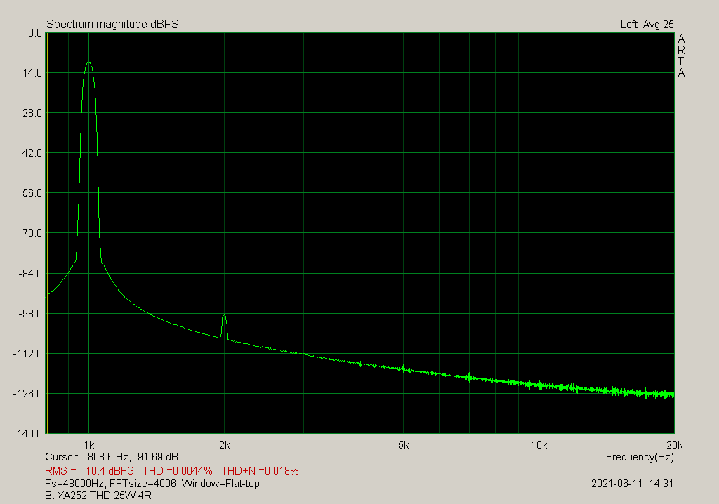

Graphs , 4R load, BFR=22R
everything the same, load 4R

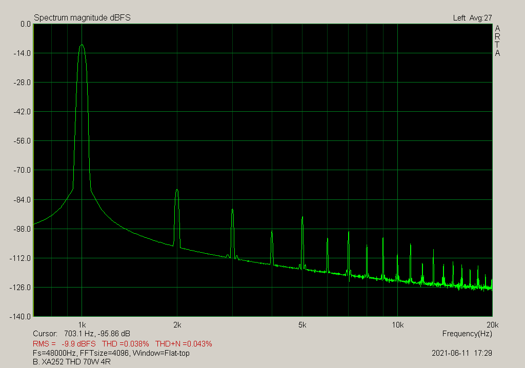

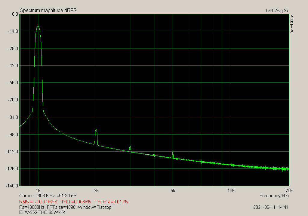

Graphs , 4R load, BFR=22R, continued
again
I didn't investigated where is bloody clipping
Meant that 70W is already enough
again

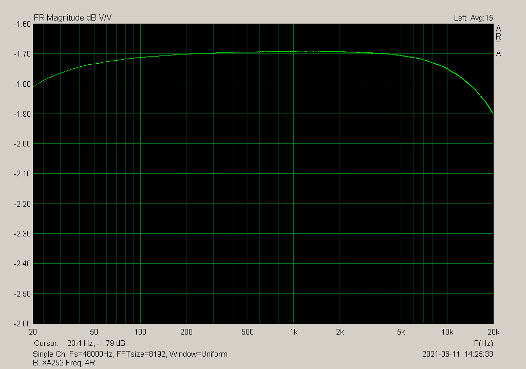

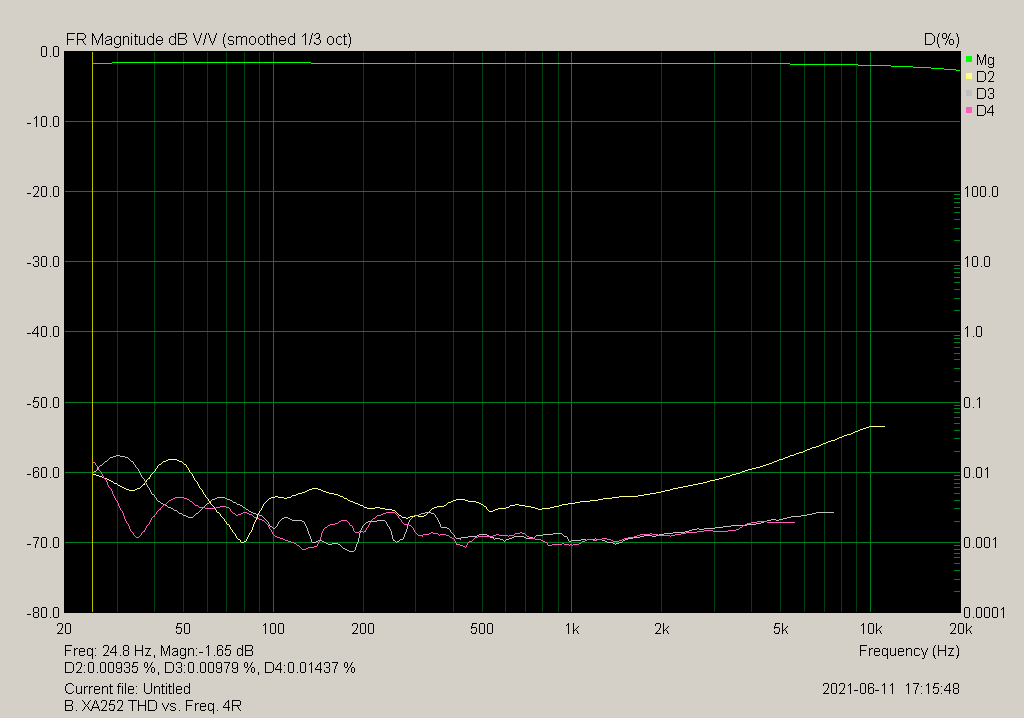

Graphs , 8R load, BFR=510R, continued
Everything the same, but BFR changed to 510R, that being opposite extreme to 22R - practically lowest OLG which I considered
Graphs , 4R load, BFR=510R
everything same as previous, load changed to 4R
Impressive - still lower THD at 50W into 4R than many measly amps do at 1W and it's still able to stay H2 dominant. Again, many of the ones I measures start to become more H3 at higher output.
Have you done any SIT testing yet?

Twitchie - I did made some listening - as always - decisive step should I proceed with some construction - with Ikebana style prototype, mono
Have some excuisite mono recordings, which I know damn well, and - if my foot is thumping and I feel like crying - that's it - damn thingie is worthy further pains
( lying, as always, there is no pain in this)
so - yes, I did listen and its worthy , but usual ZMAudiophooling commence tomorrow...... I mean , regular sissy stereo approach
well, it's spooky
didn't heard SIT iteration, but I have no any suspicion how it'll sound
so, few days of fun with full MOS, including visit to my Set of Spare Ears (hopefully tomorrow) then SIT tryout/presentation/visit to SSE
edit - no way to compare this Beast to Singing Bush Beast - really two sides of same coin ........ if you can call Coin territory marking same level of high quality
Iq 1A7 ...
Chance for redemption for all the failed F5T builds and won't leave dry taste in your mouth
That's also big consideration for building this over BAF 50W (or SB) is no need for 63+V caps but is it still possible to sound like big powerful SET amp?
Only MZM knows 😀
Big problem now is I will have to go find or build big horribly inefficient speakers to burn all those watts
Only MZM knows 😀
no, even if I'm sure that regular Greedy Boy is predestined to love both, these two are never going to sound, well, similar
breed thread is there, but difference in THD level is just too big ........... in fact, yes - this one can sound as big powerfulllllllll SET amp-cruising at 1% of potential
which, funny thing, is exactly how I think that Singing Bush is best used
impressive low THD+N at full power.
name of the game was to make Babelfish of XA25
so, that is it
