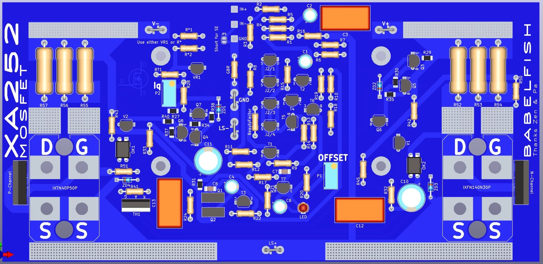

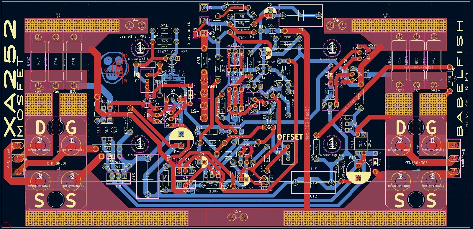

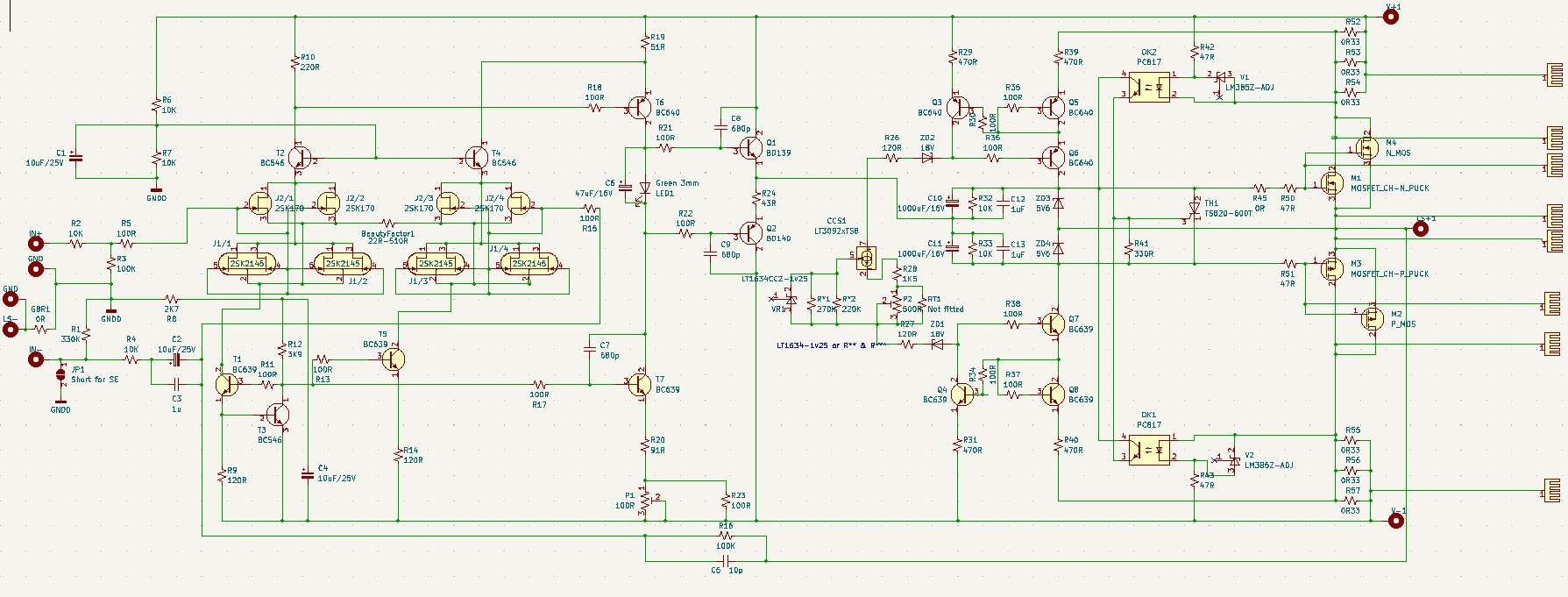

Shutdown behaviour is not very good, I am getting 3 thuds (not quite AJ thud level). I am disconnecting the speaks before shutdown until I work out what is going on. Have I made a Frankenstein XA252? I will post my KiCAD schematic and layout later.

though, in general - for good behavior it isn't just schematic, in some cases it is also how pcb routing is done
problem with my pool of knowledge is - it isn't overly organised, so I'm not exactly able to express what is important and what is not
in short - can't help much with pcb design, if it ends that your schm is correct

Hopefully it is a correctable mistake in my schematic. If it is my layout I will have to buy some professional boards designed by someone who knows what they are doing. I was inpatient and really wanted to make a XA252. At least my pucks and speaks have not blown up or caught fire yet. I only started DIY audio during lockdown and was bored (one good thing about COVID).
note in post #1
final separate schmtcs are in post #624
https://www.diyaudio.com/community/...2-sit-babelfish-xa252-set.373443/post-7206721
compare to these
I see at least one cap different
also cascode for LTP, voltage
will check later thoroughly
compare to these

well, I'm not really aware of any good comprehensive tutorial for drawing pcbs, even if there are certainly some and certainly good ones
as I said - from various reasons it is not easy for me to make any longer, while still comprehensive, tutorial on subject .... mainly because habits I have are result of years of collecting crumbs and forming ideas of them; my ideas - not saying those are proper, but they're certainly working for me
anyhow - some components you must spread due to thermal reasons ( say output devices)
if you can keep anything/everything close - keep it
differentiate power traces from signal traces
recognize all routes (traces) being susceptible to capacitive coupling; same for current pulses
differentiate GND routes regarding signal and power
differentiate senses
recognize routes critical to oscillations ( connected to susceptible ones above, but not only)
keep them all fatest you can
double power ones - to top and bottom wherever you can
etc etc
ground plane - who cares, as long construction isn't MC, MM or digital
how to learn PCB design - take confirmed and good project and study it; there are myriad of Papa's pcbs around - real gems with which you can learn what's important and what's not
I'm deliberately doing many things different, simply because I'm Chicken and I started doing my own pcbs ..... when - yesterday? ........ comparing to Papa

I used your page 1 schematic. I will get some new diodes, resistors and remove c7. I think my c6 is 47uf, I will double check. Thanks again.
Hopefully it’s the underrated diodes causing the weird turn-off behaviour. Both boards do it in perfect sync. The AJ is back in until the XA is sorted.
zeners 22V are there to keep voltage across LT3092 in safe range
Vmax for LT3092 is 40V
if rails are 35V, that's 70V window
5 volts or so across CMirror transistors and all series resistors
1V2 across 120K reference resistor
less 2*18V zeners, ends with ~28Vdc
using 22V zeners means ~20Vdc
not critical at all, did put them on above list as difference to ref. schm
frankly, voltage of cascodes being first thing possible to make difference in behavior, if culprit is in schematic and parts values
