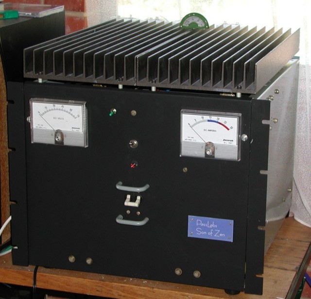

Wow 😯 Flying Furnace looks amazing! How much does it weigh ZM?
frankly, forgot
case is in my workshop storage room, not moved at least 3 yrs or so

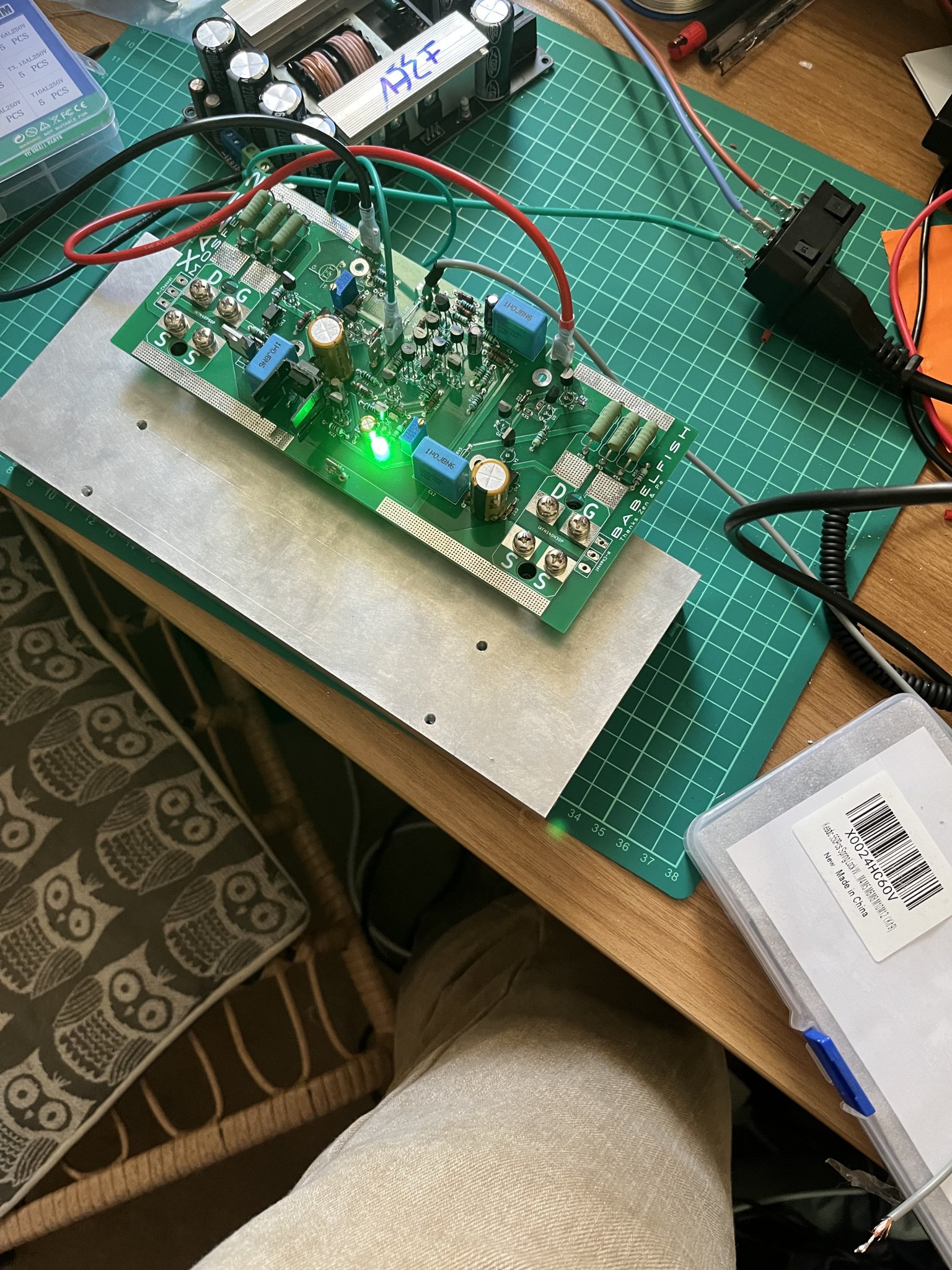

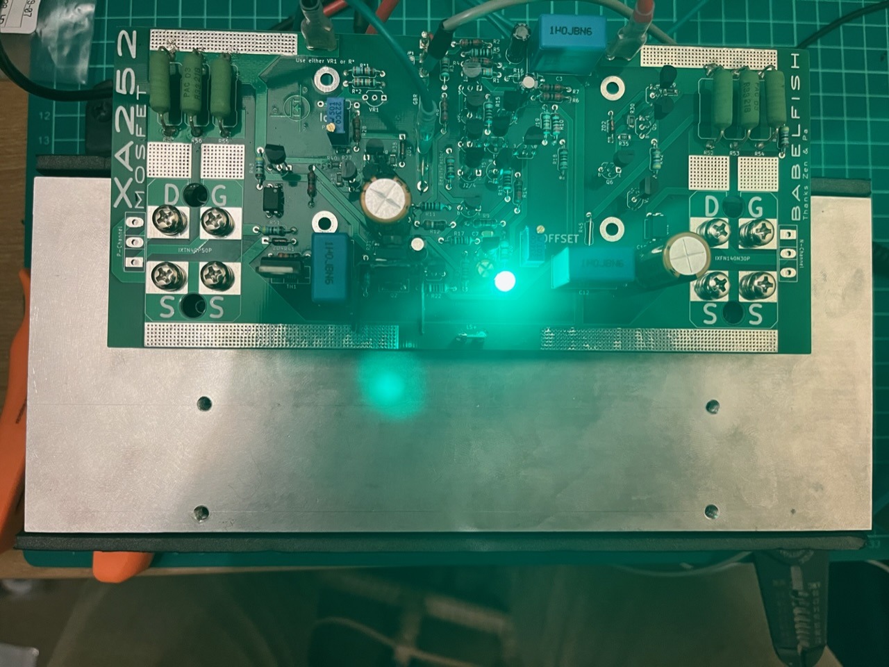

I just needed to solder the green LED since mid December to finish the board but had a few other problems to deal with. I got round to it today and powered up the board. A green light and no magic smoke 😊 I will set the bias and 0v tomorrow.
I see you implemented TO247 pads, just in case
with those, you practically have Plethora of Pinjatas amp
They were for testing but went for the big guns. Would I need to change much to use irfp150’s?
well, IRFP240 (or IRFP150, if you want to play with THD Spectra) up, IRFP9140 down
no other change than rails down to 24Vdc, Iq no more than 1A8
everything as explained in link above
