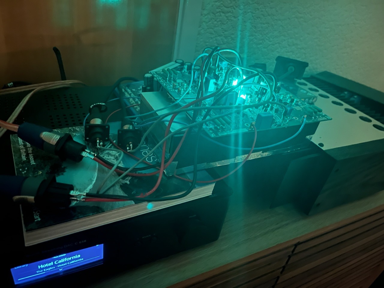

Wow wow wow. It works, and sounds superb. As sweet as my AJ but has much better control of the bass and this is a low level test (daughter is asleep). It is running at about 50c. Thanks ZM, fantastic work.
I was worried about this one. It is the second amp I have made from a circuit diagram and also my second layout.
Yes it is the mosfet only version. Had a listen to The Eagles, Fleetwood Mac, REM and Ali Farka Toure so far and they haven’t sounded so good. Only running the boards at 1A each, I am surprised a 250x100x38mm heatsink can keep up.
I will definitely crank it up. It is a real foot tapper. It is a step up from the AJ which I love and sounds amazing. I was not sure what to expect with such a small 2nd harmonic but you are right that as long as it is there. I used the 0R22 BFR thinking I might want to change it but at the moment I don’t.

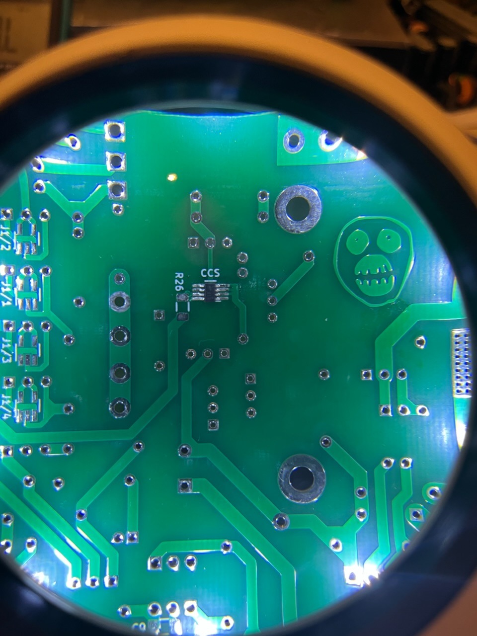

way of preventing later troubles is to check CCS solo, mounting IC and associated parts first
then you can use even 9V battery and mA-meter, connecting that inside of series zener diodes
if it shows few mA and responds to trimpot, then one worry less
