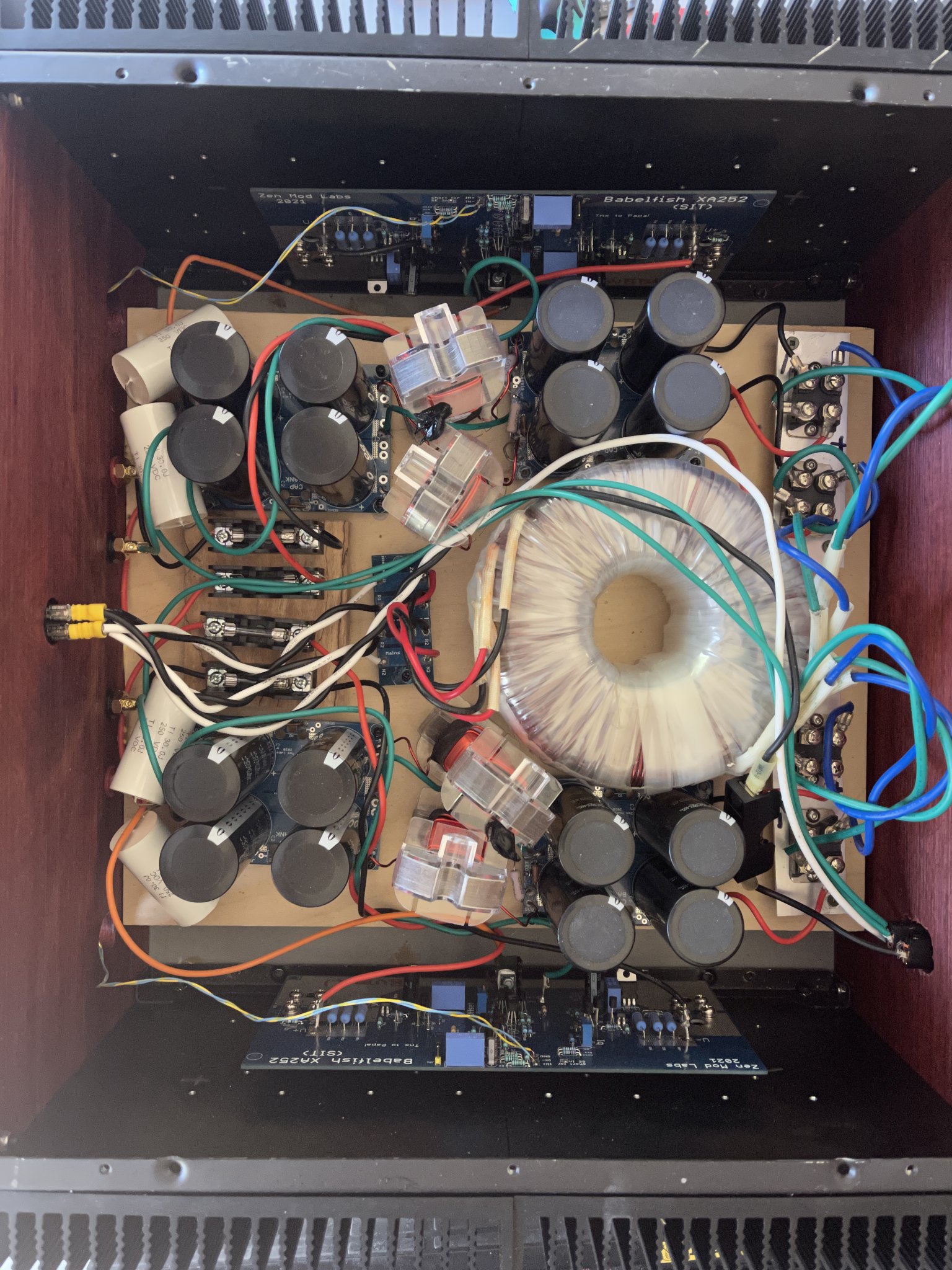

Zen Mod,
please specify transformer AC voltage and current for 35 V dc rails and Iq 2 A
I plan to use dual mono setup
per channel:
Donut 250VA (or more), 2 secondaries of 28Vac each , so using one bridge per secondary arrangement, having established GND after bridges
that resulting in 35Vdc rails under load, Iq anything from 1A5 to 2A, depending what your heatsinks can cope with
cap bank; CRC per rail , 22mF - 0R1/5W - 22mF , where 22mF is minimum
for 35Vdc rails, 40Vdc caps, or higher

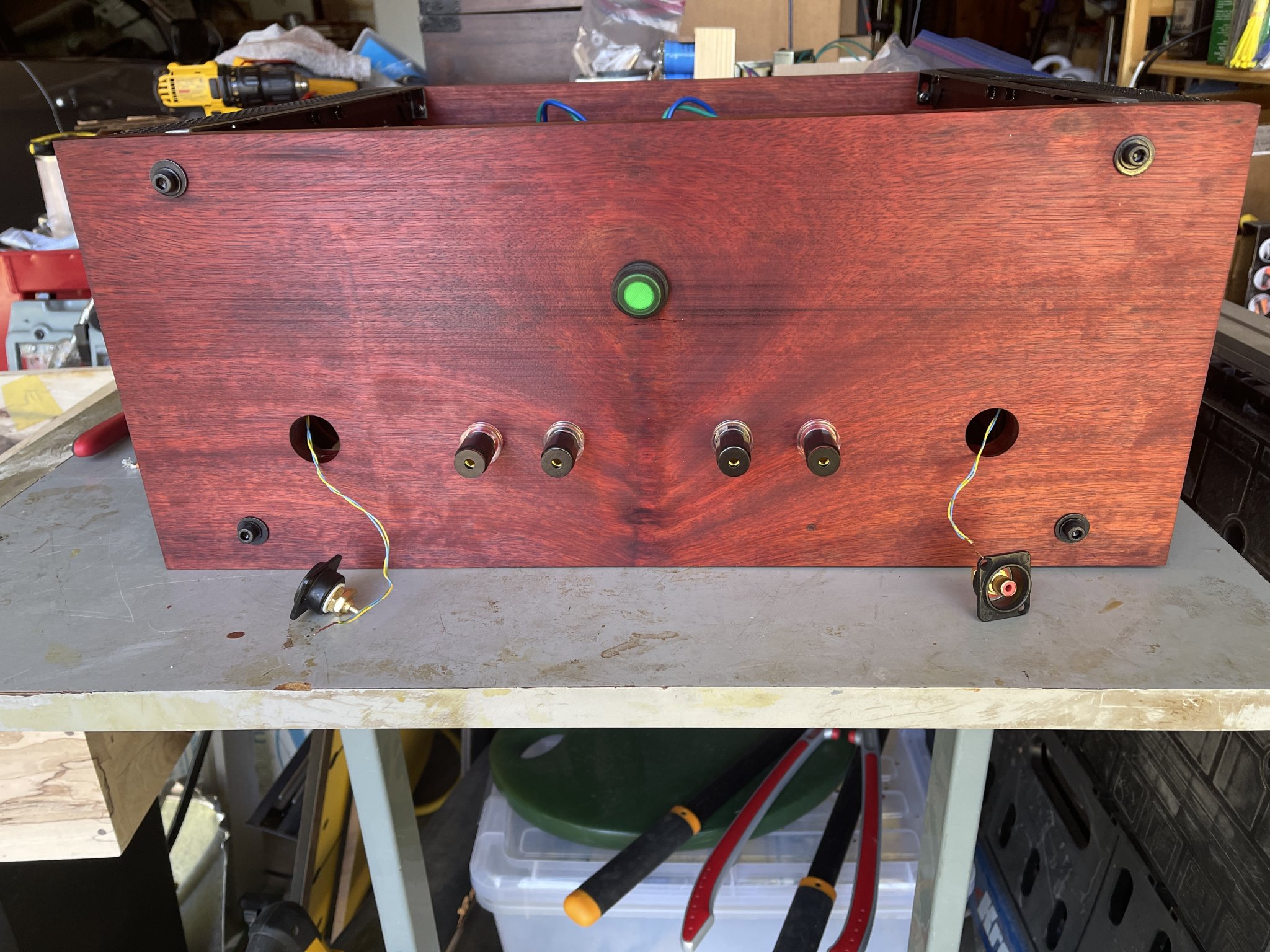

Are folks starting to build the XA252 now? Looking forward to seeing some fugly builds & impressions. 🙂
Hopefully soon if customs decides to release the goods.
Big chassis is waiting…. 😜
Bubba, did forgot to ask - how hot are those IXYS diode bridges?
if you can keep your fingers on them after 2h of work, good
if not, more hsinking needed
