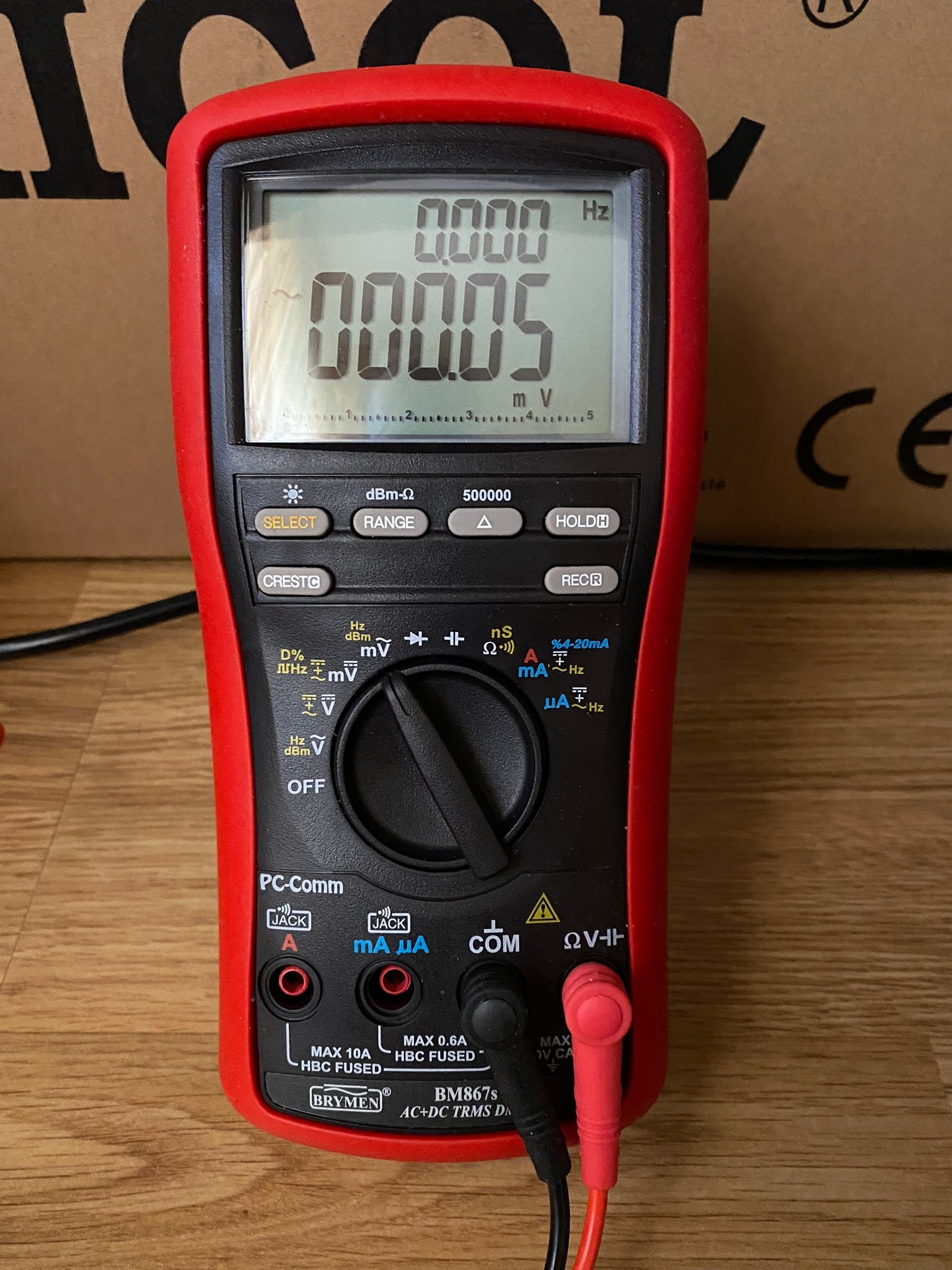

I don`t recommend using your computer to attenuate the signal, when you do that you attenuate only the signal, the noise remains the same. Just keep this in mind. Also at very high levels of attenuation the dac introduces some non linearities.
Best is to set the pc at -3db to -6db of attenuation(doing this the signal you get is no more bit perfect) this way you are sure the signal gets out unclipped and use the volume control on the preamp to do the attenuation.
With my amps I get 50-60uV of noise on the output with the preamp and dac connected and the volume adjusted for no attenuation.
If you can(if you have the gear) measure the thd with only the dac connected and also with the dac and preamp, you can see quickly the difference why you like one over the other.
Yes, the computer attenuating digitally is not optimal. The noise floor seems very very low. I plan on building a passive preamp as mentioned above. I am thinking, I have a salas in-select, and a Khozmo stepped attenuator. I have been wanting to have a single nice separate volume control for different lineages so this may be my excuse.
