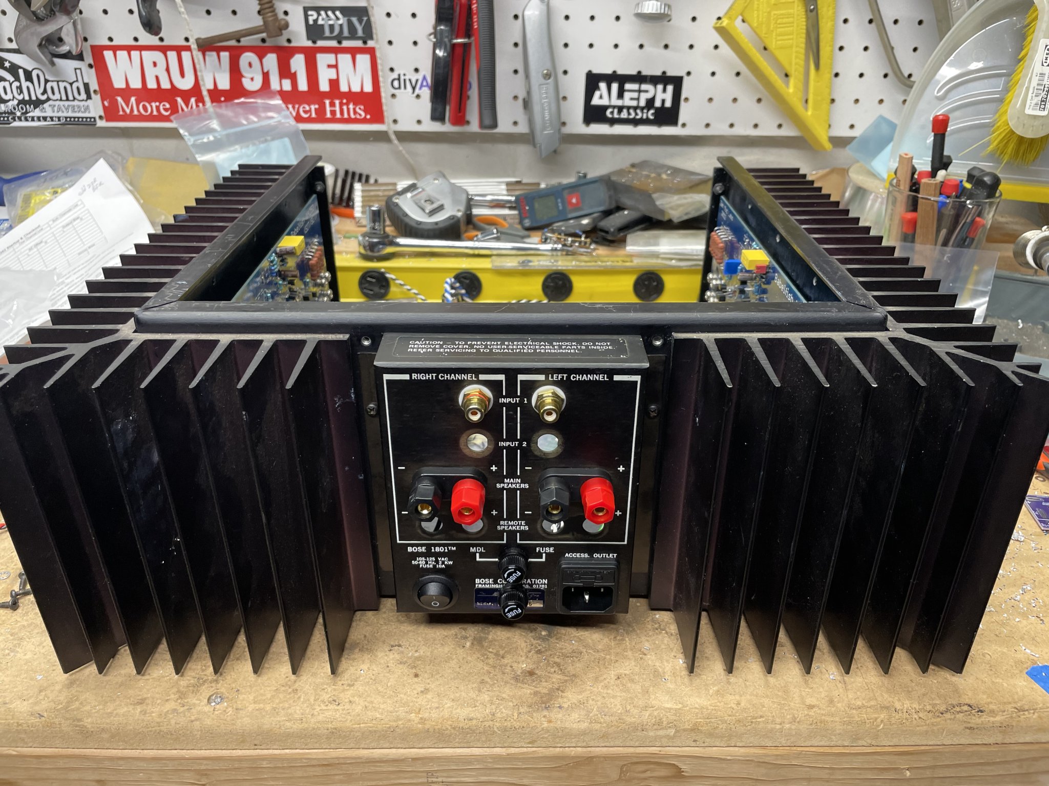

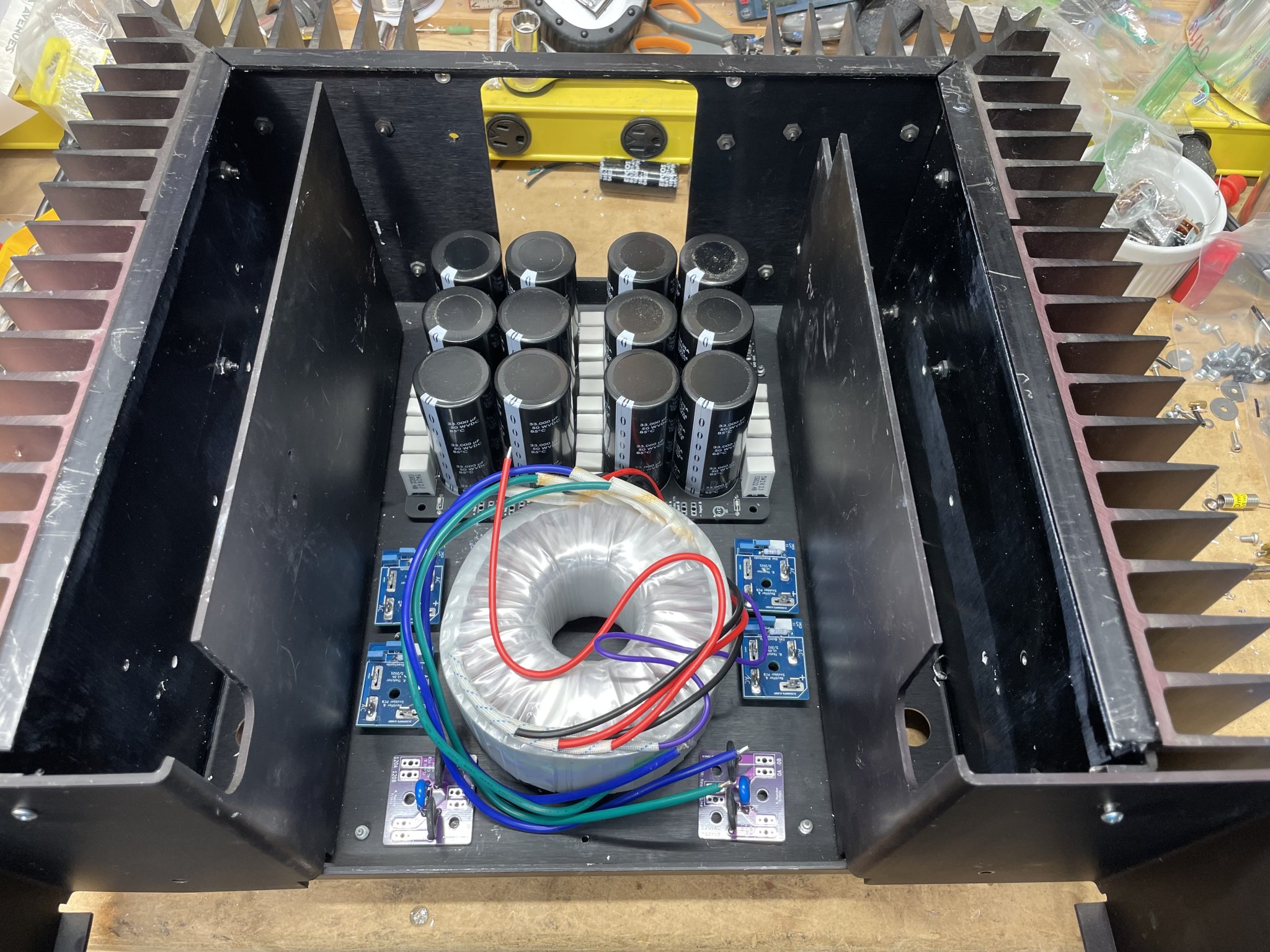

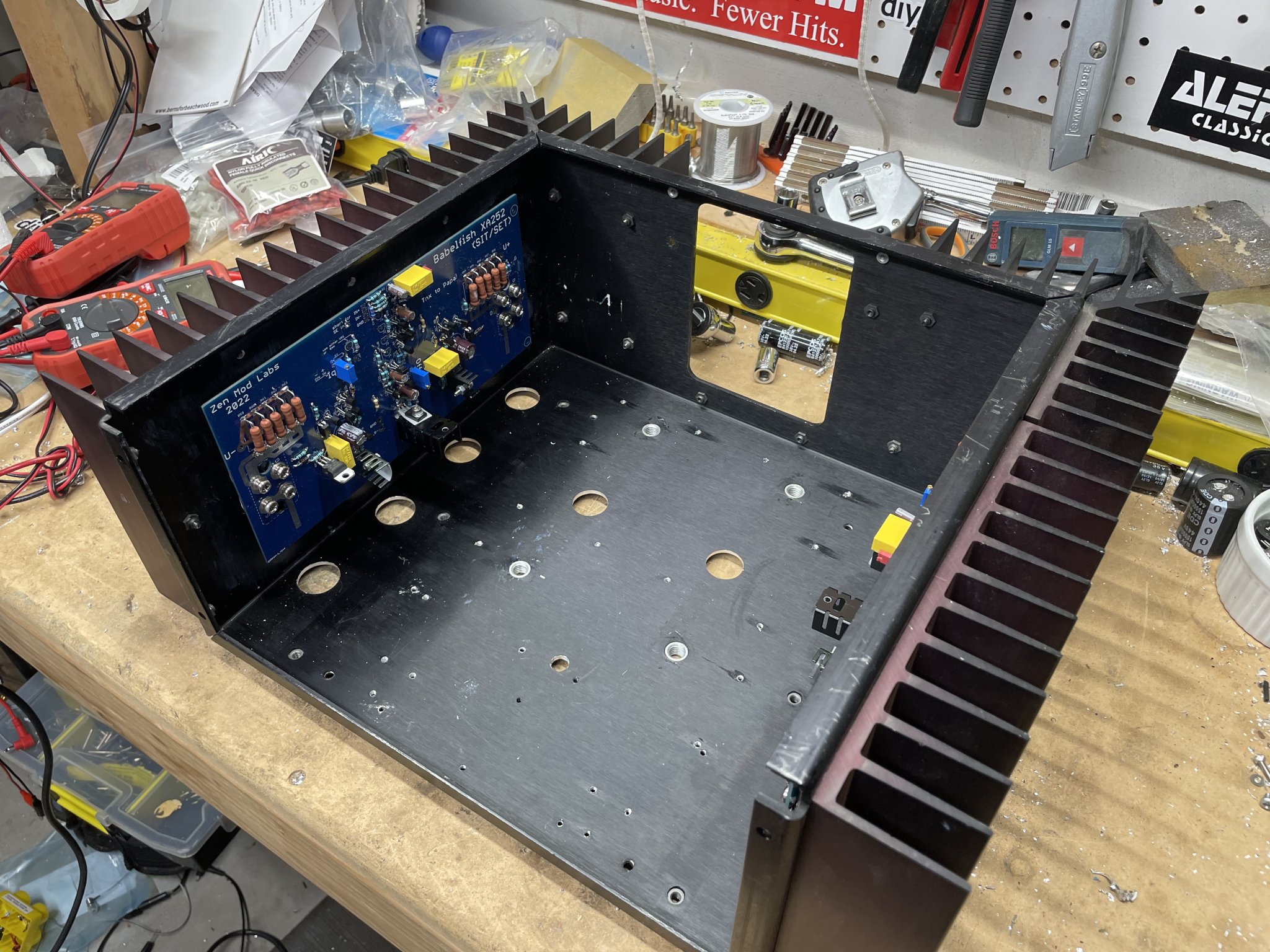

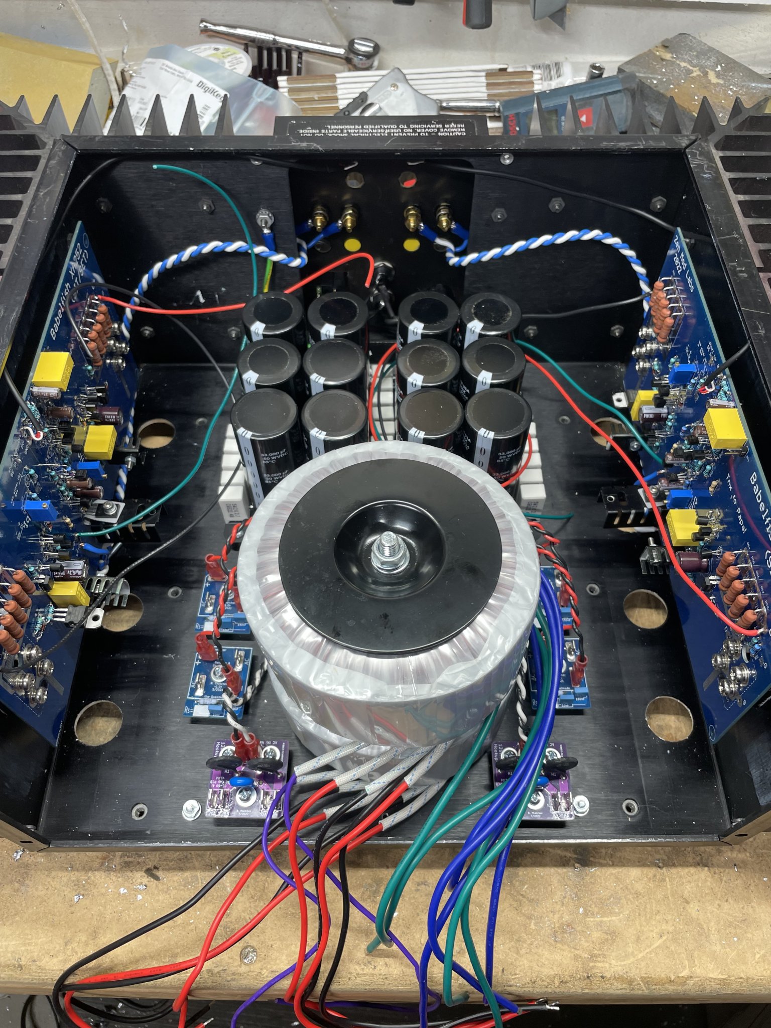

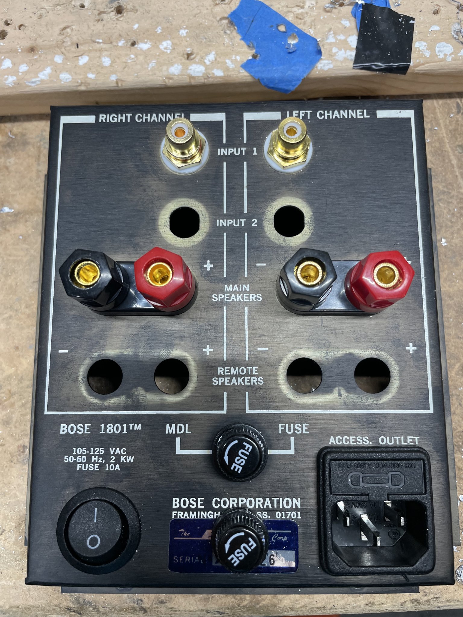

XA252 SET is being prepared for a 1970’s Bose 1801 chassis. I will go for stacked dual donuts / dual mono into CRCRC power supplies. When the amp is working I will turn my attention to making the meters and LED dance on the front panel.
25+25V donuts. Let’s see where the rail voltage ends up. 32? 33? 34?

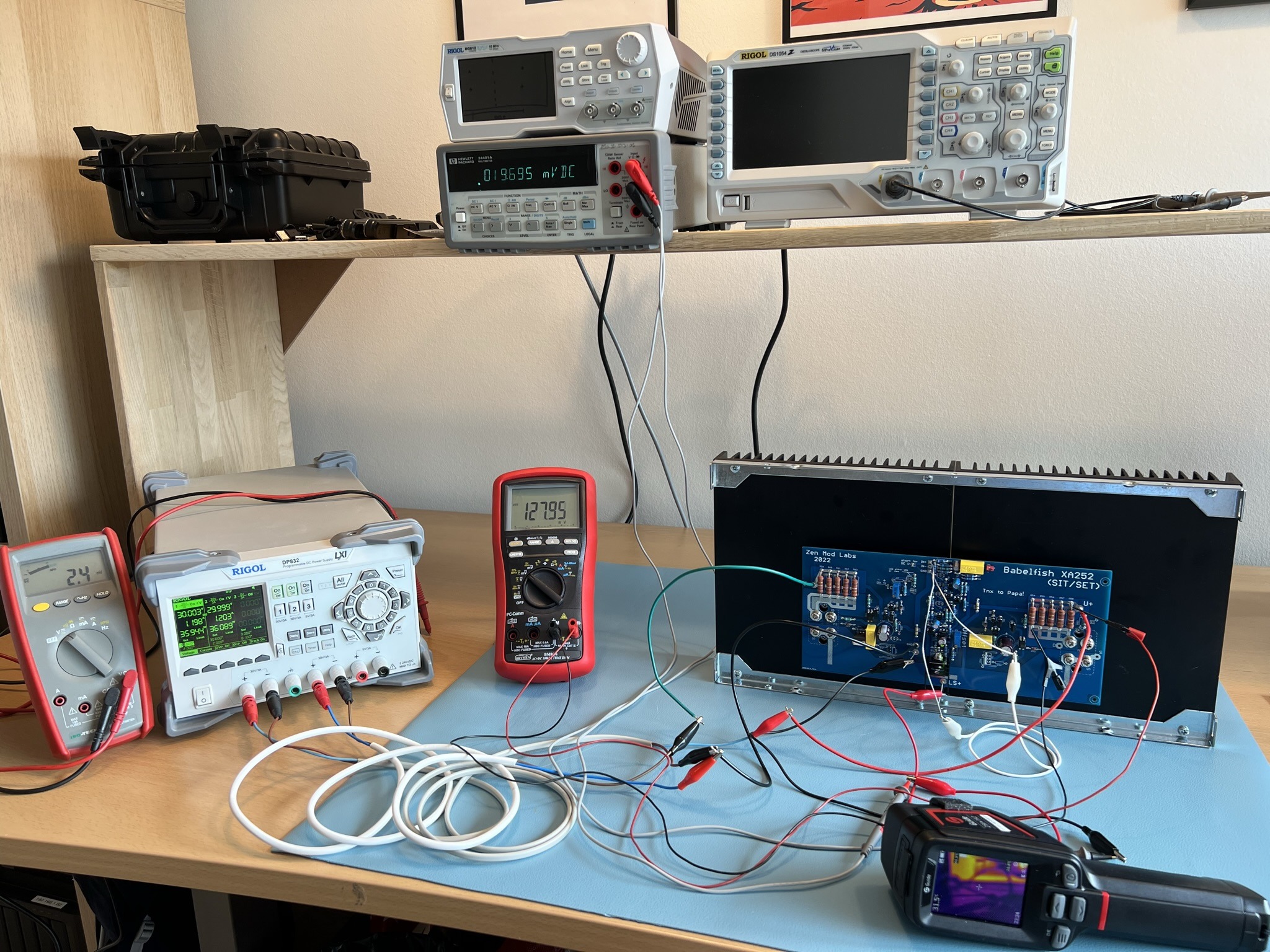

First channel power up 🙂 1.2 A bias pucks at 52 degC.
I measure T1 and T5 at 64-65 degC, is that an expected temperature? (27 degC RT)
T1, T5
I=0V65/120~5.5mA
heat=5.5mA*rail=190mW
for BC639, 0.83W part, nothing to write home about
I=0V65/120~5.5mA

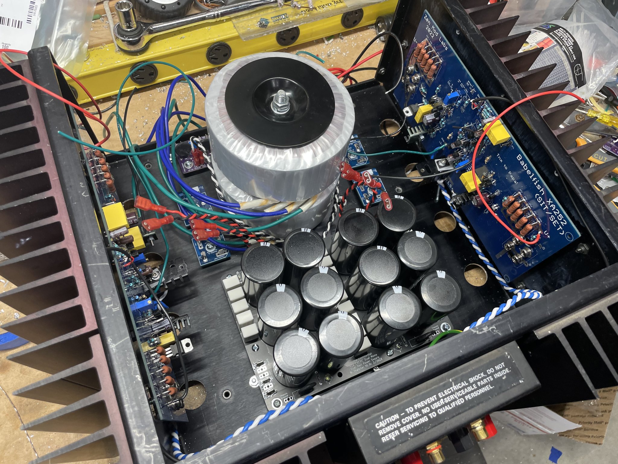

What capacitors did you use in power supply? Scouring digikey and mouser aren't turning up any 50 volt 33k caps. Or not kept in stock, long leed time. Since Panasonic stopped making my favorites, and the stash is dry short of cannibalizing existing power supply.25+25V donuts. Let’s see where the rail voltage ends up. 32? 33? 34?

I'll be using Antek 600VA 28+28 volt trans, figuring 34-35 volt rails. Now that Panasonic not making them what next! Saw some CDE, but not available with digikey or mouser. I will check Newark.

Randy has a bunch of Cornell dublier caps listed in his build guides. I suspect that's probably what he used.
I'm scared
that bench is too clean .......
Russellc
Digikey Part number 338-3814-ND
I bought these months ago. Mike is right, I do tend to go for CDE.
75 currently in stock at DK
