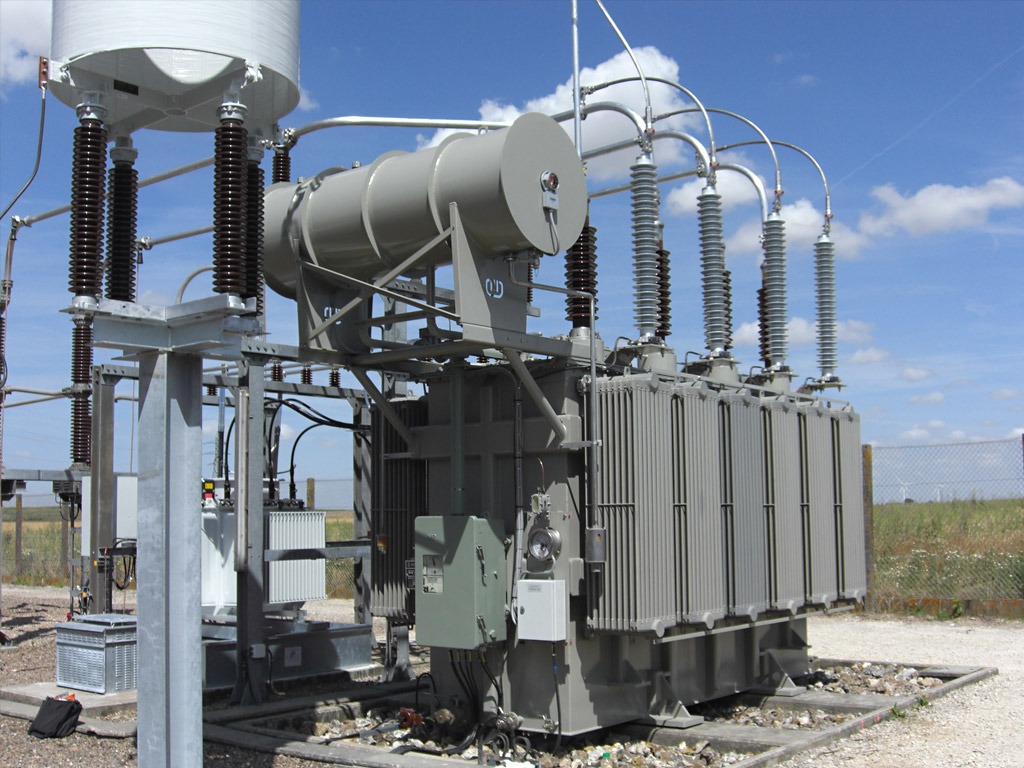

- sorta important detail - advisable to use separate secondaries/one bridge per secondary arrangement; as with majority of my little amps, also in case of Babelfish XA252 SET and Babelfish XA252 SIT - dynamic loading of rails is not uniform - result of complementary connected output devices not exactly being complementary, so having different/wakoo transfer characteristic
let's phrase it differently - whenever you have proper mosfet in one rail and SIT or Schaded mosfet in another rail, proper mosfet is having greater xconductance than it's partner
that resulting in greater dynamic loading of rail where proper mosfet is situated
so, if there is usual power xformer arrangement - center tapped secondary, entire rails loading difference will transpose to Center Tap ( used as Audio Gnd) , and xformer - happy stupid critter - is subjected to see it as nothing else as intermittent DC
We all know that xformers don't like DC and completely normal consequence is nothing else than buzz ........ and spoiling of xformer transfer characteristic
spoiling is going to result in spoiling AC coming from transformer, putting garbage back in rails, so some smearing of supposedly beautiful Soundscape ......
go figure

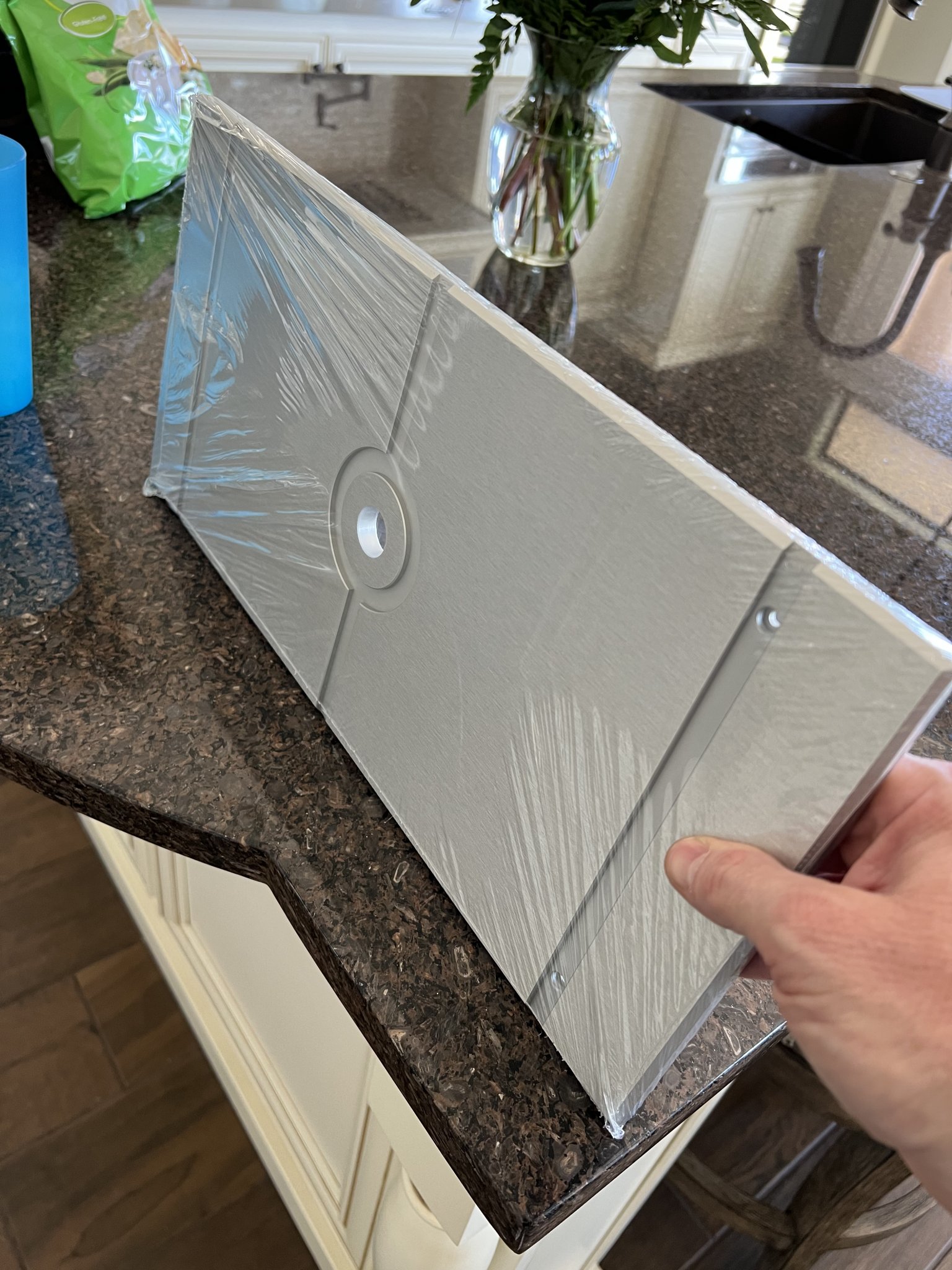

You guys planning to tap the sinks for the pucks yourself, or ask Gianluca to do it? Any drawings made allready for that? If I go with this, I think I am gonna have this done at the factory.
:cuss: :deerman:
do it with Viking Axe, or just ask Peppennino to make it, with his 'Talian Viking Axe, for you
