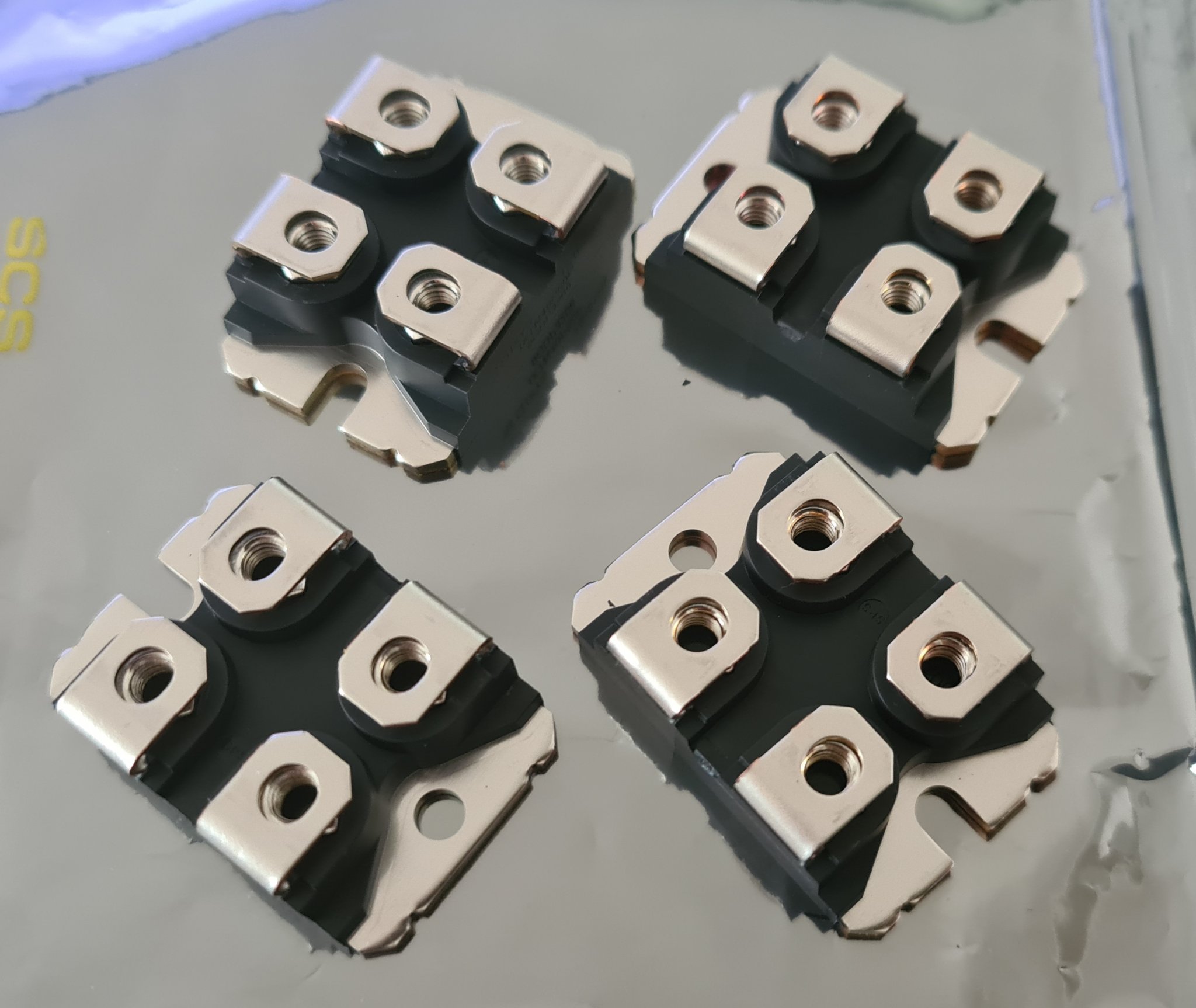

Just wanted to show how nice they are and how eagerly they are waiting for this new fishthingie
my dear Wakootalian
I wrote few times - I did tried them in SissySIT , and didn't liked result - just too much THD, and we all know that SissySIT is already THD Generator ( almost more than amplifier)
but, that same combo ( SIT+Puck) shines here
