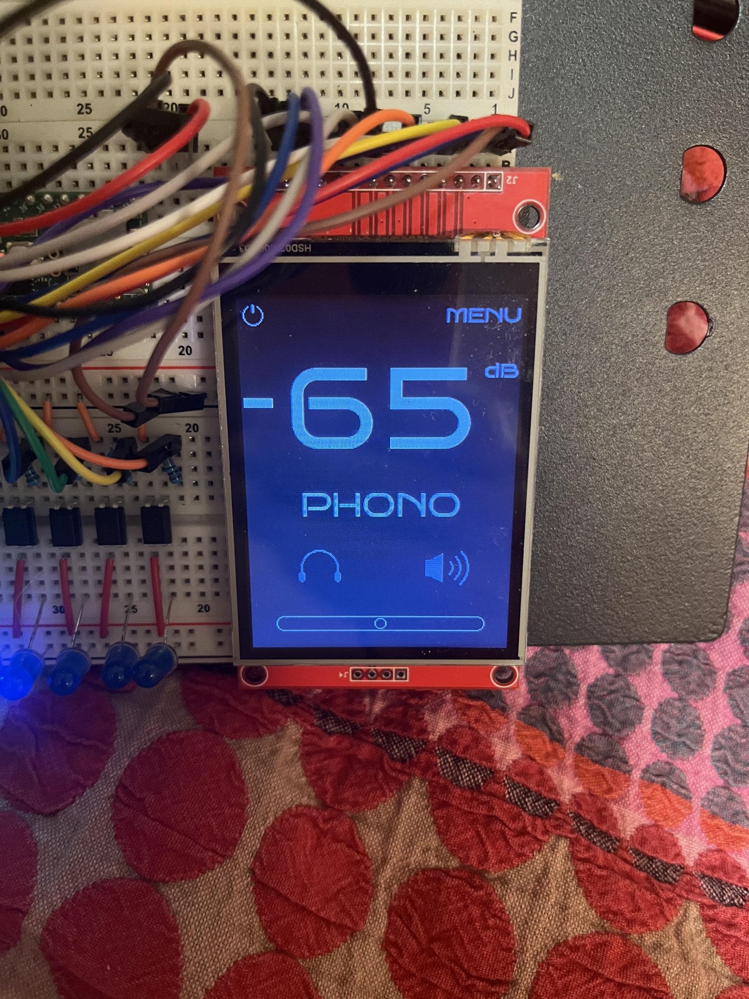

I’ve been working on this on and off for a few years. A touch screen controller for a preamp or integrated amp. Remote control, balance, 5 inputs, 2 outputs, backlight settings, brightness setting, lots of colour settings, speaker grounding (when turning on and off), changeable input names, adjustable fixed level output (for tv or streamer with its own volume control), adjustable trimmed output (so weak inputs play at the same level as the rest of your gear), aux power (relay that can be set to an input for a DAC or phonopre psu), mute, 0.5dB steps and standby. Uses Opto couplers so any voltage relays can be used. Uses one or two PGA2310 chips for SE or BAL. I have been concentrating on the User Interface and the look of it. I will post a video of it working soon.

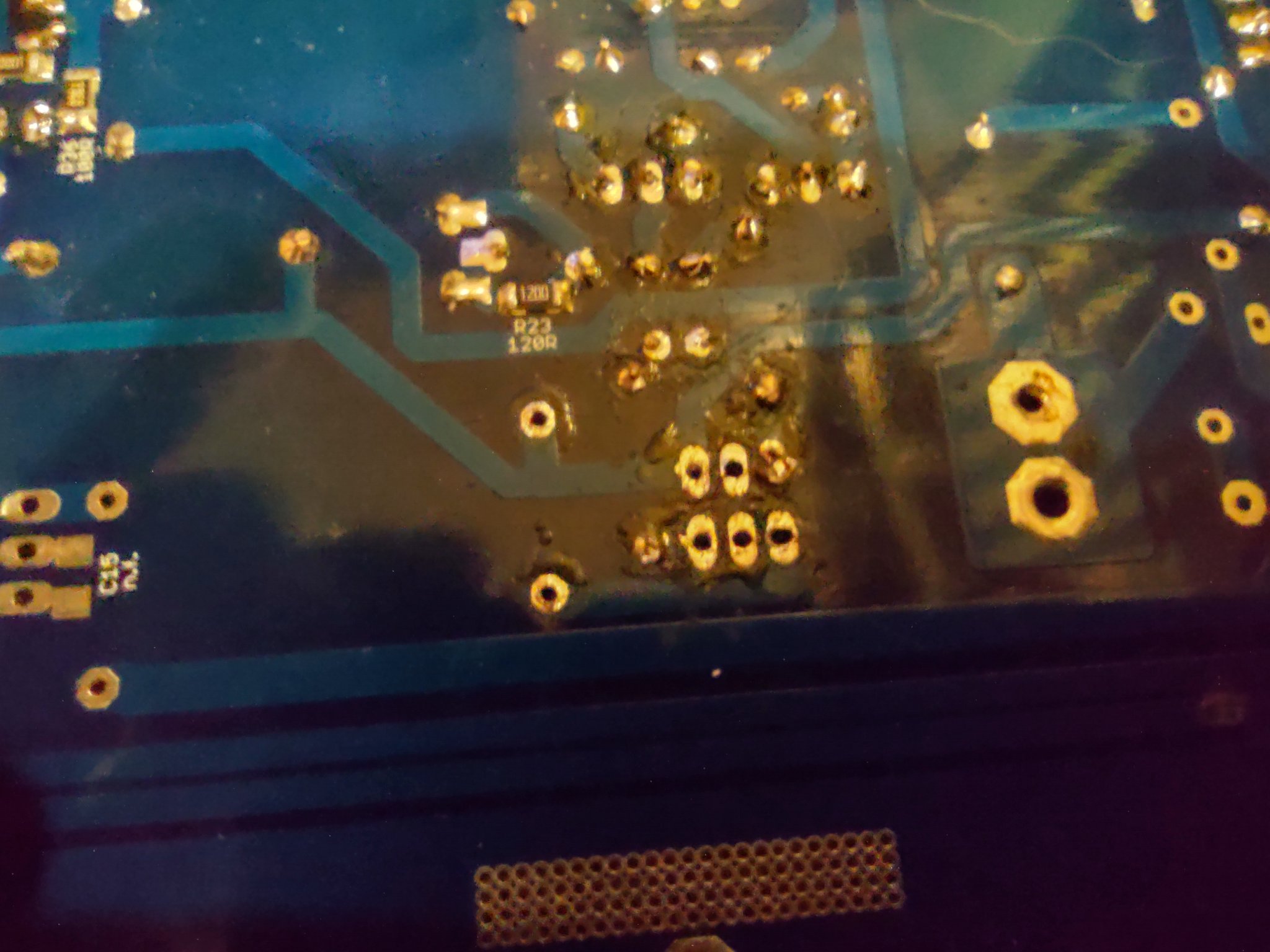

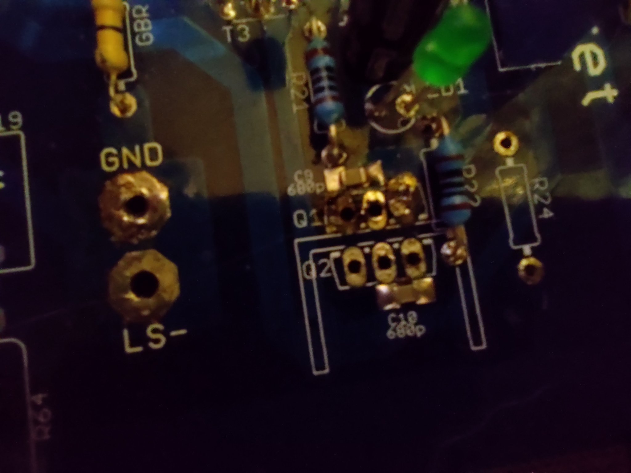

Zenmod, All parts replaced, but have not installed Q1/Q2 sandwich.... should I complete assembly and attempt refire, or leave out Q1 and Q2 for now with short on Q1, whole mess not yet hooked to mosfets and go through tests again? Or just attempt re firing it up?
I would do that, considering amount of replacements you did

The pad lifted? That shouldn't be a huge deal. If you want to use the board, you can run a piece of jumper from the lead off of the BJT to the next part(s) on the schematic.
yeah
Dont have the board in front of me right now, there is a resistor I think R19? looks like it connects. If so, I could replace it, leaving long lead to bring up through messed up pad and solder directly to leg of device.

If it is unrepairable, will just buy another kit, maybe two, I want one for upstairs too, and a spare board ready to go isnt a bad idea!
Looking at schematic and pads, I think I can get this part wired as suggested, but will likely build replacement channel for if/when repair let's go,

Bridge the lifted pad and try to make it work.
Considering the amount of pain you suffered with this board, don't stop just now.
At least it'll tell if you can recycle the parts or just trash the whole, not mentioning your skills upgrade.
And your last image make me suspicious regarding your soldering method.
HOT iron, fast action, and don't be shy with solder: some pads are not properly covered.

I can solder, problem is those parts, Q1 and Q2 have been in and out SEVERAL times.
Used desoldering station which works fabulous, just last time, pad gave up ghost. Those particular pads are tiny.
They were properly covered, pic is with all the solder sucked off pad. nothing being trashed, I can fix board. I am getting another set for another amp, going to buy one extra channel. Don't like messy boards, but if works, great if not replacement goes in, old board in parts drawer.
