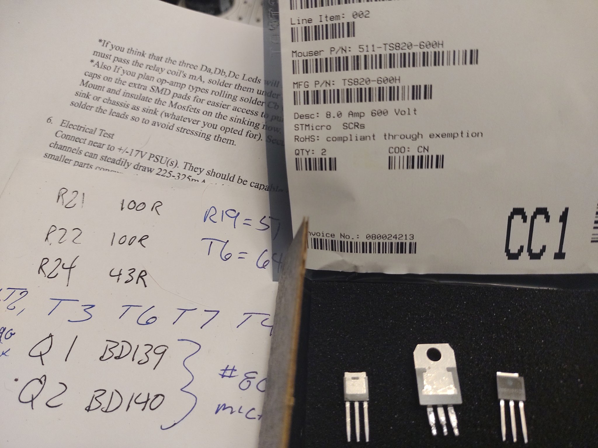

Parts all came but not sure about my TH1 choice. All the right numbers appear to me to be correct, but when I opened box, part is significantly smaller than the original supplied TH1 part. Here's a pic with packaging. Quite a bit smaller in size, so I think I may need to reorder?
Or is this part fine, despite much smaller size? (Pic shows original removed part )
Comments again appreciated 😁

Yes, I'm sure I will. At this point, when ready to re fire it up, every part on board except the tiny bits that were pre attached and the outputs are replaced. Seems like it should fire up as it did originally.
The through hole parts on the board are pretty inexpensive, to keep it going no risk I'm keeping spares of everything! I have bought them and extras. This way it can be fixed without a bunch of different separate orders wasting more time!
The other channel was corrected with minimal parts dead. This channel didn't respond same way.
Sorting through the parts I do believe the only dead part extra compared to other channel was T4. Went ahead and replaced all as I had the parts
