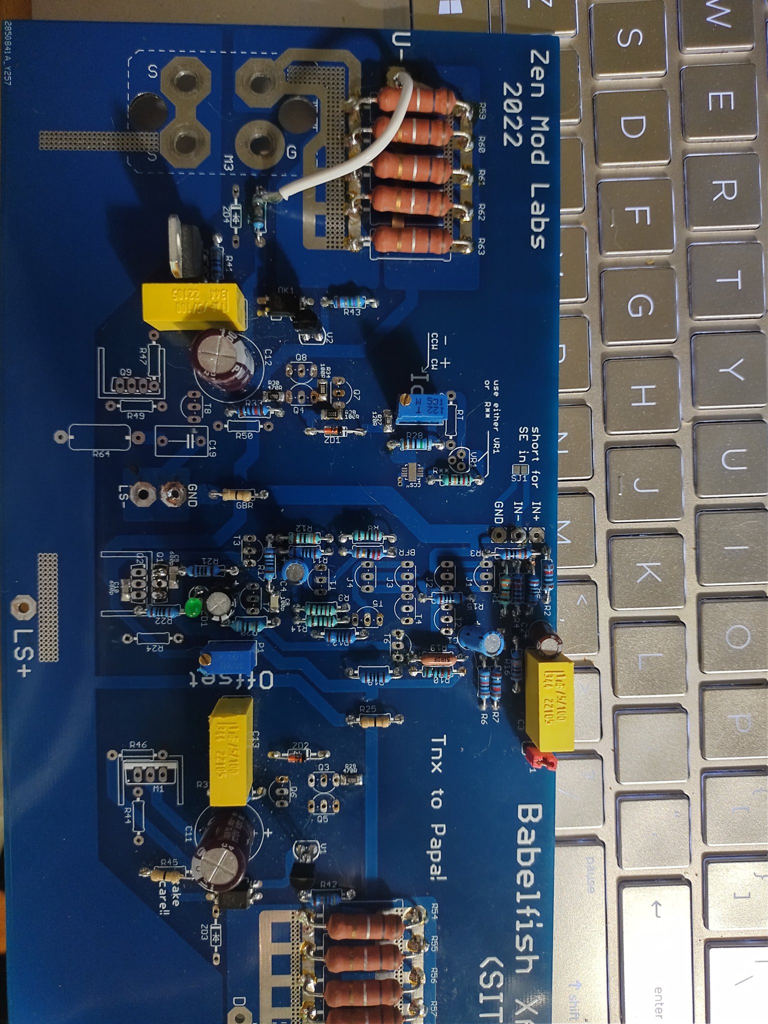

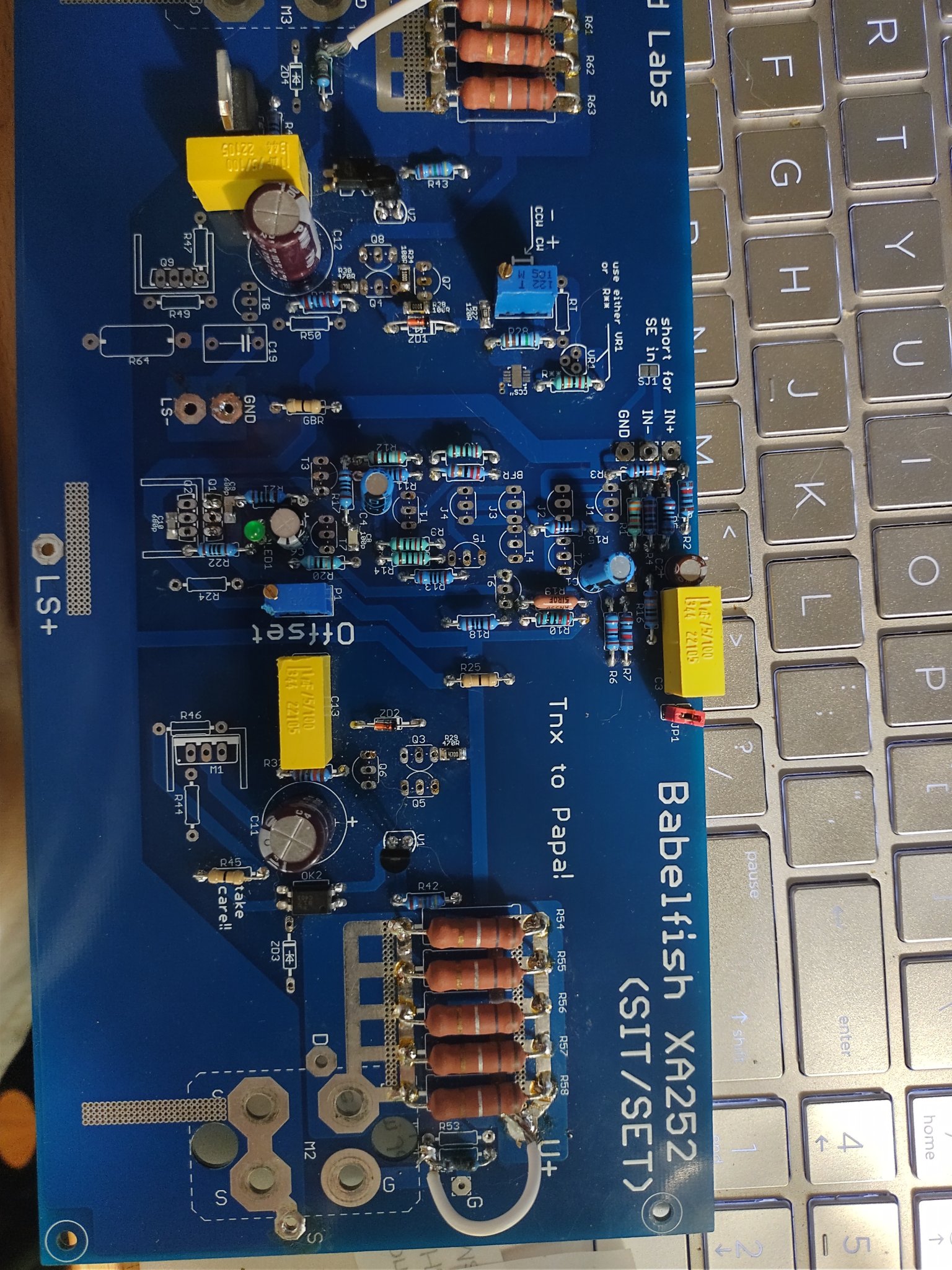

I think due to physical constrictions, short sink.But why mount the SIT in the corner?
I have now removed everything with the exception of VR1, VR2 OK1, and OK2 as well as TH1. thought I better check in and see if they are also on removal list.

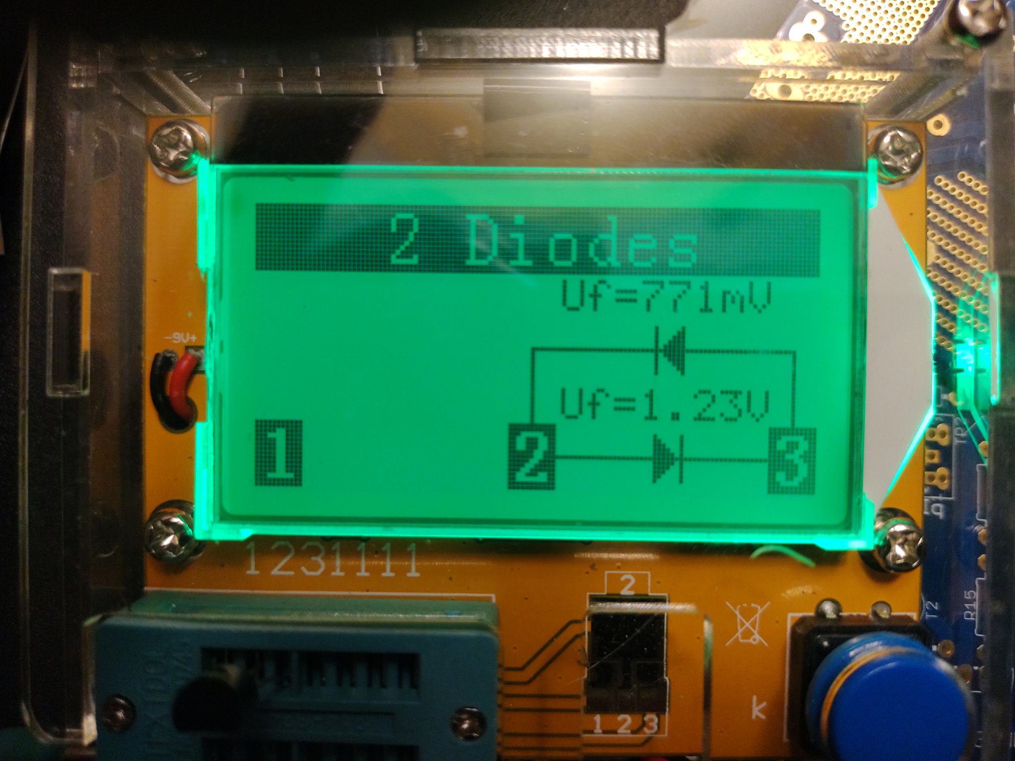

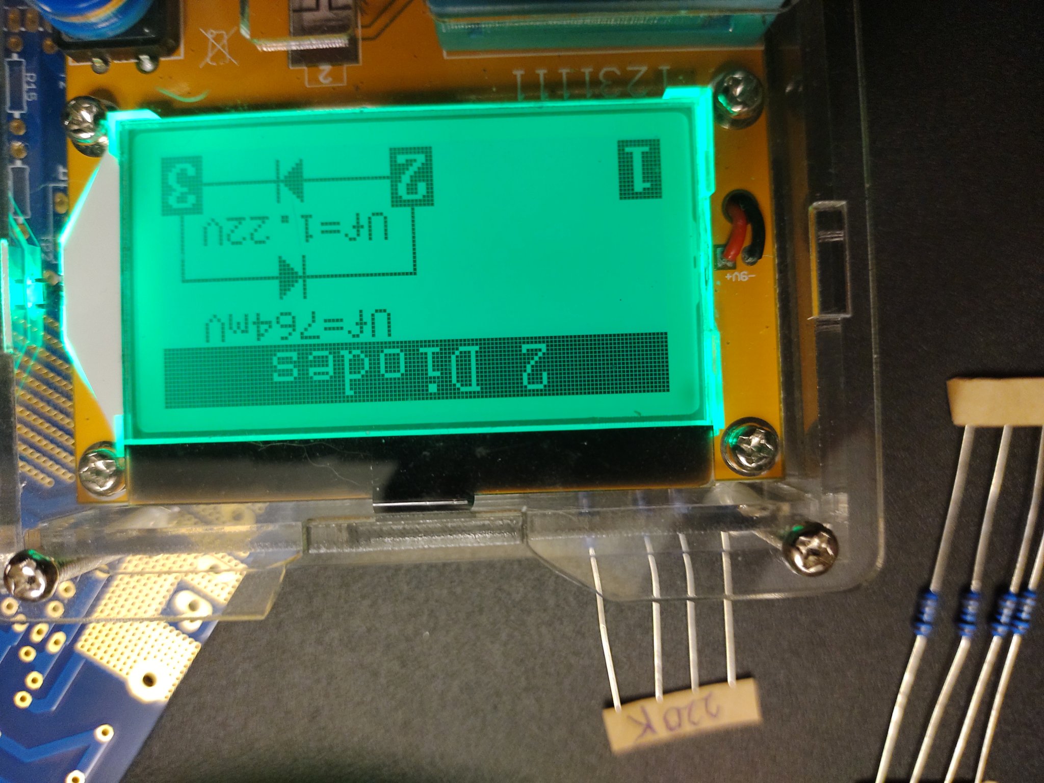

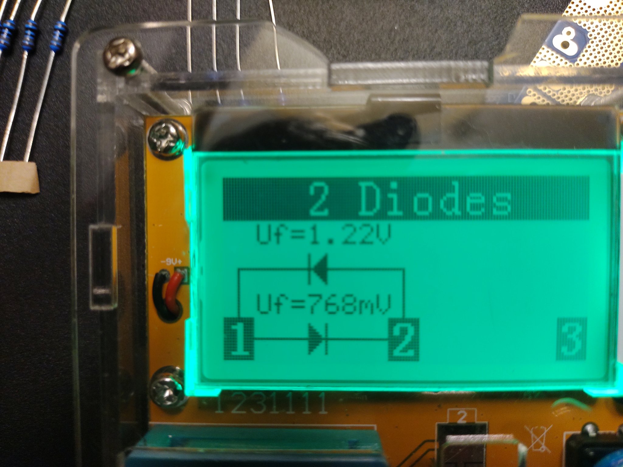

All T1, T2, T3, T4, T5, T6, T7 are tested, with only T4 faulty, measuring as resistor. That is one not previously changed, I believe that was only T6 and T7 the first repair go round. So, are TH1, OK1, OK2, VR1 and VR2 also suspect and need checked? pics will be posted shortly!
Oh, and the two suggested zeners to test, ZD3 and ZD4 need a short extender soldered to one leg to fit in gizmo, but setting multimeter to diode showed a small measurement with polarity one way, nothing the other way so I think they are good, I will solder extender and put in gizmo
Ok, guess I will remove OK1, OK 2 TH1, VR1 and VR2 and test them. Replace any bad, and refire. If that's not it, may be time for real McCoy, I don't seem to be able to fix this rascal!

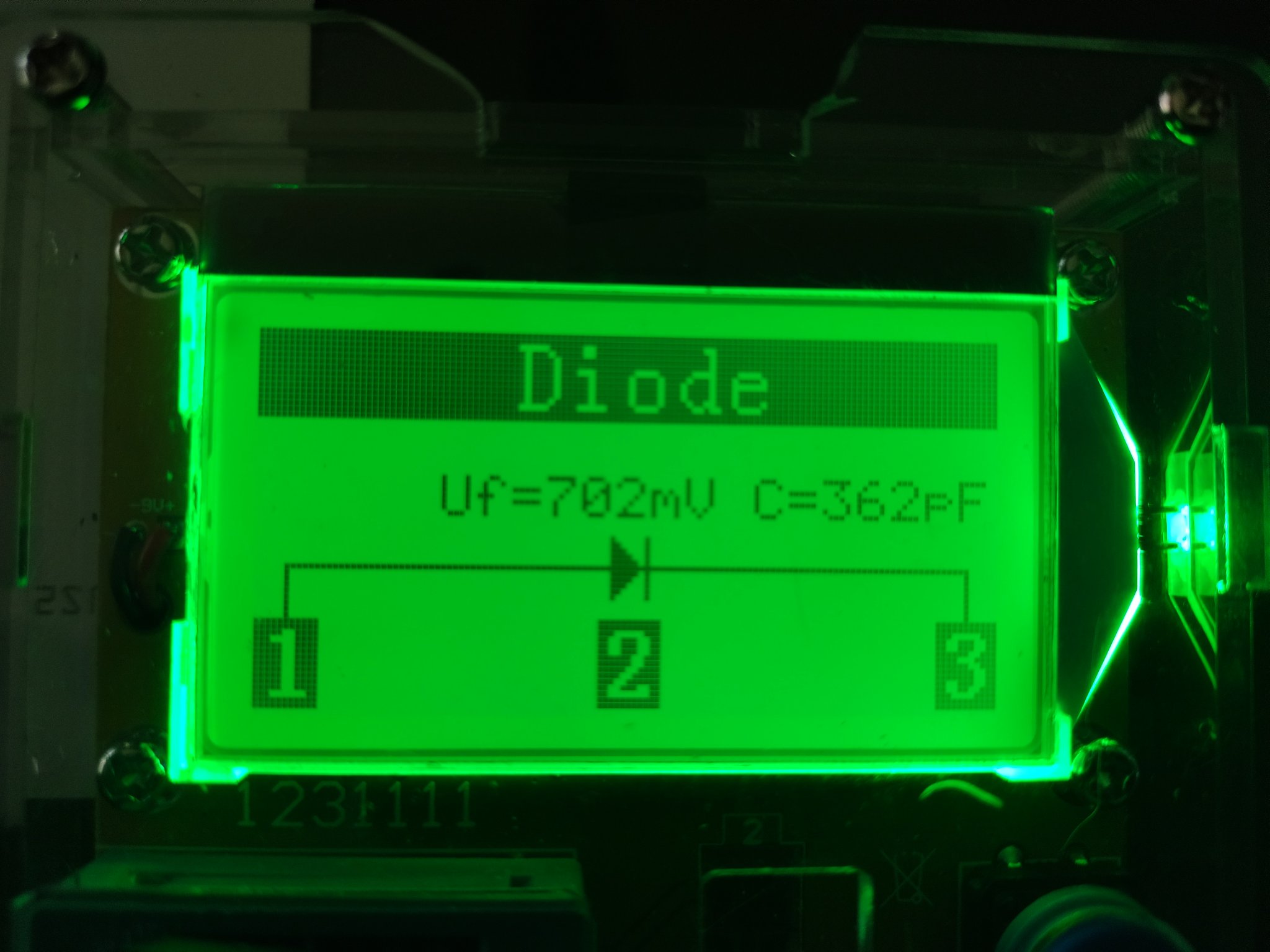

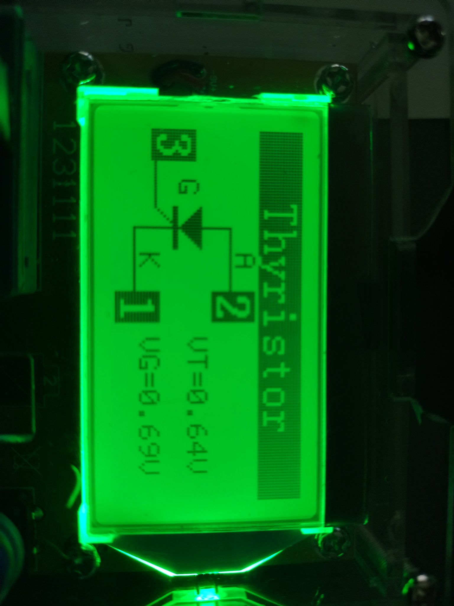

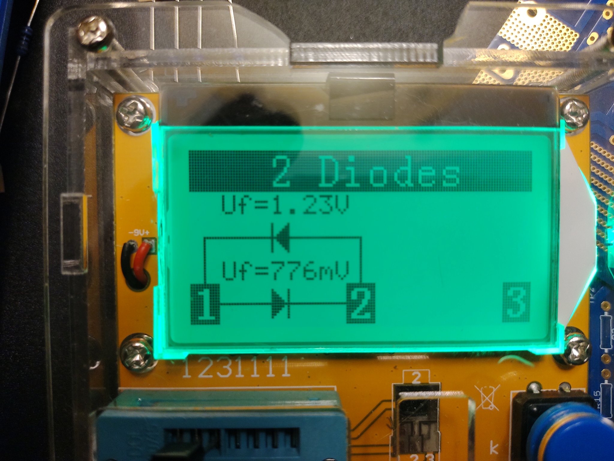

Are these measuring good? I assumed V1 and V2 were good, but didn't know about TH1. It measured as thyristor one way, good but as diode other way. Good?
Russellc
Russellc
thyristor - if measures OK in one placement way, difference of measurement placed differently can be explained only by software quirk
so, good
V1.V2 - they're "just" opto diode protection of overvoltage; circuit - in normal circumstances - can go even without them
