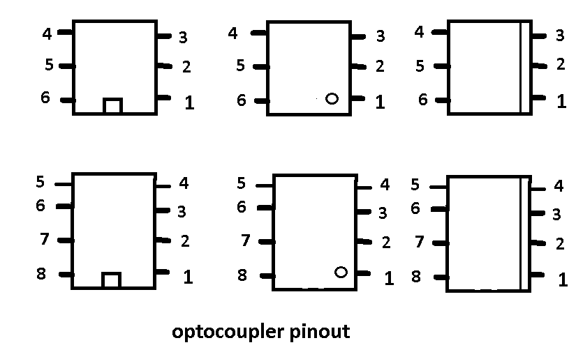

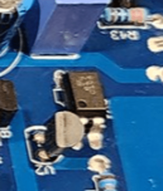

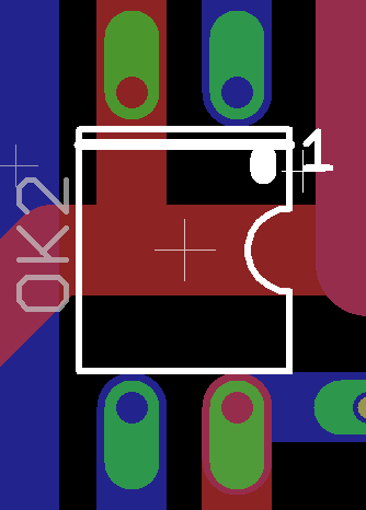

I had impression that optos are rotated, but no..........
just in case, as confirmation that they're OK, attached files
schm for your option is, from post #1462
proper optos are PC817C, through hole
example: https://www.tme.eu/Document/7534c9f89aa4b1eba4ec90182e378328/PC817_2_3_47.pdf
edit: as I can see, even if you rotate those optos you have, pin 1 is not going to be

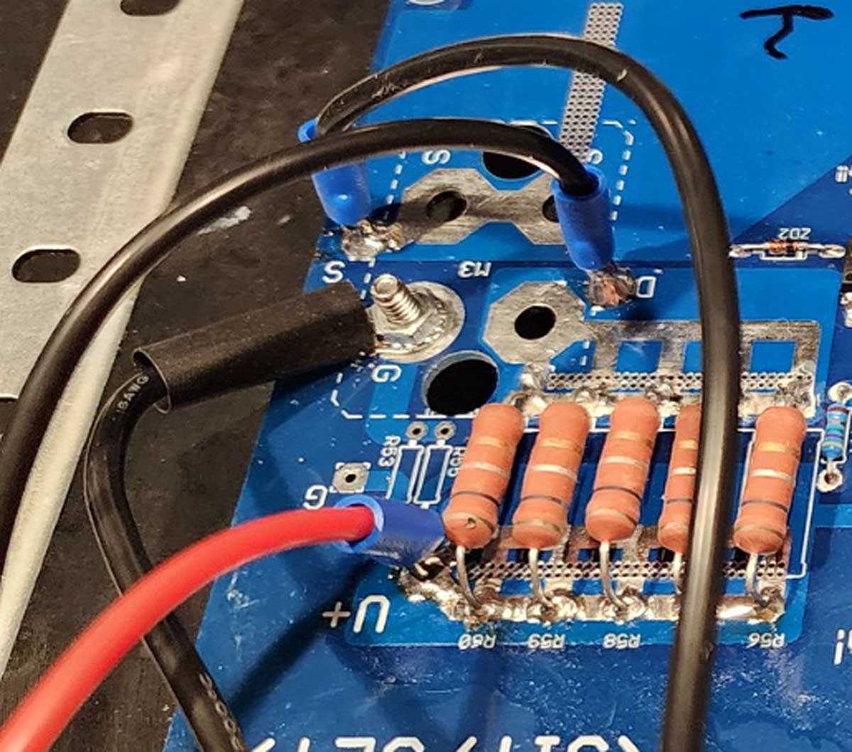

here it is, proper cummulative schm for your iteration of pcbs, even if I'm sure that I sent you pack of files:
but, I think I found what's problem
instead of bolting wire to G mosfet pad (and not!!!! populating R53), unbolt that wire from G mosfet pad, desolder fat wire from SIT Gate, solder 47R resistor ditto to SIT Gate, thin wire ( heatshrink wire, resistor, gate pin) and solder other end of thin wire to small G pad, near R53
as is now, Gate of SIT is floating, so no wonder that you have drekload of current

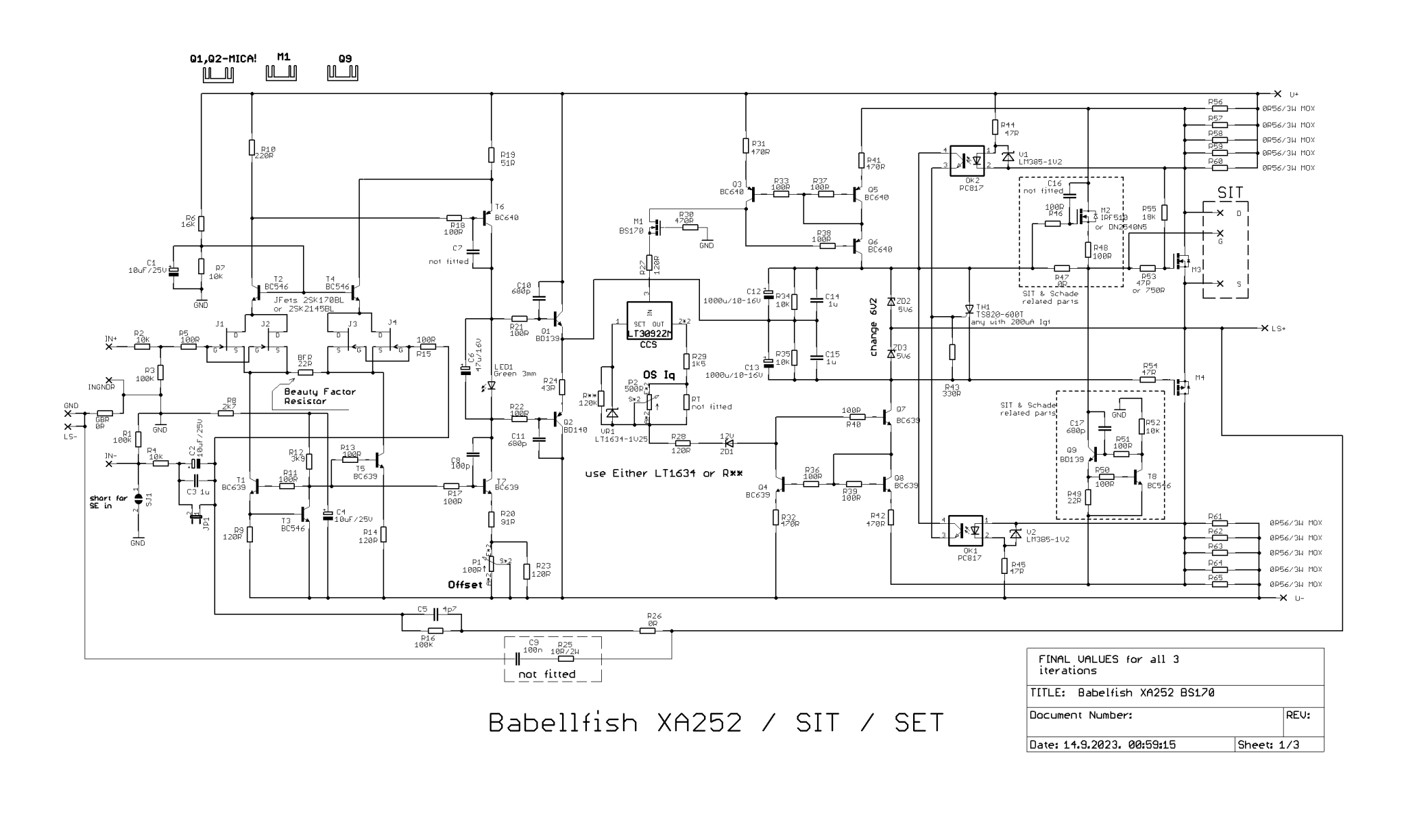

HI, been studying circuit and simulating in LTspice.
Regarding: " OK1-OK2-TH1 .......... 10A limiting circuit, Savior of Our Souls, blatantly stolen from Pa 😛 "
Was wondering when it will be of added value. Came to the conclusion that only a short on the output will trip this circuit. Am I correct, or do I mis another failure mode?
