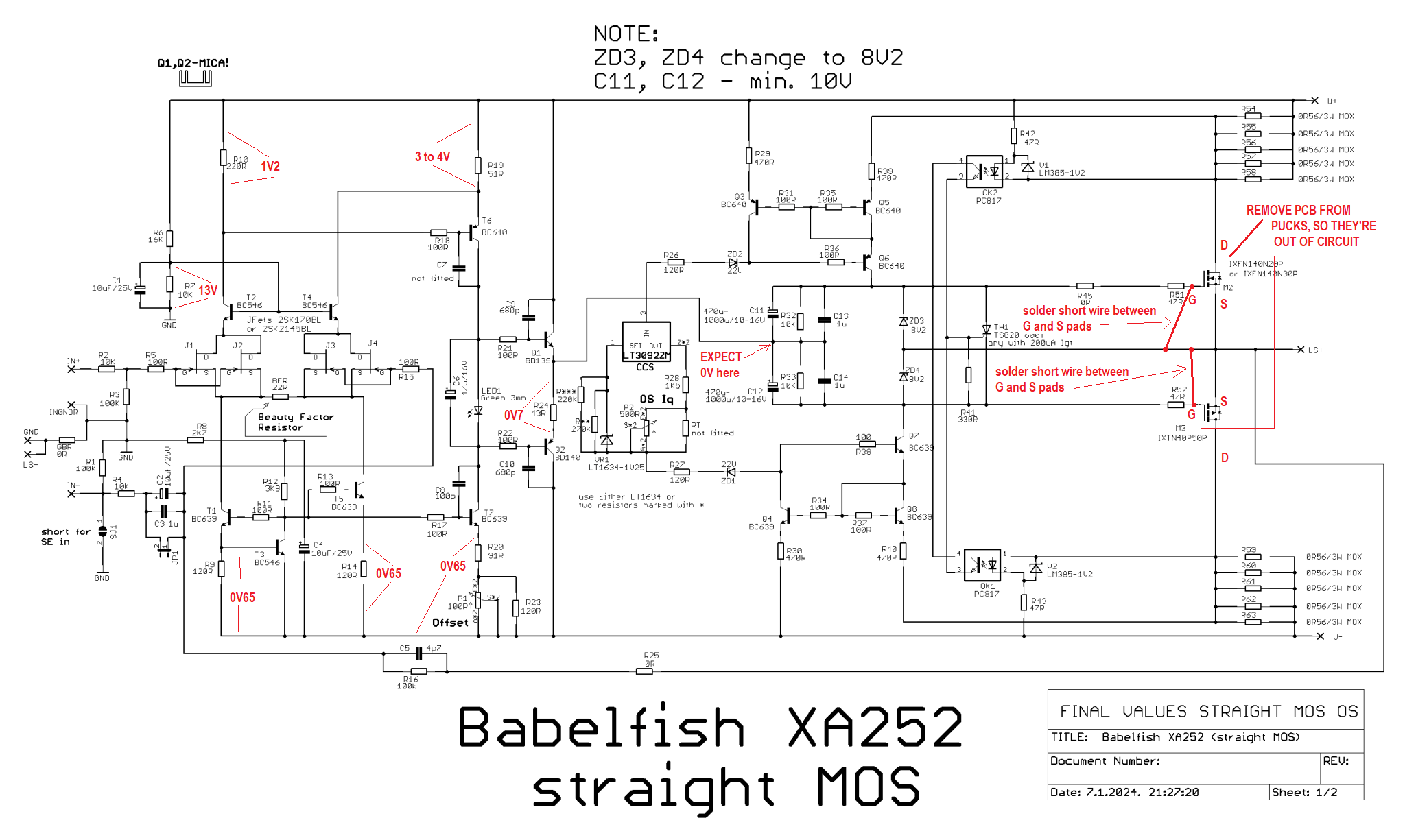

Before I start to populate XA252 SET with FQA36P15/FQA28N15 mosfets using +-24V rails then I want make sure that everything goes smoothly. 🤣
ZM mentioned that I can use the same PCB with mosfets when using 24V rails and no change is needed?
To test this XA252 without mosfets then I short output G and S. Then Iq pot all the way CCW which means 0 ohm or 500 ohm? Papa already gave me a lesson about that with F5m because some pots with CCW have other values.
Is there also a point to test it without Q1 and Q2? If yes then what values and where to test them?

Go back a couple few posts, zenmod had me testing with board off mosfets and Q1 and Q2 removed.

I try to answer to my question.
P2 set to max value, use DMM to measure it.
Remove Q1, Q2 now, to establish DC path for NFB, allowing FE to self-center, put short (piece of wire) connecting B to E pads of Q1 and Q2?
Then short output G and S.
Establish proper DC NFB path for servo action, simply shorting zeners between output gates - ZD3 and ZD4, then you'll have proper DC offset at output to check and sine at output.
If parts are OK, you'll have so-so close to 0V AC at output and close to red written check values on FE specific places/components (picture attached).
R19 - have values 300-400-500mV.

pretty much no change needed for lowered rails, in that amount
don't bother with partial tests, if new build; better invest time and energy in triple checking everything, then put temporary 2A5 fast fuses in rails and power it on and set

as I said , if new build, why bother with procedure mainly intended for troubleshooting
