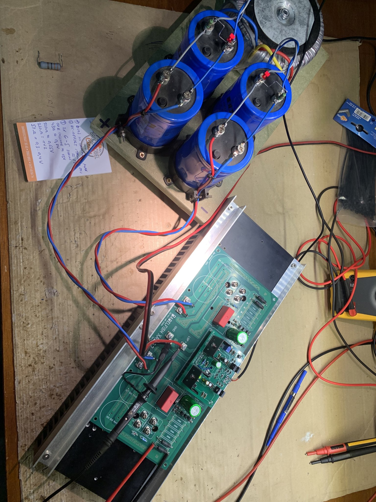

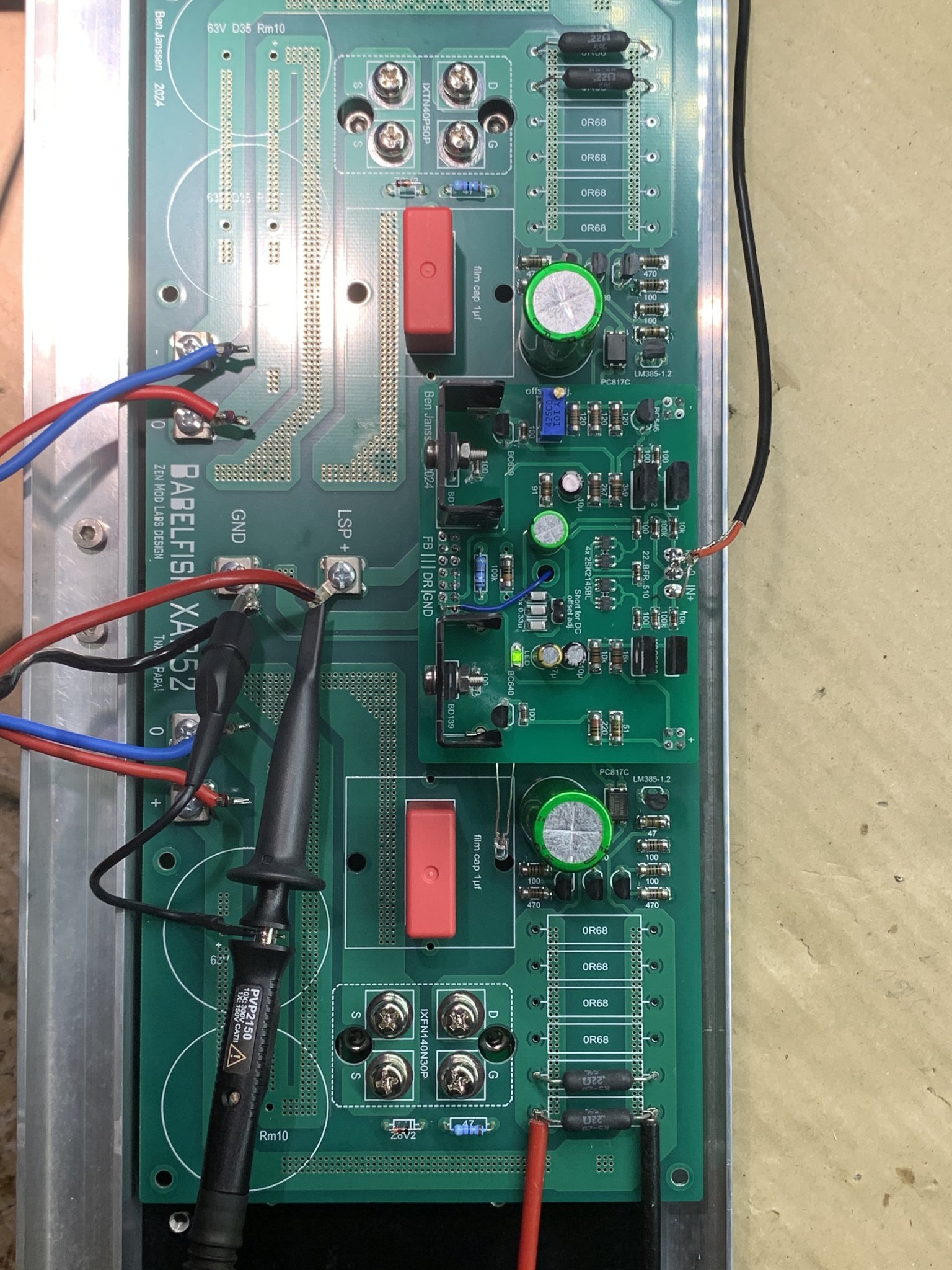

Another one is alive. First iteration of PCB’s assembled on a testbed. Rails are 30v, currently biased at 1,5A. Listening Enya during typing.
GND star point is created on the OPS pcb. Idea is to add 63v 22000uf Mlytic’s on the OPS pcb.
Bias behaves well during clipping.

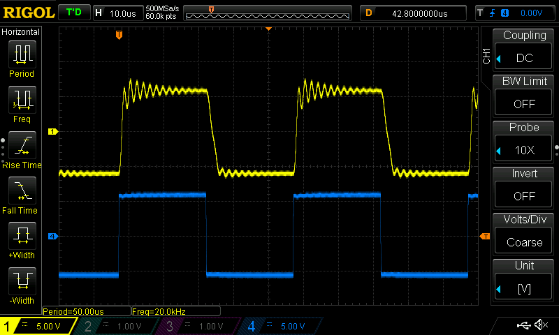

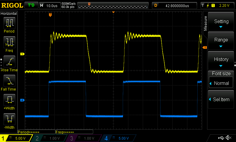

I just replaced the BD parts with the TTA + TTC004 combo. I did comparison with 20kHz 10Vpp on a 7R load // 100n.
Result is identical.
01 = BD's
02 = TTC+TTA
