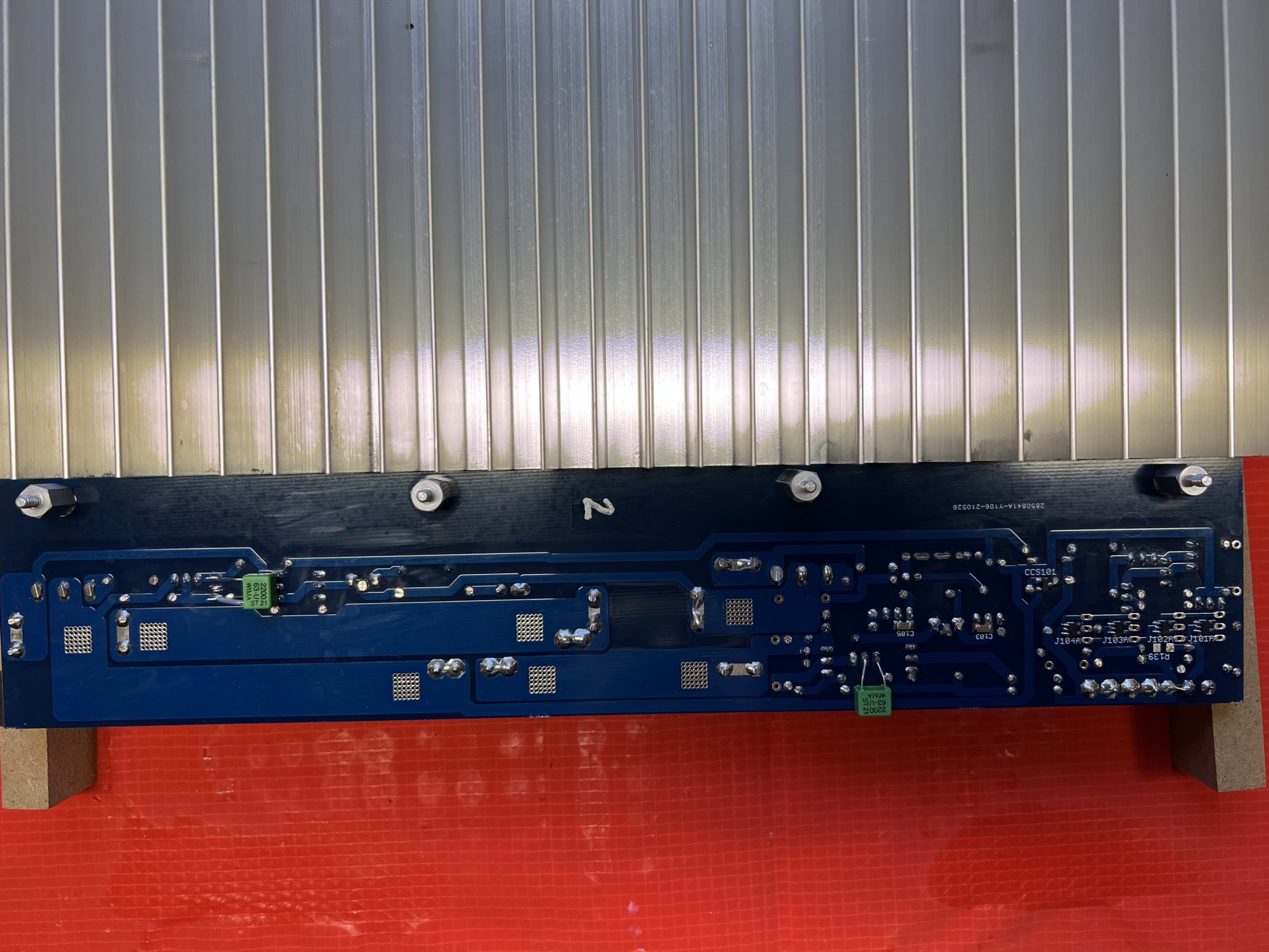

I’m going to start with ZM’s suggestion of placing a small cap across the BD140 base and emitter at T111 and see what happens.
Unless ZM chimes in and says I should start elsewhere due to the results of placing a 10uf cap across R122?

Fired it up
No buzzing on start up this time.
The residual noise level appears to be pretty much on par with the first pair of quiet amp boards when I place my ear very close to the test speaker.
I don’t want to celebrate too soon…but I’m feeling so relieved!
I’ll let it sit over night and cycle it a couple more times to make sure.
If all goes well, I’ll probably mount the same caps on the other boards to placate my OCD.
Then bring them all back up to temp and re-check bias and dc offset.
Might need a break before attempting to swap in Semisouth.
Thanks for all the patience and help everyone…especially ZM!

well, I did mention those small caps several pages back...
take care, I can declare that my browser is taking few posts per page, so my claim can be only truthful
remember those 1nF caps in Papa's Alephs?
they're mostly not needed, but in some builds you simply can't go without them....

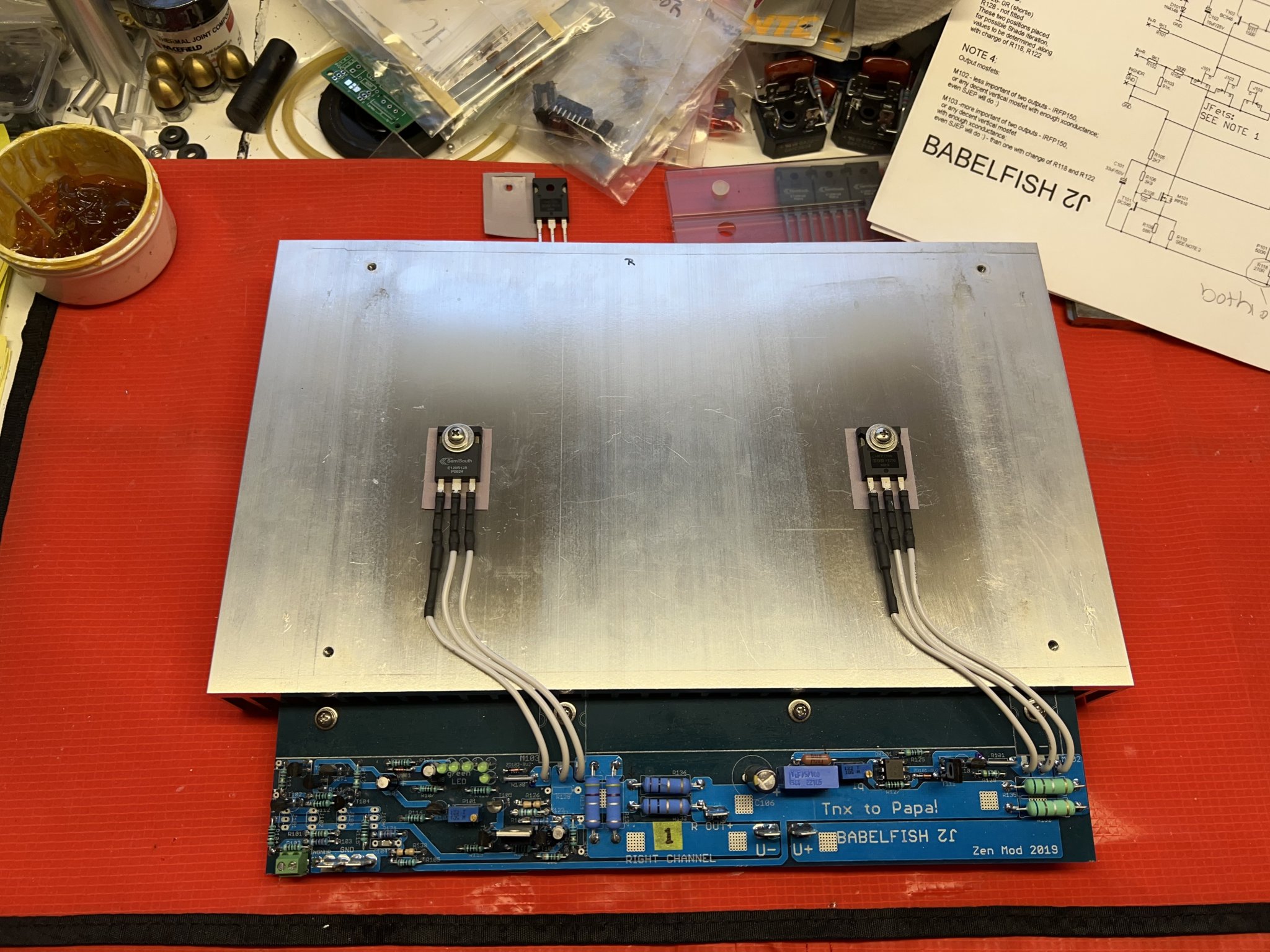

As mentioned, I decided to add small caps to #1 amp boards as well.
While on the bench I said $crew it…I tested and waited long enough…I put the Semisouth in. I want to compare it to the all irfp version.
This is Semisouth R125 down position only for now.
I have changed R118 to 270 Ohms and R122 to 82 Ohms as noted on modified circuit diagram posted earlier in thread.
Re-centered Iq and DC offset pots.
Anything else to worry about before I fire it up?
