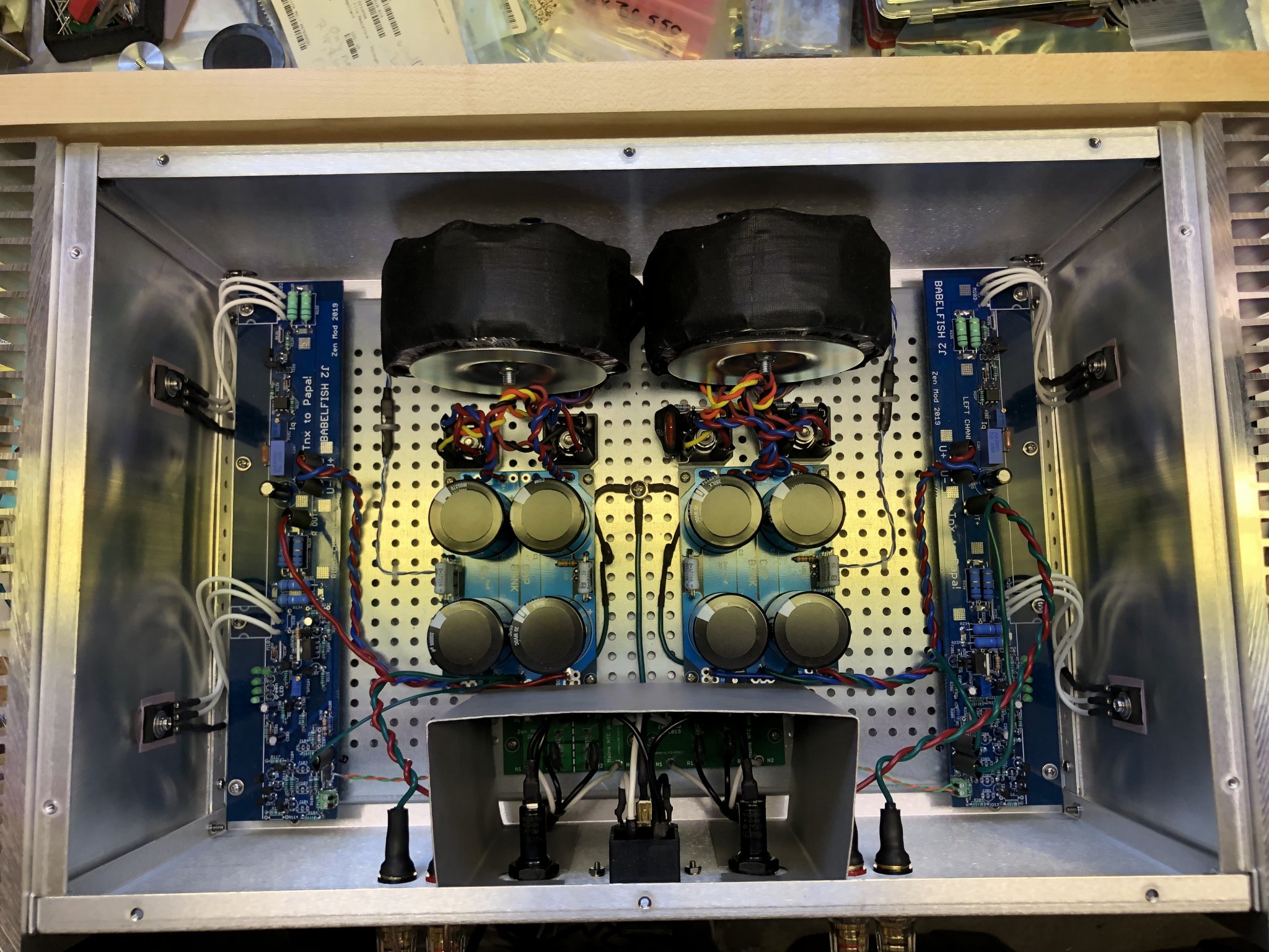

Had time this morning to install bridges on channel with my original wiring. Original wiring is right channel in pic…Left in pic is last suggested wiring.
Fired it up…no dice. The noise is still there…and it sounds worse for some reason.
I didn’t revert the wiring on the other channel…didn’t think it would matter if I wasn’t powering it up. Maybe the modified ground wiring is affecting this channel for the worse as well?

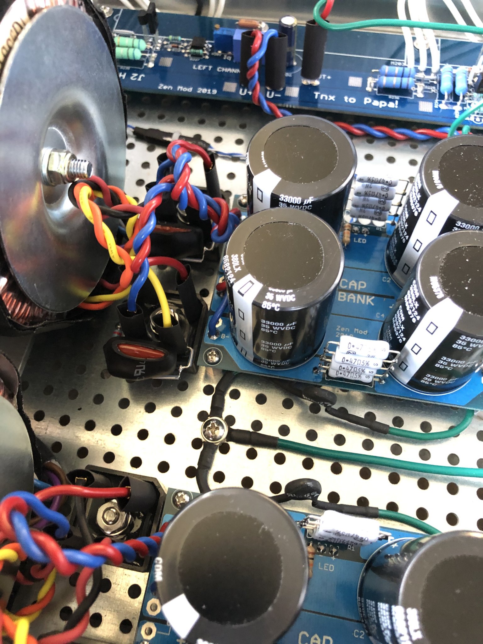

I think I did things correctly with the snubbers.
Added a few more pics of them installed in the case.
Ideas???

there must be something differentiating these two amps, one being buzz-free and second being buzzy
unfortunately, conclusion of what is that exactly, is possible only with more work ....... either changing blocks in it, or even migrating them from buzz-free amp
how you decided what value of resistor is in snubbers?
Got resistor value from Quadimodo thread after posting an inquiry with my transformer info.
rhthatcher replied with values he had used with same transformers successfully

Finally stopped my sulking about having to take apart my #1 BJ2 that is quiet.
Initial test was pull the left channels from both (which have same unmolested original wiring scheme I did…#2 also has snubbers) and switch them.
Did test before hand to confirm things were as I left them regarding noise in #2 and #1 being completely quiet.
Well…noisy left amp channel from #2 swapped into #1 quiet
took noise with it.
Further test showed the right channel in #1 stayed quiet…so noise is somewhere in the #2 amp board.
Also tested right channel still in noisy #2 case by itself…still noisy.
Installed good quiet left channel #1 into #2 chassis with still noisy right channel.
Sound test showed left channel from #1 stayed dead quiet even in the #2 chassis. Right #2 channel remained noisy in same case.

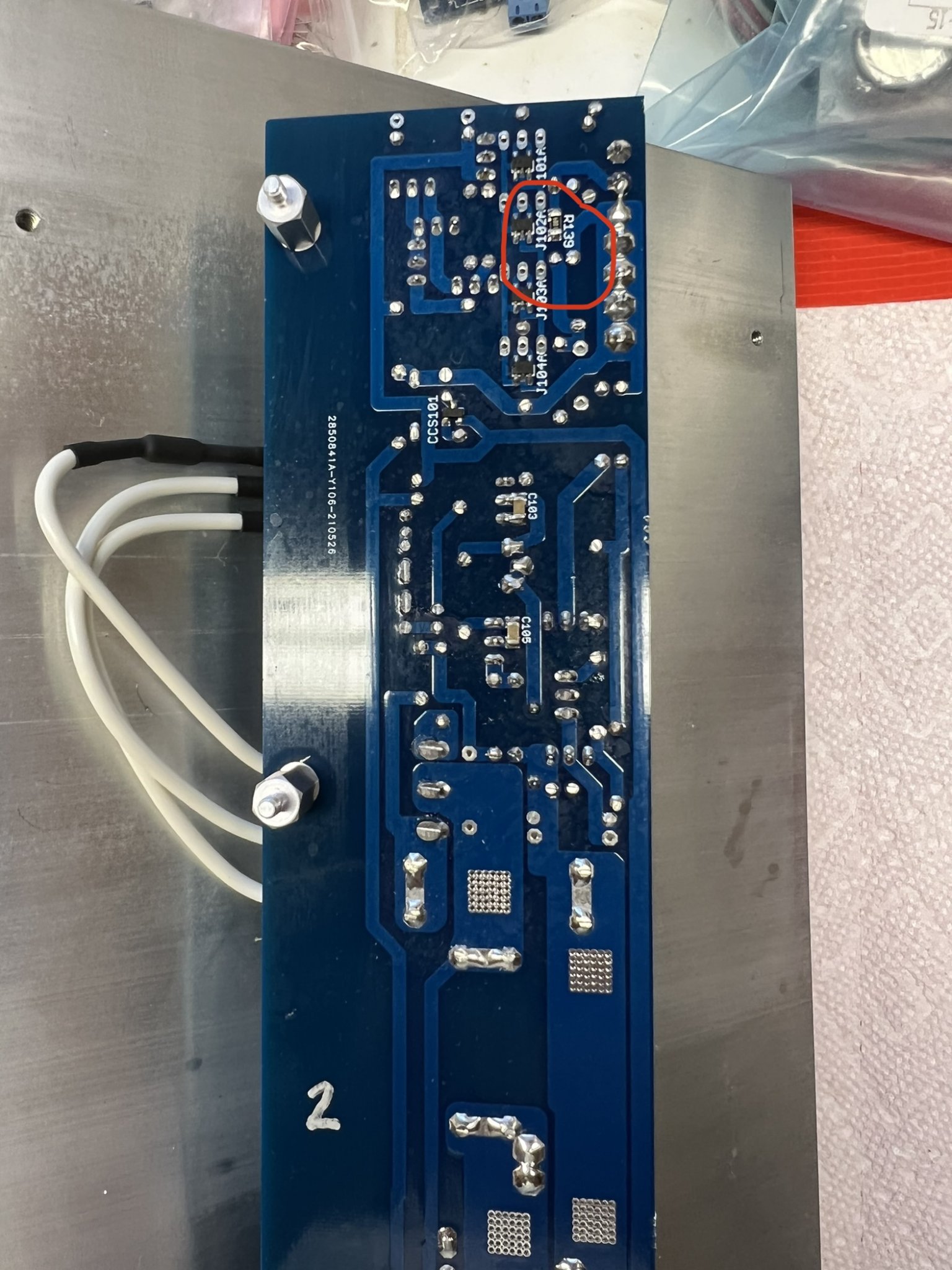

I went back into BJ2 amps today.
I reversed ground wiring changes in #2 case for right channel so it matched wiring again of the left channel which I did already test quiet #1 left amp board on and it remained quiet in #2 case.
My intention next was to swap the right channel amp boards of both cases and perform the same test to see if I got the same results of #1 quiet amp board staying quiet in #2 case and etc.
While I had the right channel boards out of the cases I labeled, compared and took pics of both.
In the process I noticed a difference between the #1 and #2 right amp channel boards.

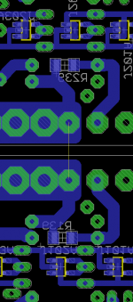

There is a spot for R139 on the #2 board that has a SMD resistor already mounted…not sure of value….I tried to measure it, but there appears to be no resistance due to the fact that I bridged the input (-) to ground as I am using single ended RCA source.
I assume R239 is also present on the #2 left amp channel board…but that I didn’t notice it. I would have to check.
There is no R139 on #1 right channel board…or maybe I’m blind?
My understanding was adding R139 helped amp offset “behave” better using Semisouth.
I’m using all IRFP right now.
Any chance this is causing the noise issue?

R139/239 are additional 1M resistor, only on latest gen of pcbs
role is to prevent neg input floating, just in case someone left both inputs free, it's having nothing with better offset - which is normal functional behavior
anyway , that can't be cause of your troubles

to make DC ofset behavior more friendly, change R139/239 smd resistor value to 100K
or simply solder plain 0207 size 100K across the existing one - use surrounding pads
though, I'm not loosing sleep regarding that - simply grounding both inputs is my regular procedure while setting da beast

The speaker sat closer to the amp on the vinyl seat of a stool.
I made sure not to touch anything else when powering on the amps except the plastic power switch.
The first noisy channel I tested was the one I had just worked on.
It made noise on start up. It seemed like it wasn’t going to stop. After a minute or so I reached to shut the power off…and touched the chassis by accident. This seemed to reduce the noise.
Instead of shutting the amp down, I went on to uncoil the speaker wire and alternate it making contact with the floor while holding the speaker. Noise came and went.
At some point the noise subsided, but never got as quiet as the first set of amp boards.
This really made me scratch my head. I need to confirm that touching the chassis has an affect on the noise.
I repeated the same test on the other noisy amp channel…this time being careful not to touch the chassis.
I got noise on start up. Let it sit and listened. Eventually the noise subsided on its own…but not as quiet as the first set of amp boards.
I let the speaker cable drop to the floor and picked up the speaker. Noise came and went with the cable making and losing contact.
As I said…none of these tests had any affect on the case with the first set of amp boards.
At this point I am wondering if I have more than one issue.
Perhaps there is a grounding problem?
Is it possible that this second pair of amp boards might be producing excessive dc offset from a cold start up that is eventually subsiding as the circuit stabilizes?
When I originally fired up both pairs of amp boards in their cases I followed the same procedure regarding initially setting Iq and adjust dc offset and then allowing the amps to come up to temp equilibrium and adjusting them a few more times. I followed up by repeating the process the next dayfor both amps before I finally tested them with speakers.

In your suggestion #1…680-2n2 is equal to .68-2.2 nF as I understand it?
Not having luck finding anything in this value range in my stores. The smallest I found was some .047 uF in poly, mylar or ceramic.
I did find some 10uF 35V elctrolytic Silmic ii.
R122/222 are socketed…so fairly easy to pull them…add the cap across legs… and plug back in.
I don’t know what proper “up/down” polarity is in the cicuit.
I attached a pic of R122 and surrounding components…can you edit with “+” on appropriate leg of R122 resistor?
