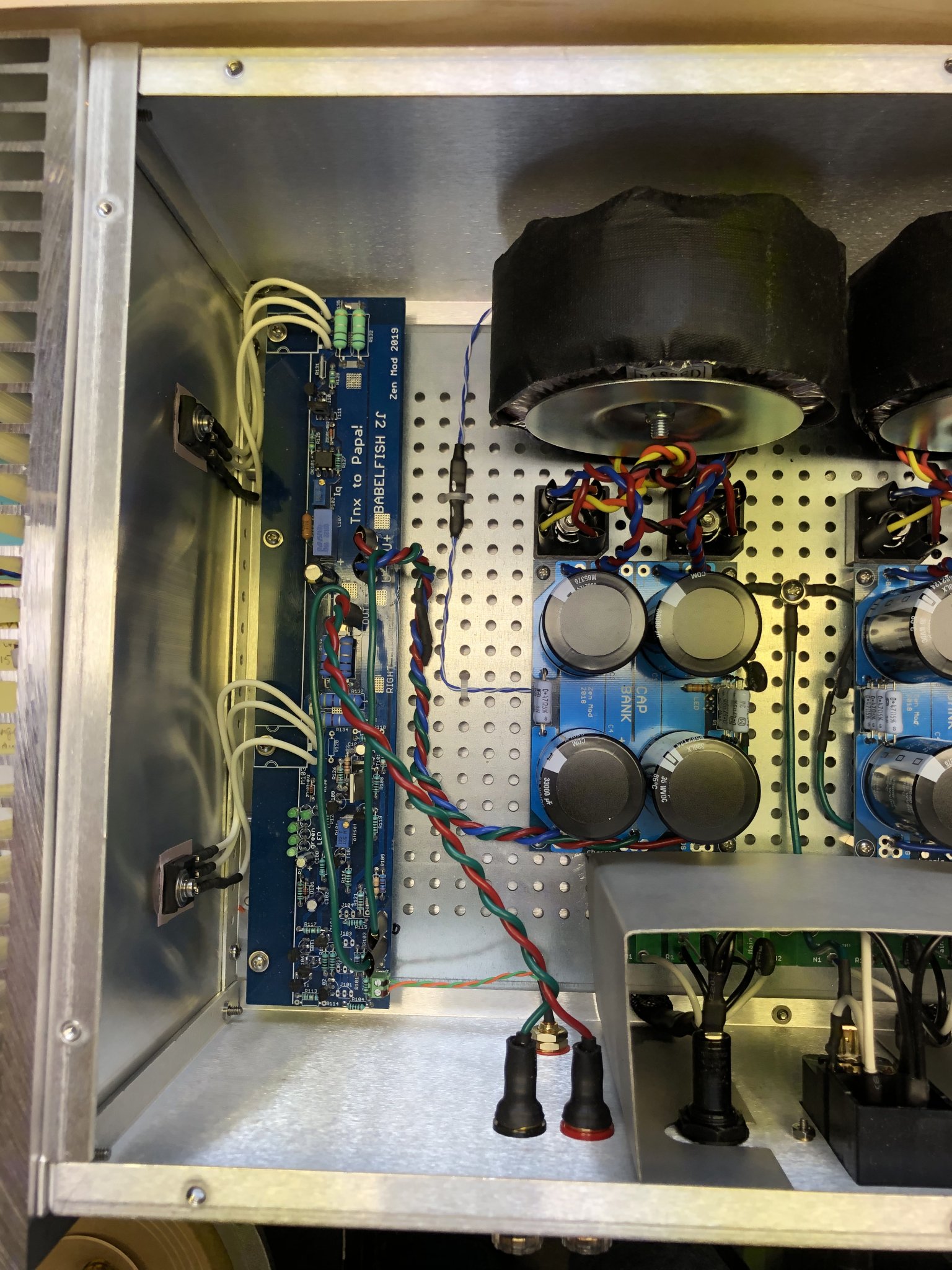

Also, why aren’t the RCA jacks as close as possible to the amp board inputs?
It looks like the RCAs are next to incoming AC power!
To a lesser degree, the speaker jacks don’t need to be near the incoming power either.

The positioning of the RCA inputs and speaker binding posts is due to using a Modushop 4U/400 case I purchased after starting this build as a template for the back of my cases…what could be better right?
Unfortunately…the larger power inlet combined with the desire to build dual mono supplies in what is essentially my equivalent to only a Modushop 4U/300 case required compromises when realizing I needed to modify the back panel to also incorporate seperate fusing for each supply.
The result was everything got crowded I tried compensating by enclosing the incoming AC with a galvanized steel shielding box. It is what it is now.
One amp is perfectly quiet like this…one would hope this was possible with both.
I’ll take a look at the input wiring…can’t remember if the noise lessened while I was fiddling with it. I did shorten it and twist it as much as my clumsy hands would allow inside the case.
BTW…I have some Mogami Neglex 2549 for RCA cables I haven’t built yet…hwould that be for input wiring?…assuming I’d attach shielding only at one end at the RCA input socket?
Thanks guys
Thanks guys

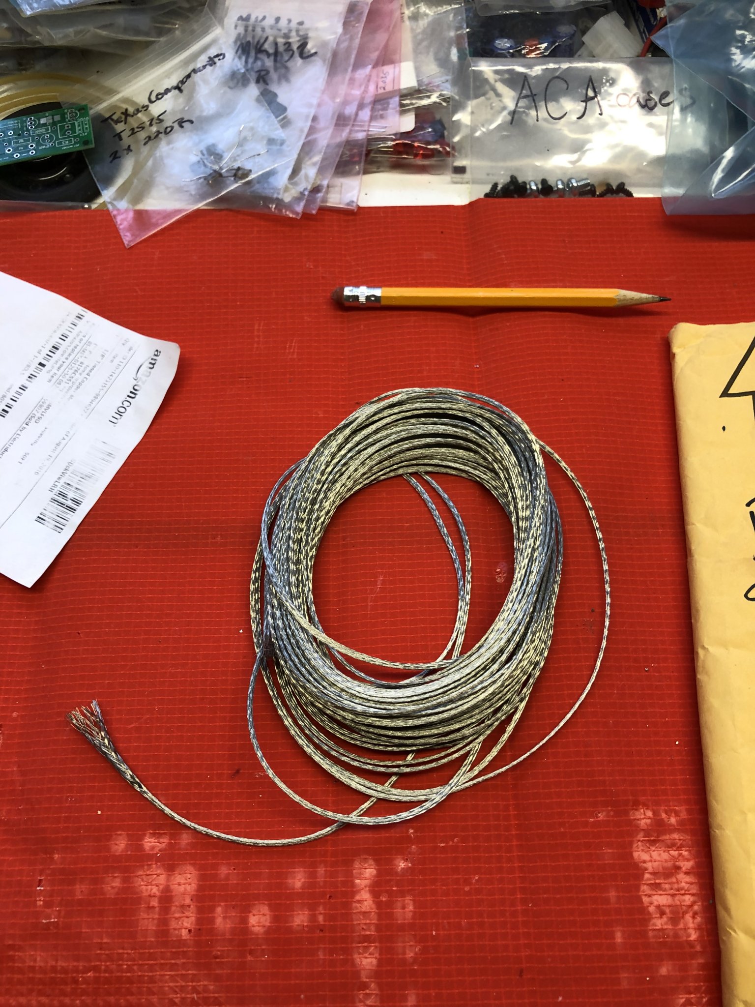

P.S. I have some shielding braid I could try sleeving either DC supply wires or input/ouput wiring with and grounding the sleeve. Worth the effort?

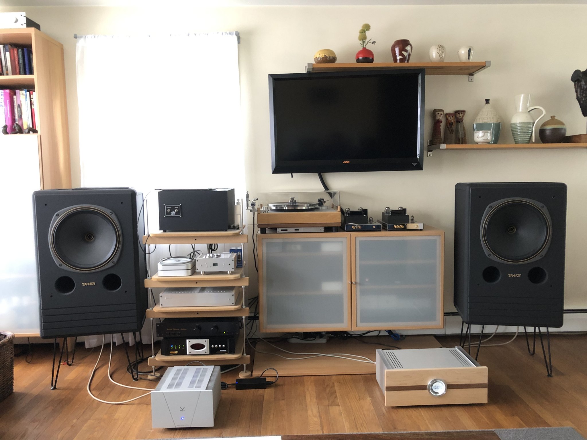

Well, one thing I realized my Audible Dillusions pre is still good for…
Impromptu amp comparisons when one of your matching amps is on the work bench, both your systems are in pieces and you just want to hear some music!
Actually…first thing I discovered was my patch cables were set up wrong for left/right comparison…which gave me the opportunity to play with gain levels between the high/low sections of the Tannoys
The Tannoy crossover is set to “level”. I tried bringing the volume up on the woofer since I’m using both pairs of outputs on the AI to biamp and don’t have my sub being fed a signal.
To be honest, I didn’t feel there was an improvement and actually liked the levels matched between the high/low sections.
I changed the wiring so I could match gain between the VFET amp and the BJ2 by centering the stereo image by ear from my listening position on the couch with the left and right volume pots.
After flip flopping back and forth several times between left and right channels with the volume controls the only real conclusion I came to was that both amps sound wonderful.
If pressed for an observation, I would say the VFET does give the impression of being a little more forward…a closer feeling. There is a lot of “air” in the notes being cast into the room…your left with an intimate feeling with the music.
The all IRFP version of the BJ2 gives off a darker more ambient feel…as if the sound is being cast around a concert hall…perhaps that is part of the recording I’m not picking up from the VFET.

OK…half hearted attempt to get back to solving noise problem with second BJ2…been too busy playing with Sonidos.
Started working by confirming noise on both channels by firing up only one donut at a time. It’s on both.
Focused on powering one channel to see if I could make progress and compare with other channel.
Anyway, I need to test some of my monkey logic on you electronics genius’.

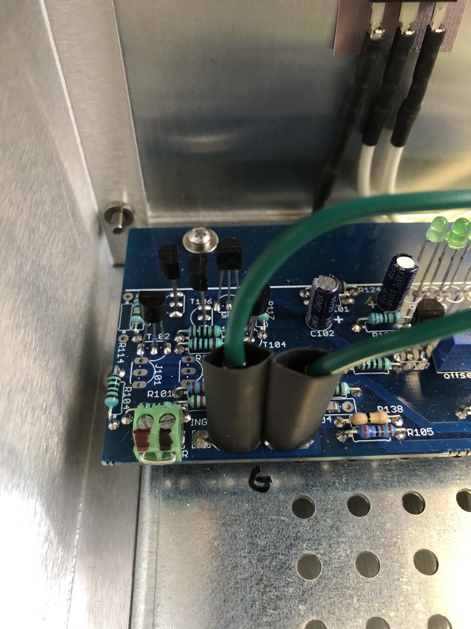

I was begrudgingly sticking hands inside case to start changing out input wiring…then it popped in my mind to test amp for noise once input wires were disconnected…same noise present.
Does this mean input wiring is NOT responsible for noise?
Secondly…while poking around I again noticed moving DC wiring connecting to amp boards changed/reduced noise.
I decided to take a previous suggestion from BenMah(?) on first BJ2 noise issue…I extended the ground wire so it could be twisted with the DC +/- rail wires all the way to their amp board connectors…then ran ground wire to its ground connector on amp board.
Didn’t solve noise…might have reduced it.
I tested input ground resistance to the chassis as well as other two ground points on amp board to see that CL60 was good as had been suggested on first amp.
Left channel gave me 14.5 Ohms, right channel gave me 12.5 Ohms. Not sure why there’s a difference. CL60 I used are specified to be 10 Ohm 6 Amp.
Pulled the chassis star ground off at IEC inlet to see if the IEC was grounded at mounting points as well and maybe creating a ground loop?(read about in other noise issue thread). No ground to chassis at IEC when wire was pulled.
Tested for noise when chassis star ground cable was disconnected. Still there…maybe worse.
Not sure where to go from here.
Is there a way to hook up my computer with REW installed and test the frequency of the noise coming out of the amp?

- thin GND wire solo to channel pcb
- fat GND wire from Cap Bank pcb to negative output terminal
- fat wire from channel pcb to positive output terminal
last two either solo or twisted where you can meet them
When you play with the ground wire from PSU to amp, do you notice changes? I recall getting improvement when I routed my ground wire tight, parallel and behind the board.
I was able to see my noise in REW
The wiring looks good. Can't see the AC wires but I assume that the live and neutral are tightly twisted and they run down the middle of the case.
Rotating the transformers may help. There is usually a position of minimum noise.
Also all of the amplifiers, preamp, and source should be plugged into the same wall outlet, and bundle all of the AC cords together.
As a last resort, drill new holes in the back plate to locate the input and speaker connectors far away from the AC.
