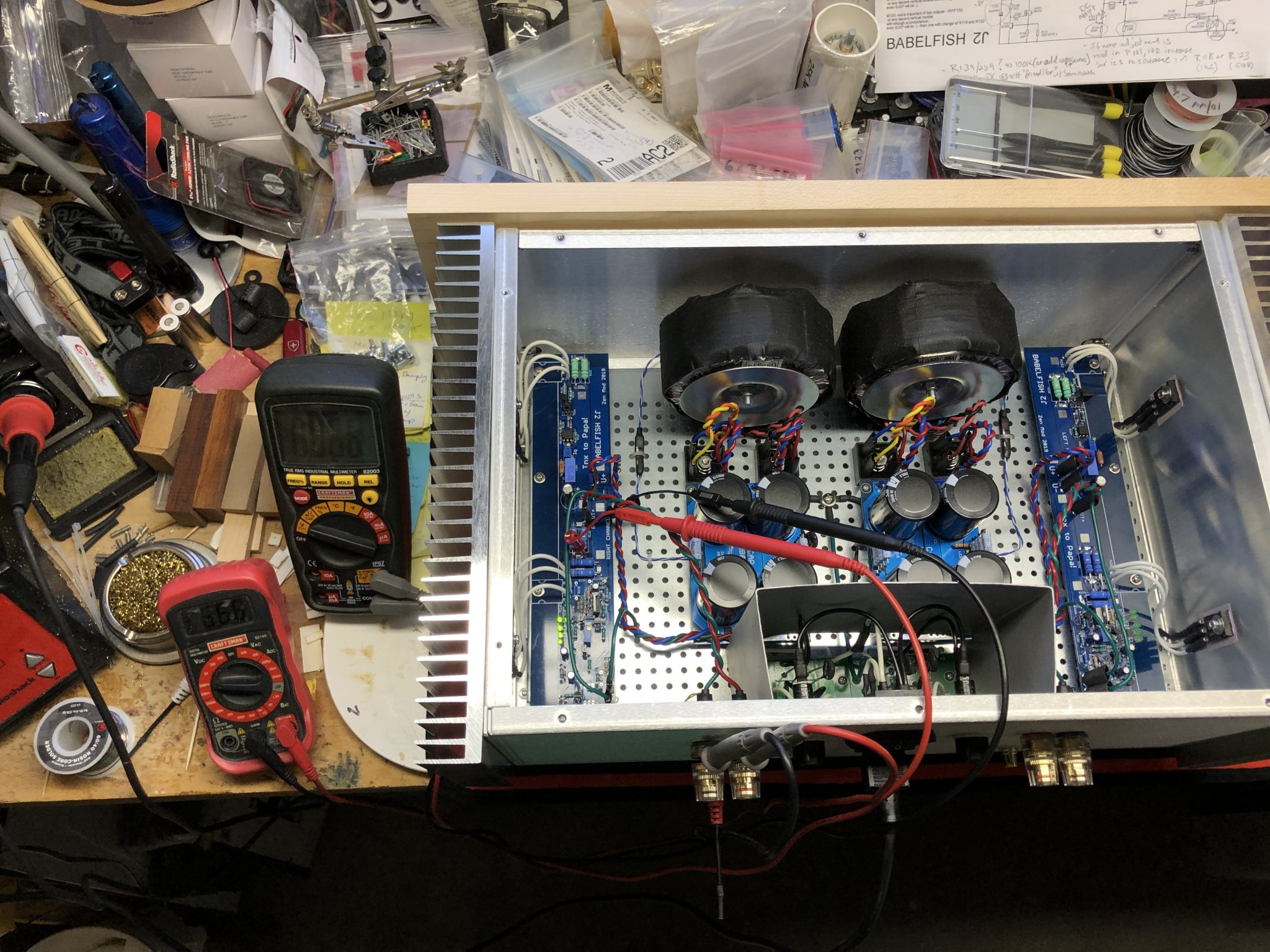

OK…I know this is under “when you cross that bridge” and all that.
Numero Due boards are completely populated…connections ready etc.
I am building this second J2 with all irfp150 initially as I did Numero Uno for safety of unobtainium Semisouths to be added afterwards.
All that’s left is to put boards in case, plug in all power and signal connections and “fire in the hole!”
I have installed sockets at R118(218), R122(R222)and R123(R223) as with previous set of boards.
Their values are set as:
R118=820R
R122=270R
R123=220R
Looked back over start up notes and different iterations ZM posted schematics for circuit.
Not going with altered MOX values right now regardless…original values are mounted.
I see a note about DC offset and making it “friendlier” for Semisouth by adding up to 100K across R139/239?
This is tiny SMD on bottom of board that requires pulling boards again.
Is increasing resistance at R139/239 a given to get DC offset to behave with Semisouth?
Can the 100K be mounted now and still allow DC offset adjustment with irfp150 in circuit?
Measurement across R139/239 gives only .5 Ohm or so when I checked.
Someone posted that adjustment to R123 was necessary to get the circuit to work with Semisouth.
I’m assuming that was to achieve a desired bias setting as there is also a note mentioning an increase of values at R118 and R123 if additional adjustment is needed.
Thanks codyt…looks like you were going full Semisouth.
Not sure I’ll have the same set of issues…my intention was to go Semisouth down after building them full irfp.
I could go full Semisouth, but I’m saving part of my hoard to pursue my J fetish further in the future.
Said the hell with it and slapped everything together this afternoon.
First channel of Numero Due is fired up and cooking…no drama as of yet.
Twiddled Iq pot to bring it in line with 670mV that I set Numero Uno at which resulted in a temp equilibrium of 50-55 C on these heatsinks. Took maybe 4-5 turns on the pot as it started out around 750mV when I banged it on.
Had about 150 mV of DC offset…no problem twiddling that out either. Its dancing back and forth 10mV or so around 0.00.
Will wait for it to cook up to temp and twiddle some more…then onto second channel.
I’ll just have to suck it up and pull the boards if I need more resistance across R138/239 once I mount Semisouth down to get the offset to play nice.

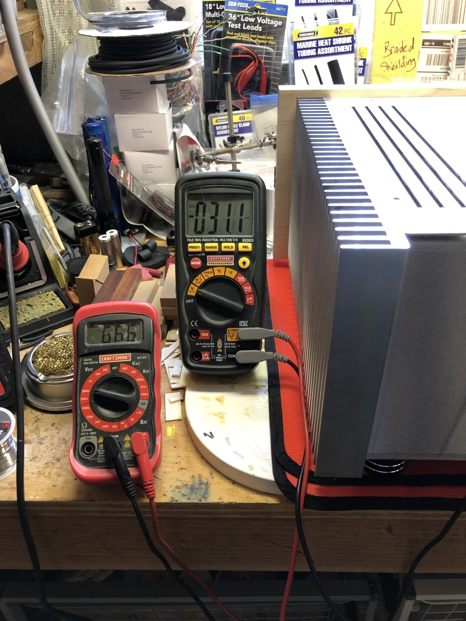

It appears Satan is in my amplifier…no matter how many times I adjust the Iq and heat cycle it the bias seems to settle on “666”
Is this a good or bad sign?…it is Class A after all…👹

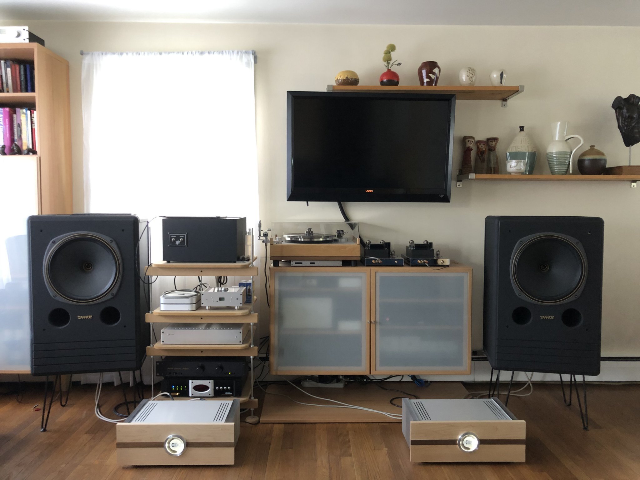

Some impromptu Bi-Amping shenanigans with the Tannoys
The underlying first impression here is ABSOLUTE CONTROL
This sounds so tight…If they could walk…they would squeak

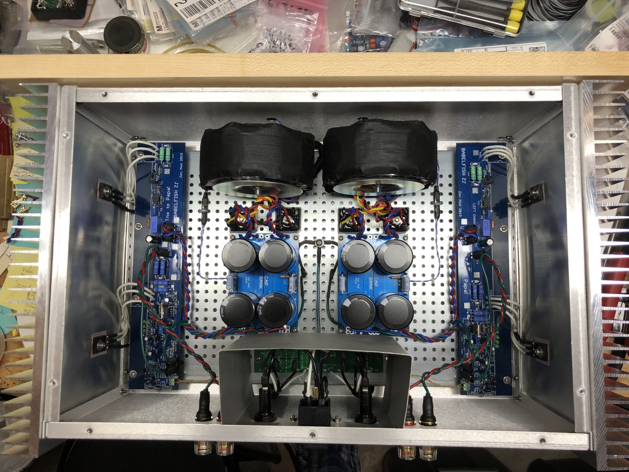

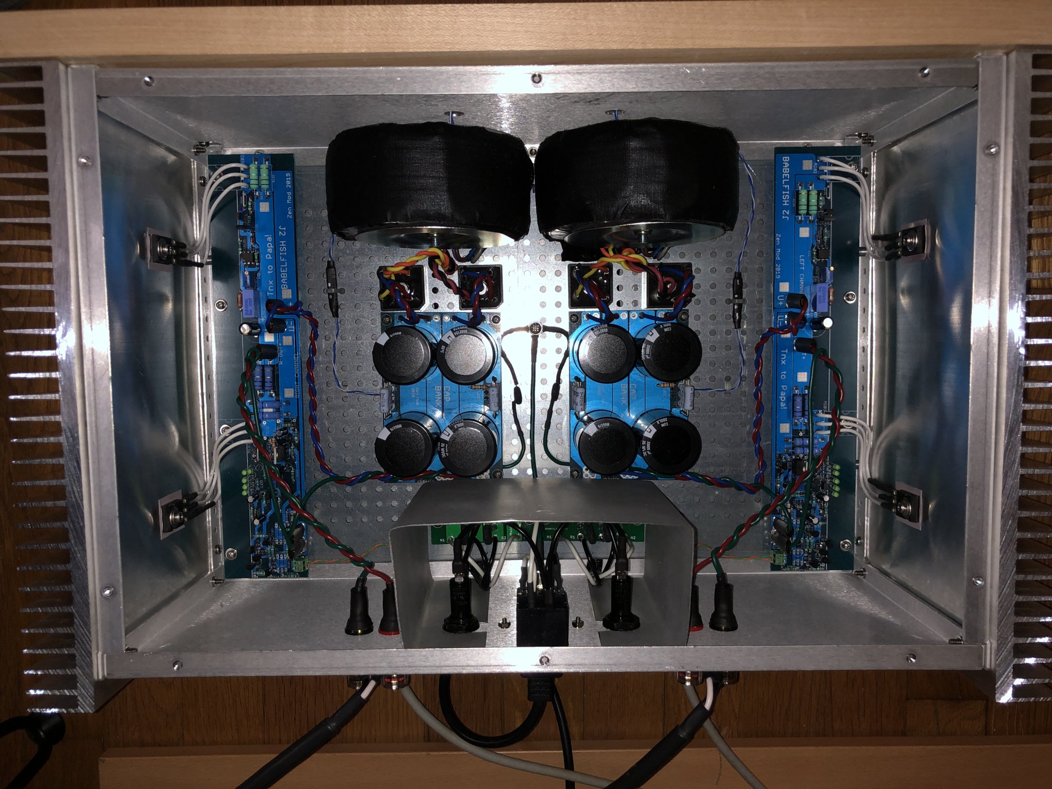

So I was mistaken…there’s drama with the second amp
The noise through the Tannoys from the AI pre was the majority, but further testing with AI disconnected and more sensitive fullranges connected to the amp without a source exposed buzzing similar to when I fired up my first BJ2.
I went back through comparing the build of both amps, only a few things stuck out. A few wires that could be a little shorter. Twisting both pairs of twisted transformer secondaries together. Now, as far as I can tell they’re identical builds.
When I was poking around inside shifting the DC power supply wires running to the amp boards seemed to affect the noise level the most.
I tried pushing the the DC wires away from the transformers and power supply boards under the amp boards and the buzzing got quieter. They were part of what I shortened when I noticed the first amp had slightly shorter DC wiring.
So first one is dead silent…second one has slight faint buzzing.
Not sure if its just bad luck or what…I’d rather both were dead silent.
Any ideas?

both channels buzzing?
well, this is the thing I'm rarely doing, but this amp is of those benefiting with coax cable to input
so, that's first thing; simple test - if you close input twisted pair with your fingers, and there is less buzz, go for coax
