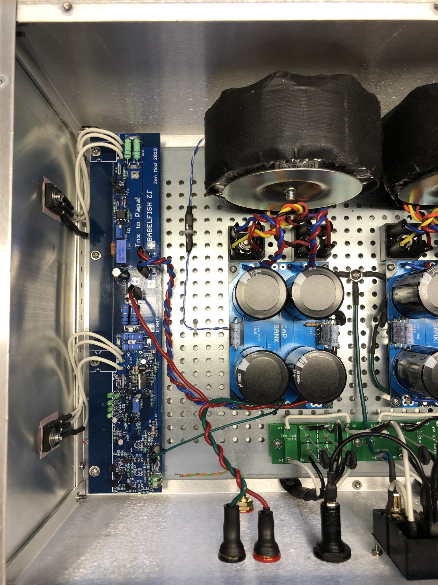

OK…I rewired as you requested ZM…I think.
Pic is a thousand words.
All my wiring was 16 gauge.
Kept 16 gauge for +/- DC rails from Cap Bank to amp board…twisted as requested.
Connected 16 gauge ground cable from Cap Bank directly to negative output binding post.
Kept 16 gauge from amp board to positive output binding post.
Twisted the two as they allowed.
Added small 22 gauge ground wire from amp board to ground on Cap Bank.
Left input grounded with mini jumper in place.
Fired up.
Noise is at least times worse.
Sounds like transformer humming out of speaker amplified.

When you play with the ground wire from PSU to amp, do you notice changes? I recall getting improvement when I routed my ground wire tight, parallel and behind the board.
Noise was changing when shifting +/- DC rail wires which ran twisted only partially with ground (about 1/3 distance).
Afterwards, I extended ground wire to twist the entire way to +/- connectors on amp board and then to its connector on amp board.(previous pic Ben commented on)
Noise level was reduced I think, but not gone.
Shifting wires afterwards no longer had an affect on noise level.
Do you have a pic of your amps internal wiring?
Yes they run under the base plate twisted.Can't see the AC wires but I assume that the live and neutral are tightly twisted and they run down the middle of the case.
Rotating the transformers may help.
Tried that…both directions…no dice.

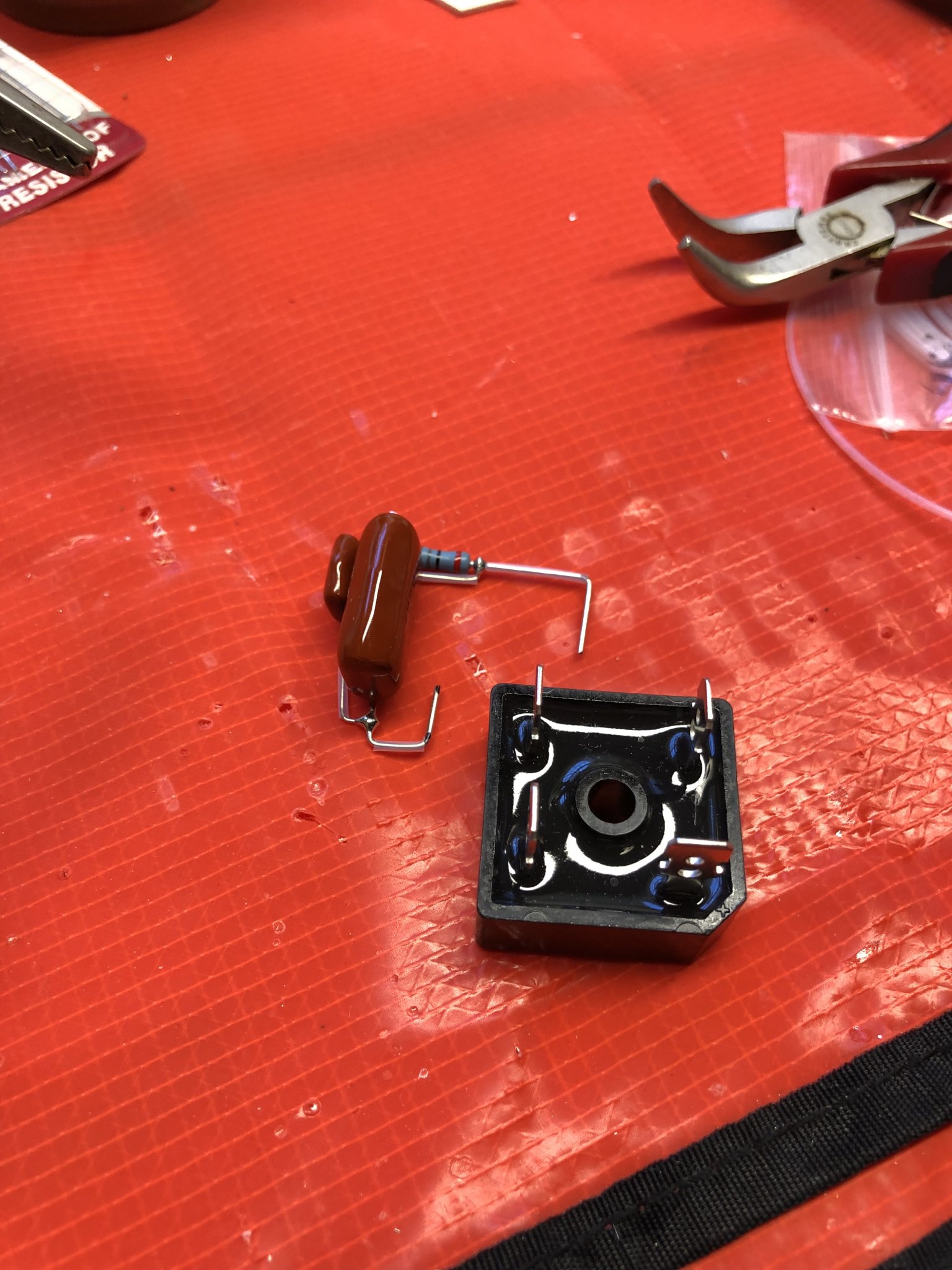

you can use non-scientific dummy ZM approach in this case - make quasimodo filter using more or less most common values of 10nF and 150nF caps, and varying resistor value ..... starting from 47R and going down, simply relying on your ears to spot some difference in buzz, both at spk output and from xformer itself

18R works like a champ if you’re using independent secondaries and Cx 10nF and Cs 150nF”
Found some extra 10nF 250V WIMA film caps I ordered for Bi Amp crossovers
Desperately searching for a 150nF in my various boxes and bins…no luck so far
I haven’t seen the circuit of how these should be wired into the supply yet…I’m assuming it should be between the transformer and the Cap Bank?
Wondering what the resistors need to be rated to?

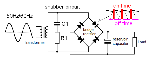

look no further, first or second page of data thread is having exact picture - one filter per secondary (so prior to bridges)
resistor regular 0207 size, caps 100V
post #17 https://www.diyaudio.com/community/threads/quasimodo-results-only.313202/post-5692124

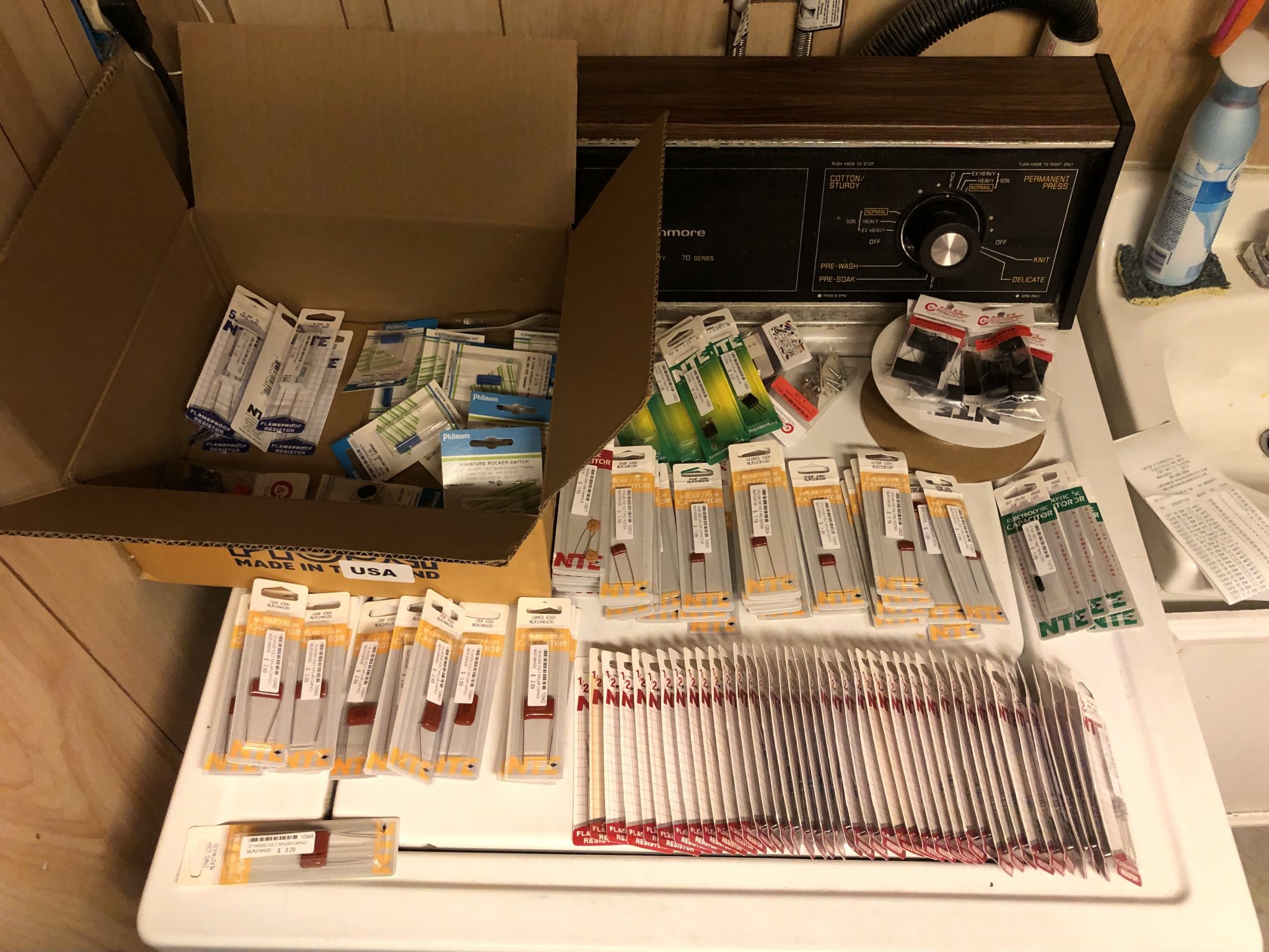

Yes…that was a brain fart that was still bouncing around my head when I made a run to the only electronics store I know of in my area…about 40 min drive.
As soon as I started asking the owner about stock and was trying to convert pF, nF, uF in my head I realized my mistake.
They have limited generic mostly NTE stock…similar to old Radio Shack which are all but gone now.
Worse news…he wants out to retire. Either business sells or he closes the doors in 4 months.
I was in dispair as now there will be no emergency source anywhere nearby.
I lost my mind and started buying anything similar to what I thought I could use for snubbers and a few other things I had in mind.
Luckily, he gave me a nice discount off retail pricing.
Picture of haul and best matches to what we said should work for Quasimodo.
They are Mylar film caps. I found a few 100V electrolytic @ .1uf…and the only Polypropylene caps in the store which are 250V @ .1 uF and .22uF.
Resistors are standard metal film .5 watt 2%…so should be OK…got a whole bunch of values from 11-47 Ohm and some others since I don’t have many in the drawers.
Any issues with using Mylar for the snubbers?…hope not

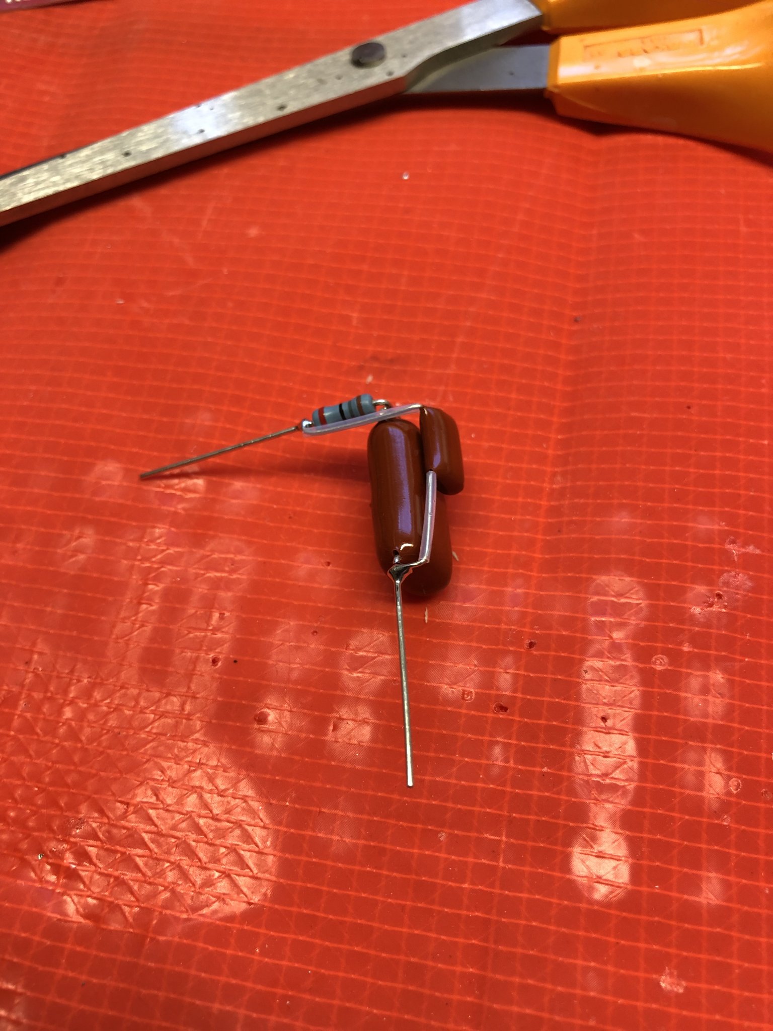

Thanks ZM…even better was Mark’s Quasimodo pdf from the thread.
When I first glanced it over, I thought it was simply devoted to explaining the Quasi and testing with it.
Went back and discovered a complete explanation of the snubber circuit along with values used and placement a few pages into it.
Hardest part was trying to figure out how to build and integrate it with such limited space in between the transformers and rectifiers.

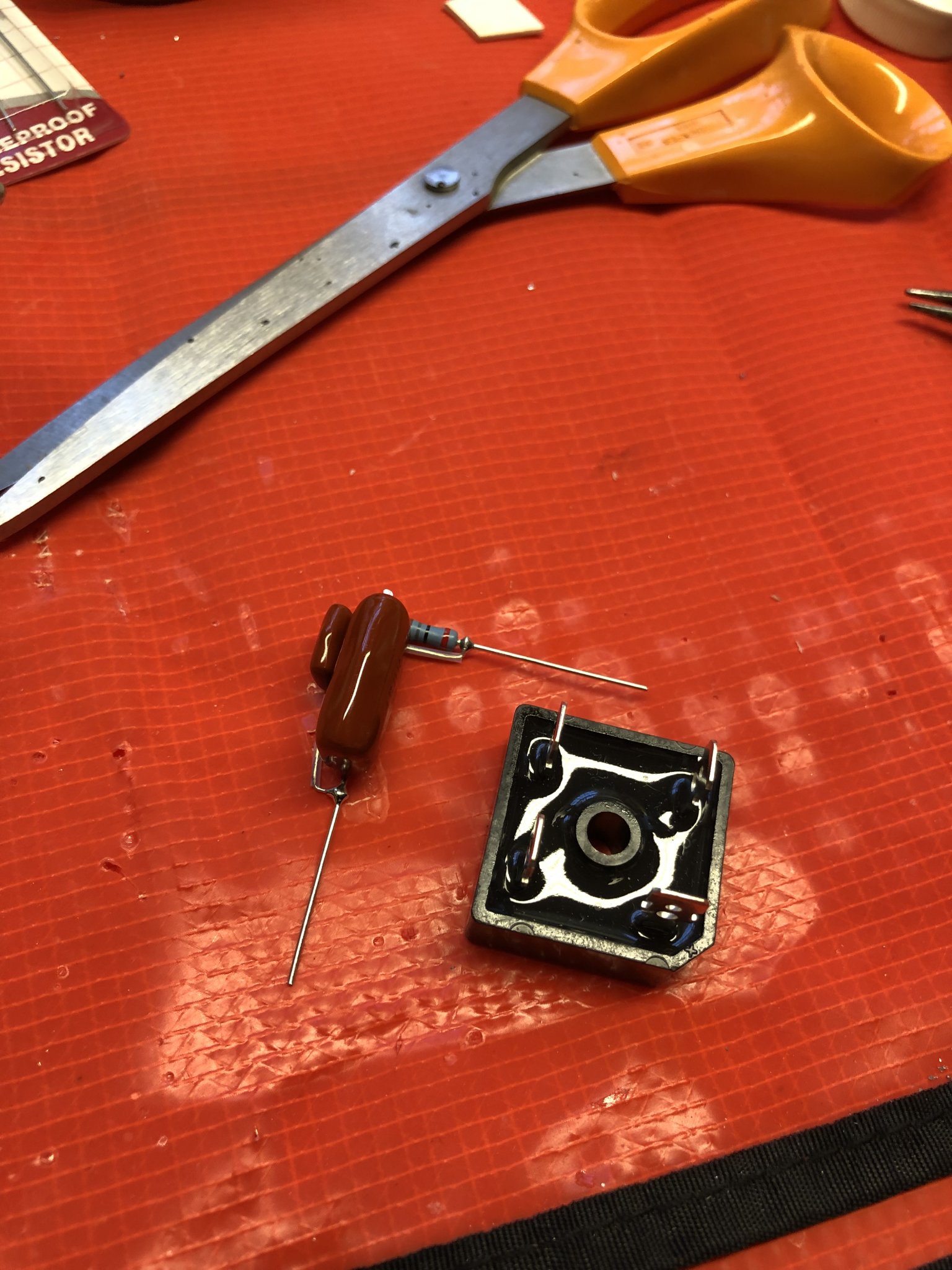

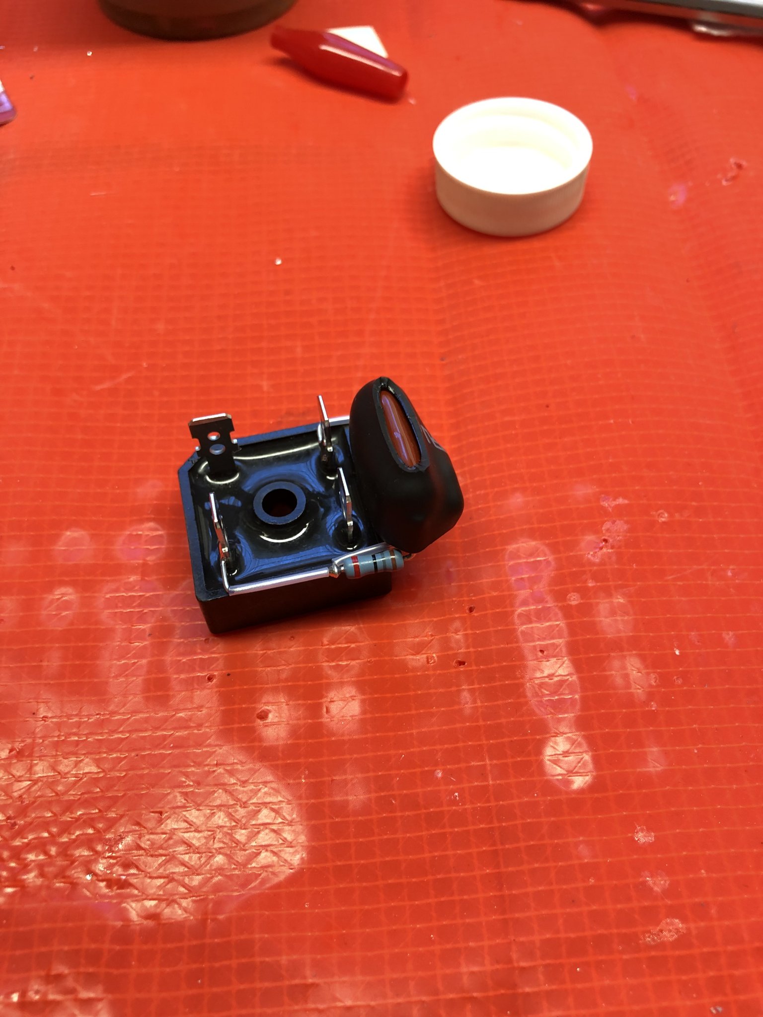

Finally got some time yesterday to pull out a pair of the bridges and add snubbers.
My daughters dance recital is today…not sure if I’ll have time to get them back in and test…
