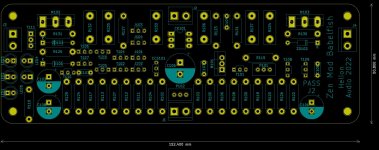

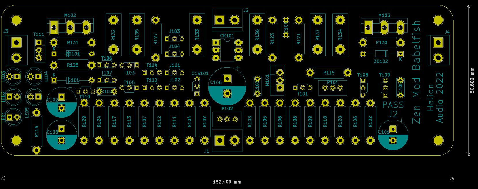

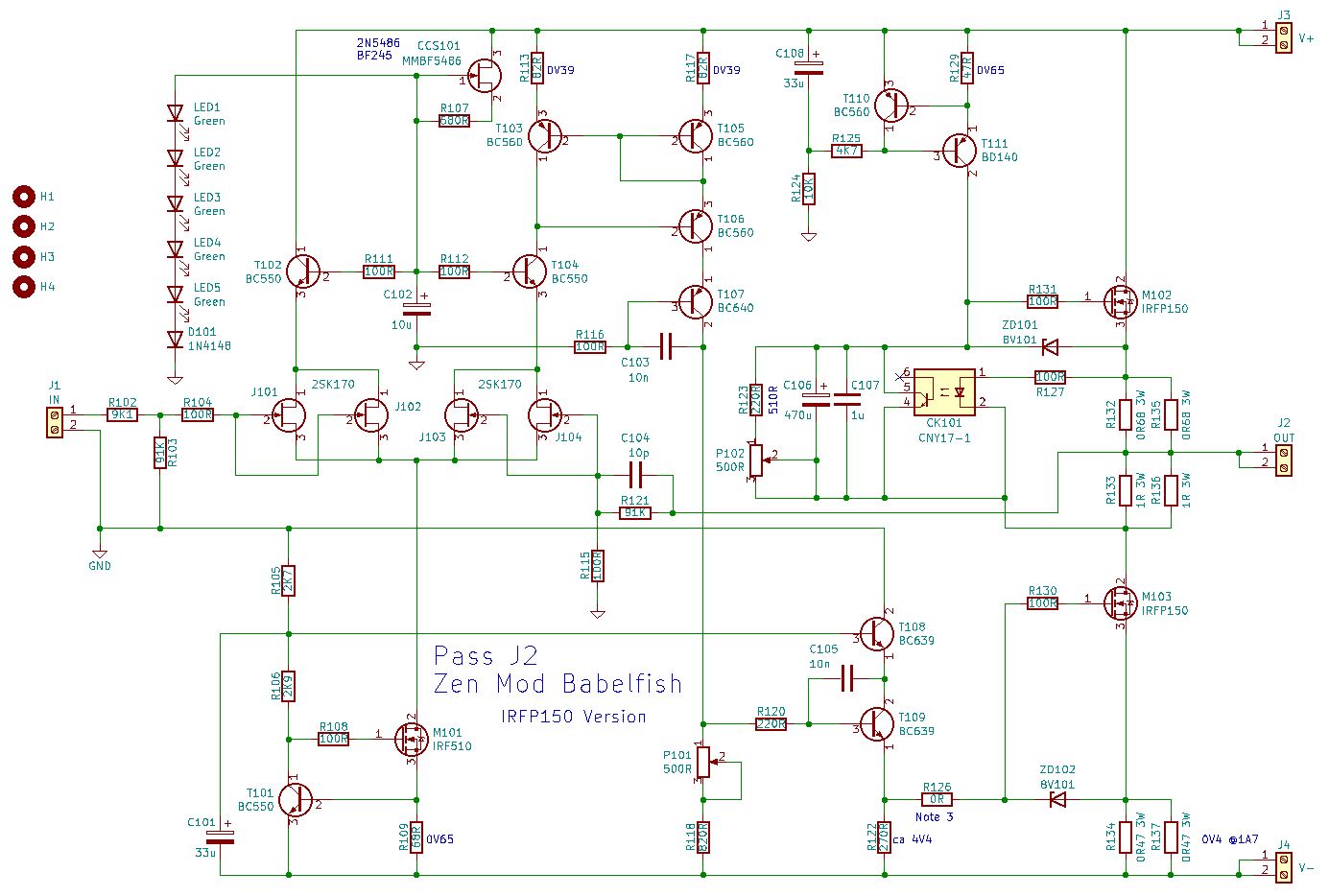

I am making a PCB for the IRFP150 version of this amp. Could anybody give this schematic some seconds to see if I got it all right?
Thank you!

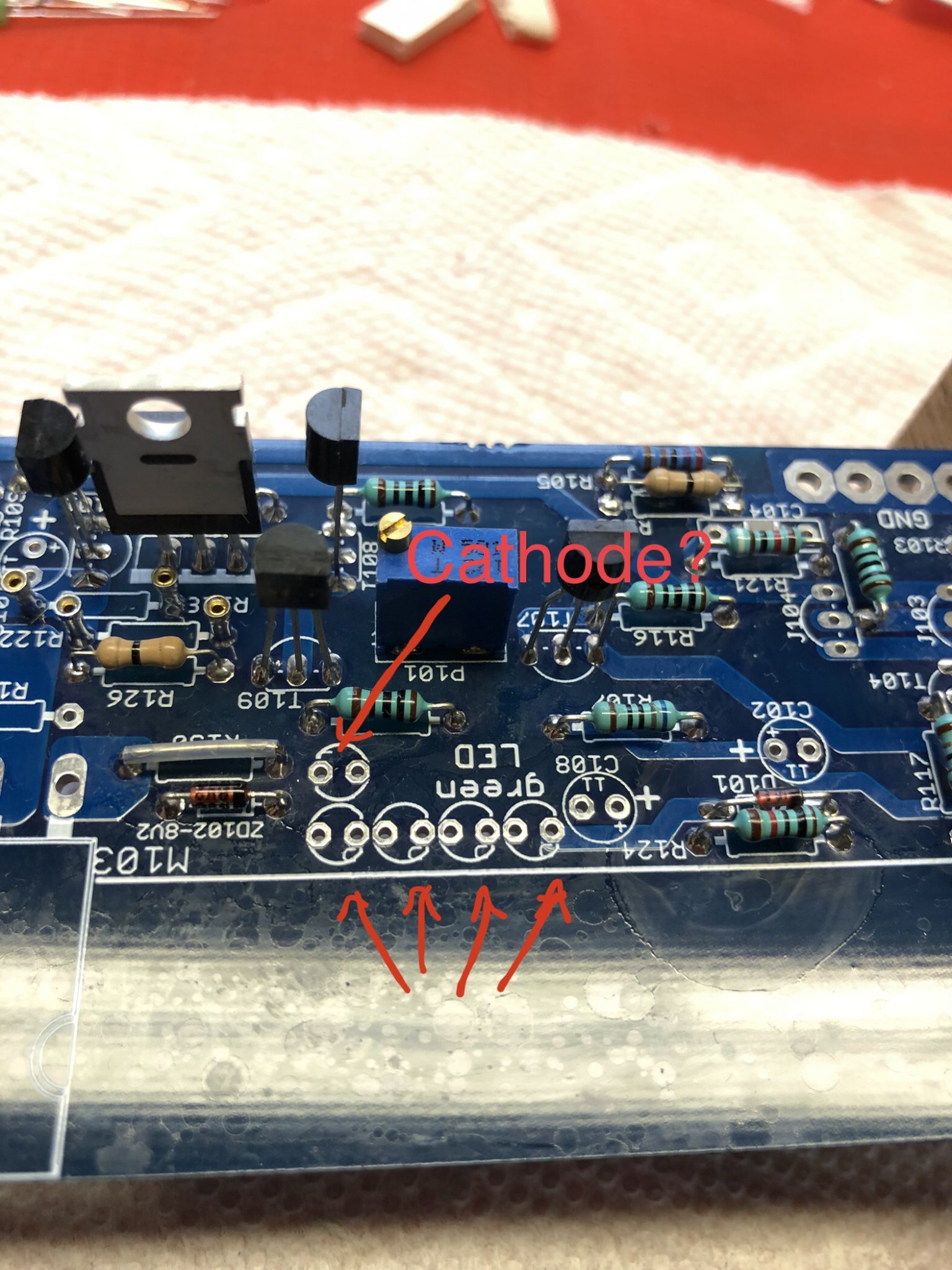

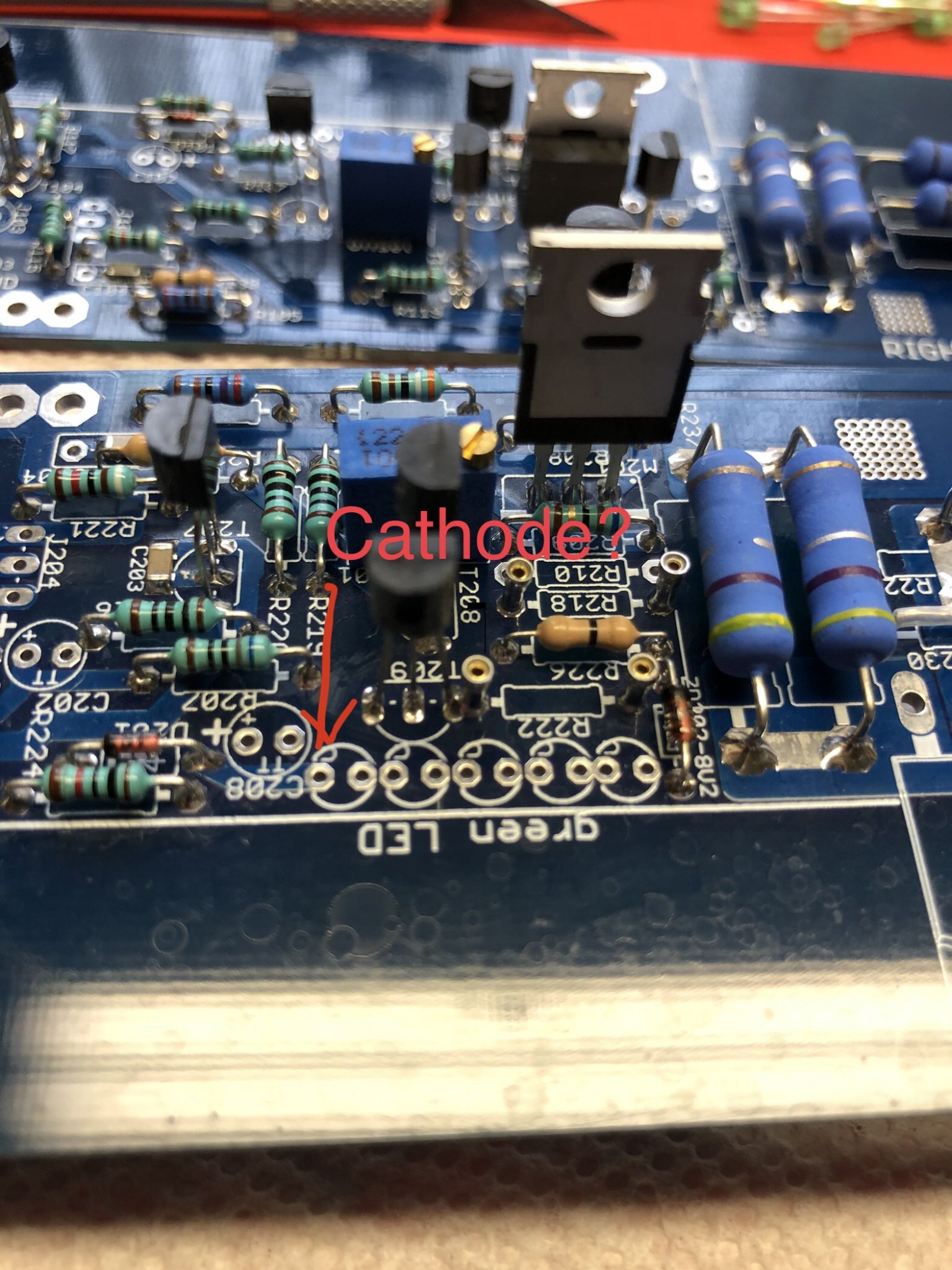

Just want to double check trixy ZM’s secret LED mounting code…
These squiggles near pads are “C” for “Cathode”?
…and last one on Right channel board is extra trixy reversed direction?

just keeping things exciting…I start doubting my memory and have to take breaks to avoid assumptions and mistakes!
So far this set is going pretty well…only had one mishap mounting T104 backwards…was lucky that I caught the mistake with fresh eyes when I sat back down to it
