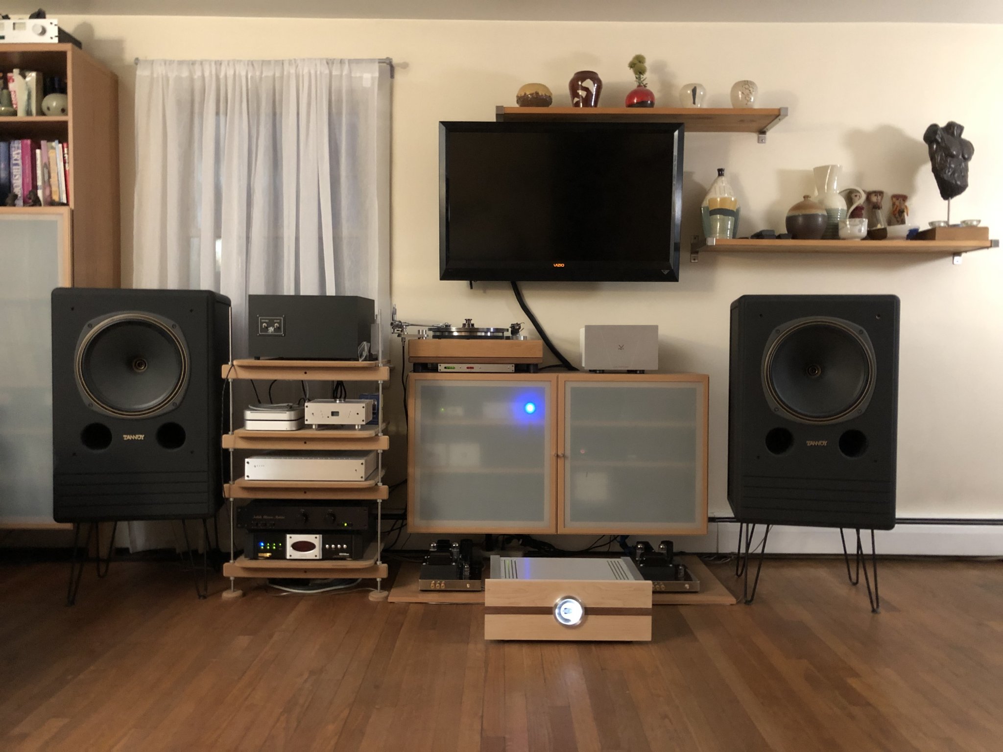

The speakers are something I continue to play with.
Fullrange drivers have held my interest for various reasons for a while. I’ve been through several variations with OB and front horns.
This is my “experimenting” system that I was able to move into the sunroom that I recently finished renovating this past year.
This version uses a pair of Lii Audio Crystal 10 drivers up top I found used at a very good price.
The bottom end is a pair of Acoustic Elegance Dipole 15s I also found used.
I power the AEs with a pair of Hypex FA502 that sit on the floor behind the speakers.
The Hypex are essentially set fullrange with a high pass on the bottom end to prevent any damage to the drivers at very low frequencies (went through that already with another driver in OB).
I manage the signal with a First Watt B5.
The front end is based on a Salas Hypnotize DCB1 which I modified with ZMs help in the KISS thread to have 6dB of gain via some Jensen transformers on the outputs.
I would say this system is what I prefer to listen to when I’m mostly in the mood for small ensembles…chamber music, solo classical performances (like piano or guitar) a good amount of Jazz and Blues performances as well as a lot of Downtempo style electronic music.
No time yet to get her impression since it’s really just singing since last night…plus, she’s busy during the week late earning the “big bucks” so I can have more fun in my hobbies!
She’s mostly happy if I’m happy…and paying a lot of attention to her and the fact that she is beautiful and brilliant!
We like to sit together on the weekend sometimes and listen in the sunroom. I’ll have to pick out one of her favorite Flamenco recordings and see what her reaction is then.

I could not resist an ultra-weakling analog session in the living room with the Tannoys 😁😁😁
The old AI tube pre gives some hiss through the Tannoys…its not disagreeable…just not as quiet as my DCB1.
They actually make lovely sounds together.
I can now sit back and enjoy for a little while…and decide what is most important to build next.

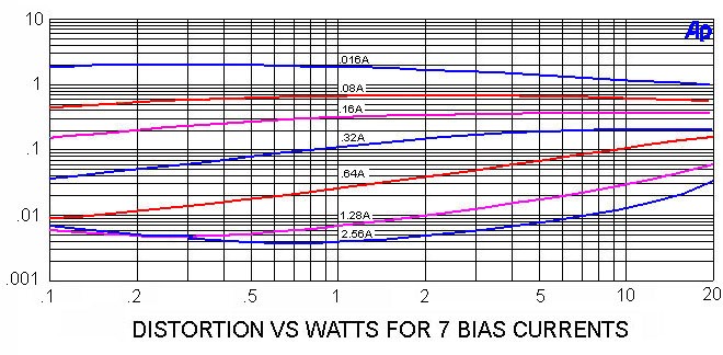

So the question that arises is: Can I increase the bias setting…or do I want to?
The system plays plenty loud for my taste with that particular preamp…and only set to the middle of its level range.
Is there anything to gain regarding sound quality if I increase the bias but don’t need the extra power?
BTW…this was with no IV stage on my DAC only IV resistors…which I have sort of accepted, but had been considering a few IV stages to add gain.
Of course recording levels and results have varied.
These are not the warmest conditions the amp will encounter.
I will have to monitor the amp’s temperature in both systems over some time I think.
If I remember correctly, it did get hot when it was in the sunroom system with the open baffle system.
I’m assuming this is because it was only driving the fullrange driver from about 150Hz up with the active crossover.
With the Tannoys it has to drive the 15” and compression driver through the passive crossover
heat - what you meet first - allowed dissipation per device or allowed temp on heatsinks
say no more than 45W per mosfet (decent thermal arrangement is a must) and sinks at 55C in Summertime
of course, there are differences with more Iq, I like them in most cases, but how much and will you like them - your taste
That's a good question. Take a look at figure 3 taken from the article "Leaving Class A" from Mr. Pass. You tell me.... What does increasing the bias current do??? (pro tip... we run our stuff with as much bias as the hardware will take, but not so high that devices fail. Goal is fantastic sound....forever....)
