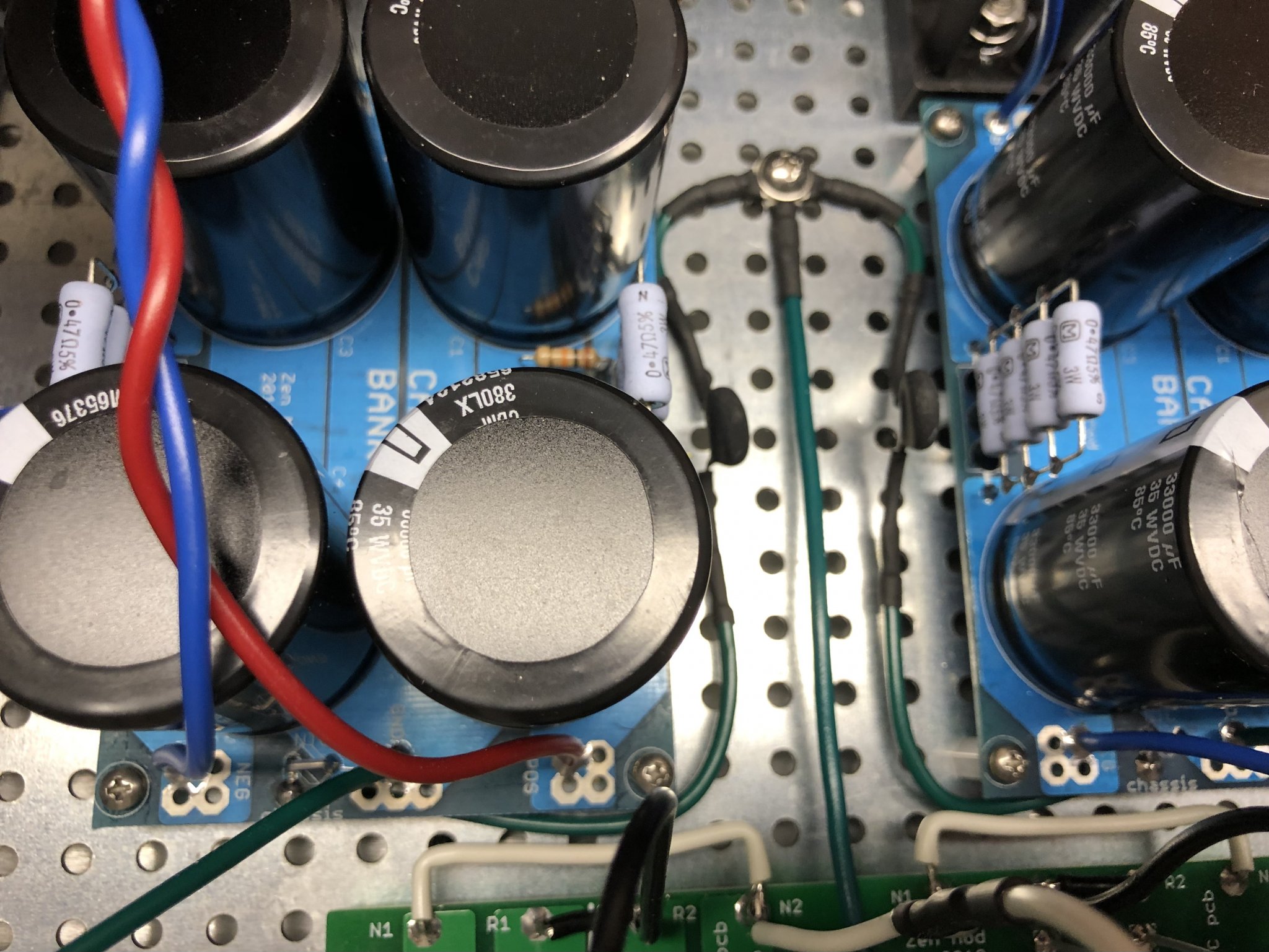

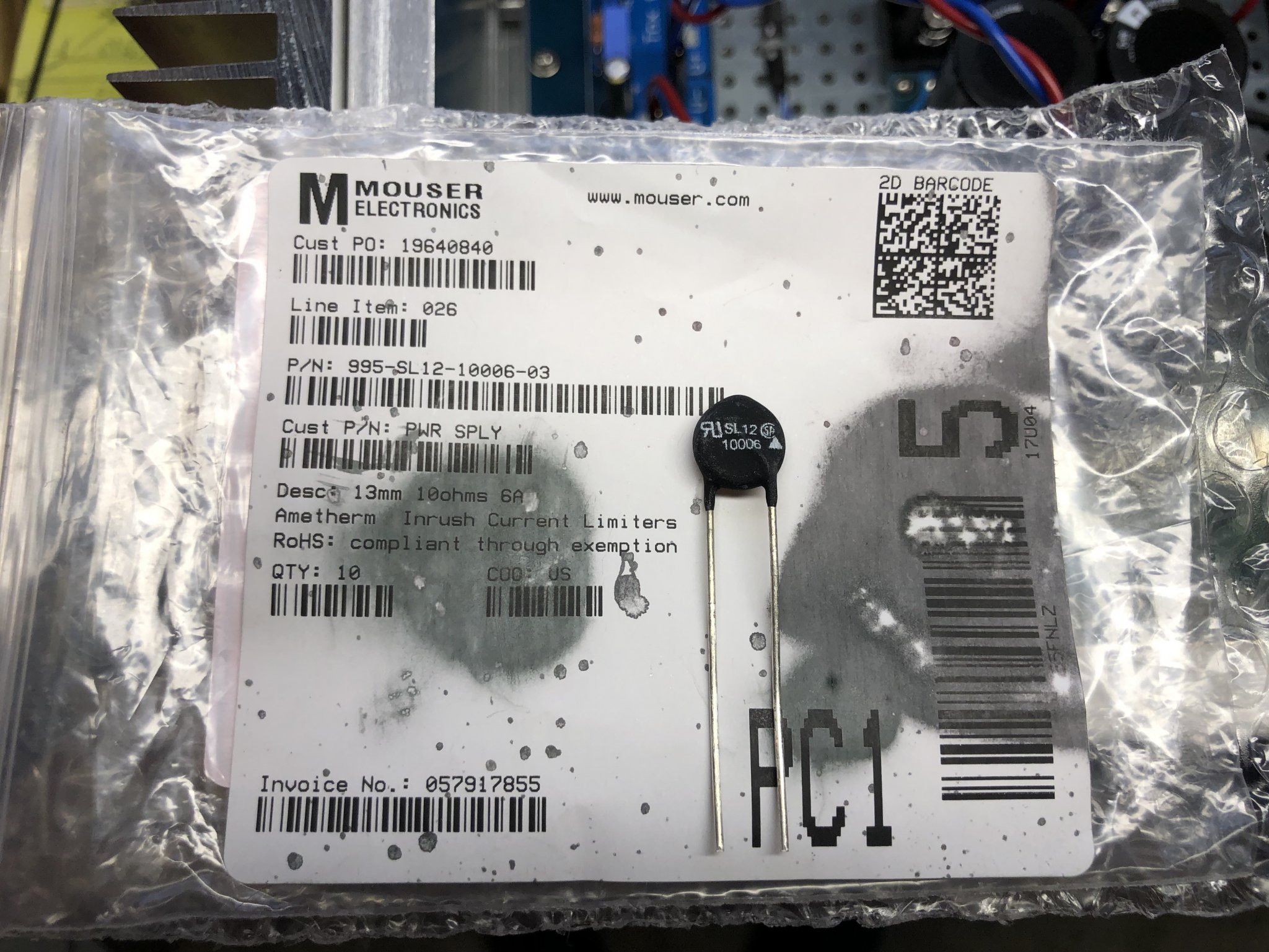

can't see from that picture - do you have NTCs connecting audio GND and chassis?
small ones , 10-15R, around 10mm Dia, place for them at output side of Cap Bank pcbs
leave second unpowered
The leads of NTCs I had on hand wouldn’t fit in the holes on the Cap Bank PCB. They are 13mm 10 Ohm 6A.
I had to put a jumper in the board where the NTC mounts and then put the NTCs inline between the PCB chassis cable pad and chassis ground point.

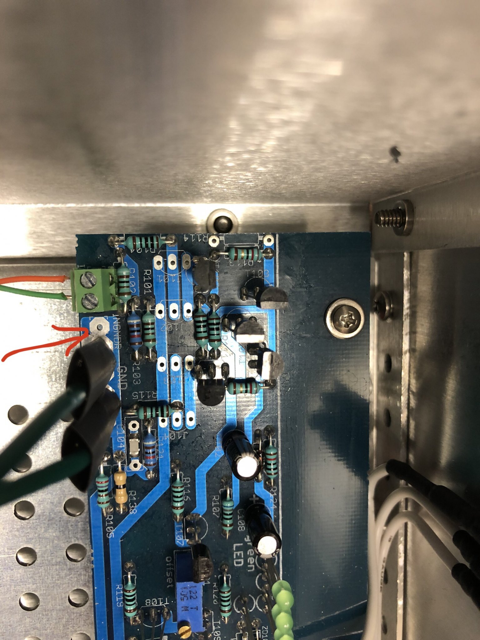

what's happening if you have just one channel powered, input grounded - is there any buzz in (test) speaker?
btw - I see you're using RCA for input; did you grounded Neg input on pcb (that being necessary if you're going for SE input)?

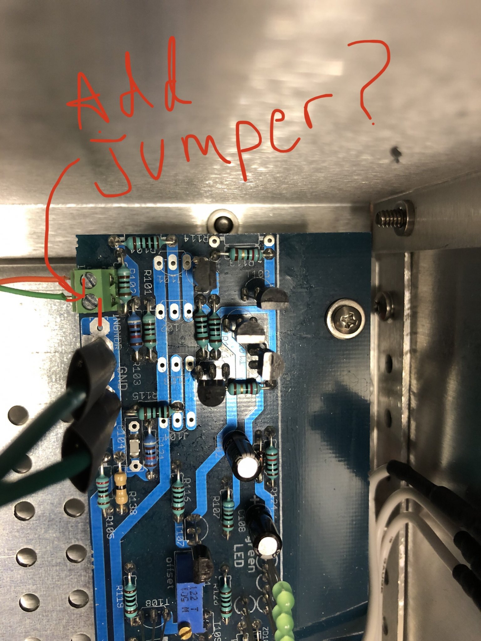

I had noticed the “INGND” labeling on the PCB near the input pads…but didn’t know what to make of it since I hadn’t come across anything in the notes or thread about it…it slipped my mind to ask.
Do I just need a jumper from the “INGND” pad to the (-) negative terminal pad where I mounted the euro block?
well, schematic on page 1 is clearly showing Positive input and Negative input and INGND
that, amp being made to have Balanced ( XLR) input
when you want to use SE (RCA) input, your signal Hot goes to Positive Input, Signal GND goes to INGND, and Negative input must be shorted to GND ( InGnd)

you can leave euro block (argh!!! piece of drek)
just make short/bridge between GND and IN-
same as you need to do when you're making Aleph J
RCA Hot goes to IN+
RCA GND goes to INGND
IN- shorted to INGND
RCA Hot goes to IN+

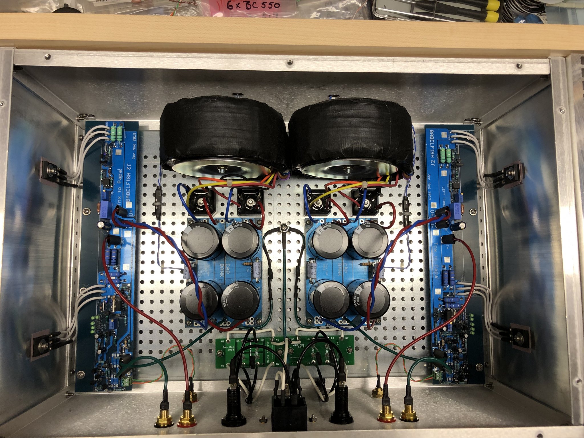

I pulled the amp cover and continued to try different variations of the source, speakers and etc. to reconfirm what was going on.
At one point I started to examine the power supply and signal wiring again to see if the noise would change if I shifted things in any way in the case.
I lifted the twisted power cable that runs from the cap bank to the amp boards and it made a noticeable difference in the level of the noise…but it didn’t eliminate it. Pushing the cables back down toward the top of the caps caused it to get louder again.
I can’t help but get the feeling I’ve done something wrong with the supply and case layout and its injecting noise into the circuit.
I’m not sure what to do to confirm whether the power supply is the source of the noise or not.
I’m open to suggestions as to how to proceed.

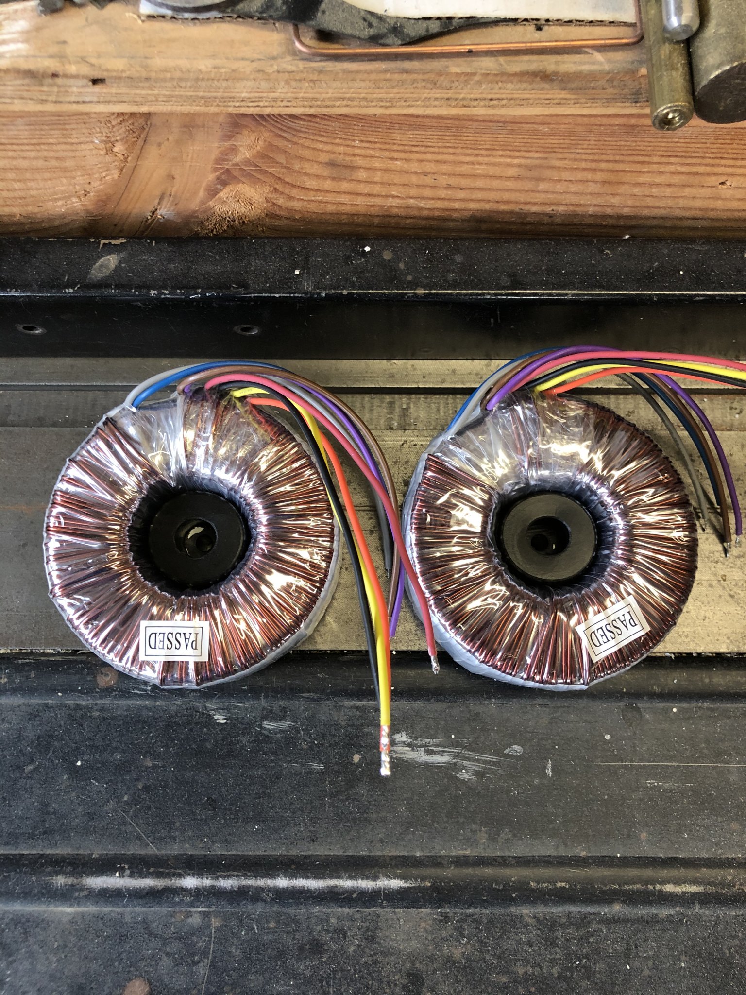

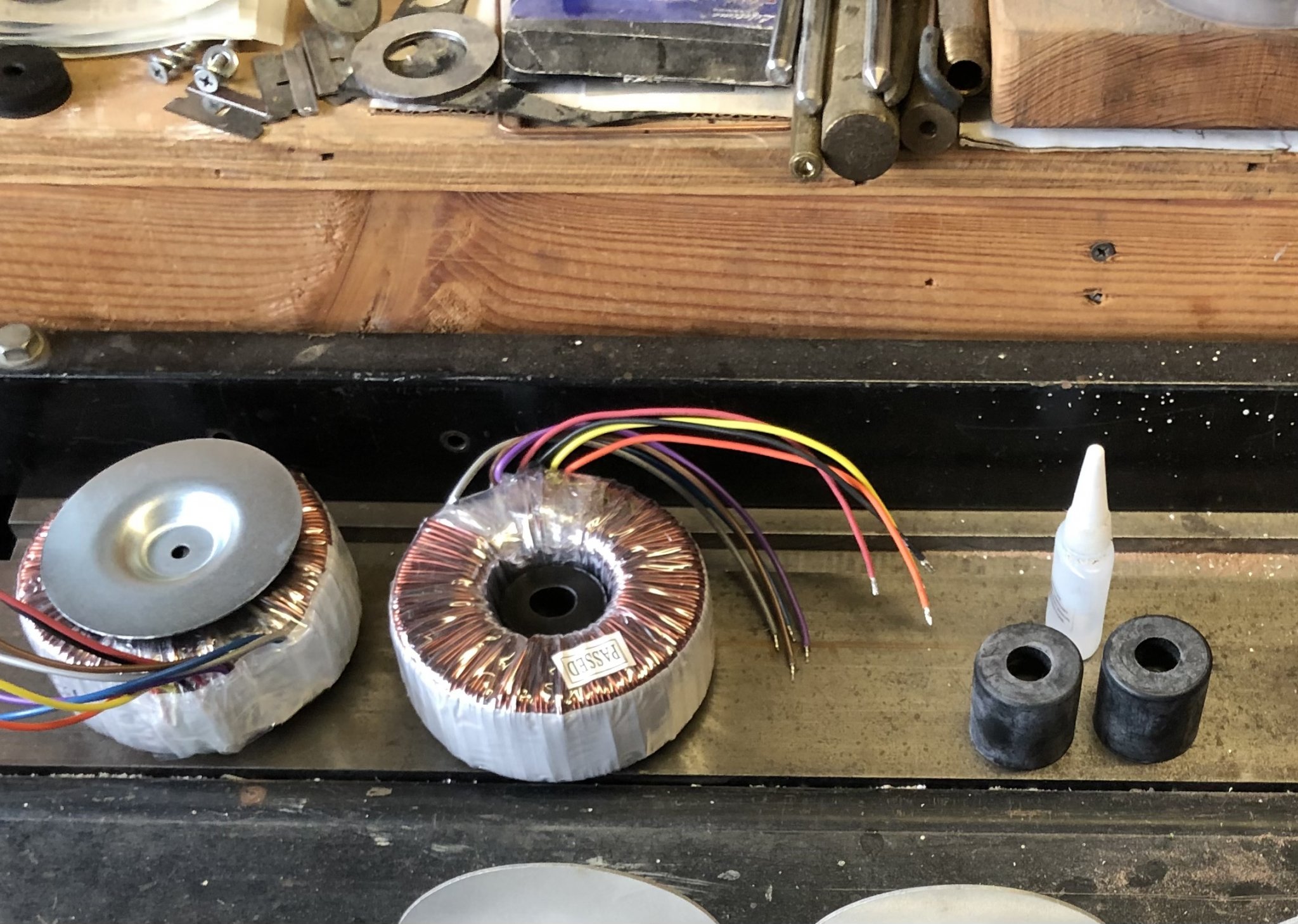

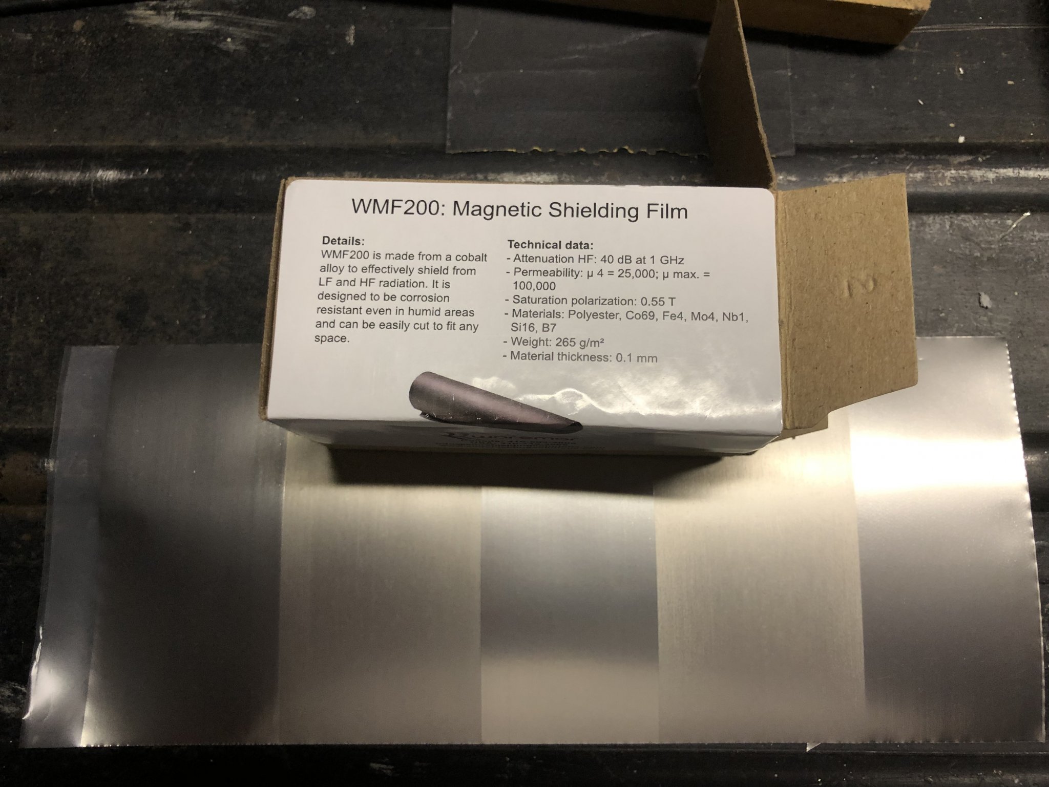

Something I’m wondering about after considering what might be wrong due to my power supply…I worry it might have been a bad idea when I thought it would improve things.
I wrapped my transformers with a shielding material to help prevent noise issues if I ever installed an amp in these cases that used signal transformers…as I think I saw ZM did in one of the SissySIT builds for a friend.
Its taped in place around the periphery of both transformers.
I’ve attached a pic of the shielding.
Could this actually be having the opposite affect by being taped directly to the outside of the transformers?

I will revisit your pictures tonight, hoping to see something fishy
if you wrapped that material simply around Donuts, isolated and not being connected to anything ( chassis), then you did good
my Donuts Vendor is doing exactly the same - practically same material used for cores, wound in 3 or 4 layers around circumference, then everything taped with isolation
one thing - check polarity of wires coming from RCA to pcb
@chromenuts -

Hi ZMI will revisit your pictures tonight, hoping to see something fishy
The shielding material wasn’t cheap…mine only goes around once. Who knows if that even did anything except create more work for me.
The shield is isolated…no connection to ground.
My RCA positive and negative connections are connected to the correct pads on the PCB.

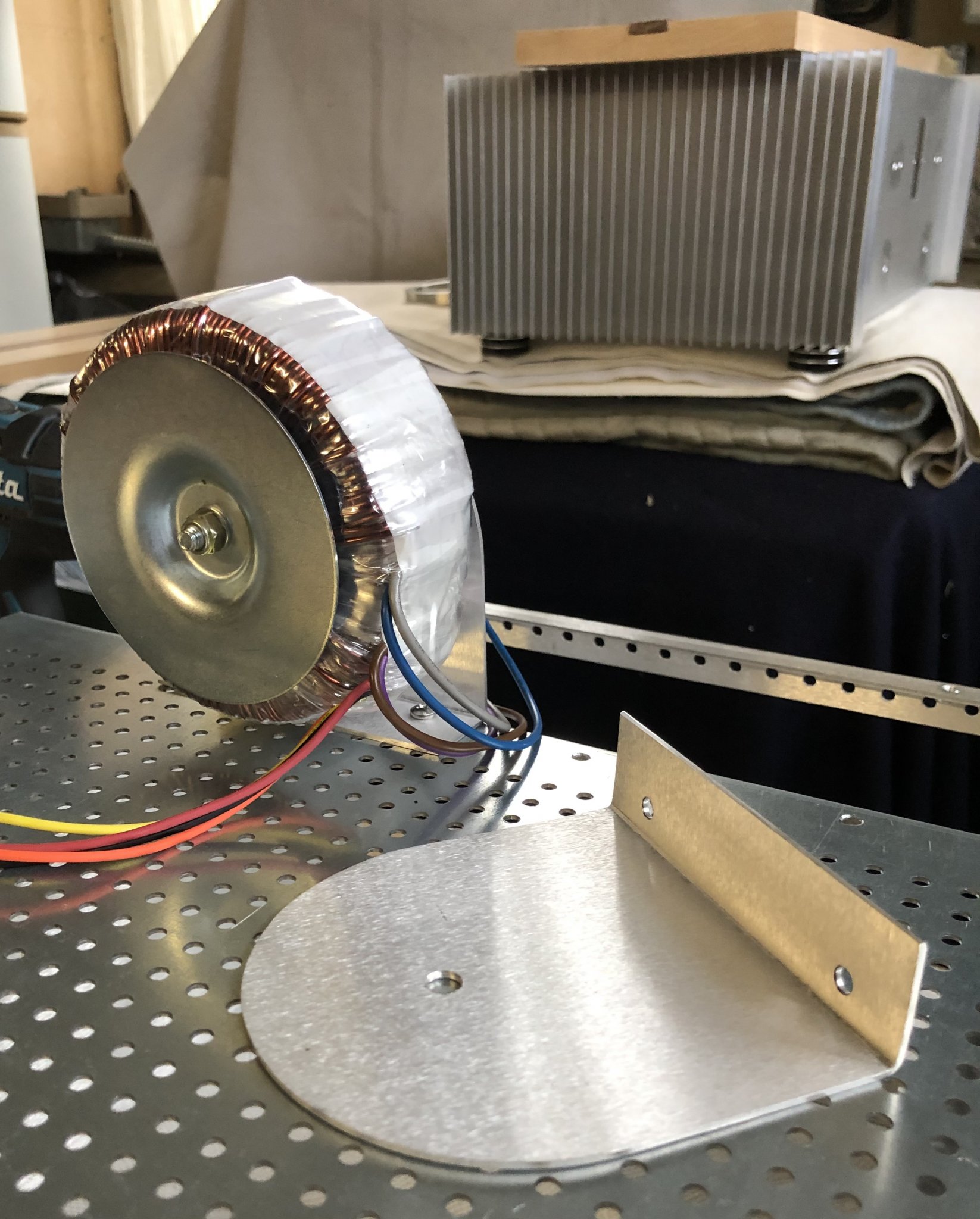

I have thought of one other thing I did that I’m worried might have been brilliantly stupid.
Back in August when I was making the mounts for the transformers we went through the debacle of how the brackets couldn’t be “U” shaped cradles (or they would create a short in the transformers) and I had to change them to “L” brackets.
When I finally got that straightened out and was mounting the transformers on the “L” brackets I noticed they kept sliding down wanting to make contact with the floor of the case.
I figured I needed a bushing to help keep them centered on the mounting bolt.
My solution was some rubber equipment feet I had lying around unused.
They are made of rubber with a steel washer at the mounting point.
I had to lube them up with some silicon and use some pressure to press them into the center of the transformers. Pics attached.
I’m wondering if I could have caused some damage to the windings or if the bushing created a problem for some other reason?
The voltage I’ve tested coming from the transformers appears to be normal.
I’m wondering if they would still operate properly if I had created any kind if short.

I’ve attached a pic of the CLs I’m using.
When I use my DVM to “ring out” continuity of the case panels I get a clean ring on every panel.
When I test my signal input and output grounds I would expect nothing based on you saying they should be isolated from chassis ground.
Instead I am getting a ragged sounding ring which says there is some kind of continuity happening between my chassis ground point and my signal grounds.
I don’t know why that is if you say they should be isolated.
Regarding my concerns about the bushings I pressed into the transformers for mounting.
I looked up the manufacturer’s wiring diagram. They are dual primary and dual secondary.
From there I proceeded to ring out the windings to confirm if there were any shorts.
The secondaries are all intact and there were no shorts between them.
I found no shorts between the secondaries and primaries.
When testing the primaries themselves I found continuity between all leads where they connect o the NTC boards (no where else to test).
This appears to be due to the fact that I cannot disconnect them from the NTC boards.
I have a second set of the same NTC boards already populated and wired the same way as I used in this amp.
I tested a brand new Antek transformer with dual primaries/secondaries with these boards.
When the Antek is disconnected the primaries ring indepedantly with no shorts between. When I connect the primaries of the Antek to the NTC boards as I have done in the amp I get continuity across all leads.
I know this isn’t full proof deductive reasoning, but it seems to indicate there is no unusual behavior.
The only other concern I might have would be if the pressure exerted by the rubber bushings inside the transformers could be causing a problem with the windings proper operation.
The continuity between safety (chassis) ground and audio ground is through the in-rush current limiter, which has a cold resistance of 10 Ohm. Set your meter to Resistance and measure the resistance. It should read 10 Ohm.
One thing that I noticed from your picture of your amplifier is that your audio inputs and outputs on your back panel are very close to the AC input and AC wiring. Combined with the loose, untwisted wires, that may contribute to hum.

I tested resistance between my chassis ground and the connection points on the PCBs for (-) negative input and output (RCAs and binding posts are still disconnected).
I got 14 Ohms on one channel and 13 Ohms on the other. Seems to be acceptable.
I thought about your comment regarding the AC wiring proximity to the signal wiring.
I had originally taken the deluxe backplate of a Madisound 4U case I purchased on sale after these cases were being built and traced the layout for the back panel on these.
One would think that would be a safe move.
Of course, then I had to change things recently because ZM instructed me that seperate fuses were a must for dual mono transformers. My choices were limited to make it reasonable with existing wiring and caused things to get more crowded.
It didn’t seem logical to extend the binding post wiring just so I could twist it a few times while it ran to the PCBs when considering the locations at opposite ends of the boards for the positive and negative output connections. Maybe I need to consider otherwise.
I twisted my input wiring and tried to make it short yet manageable to handle and connect. I can probably shorten it more.

It's always best to keep AC wiring as far as possible from amplifier wiring and twist all wires together with their returns.
diyAudio member Bonsai has a good write-up on amplifier noise and hum that I use as a guide in my amplifier building:
https://hifisonix.com/wordpress/wp-content/uploads/2019/02/Ground-Loops.pdf
Looking at your amplifier, is the AC wiring from the back of the amplifier to the front twisted together?
As for the V+, V-, and Gnd from the power supply, following Bonsai's recommendation, I twist them together from power supply to amplifier board. If the Gnd point on the amplifier board is separated from the V+ V- location, I keep the Gnd twisted with the V+ V- wires to that point, and then take the Gnd wire to the Gnd point on the board. Likewise I would do the same with the speaker positive and negative if their connection points are not next to each other - twist the wires together from the connectors at the back panel and take both wires to the speaker positive connection point on the board, and then the speaker negative to the Gnd point.
I twist together all wires and their returns starting at the IEC connector all the way to the speaker connectors and points in between.
Some may say that my twisting of wires is obsessive and not necessary as their amplifiers with untwisted and loose wires are not noisy at all. Their speakers may not be very sensitive or their tolerance for hum my be very high. The reason I do it is that my speakers are very sensitive (103 dB) so I do as much as I can from the start. Then if there is noise after that, I have already eliminated sloppy wiring as a cause and look for other reasons.
In your case the wiring may or may not be the major cause of the hum. However if you eliminate potential causes you will then be able to get closer to finding the problem.
