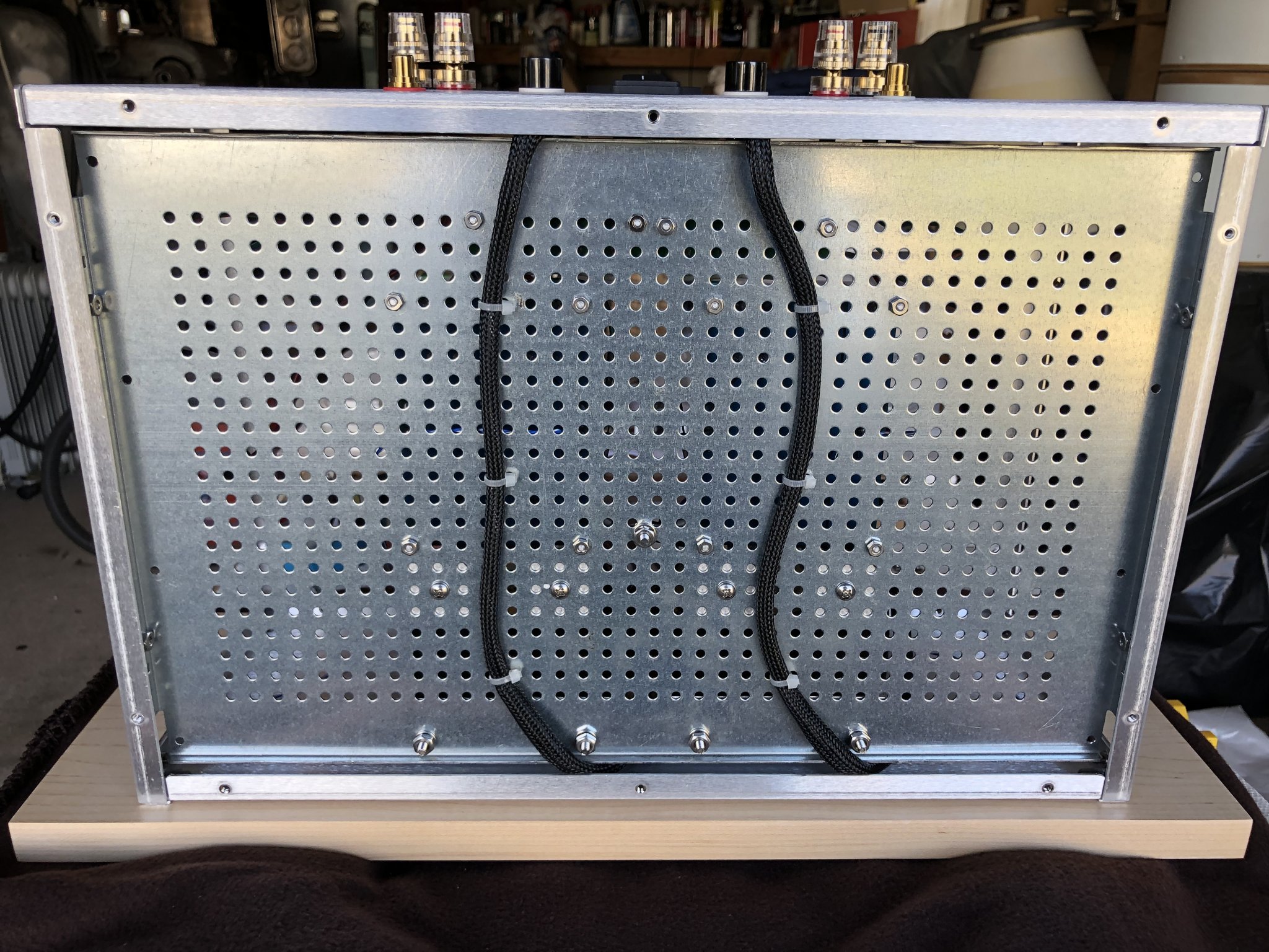

The AC wiring from the NTC board in the back of the case runs under the perforated steel base plate and is twisted the entire way (hot and nuetral twisted for each primary and also the two pairs twisted and protected inside loom)…a pic is attached.
I wasn’t sure what to try next and decided the easiest thing was to remove the bushings from the center of the transformers just to put my mind at rest that they weren’t causing any issues.
It didn’t seem to make a difference when I fired up one channel and gave it a listen on the bench.
I had also rearranged the ground wire running from the supply to the amp boards so that I could see if shielding the signal wires with a piece of scrap shielding material I wrapped the transformers in would make a difference. There was a slight reduction in noise, but not much.
Thanks for the feedback and link. I’m going to read through it now.

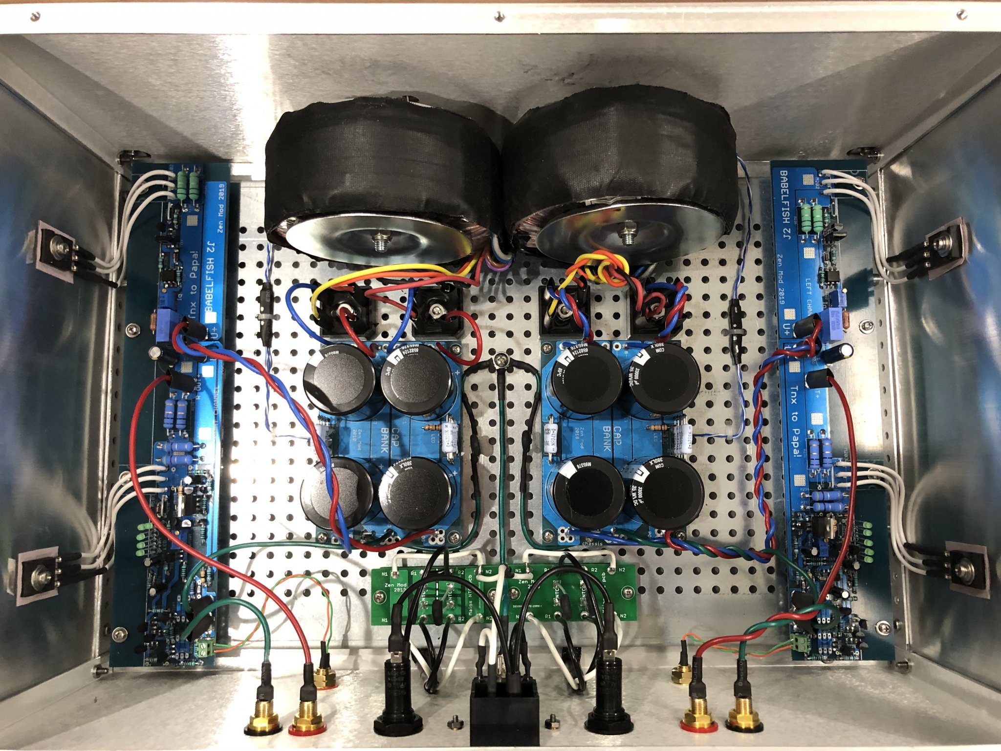

It's great that you are getting results.
I would suggest lengthening the Gnd wire from the PS board and twist it with the V+ and V- all the way to the amplifier board V+ V- connection point and then take the wire to the Gnd point of the amplifier board. Do the same with the Speaker Gnd, twist with Speaker+ all the way to the amplifier board and then take the Gnd to the Gnd point.
Another place to improve would be at the IEC. Take a twisted pair of Hot and Neutral to each fuse, connect the Hot to the fuse, and then continue the twisted pair onward to the each channel's board.
Looking at your twisted input wires, I would twist them much tighter.

Just wanted to mention I also rotated the transformer so the wire outlet faced down in the last round of modifications.
I also forgot to post a pic of the AC wiring.

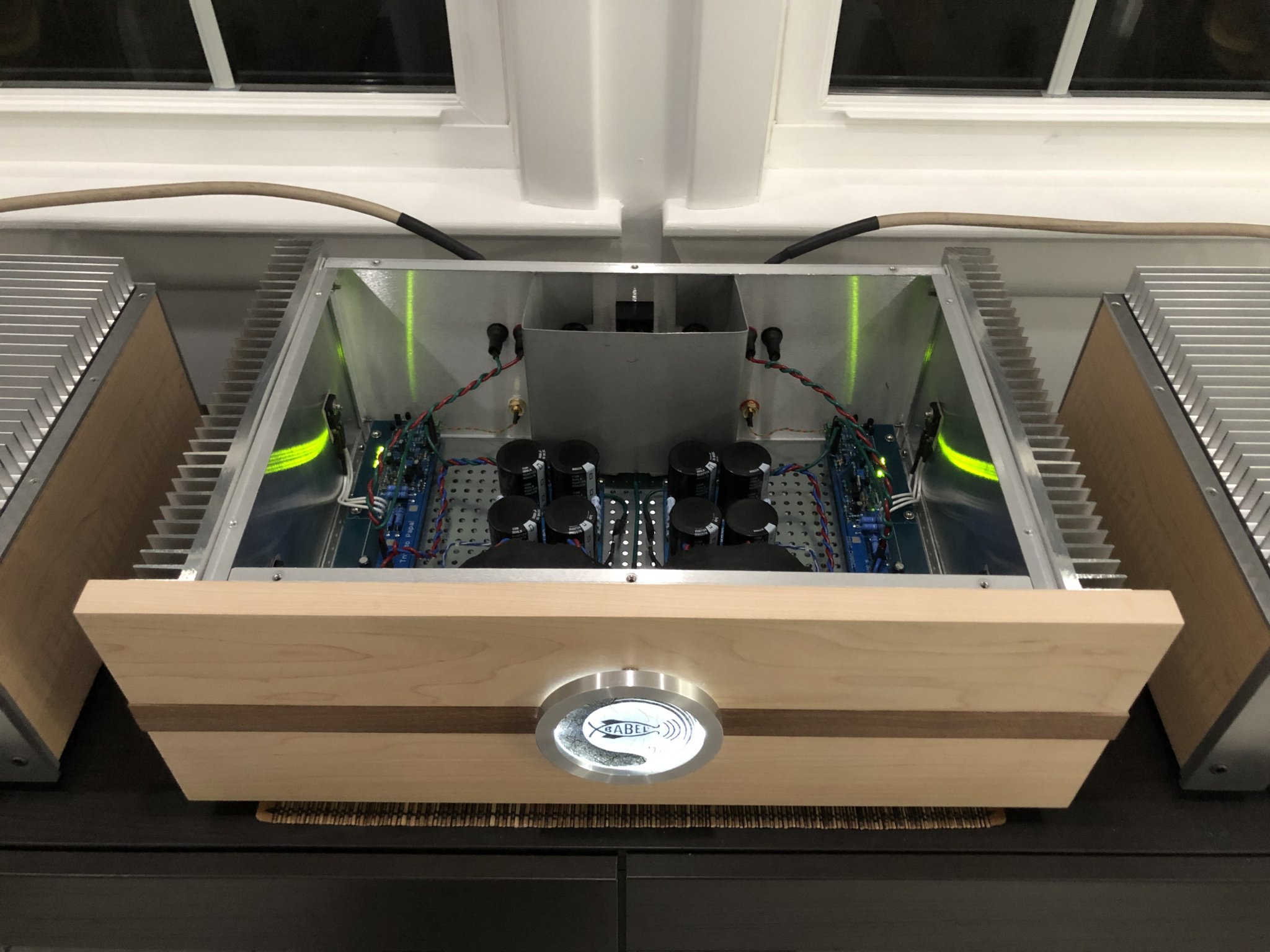

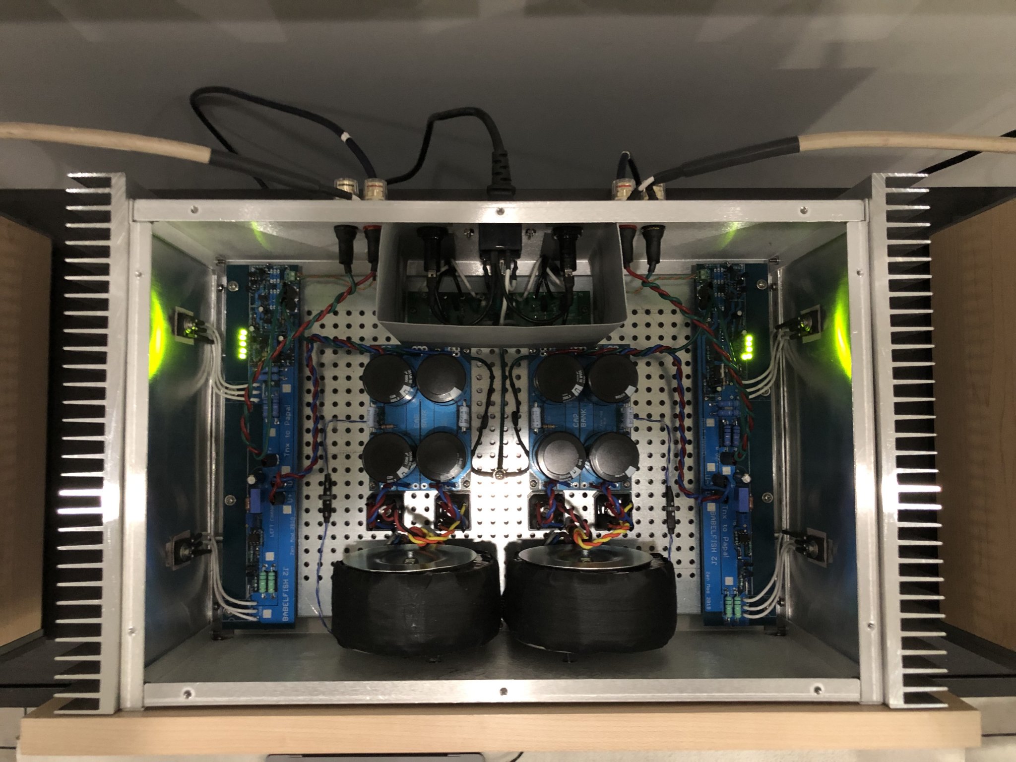

I’m finally listening
I went back in after having twisted the supply wiring on the first channel between the transformers, bridges, cap banks and amp boards.
I extended the binding post wiring so it could be twisted further. I also shortened the input wires so I could just get them connected.
At that point I was wringing my hands over the task of having to pull all of the supply out again to modify and twist the AC wiring as well as extend the ground from the cap bank to the amp board so it could be twisted more.
I decided to give it a listen and discovered I was just barely able to hear the slightest level higher noise than I could hear from my F2Js.
I did some more hand wringing and wrestling with my OCD while I applied the wiring modifications I had already done to the second channel.
Finally, I decided it might be less painful to try making a shield to encase the AC wiring…or at least it seemed less offensive than having to pull everything out again and curse over desoldering one more time. Then I could decide if the cap bank ground needed work.
It turned into a bit of a struggle to fabricate and fit something, but in the end the results were phenomenal.
This amp now surpasses my F2J monoblocks. It is so quiet that I easily end up hitting my ear against the speaker cone before any noise registers in my hearing.
I’ve been enjoying music as it came up to temp over the last hour or so.
I’m looking forward to spending some time with it and trying some comparisons with the F2Js, VFET, ACAs and few others I have lying around.
Thanks you all…especially ZM…for helping to get me here!

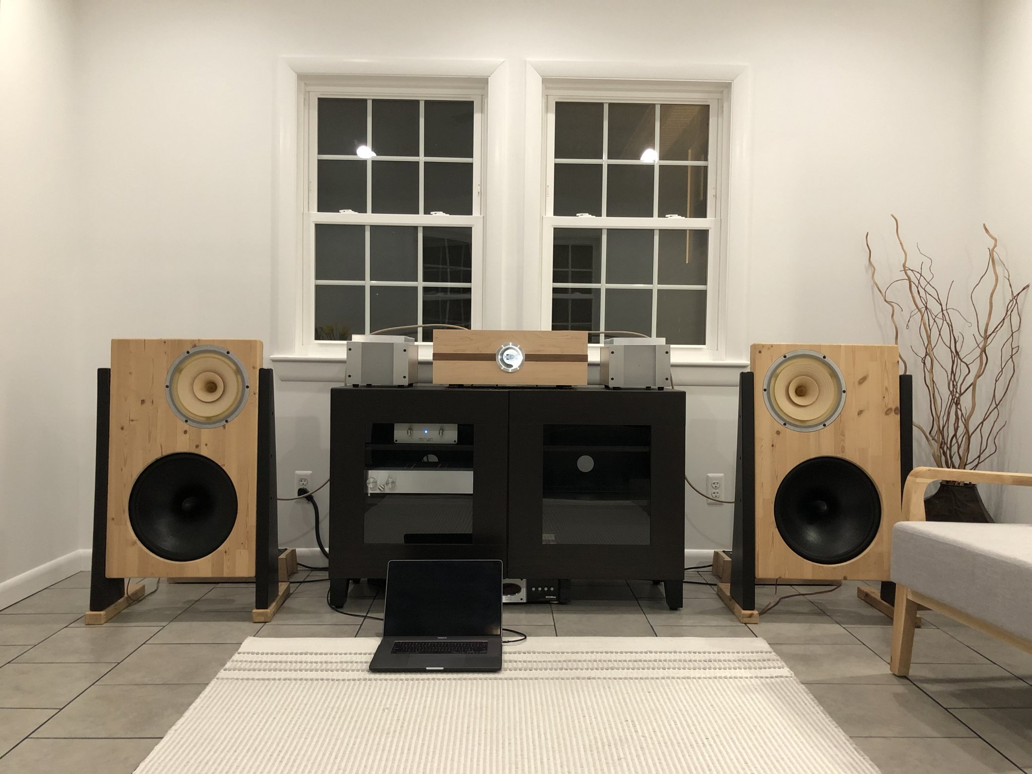

I took a few pics while having my first listen.

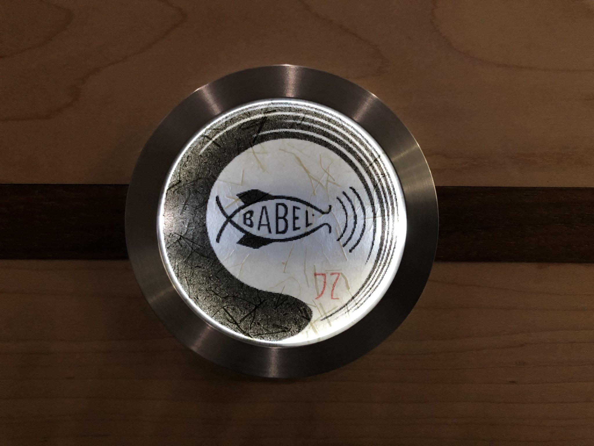

Wow!, Looks great Chrome... I love the amp design and the ZM Babelfish J2 logo.
ZM might have to get that logo on the next batch of PCBs.
- Babelfish ᄅſ....or FW J2 on Steroids .... or Not your Father's J2!
