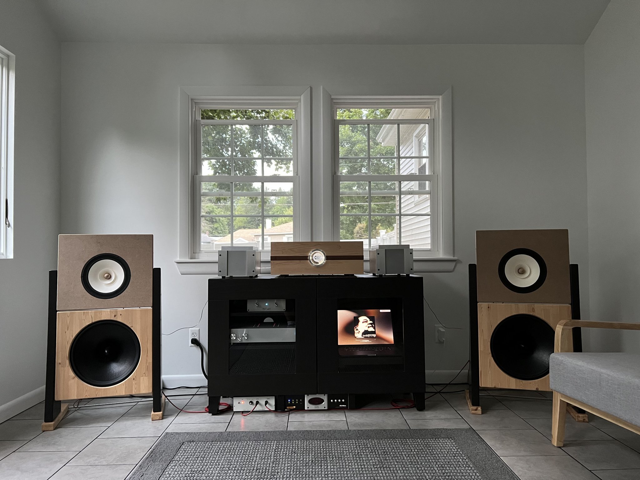

Some nice looking open baffle (?) speakers there.Finally tapping toes again 😁
Yes those are my long term OB tinkering speakers.
Currently have the Babelfish J2 driving the Sonido field coils up top.

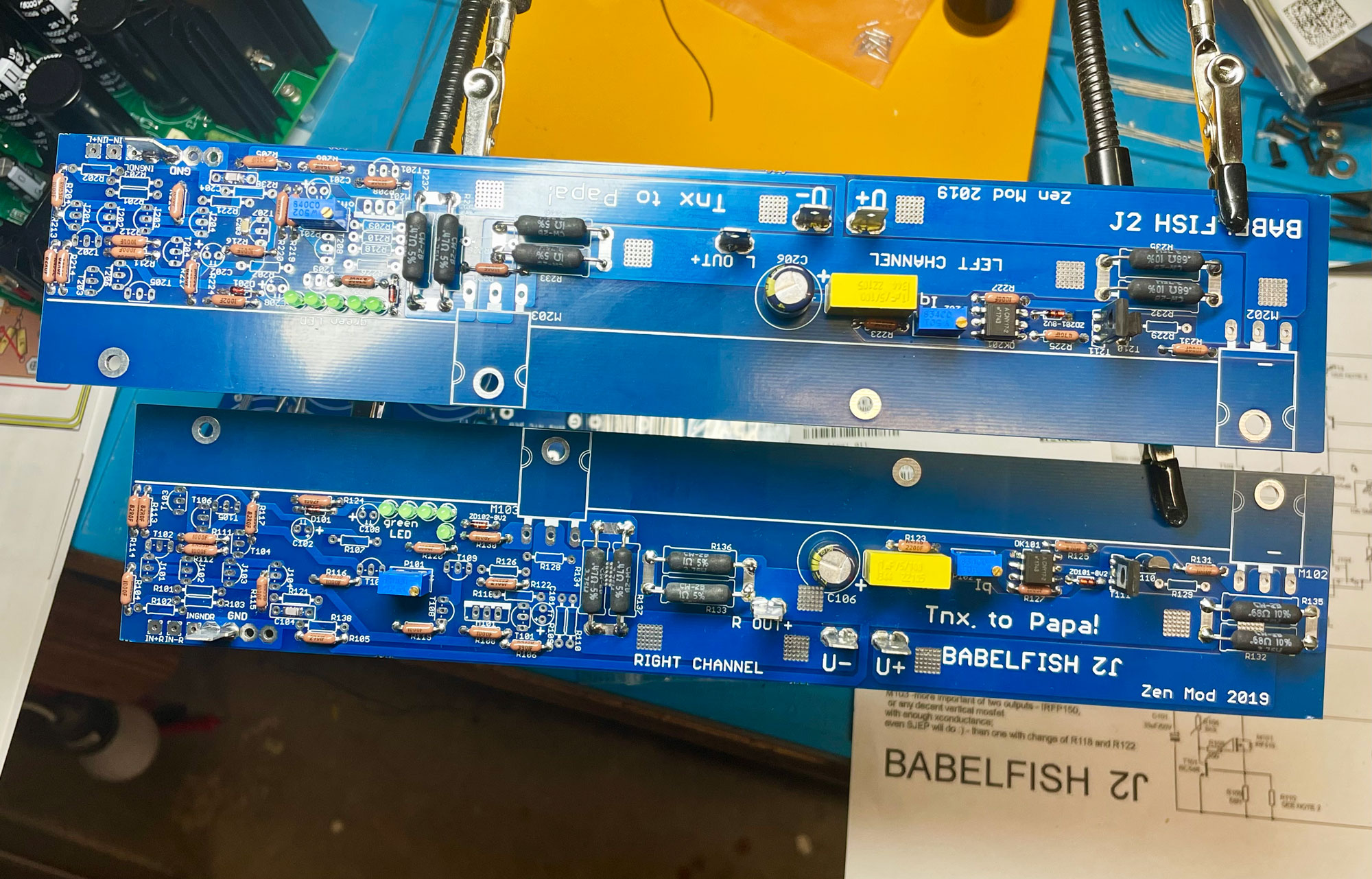

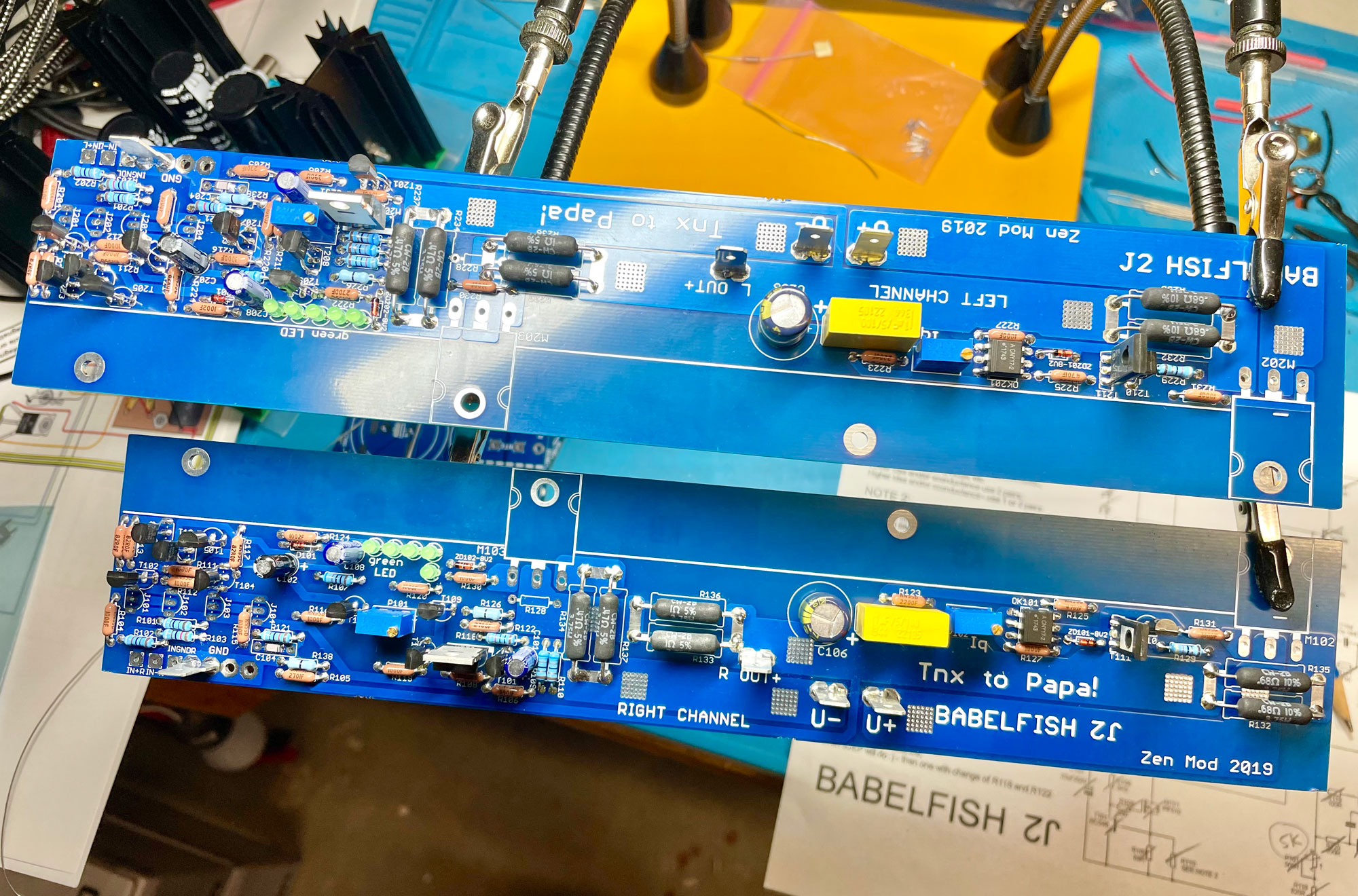

Some progress... Meant to order ZM Option #2—goofed on that—then accidentally ordered 50R trimmers—found 2x 500R in my stash for AJ—used some 5K I found for offset....they go low enough... Jeez.
Think that's that. This will come together pretty quick since I have mono chassis and PSU ready to go....If anybody spots anything weird... let me know! I DO LOVE some ZM style boards. VERY photogenic.
