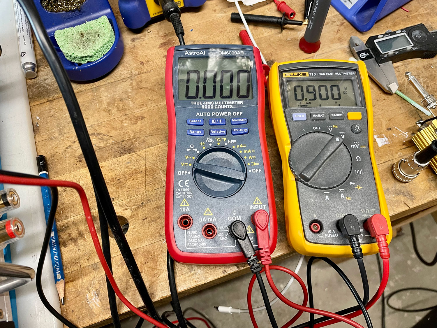

More importantly, here is a link to his speakers’ impedance/phase curves:if 0.9V is across 0R5, meaning 1A8, you're good
you can go even lower, to 1A5, if you don't need max oomph for your spks

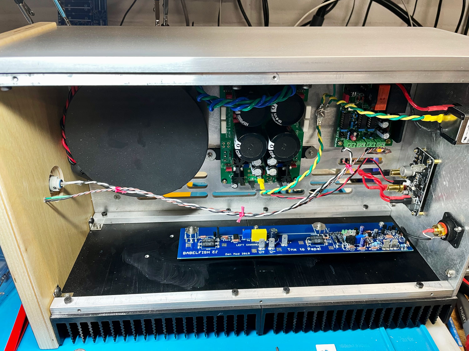

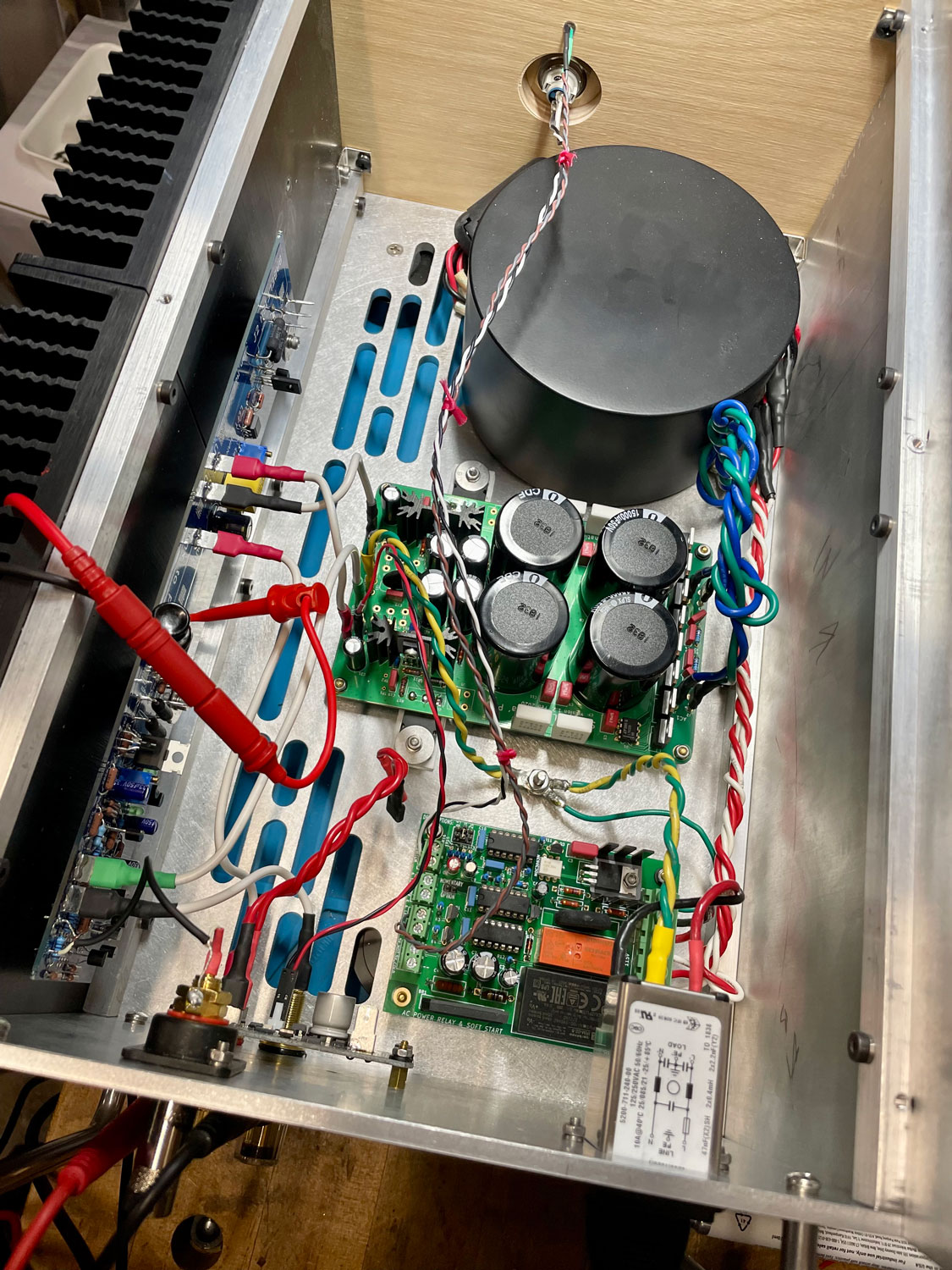

I’m jealous…I’ve spent so much time trying to figure ways to push more current through one of my BJ2 4U/300 builds to see what, if any, difference it might make.
First attempt with small fans in bottom of case was a failure…fan noise was intolerable and didn’t move enough air to make any real difference.
I’ve only just gotten things to the point where I can push it up from 1A3 to about 1A5 on the bench and keep things around 55C.
It required bolting on additional heatsinks internally, opening up the baseplate under the amp PCBs which I raised up on taller standoffs for better air flow, changing the chassis cover to perforated aluminum and mounting two 3” fans to help pump air through.
I also installed a separate power supply, thermostatic controller and voltage regulator for the fans.
I’m hoping it actually runs a little cooler once I’m driving a load in a cooler environment. My workbench is in the furnace room…🤞

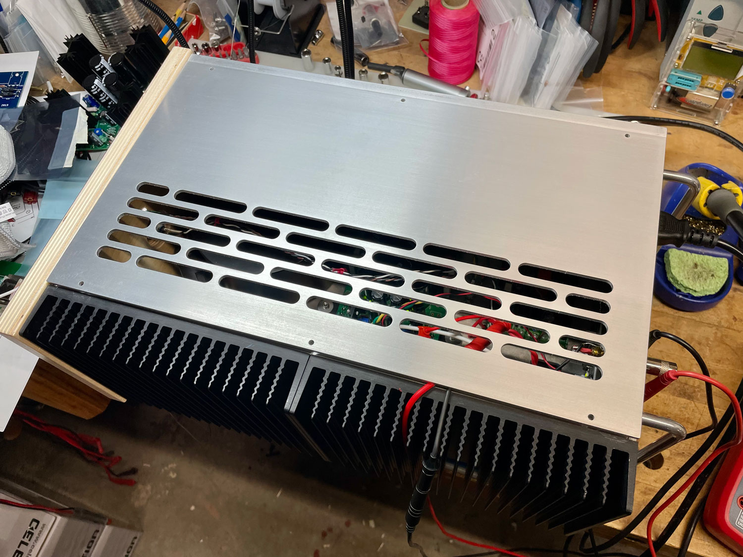

Wasn’t sure about the perforated aluminum…but what’s not to like about a sexy see through top? 😉
I can easily view my thermostatic display which tells me I’m running just under 53 C while pushing 1A5 when it settles into equilibrium.
Driving a load in a cooler room made quite a difference from it idling on the bench down in the furnace room at about 55.5C.
I could most likely try going for 1A7 I think.
I’m going to spend some time with it and then switch back to the amp running 1A3 and see if I think its worth the hassle to give that chassis the same treatment.
