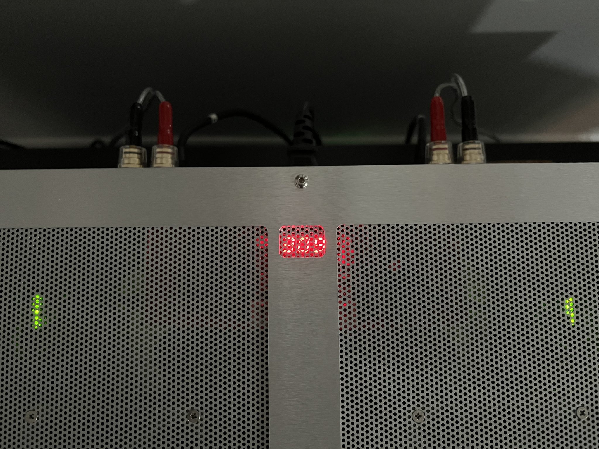

This is what I came up with for final top plate casework of my BJ2.
Table saw wouldn’t give me clean cuts/corners and mill is too small so I had to get creative and used a discount store 8” x 10” picture frame as a template for my router to make ventilation windows.
Added peek-a-boo hole for temp display with mill afterwards.
Still have the second amp top plate to do…but then I think they are finally done…unless I end up having to dial back Iq when the weather gets hot again 🤷‍♂️

I just plunged it.
Cut a little at a time with depth setting stop on router…maybe .5 mm at a time.
You could rough cut with a jigsaw, but the feet will scratch this type of surface up. I wanted to avoid that even if cutting from the inside. I’ve tried covering the feet with masking tape, but it can wear through.
I use carbide bits…no problem with soft aluminum like this. It will eventually wear, but no more than with cutting hard woods or MDF in my experience.
I do the same with carbide blades on my table saw.
Obviously make sure you wear good eye protection and beware that if you cut too aggressively you will get hot chips. You definitely want to wear long sleeves to avoid discomfort from any hot chips landing on your skin.

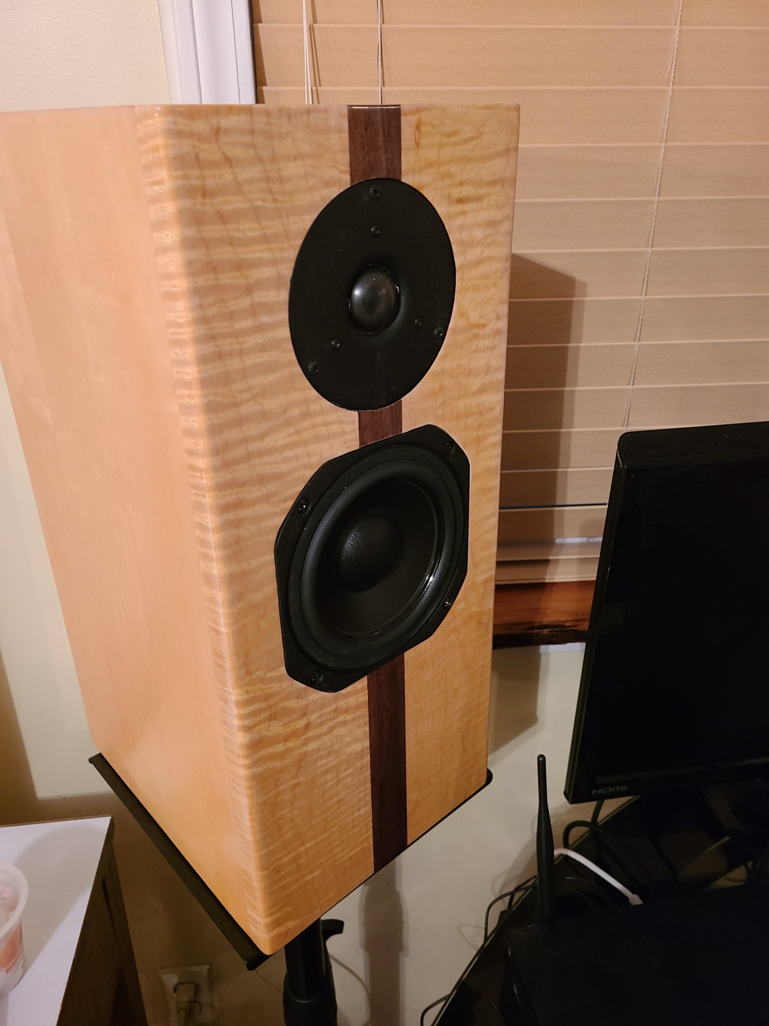

Very nice!

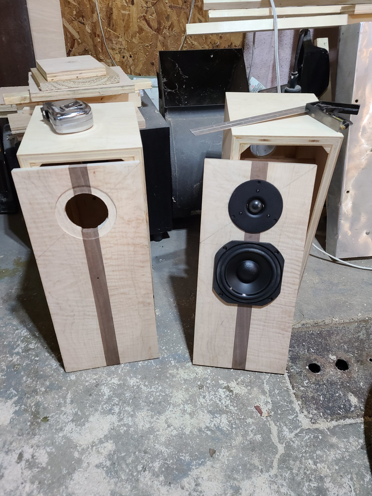

Maple and Walnut are my favorite to work with. I have a decent amount of both I’ve hoarded over the years.
I was hoping to carry the theme over to one of my speaker projects as well.
It might also end up being an MLTL for one of my pairs of Tannoy DC.
