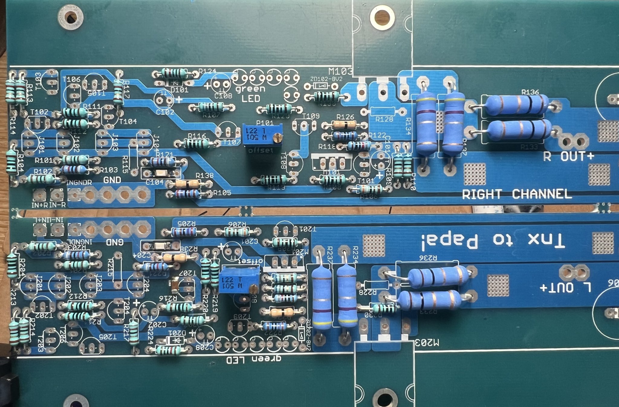

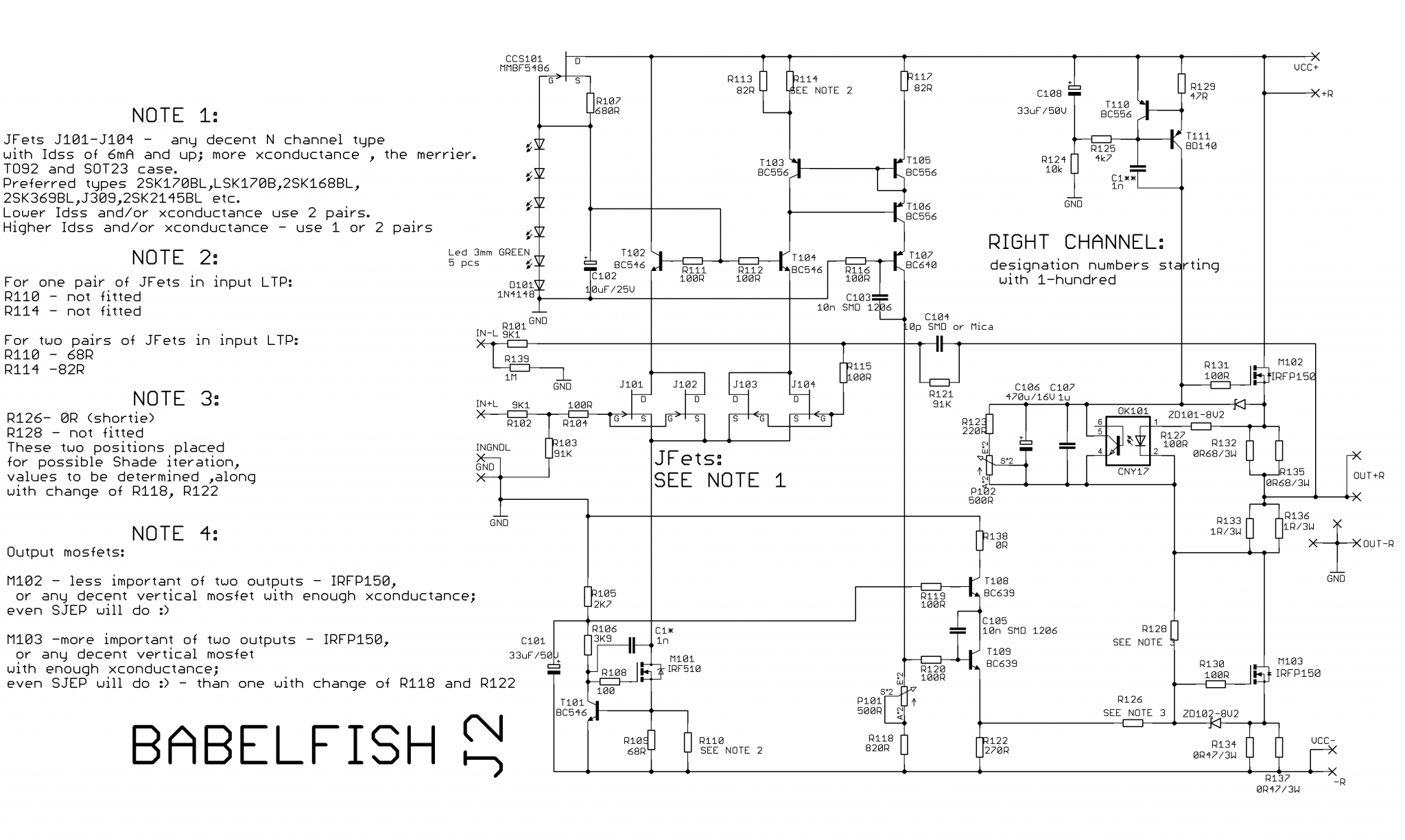

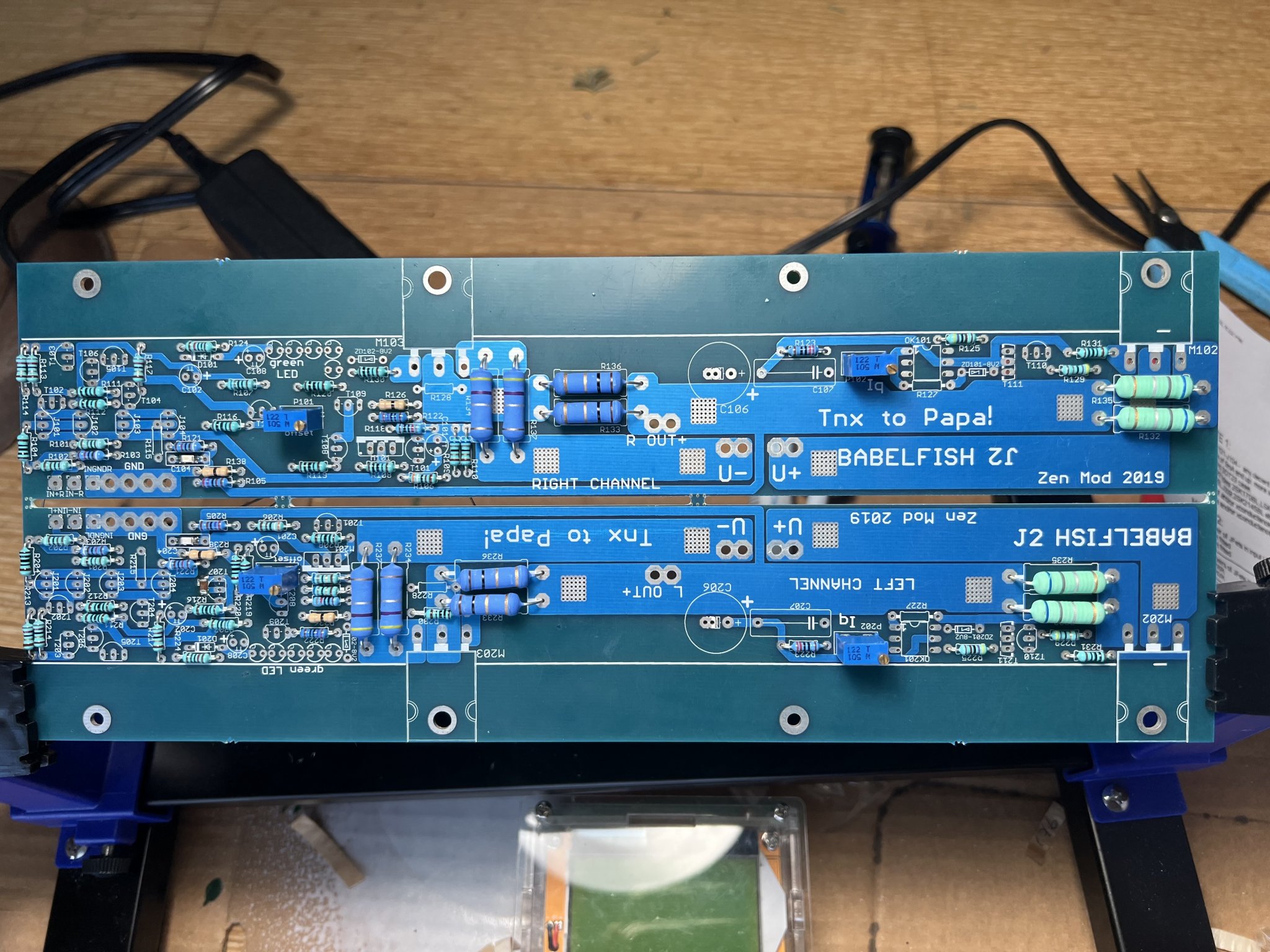

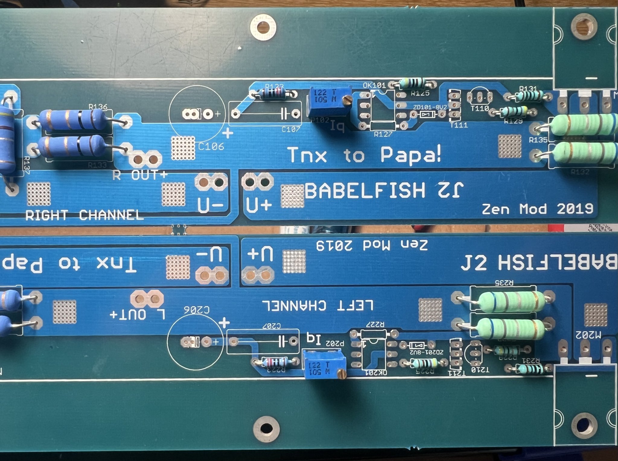

I've finally started working on my Babel J2 kit. I've stuffed the resistors and appear to have received 4 * 270R. As far as I can see in the schematic there are only 2 * 270R needed but would like confirmation. I'm also missing 2 * 100R so I'm trying to figure out if I mis-stuffed or what.
Can any of you eagle eyes spot something amiss?
TIA.
P.s. I would include pictures of the back but they mostly would show a forest of uncut leads since I haven't soldered anything yet. The boards I received from ZM have bottom-side SMD J101-104, SMD capacitors on T107 and T109, and top-side SMD C104.
TIA.
please , give me pics from bottom side, too
as I said, there are few more positions to include 1n smd caps, to increse stability even for most critical combo of transistors (think beta)

I went through the same thing in both my builds.
MZM is always including some extra resistors fir greedy boyz who want to try different flavors or can’t make up their minds what they want.
I think extra 270R is for R118…when you would have to swap it while trying Semisouth down…and R122 would change to 82R.
I can’t remember now why I came up also short 100R …but it happened in both builds.
Just MZM’s way of making sure we don’t fall asleep 😉
Edit: What did you stuff R118 and R122 with?
Also…R123 may vary depending on how you are building…All IRFP, Semisouth down, all Semisouth?

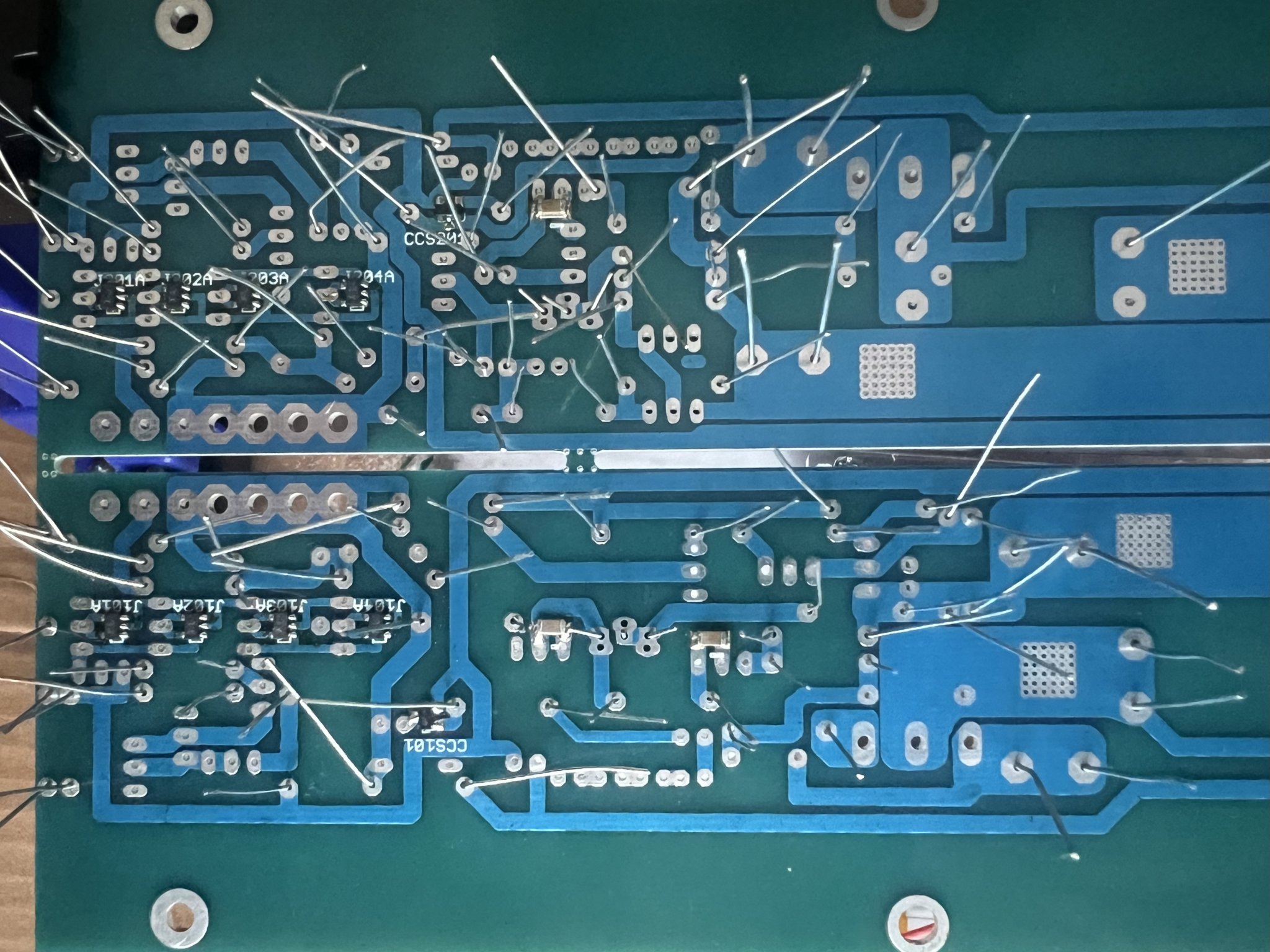

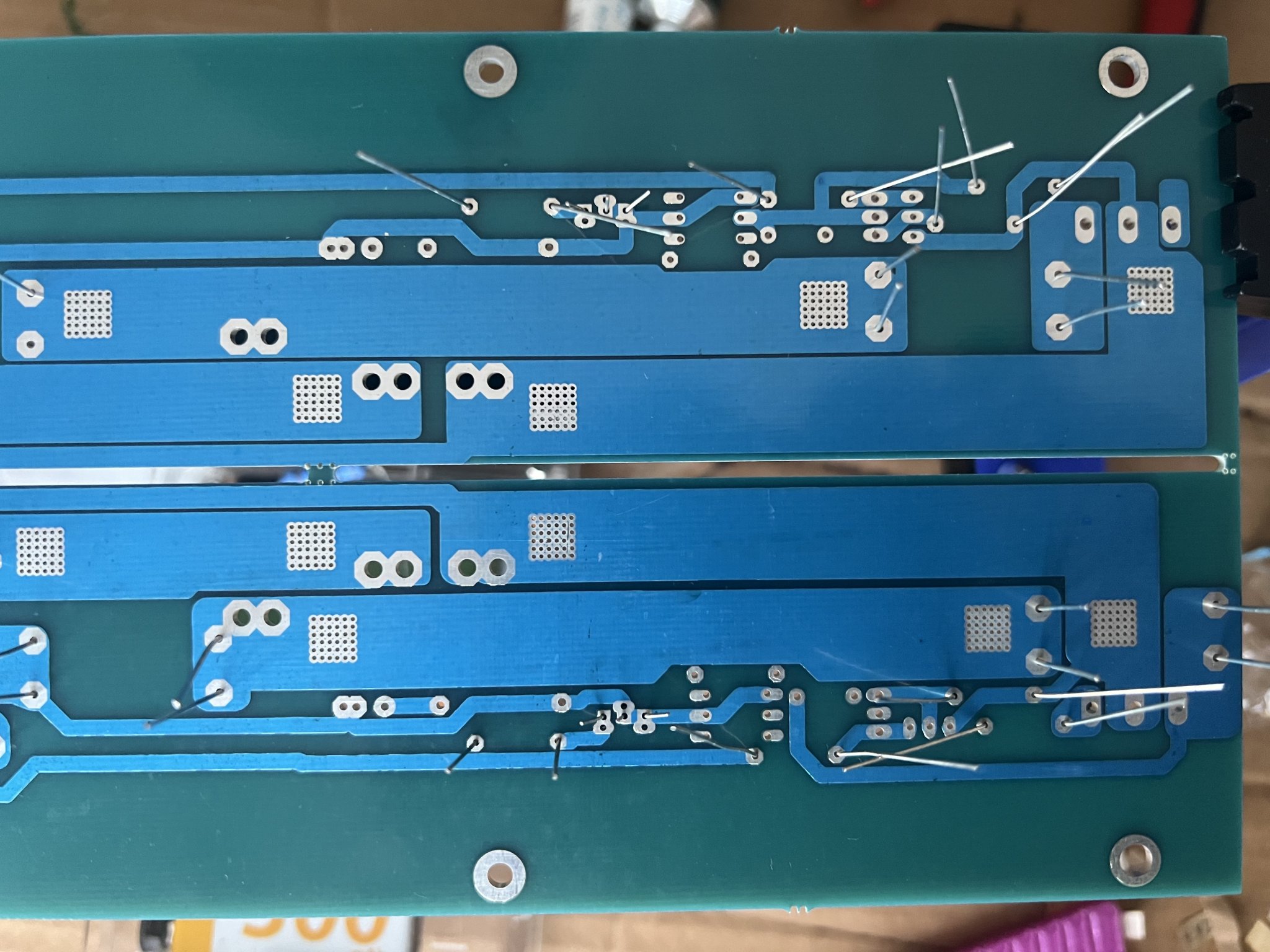

Back side pix as requested by ZM.

Thanks for the reassurance.
AFAIK I don’t have semisouth devices; bought a full kit from ZM awhile ago. Seems to be all IRFP. R118 = 820R and R122 = 270R.
@chromenuts
I pulled each resistor out of the board, one at a time, to double check them with my component tester. Found no issues, which confirms that I've got an extra 2 * 270R while missing 2 * 100R. Will dig through my stash of parts from other projects for leftover 100Rs.
order smallest 1nF caps with pins you can find, 63V will do; 4pcs
that, or SMD ones, but easier with pins
when you get them, I'll post where to solder them to prevent any possibility of misbehavior
simple and easy to do from bottom side of pcb
two caps marked with * and **, one near M101, one near T111

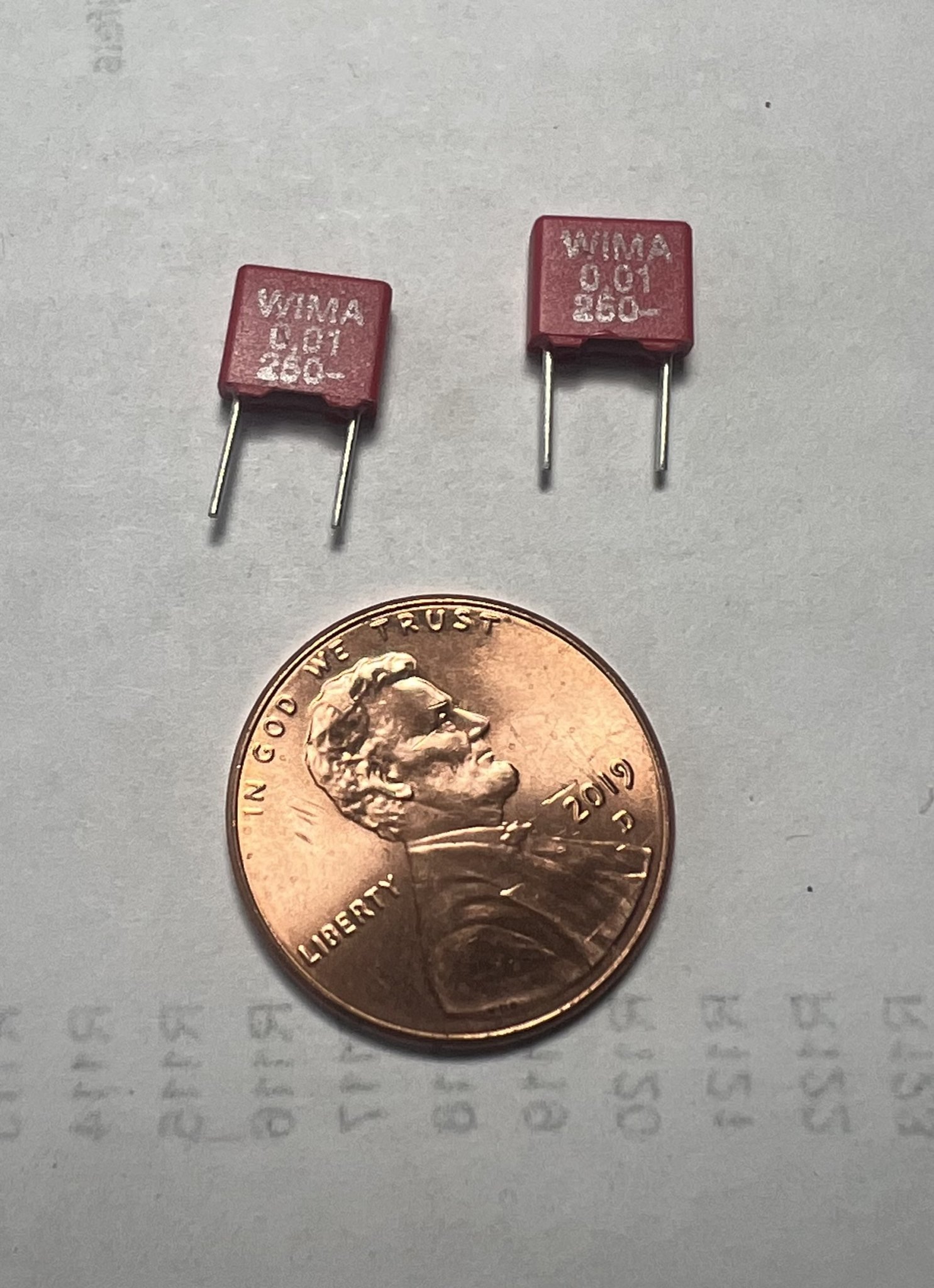

I found a couple 100r 1% metal film resistors.
The only thing close to 1nF I have on hand are some WIMA film, 0.01uF (10nF), 250v. Would they work?
[edit]
I just realized that I only have 2 of the 0.01uF. Okay, if I’m placing a Mouser order, how small do the caps need to be? Radial leads better?
I do have a bunch of 1uF caps.
[edit]

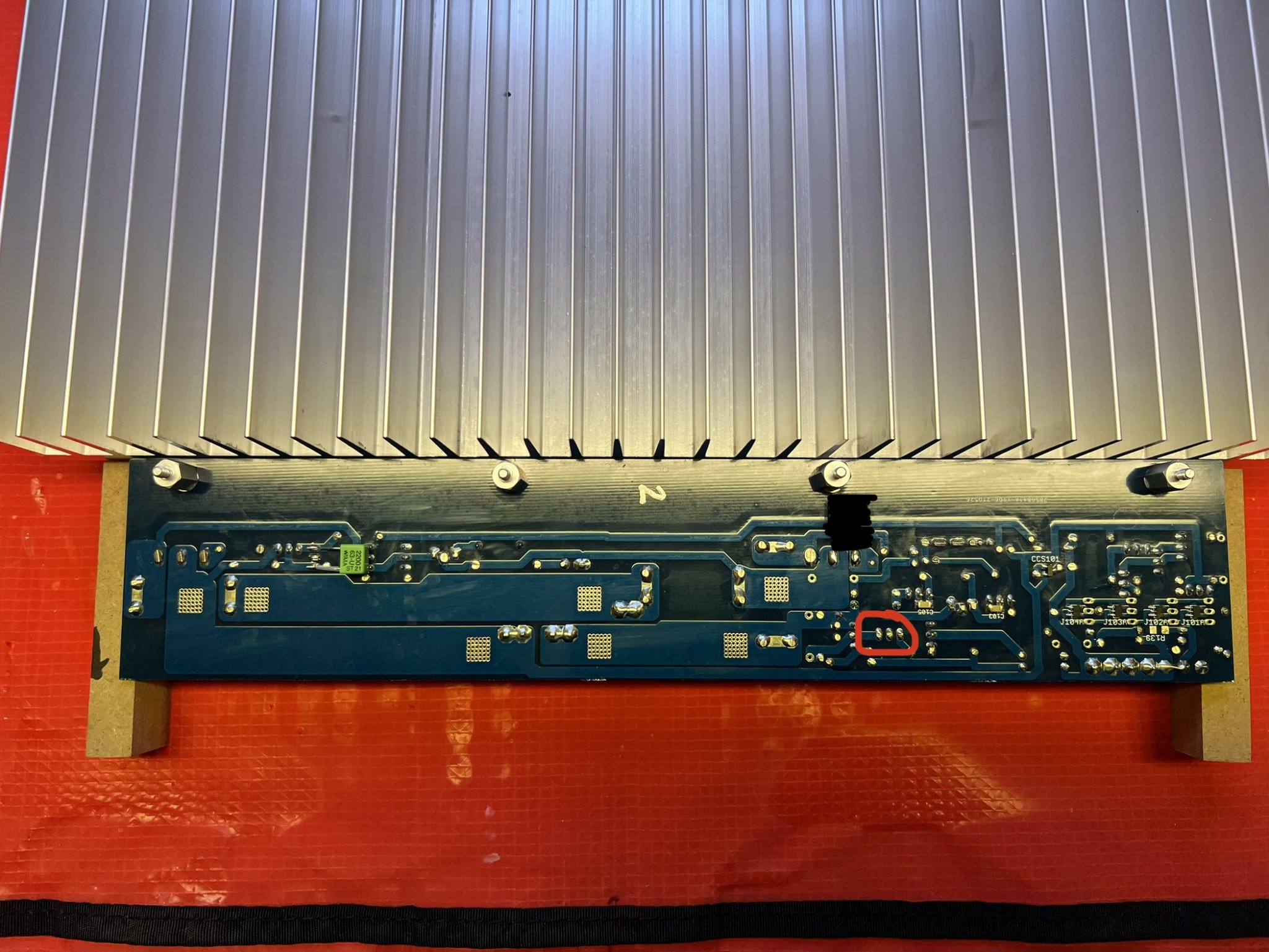

Edit: Posted screw up pic…don’t mess up and put cap at M103 first like I did. Edited pic to show where M101 is on bottom of Right channel board (red circle). I don’t have a pic showing proper pins at M101. Cap shown is at T111.
Is this what you are talking about MZM?
We added these at what looks like M101 and T111 on my amp boards to get them to behave and not make noise especially during power up.
This is a pic of the bottom side of Right channel board with tiny caps mounted.
Just for reference…these were ZM’s original instructions to me
- 680-2n2 cap, soldered betwen B-E of T111/211; even if noise is not generated in that CCS, it can't harm
- you can do the same for M101/201, cap between G and D....... pre or post gate resistor
So then mine are mounted incorrectly?
Ugh 🤦♂️
I guess I gotta go in again and change them
Any possibility of damage to them or circuit?
Ugh 🤦♂️
no damage
in fact, they'll do the same job, just halfway
your's is behaving now, most likely no reason at all to fiddle further
