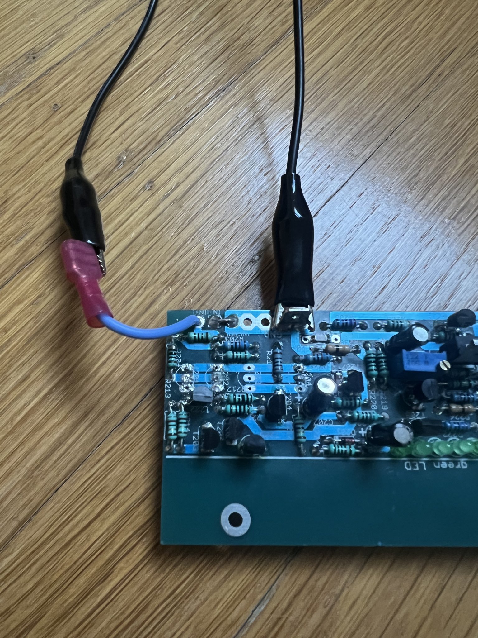

while setting, both inputs grounded?
while feeding the signal - was it SE ? if yes, neg input must be grounded
post pic of your setup arrangement
I’ve pulled the board out of the chassis already. I’m testing it by replacing one of the boards in the M2X amp I use everyday.
I have a soldered jumper between IN- and GRD. For bias and offset adjustments I connected a test clip wire between GRD and IN+.
Photo shows those connections. When the board is in the chassis it’s also connected to GRD, U+, and U-

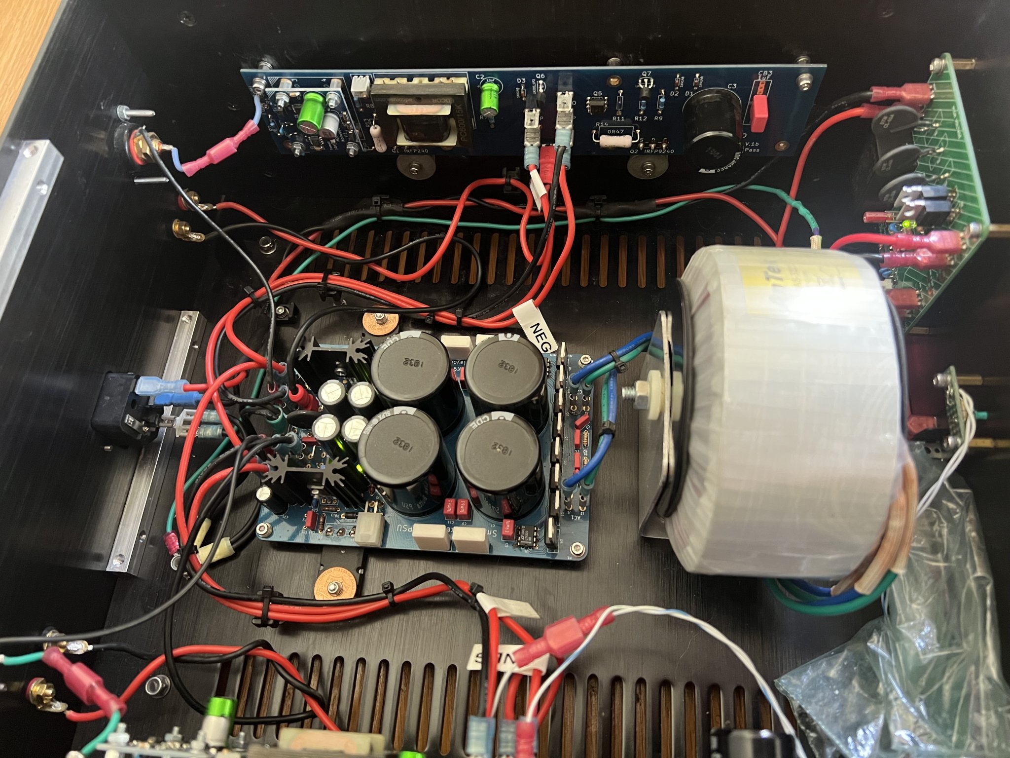

gimme a picture of your amp inside, of course with top lid removed, just to grasp visually what we are dealing with
now, one thing - are all LEDs lit?
second - same behavior in both channels?
I mean, in this moment I have no clue what's going on, sorta being in mental loop trying to decipher what you did in first place when you had smoking parts, and what could happen afterward

The LEDs do light and everything else seems normal except for the output offset voltage. I suspect there’s a bad component causing that issue I’ve ordered a better desoldering tool so I can remove transistors, etc. for proper testing.
I’ve been focusing on only the left channel for now since I’m waiting for parts to complete the right channel board.
Here’s the inside of the M2X amp I’ve been using to test the Babel J2 board. I’ve simply been removing one of the M2X boards and replacing it with the J2 board. The M2X amp works fine (listening to it now) so I’m 99.99% sure my problem is in the J2 board.
