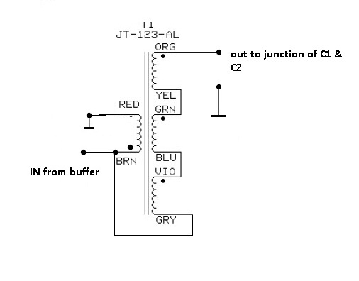

Original B1 with autoformer
Just watching Nelson's talk at BAF2017 with special attention to the B1-XFMR
and just have to ask:
Can a autoformer be added to the original B1? I have a pair of Jensens wired as in the attached figure. If so where would be it best be placed?
B1 original is here
http://www.firstwatt.com/pdf/art_b1_man.pdf
Bob

pot - buffer-autoformer
take care to short idiotproof part - series resistor on buffer output
endless talk about subject in What's wrong with the kiss...... thread
