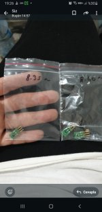

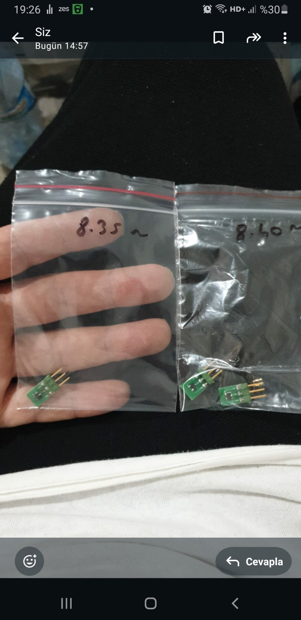

I remember reading that in a pair of 2SK170BL (or similar JFETs like 2SK209GR), the one with higher Idss is preferred for a certain position, but I can't recall exactly — is it better to use the higher Idss JFET on the top or bottom?
I recently matched a bunch of 2SK209GRs (I have a few thousand of them 😅) and measured Idss using a 9V adapter and 100R in series — though it was an older one and gave around 8.5V. I hope this slight difference in voltage won't cause a problem for Idss matching purposes.
I'm also considering putting a 47Ω resistor on the output — perhaps to isolate or stabilize the output. Any thoughts or experiences on this would be appreciated.
Thanks in advance!
