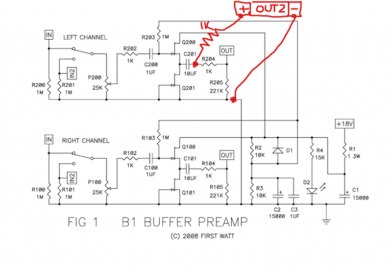

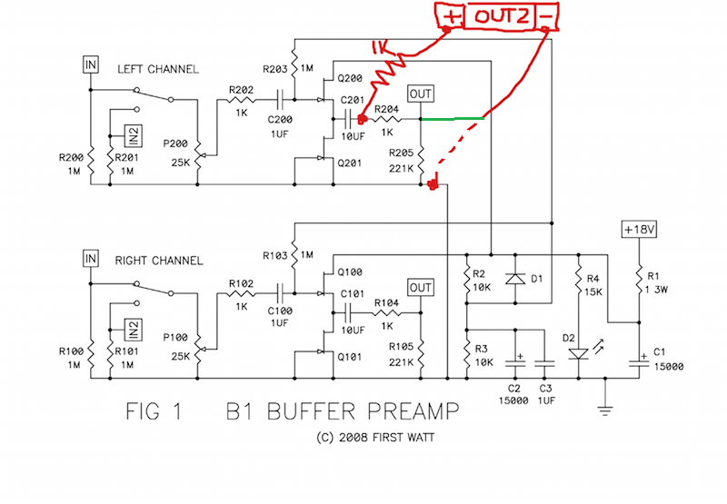

I have this image in my archive for connecting a second output. I'm wondering why the negative line is not connected to the same point as the first output's? (shown in green in the second image)
In the first image, Output 1 has a 221K resistor to ground, but Output 2 doesn't.
Can someone shed some light, please?
Both are incorrect, duplicate R204 & R205 for the second output.
I was a little too quick, you can use the first one, it's just me, I would add R205.
Thanks Itsmee. I had confirmation from a different source that the first one is correct.
However, your suggestion to add R205 makes sense. Easy to check with and without, though.

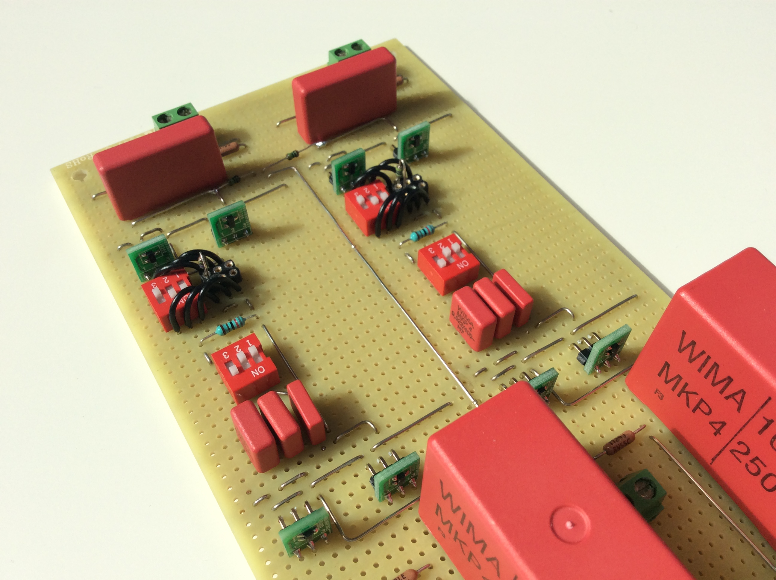

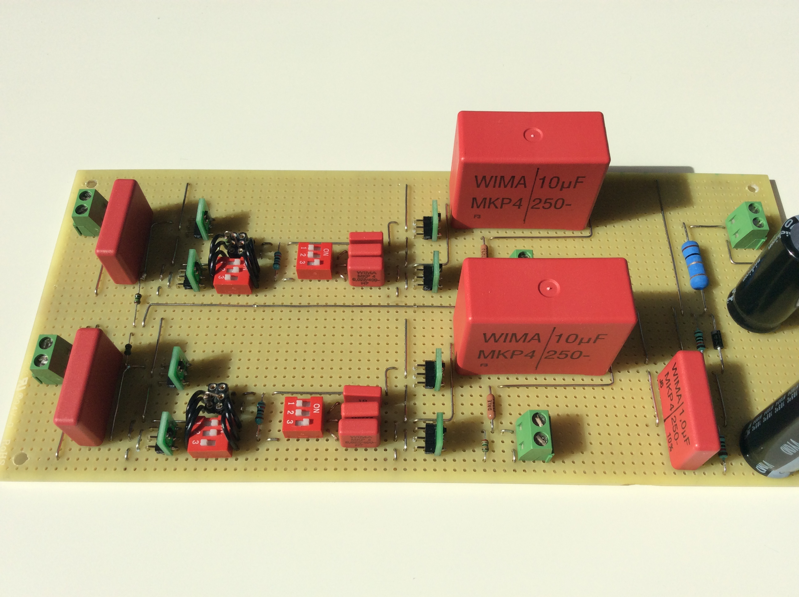

B1 Buffer, BF861B + Baffle step filter
If anyone's interested, I just completed this circuit, a baffle step filter sandwiched between two B1 type stages. Front and back of circuit same as B1. JFET's chosen for about 9mA Idss bottom, 10mA Idss top. For 20V, well within the maximum power and voltage specs for BF861B. Initial impressions sounding very good c/f existing LSK170-based B1. 4dB correction seems to be fattening the sound of my ACA/Coniston's 4-foot off rear walls nicely. Need to do much more listening now.
