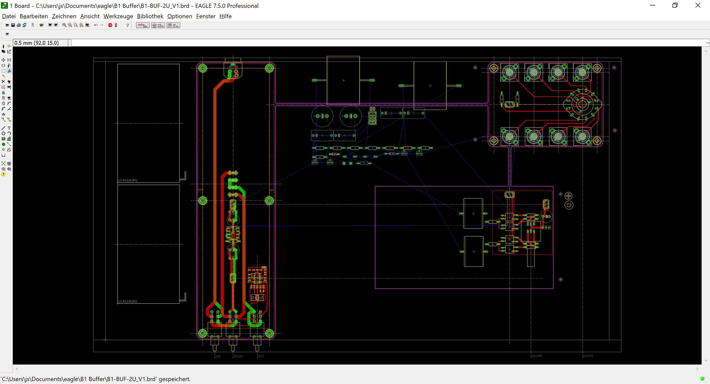

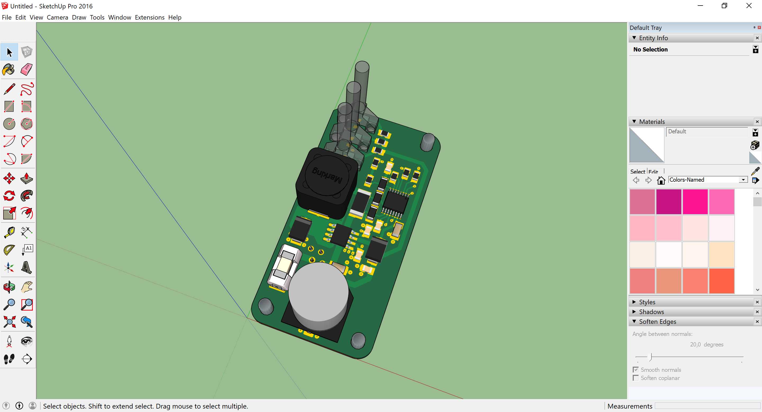

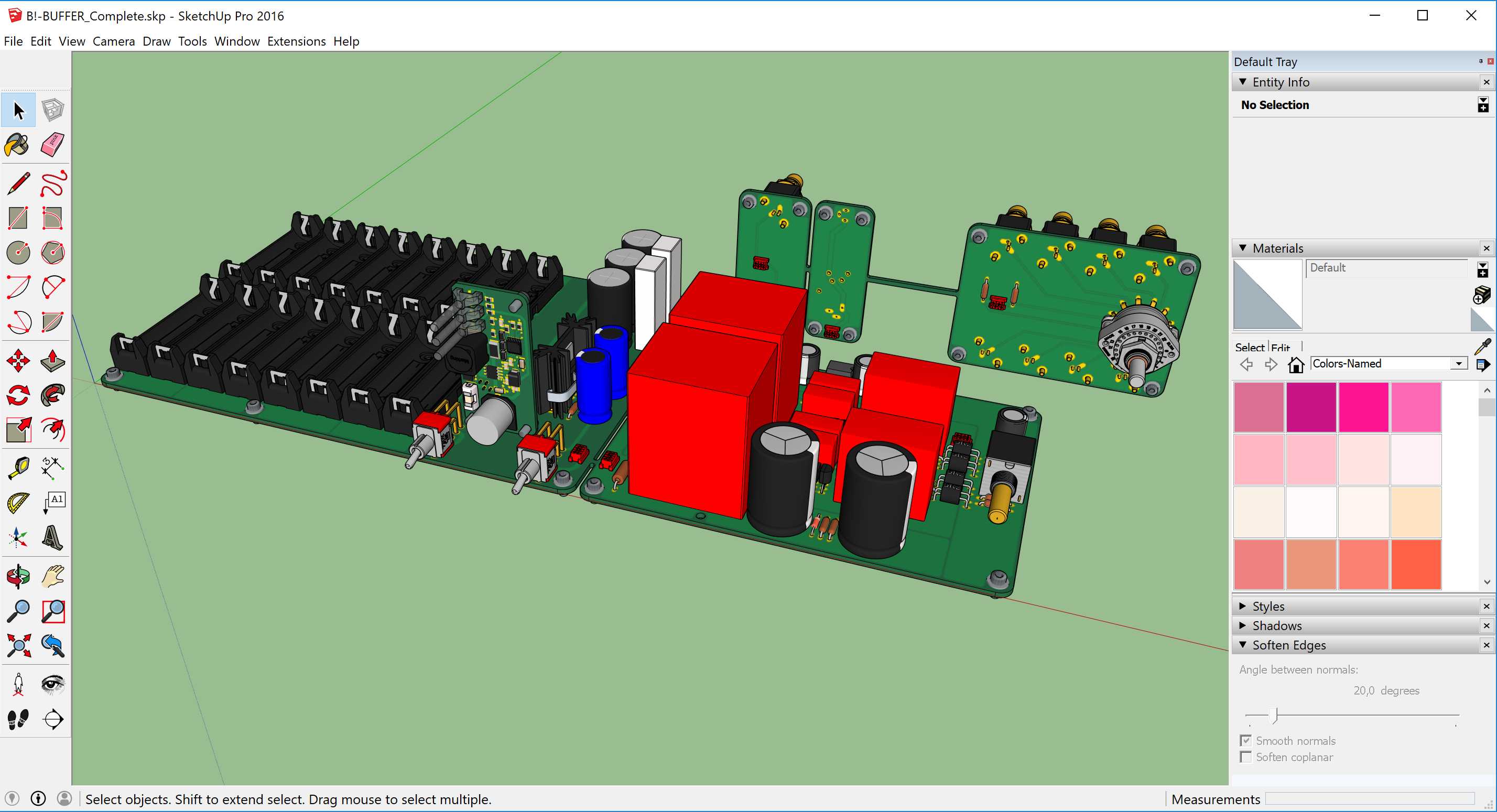

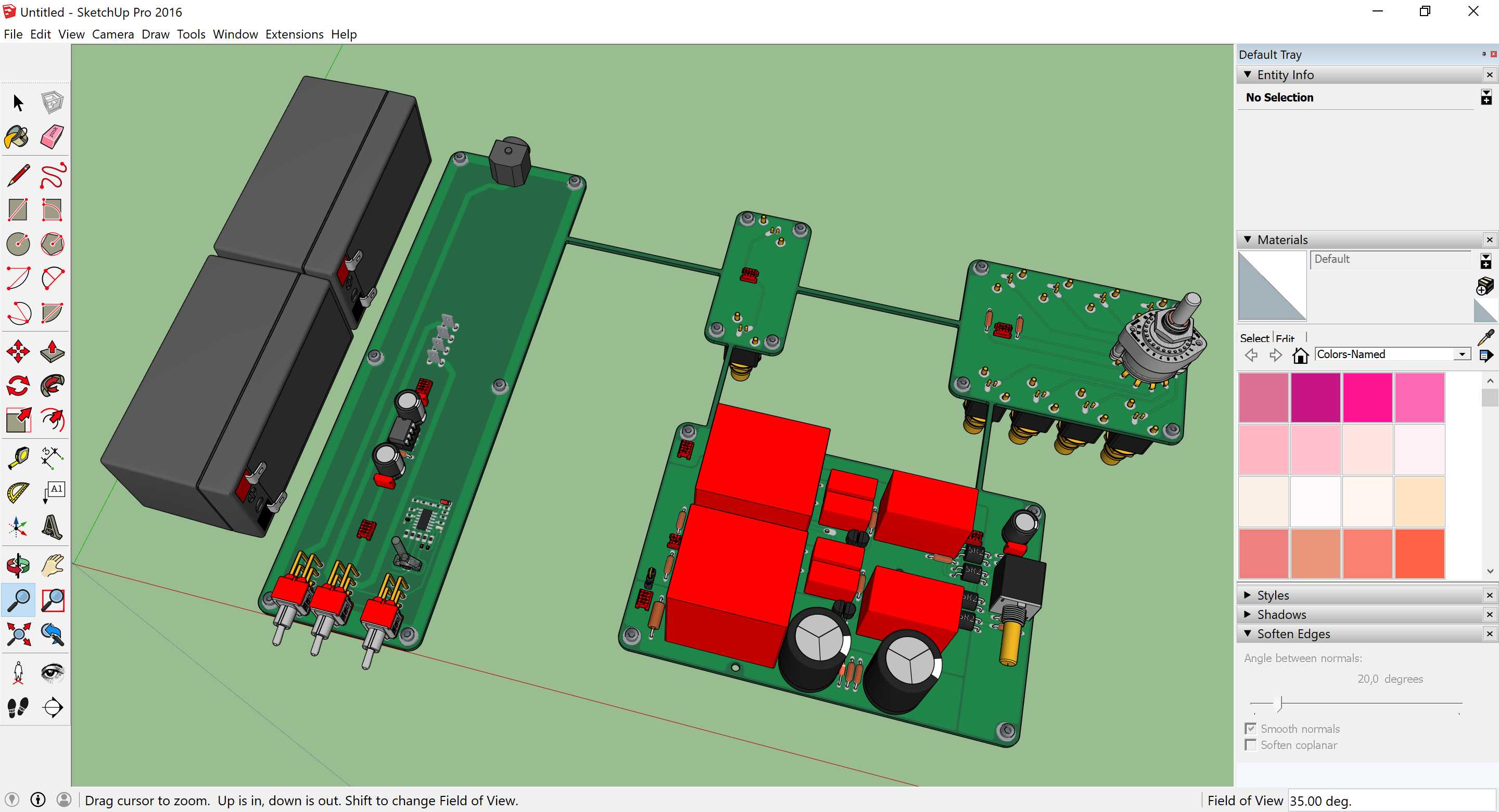

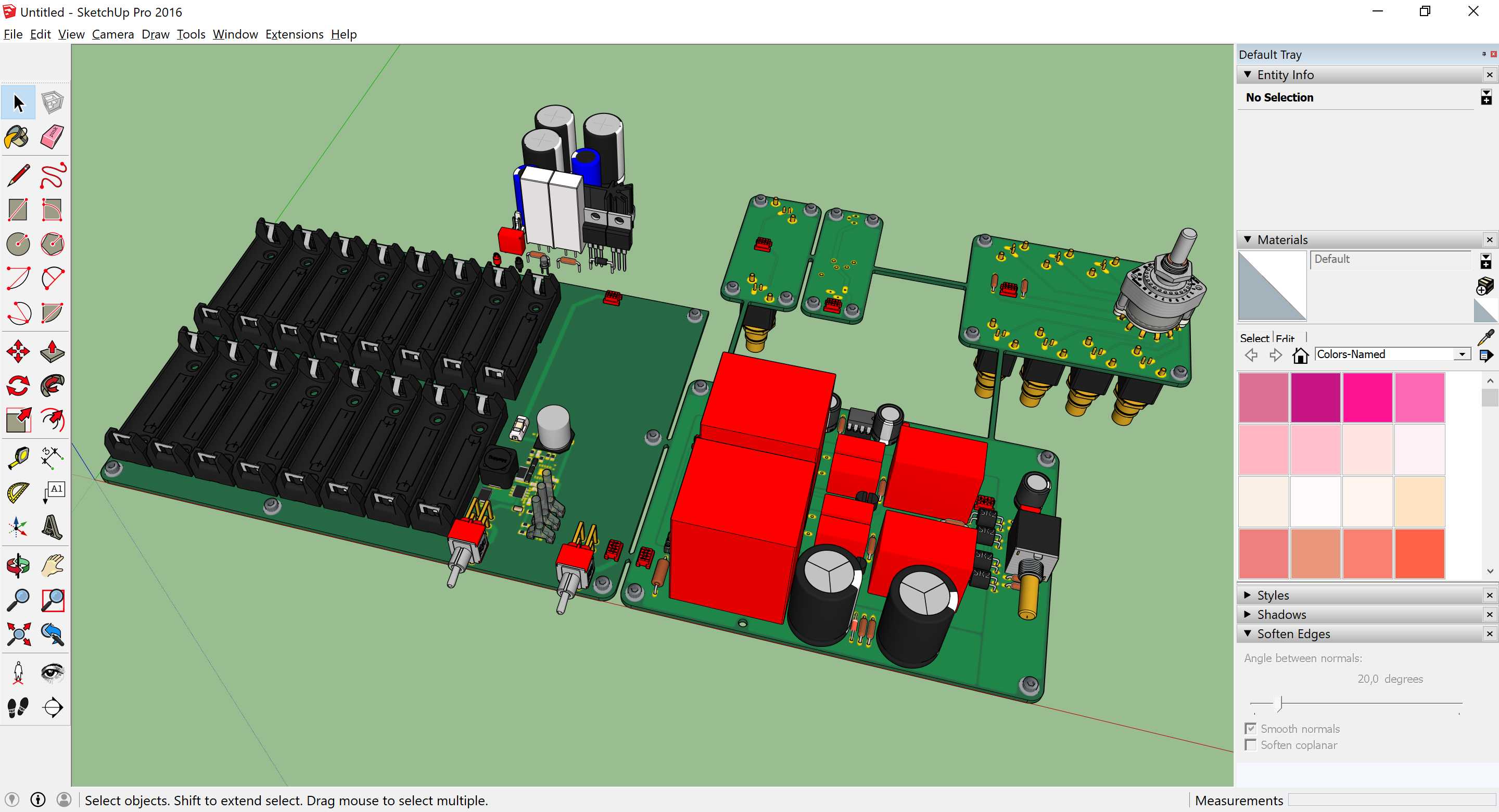

Working on battery powered B1 Buffer for HIFI2000 Slim Line 2U with LDR potentiometer.
Are following features meaningful:
- footprint for LSK170, LSK389 (TO71) and BF862
- multiple coupling caps footprint (needs suggestions for coupling caps to use)
- switched simple 1AD4 hybrid headphone amplifier
Proposals are wellcome.
