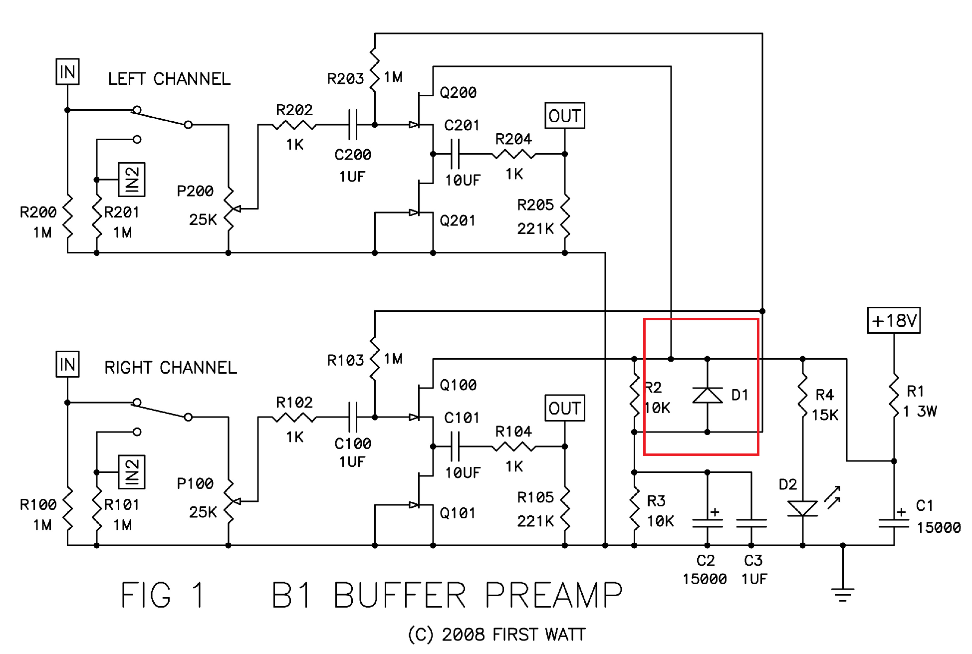

B1 Buffer Preamp
Andrew, the B1 design uses running the JFEts at their Idss. Everything else being the same power is decided by Vdd or the supply voltage. In simulation low Id( lower than Idss) gives better THD. But running Jfet at the linear part of V-I curve makes the buffer susceptible to supply voltage issues(ripple). This is my understanding so far. So perhaps running them exactly at the point where the V-I curve flattens( aka pinch off Voltage ) or little below might be the best option.
LSK 170 being capable of higher dissipation ratings could have handled the situation better.
BF862 rated at 300mW may need a lower supply voltage than original B1 voltage to run them cool. For example my Batch of Bf862 are between 12-13 mA Idss rated. The calculated Pmax 210-220mW, lower than rated Pmax on the devices. May be a just a heatsink can fix the issue.I am using a heatsink regardless to couple them thermally. What do you say about my understanding about the issue. Or perhaps use 15V rather than 18V. I read somewhere "JFets like to run hot" but it was a statement by a DIYer.
It's not just the lower power rating of the BF862, you should also note the Idss range of the BF862.
The B1 is essentially a Source Follower run in single ended mode. Even the dual polarity DCB1 is a single ended Source Follower.
The dominant characteristic of a single ended Source Follower is 2nd harmonic increasing as signal voltage rises. By the time the signal peak is approaching half the supply the 2nd has become excessive. Any higher and it is just "bad".
If you lower the supply rail from 18V and try to maintain the same signal level, you are taking the signal peaks closer to or even exceeding that 50% of rail voltage.
In my view that ruins the performance of the B1 and DCB1.
A CDP is probably the highest signal one would put through this Buffer. It has a peak output of ~3Vpk. When operating on an 18Vac supply, that 3Vpk is ~33% of available signal swing.
That is well below 50% and for most of the time the siganl is much lower than this. It is the normal range of signal that probably makes this Source Follower sound so good, the 2nd has hardly got started, except when peak transients pass.
I remember Patrick(EUVL)suggested this before. LT spice simulation agrees with your recommendation Andrew.

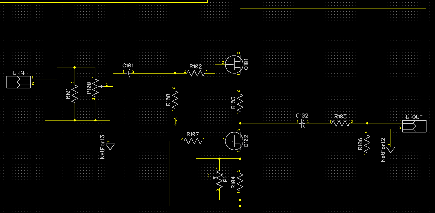

So this is the new version with source resistors. I remember ,last time it came up it was recommended to use a trimpot to null the DC offset.Please see the schematic attached and especially pin connection for trimpot. source resistors are 3ohm (R103) and R104, 3.3 with P1 200ohm pot in parallel.
Yes. But you don't need to use a simulator to tell you that.
I would swap C102 with R105.
Place R105 close to the output node.
Why are you taking the input resistor R108 to the negative power supply?
It is in the signal circuit and should remain solely in the signal circuit.
NetProt3 should connect to neg and then to NetProt2. None of these should be taken to some remote arbitrary "ground". Remember the rule: use LOW LOOP AREA close coupled pairs for all signal wiring. That applies just as much for traces as it does to wires. The difference being you cannot easily twist traces to help with attenuation of EMI, making it all the more important to maintain close coupling.
