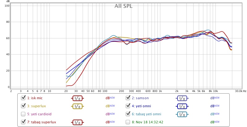

Anyway, here are the graphs from my shootout:

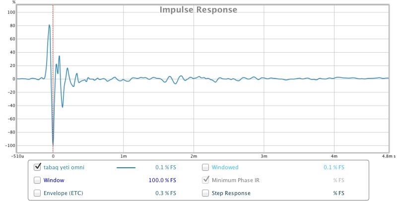

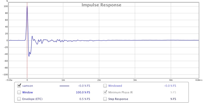

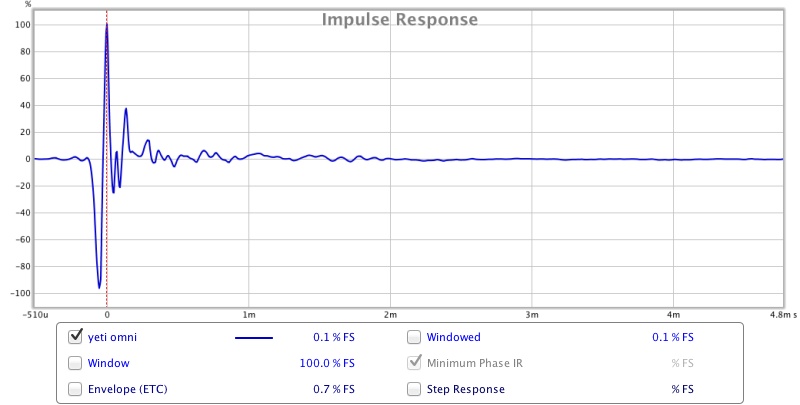

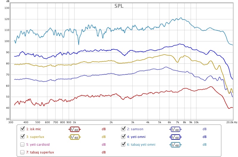

Ok, I did the overlay thingy.. and followed your settings
Hopefully it's cleaner to look at!
Same smoothing at 1/48, the TABAQ is so much more erratic than the EVA enclosure.

.....Ok, I did the overlay thingy.. and followed your settings
Could be wrong 🙂 but looks not as all five traces were highlighted when "Smooting" and/or "IR Windows" command was set.
I wouldn't even look at the impulse of the TC9 in the TABAQ. The goal here is a good impulse to have a reference for a future setup, right? So I'd take either a big IEC baffle or a sealed enclosure of at least 2 liter or more with damping materials inside. Preferably checked with an impedance plot. A clean impedance plot tells you the damping is working. You can see the impedance peak move and if done right it is smooth without wiggles. Just as smooth as a driver in free air measures on impulse. At least that would be my advice.
Ok, first things first then.
The TC9 being in the EVA enclosure which is 3 liters.

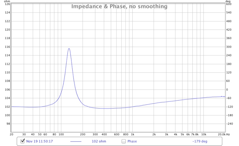

I followed REW procedures for an impedance sweep, added a 100 Ohms resistor (actually was a fair bit under 100) and got this. Looks clean enough.
You appear to have a input connections swapped.
REW Help:
REW Help:
If the left and right connections are the wrong way around your impedance measurements will show curves that are shifted up by approximately the value of the sense resistor.
Oops!
I swapped one connection, and got the same curve, this time starting under 10 Ohms.
But I think we were mostly looking for any wiggle along the impedance curve. As far as I can see, it follows the published curve pretty well.
Check, enclosure approved for further testing. 😉

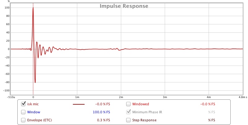

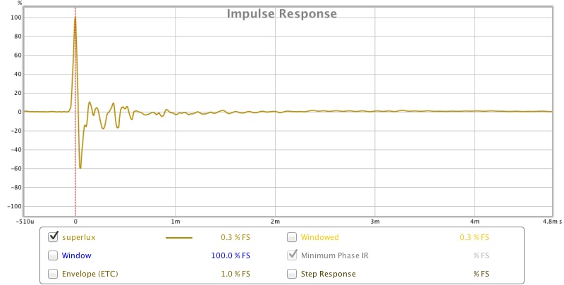

Too bad you don't have a calibrated mic. So far the Superlux impulse looks about right. But strangely enough that's the only FR graph that differs most from the others. You are measuring at 0.5 m on axis? To be able to at least compare to the measurements from X? As far away from any wall/floor ceiling as possible?
Also very curious about a loop back of the DAC. Once we have everything clean it would be good to see the differences between the TC9 and the Aura wannabe. Then you can decide what to do next. I'm guessing you'll be buying in quantities? 😀

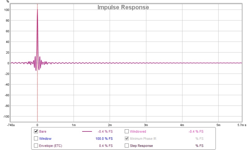

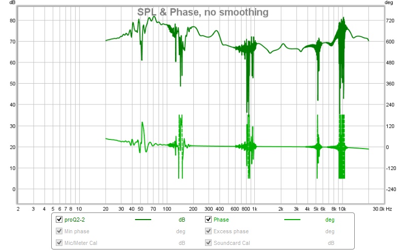

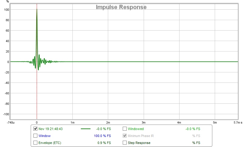

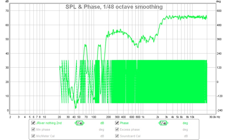

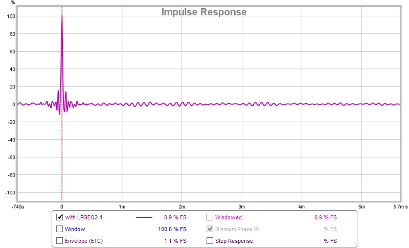

Wesayso, I managed to do a loopback output to input directly using the WDM drivers with JRiver.
The first time around, I deselected everything in JRiver and made a sweep. It looked ok.
I added my processing, EQs and all, and it went all over.
I deselected everything, and it was still all over the place.
Not sure what all of this amounts to...
Here are the 1st time freq sweep and impulse, and then the second time ...

All I can say is something went terribly wrong here. REW not able to interpret the signal. It almost looks like it has trouble with the format of the signal. I've tried to import a PCM file directly into REW which looks similar. Hard to guess what the cause is here.
Try a loopback of your sound card with jriver and no Presonus. If you can switch on filters and off again with readable results it is likely not JRiver that messes it up. In that case the Presonus drivers might be at fault.
If it acts similar with your soundcard then maybe it's a glitch in JRiver or it's WMD driver.
I've done the loop back routine a few times with JRiver without problems. Though I have heard of stability problems of the WMD driver from some users. For me it works and it's easy to assume it should work for others but that may not always be the case.
Do you use Asio, WASAPI or something else for the Presonus. Maybe switching there will gain you stability.
If perceval wants to do speaker measurements, he should get a measurement microphone.
Since he already has presonus with multiple microphone amplifiers with phantom power and ASIO drivers, I would recommend microphone with XLR connection. This will allow measurements using single clock, and with REW will allow use of loopback as time reference.
Microphones used in previous post all are completely ill suited to measurement work.
I know I need a better mic ... and I will get one.

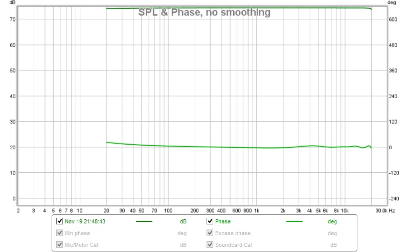

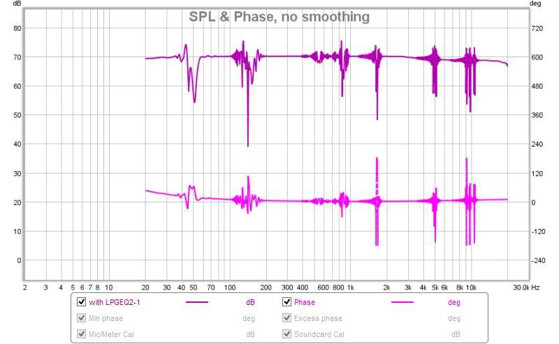

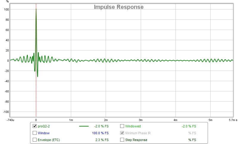

I changed the audio interface for an Art Pro Dual USB, has 2 channels. I was able to do the loopback easily.
I get a cleanish impulse at first, no filters added in JRiver... nothing checked (called Bare). Adding the Pro-Q2 messes up things, even in linear phase, the impulse is not very clean and the phase all over in short bursts along the sweep.
LPEQ2 actually does a better job on the impulse, but a bit worse on the phasing.
I noticed that when I turn on Room Correction in Jriver as the last filter (called All In), it helps cleaning up the phase and the impulse... a lot!

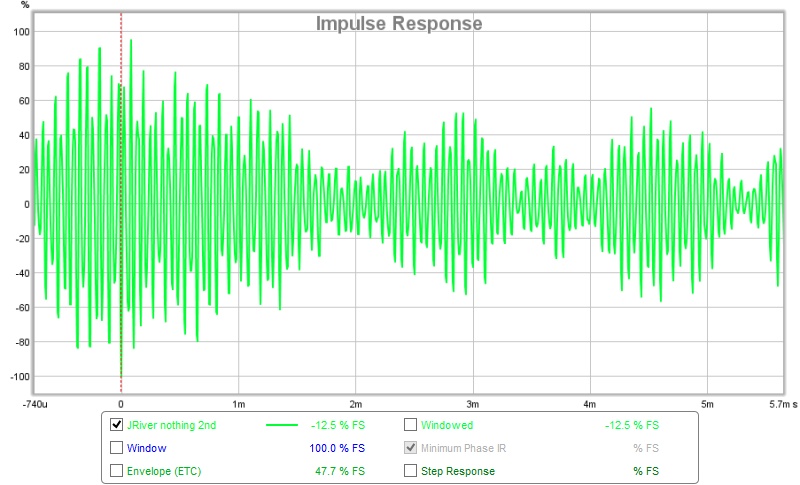

finally, I think I found out that REw is the culprit when I get weird intense like feedback impulses.
I tried with the Presonus again, and each first sweep, I get the same as the graphs above, but if I take a second sweep, it's all garbled.
If I quit and restart REW, it is clean again, but only for the first sweep.
The correction you show, it that only an equaliser? Or do you have more in the JRiver chain. Is it really only (P)EQ?
It's not easy to only judge the (correction) impulse, even though it might look like a big mess. The last option to save the impulse response would be linear phase by the way. You'd have more luck with a minimum phase correction.
Here's a graph of my complete correction of one channel, including lot's of PEQ and convolution:
The corresponding impulse is a mess, as it should be:
Convolved together with the speaker this gives me a cleaner IR end result.
Each time you change the EQ, you add ripples to the IR. That isn't something to worry too much about. But look at the group delay plot to see if REW looses track during those phase and FR disturbances. As you see my plot looks pretty clean. It didn't start out that way though. When I had ripples in my IR (without any processing) I got the same disturbances, but at different places each time I ran a sweep. Is that true for you as well?
