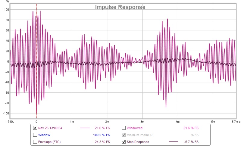

Running WDM called java inside REW have a feeling why the impulse is so erratic is because of SRC is taking place somewhere or probably some buffer settings inside JRiver is not at default, and that could either be wrong settings in Windows sound system or somewhere down the containers inside JRiver. Could you try setting up as below checklist that target run WDM at 48kHz and ensure no SRC is taking place anywhere.

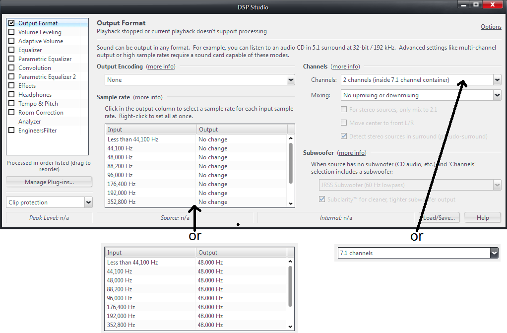

5. In JRiver "DSP Studio" set the "Output Format" container as in attachment, and make shure all containers downstream that will be ticked on later is able to handle 48kHz sample rate and now close JRiver.

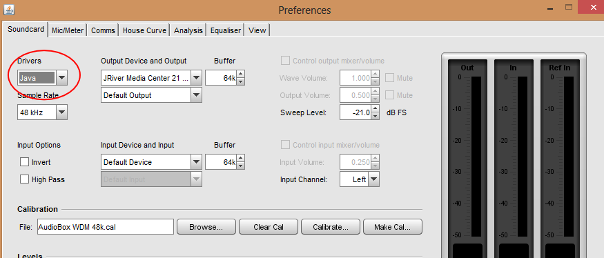

6. Open REW and in "Preferences" "Soundcard" tab set drivers to java, set sample rate to 48kHz, set output device to "JRiver Media Center 21", set input device to "Presonus Audiobox device", set calibration file to Audiobox 48kHz, check in "Mic/Meter" tab that calibration file is none or one that belongs to current mic and now close REW.

Use Java in REW, choose the default Windows device option as driver.
