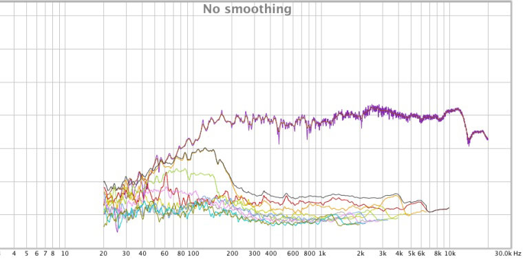

Since the hopes of getting the TC9 locally has vanished again, I decided to follow wesayso's philosophy and try to use what I got and work on it.
This was the original Aura response and impulse, which wasn't great, but not a total loss either.
After spending about half an hour with REW and adding some basic EQ to get the response a bit more tamed, I added DRC, and this is what I got on the second try.

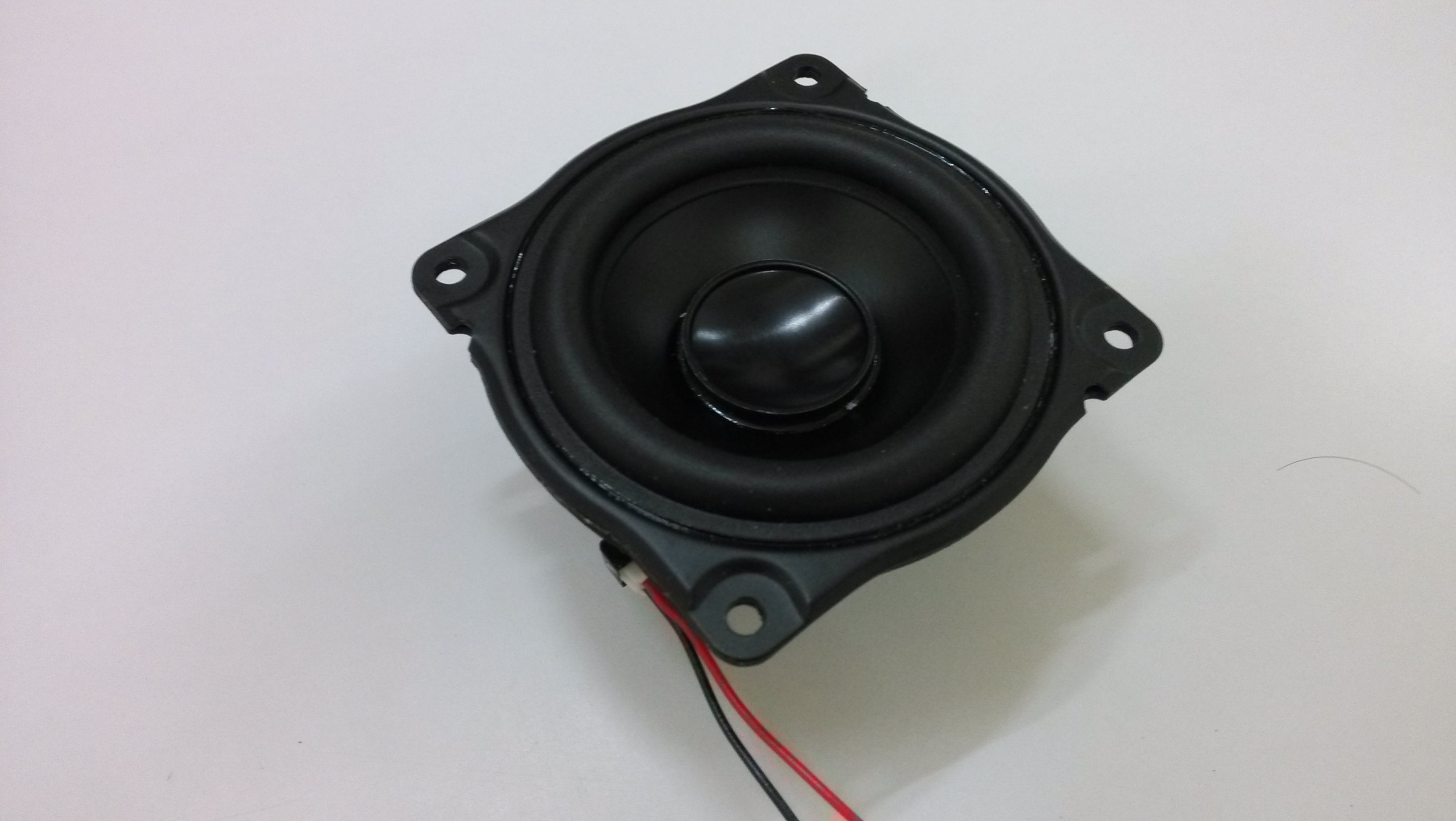

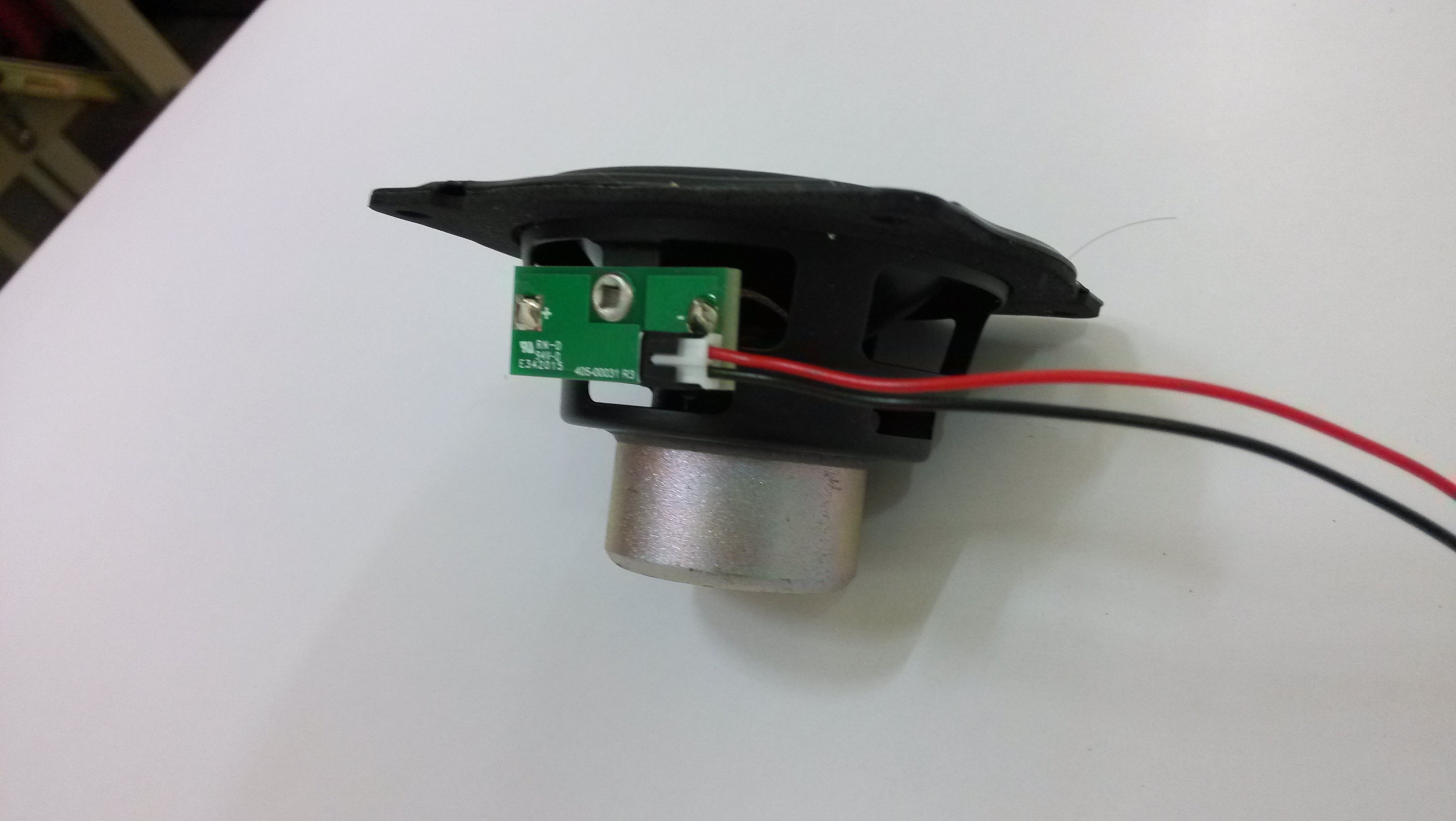

I may have found a way to bring this thing back to life. And a driver worthy of arrays? hmmm....
Wow what a change, except couple blibs in GD on a coarse time scale FR/IR looks very pro, what happened.
I do hope you didn't hammer it down into shape. Because that's not going to work. What kind of window was used here in DRC?
You've got to realise that 25x the Aura, recorded at the listening position will all have the initial ringing in their separate 25 pulses. Together they are hammered back into shape with FIR filters. That's why I recommended to at least sniff on the TC9 to see how a really clean driver does. Do you get what I'm trying to say? It all adds up. Did you listen to it? Did it sound good?
You will probably be able to get a good sound though. Much like the Aura sounds by itself, but on steroids 😀. But there's no telling if you can get it as nice with an array as the above example. Please do the same processing on a TC9 and show those results. Will it do even better, just that single one vs this Aura?

Here's what I did.
I lowered the rising mountain from 1k to 8k.
I lowered the hill from 9k to 12k.
I brought up the sinking hole at 14.5k.
I exported the impulse response into DRC. I used the "Normal" preset filter just for fun, no extra tweaking.
Ran REW again and got the above.
Yes, up to 120ish Hz, it sounds pushed above it's ability. I should have had the DRC curve coming up much later than it is now for a single driver. I got excited.
Anything above 200Hz sounds great though. I actually like the sound coming out of the Auras, just that drop at 14kHz that I didn't like... but it looks like DRC can help there.
After that, I placed the TC9 in the enclosure using the exact same processing. The only difference showed the bump the Auras needed to bring the last upper end of the range up, otherwise, the frequency response looked pretty much the same.

Stayed in the classroom to listen and play with the Aura in my EVA sealed enclosure.
Got a little quiet time, which would be impossible in the living room.
So, this is what I needed to get the response a bit flatter before DRC, this was done very crudely with Apple's own graphic EQ and a small boost at 14.5kHz. A real test would be done with much better filters and control.
After that, I made a sweep with REW, exported the wav, changed to pcm and let DRC Designer come out with soft and minimal filter presets (I don't need it to be perfect, I need to know if it can be done).
Added a hipass filter at 125Hz, to protect the little driver in the sealed enclosure.
And the resulting response. The impulse looks just like the one I published earlier. I don't think I beat this Aura into shape too much.
